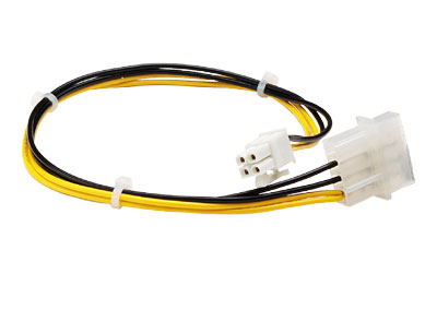

    USB-RS485 is the following FTDI based connector:
    The connection of the adapter to the SCN5's was provided by an UTP CAT5E cable, with a P4 connector soldered to the end so they'll fit in nicely into the SCN5's without soldering to the SCN5's itself, voiding its warranty.

    Even though the cables seemed ok, I've changed the UTP twisted pair cable for ones from an USB cable.
    And magically one SCN5 started living (still haven't got a clue why the UTP cable suddenly stopped working and now it does work with the stipped USB cable...).
    So I tested the same cable on the 2nd SCN5 and nothing.
    So the problem I'm having is that with the same cables etc one SCN5 is working and the other isn't.

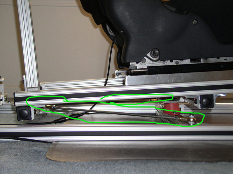

    I was looking at you sim and noticed that you don't have any extra rod's between the seat frame and the bottom frame to keep the seat frame from turning left or right.
    As you can see in the picture there are 2 rod's going from the botom frame to the seat frame. How did you solve this?

    Hey Mexwall,
    I don't exactly know the answer but I think it is because he is using a universal joint instead of the Frex-style rubber bushing.
    Don't hold me to it.

    Over the years here, I belive the consensus has been that a universal joint has been more cost effective and less prone to use configuration error that result in actuator failure and poor quality motion due to the small amount of uneven rotation. If you search the forums for universal joint, you are sure to find many posts of varying types and prices.
