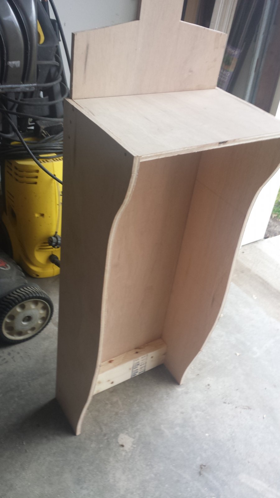

    I decided to build only the shell from these plans, leaving the interior completely available for supports, motors, linkages, electronics, etc.
    So here's the back of the seat with the headrest and various bits at the top yet to be completed.
    The only immediate concern with building just the shell is that I wanted the rear panel to be removable, so I needed additional support there. I decided on a couple of 2x4s. You can see one at the bottom in the above pic. . .there's another at the top. Each are screwed/glued into the side panels and the back panel is only screwed into them so that I can remove it.

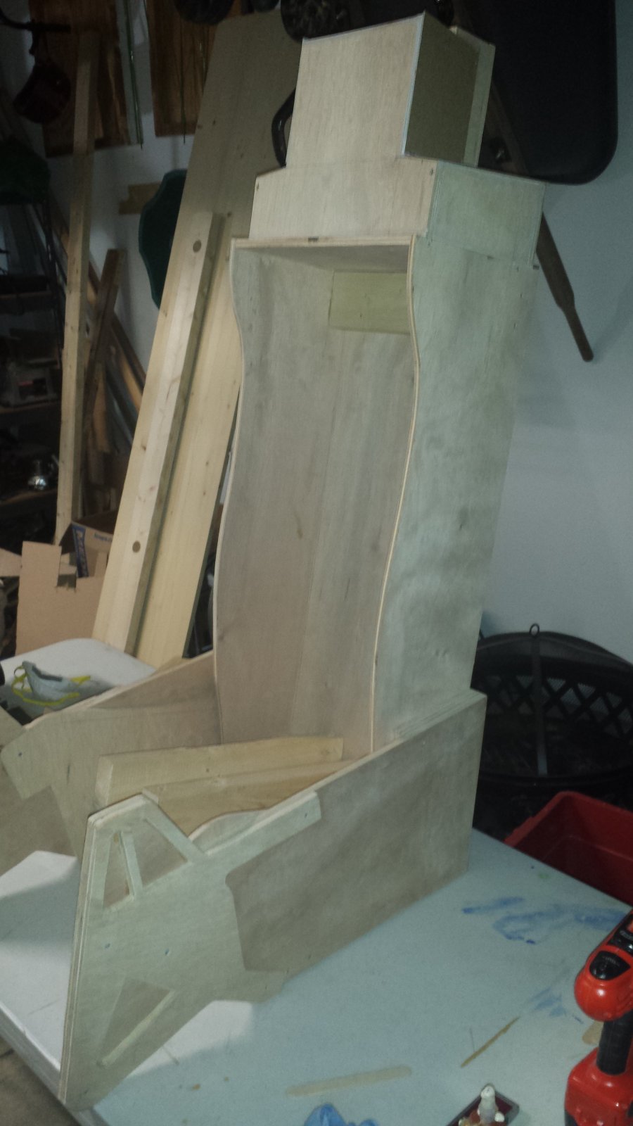

    Next came the "seat of the seat" and it's attachment to the back.
    The main deviation from the plan here was to omit the center supporting structure, also in the name of space for internals. You can see two 2x4s poking out of the back that will eventually support the seat flaps.

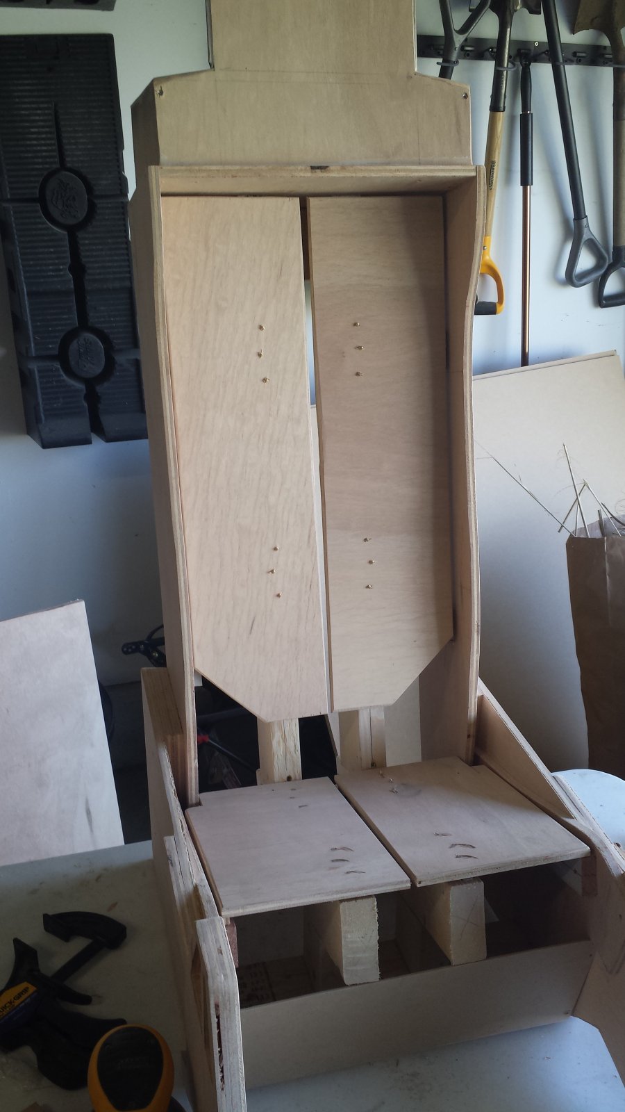

    Here's a better pic of that, along with a hint of the back flap supports:
    Finally, the flaps! I went will full-size flaps as I want anyone to be able to enjoy the seat, not just me. And me being 6'6" and 220 lbs means customizing it to myself only would have left out a large portion of the population in my house.
    The flaps will eventually be padded and covered in OD canvas.

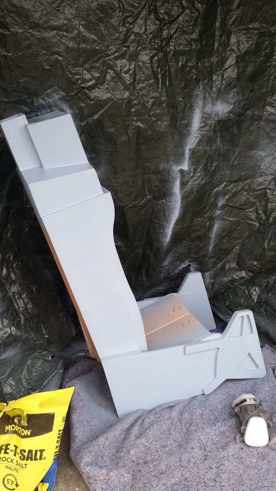

    Woodwork filled, smoothed, and painted. Flaps not painted as they'll be padded and covered eventually.
