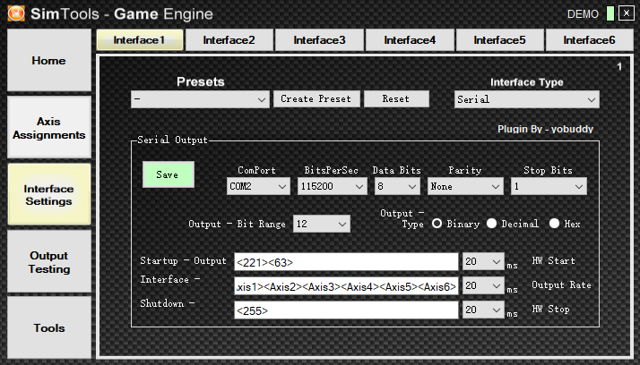

    following the FAQ :https://www.xsimulator.net/community/threads/game-engine-exceptions.7080/#post-82208

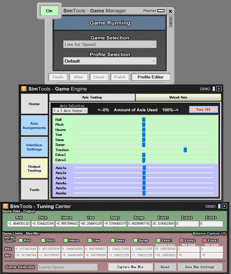

    after start the LFS , simtools sucessful hook the game , but in the virtual Axis only the Traction is moving , the other status in virtual Axis not moving (other status such as [roll pitch heave yaw seay surge ]in tunning center have normal value ) , did anyone has this problem ?

    The difference from the now obsolete SimTools 1.3 to SimTools 2 in setup is that in the Interface Settings instead of axis defined like this <Axis1> it now has designate grouping for a or b in SimTools 2 for each axis assignment, like this <Axis1a>
    In addition make sure LFS is run for a race in first person mode before patching it for motion, as that generates some required files.
