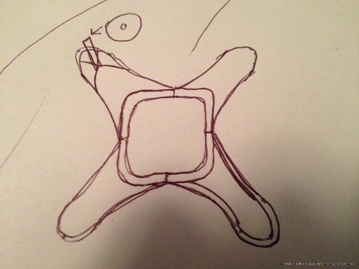

    HI EVERYONE! So.. I finally think im ready to post a little about my sim. Keep in mind.. 1. yes my welds are poop 2. I'm running on a tight budget, and last but not least 3. Im married. If you're wondering why i added that in refer to number 2 [​IMG]
    On that note, if anyone has any suggestions or constructive criticism about my build please feel free to hand me your thoughts, dont worry im a very professional person, you're not going to hurt my feelings [​IMG]
    So here we are with my original plans of what i had in mind for my sim, we can see its... well... a penis? not really what i was going for. Did i mention i cant draw?

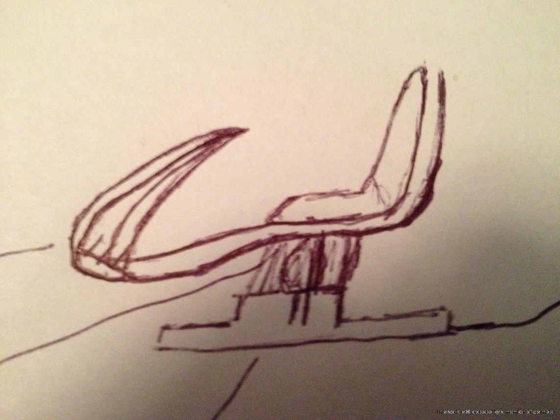

    And of course my initial thoughts for the base..

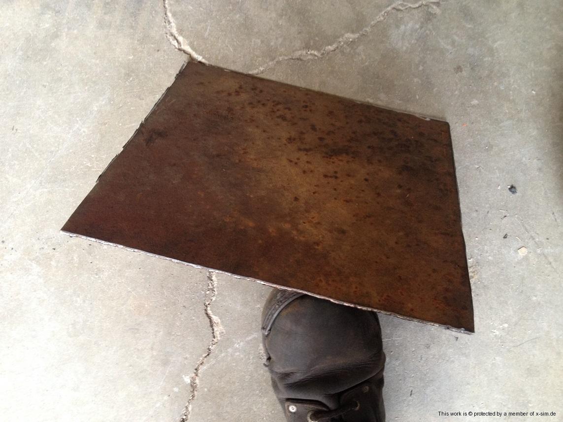

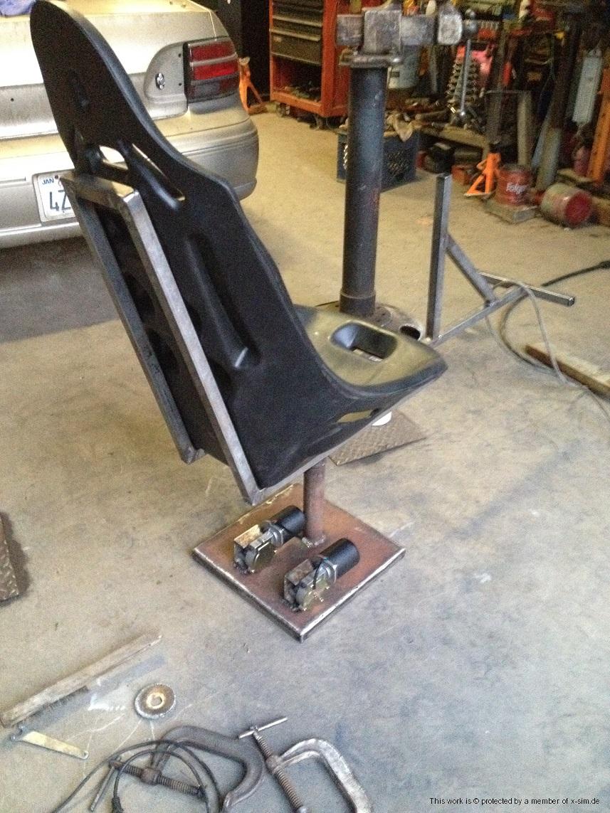

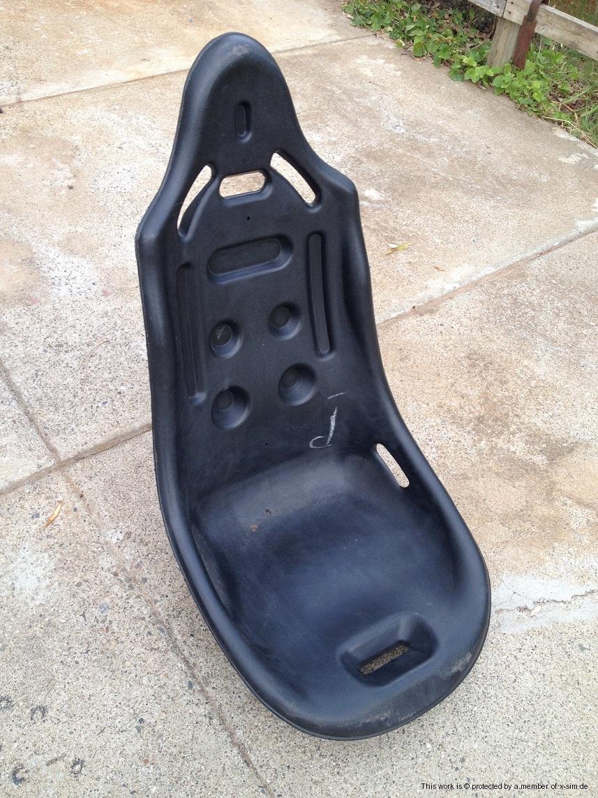

    So i grabbed one of our old race car seats

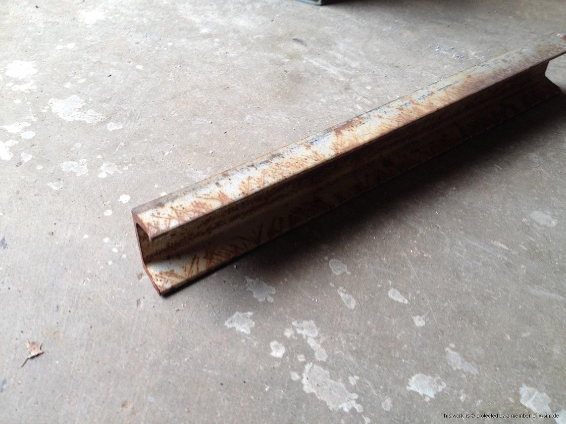

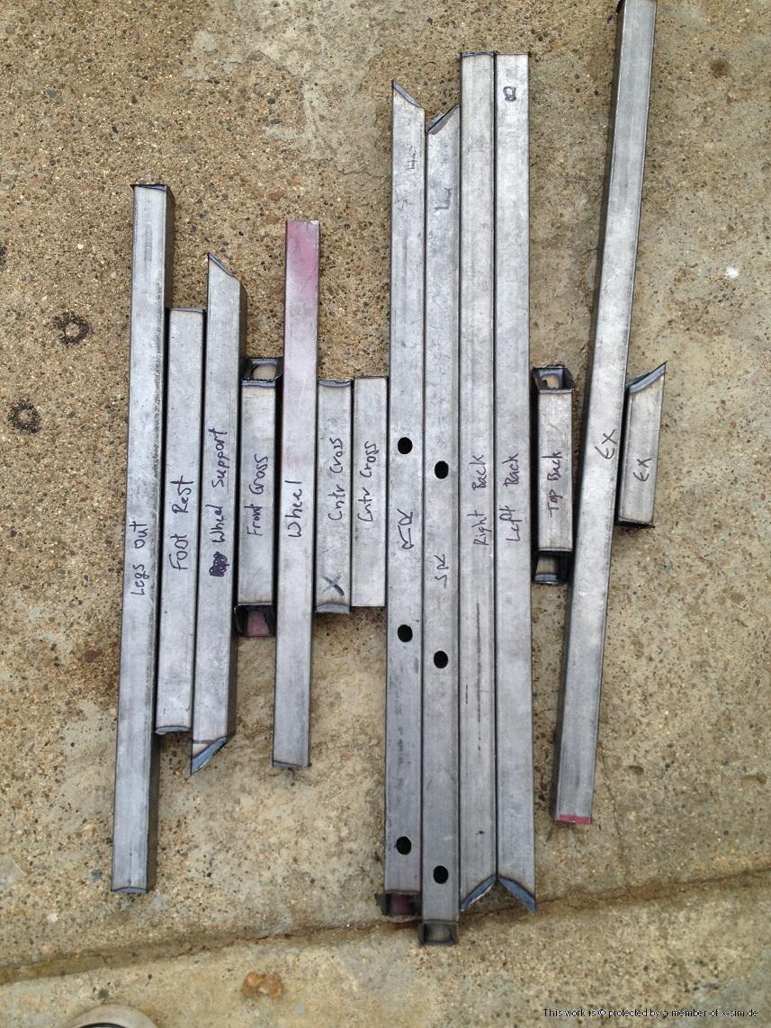

    And some metal for the frame..
    Some more...
    Annnndddd more..

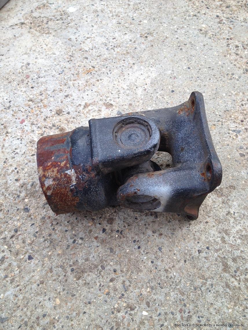

    Found an old toyota u-joint in the parts pile.. (family of mechanics)

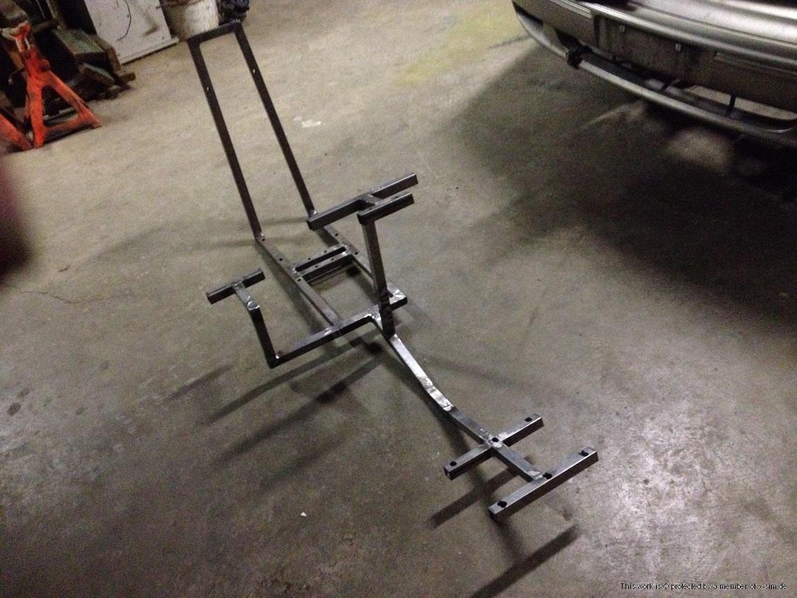

    And started piecing together the frame..

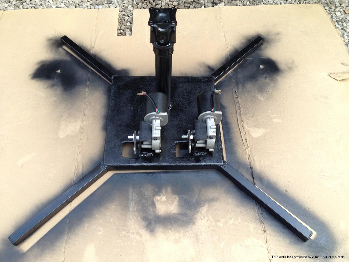

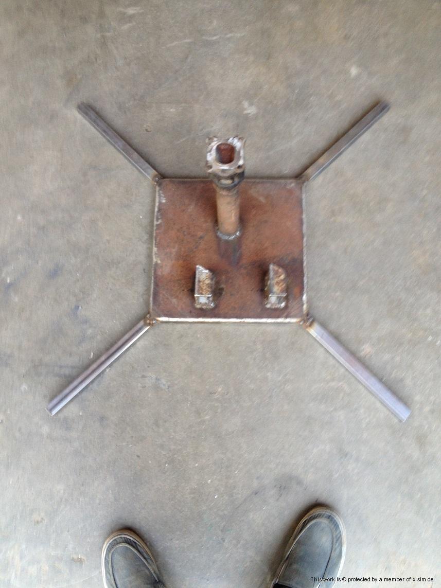

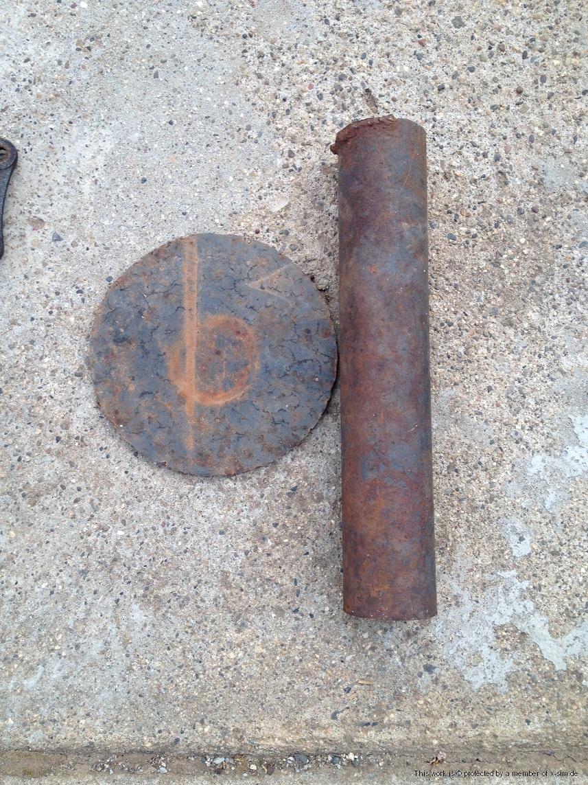

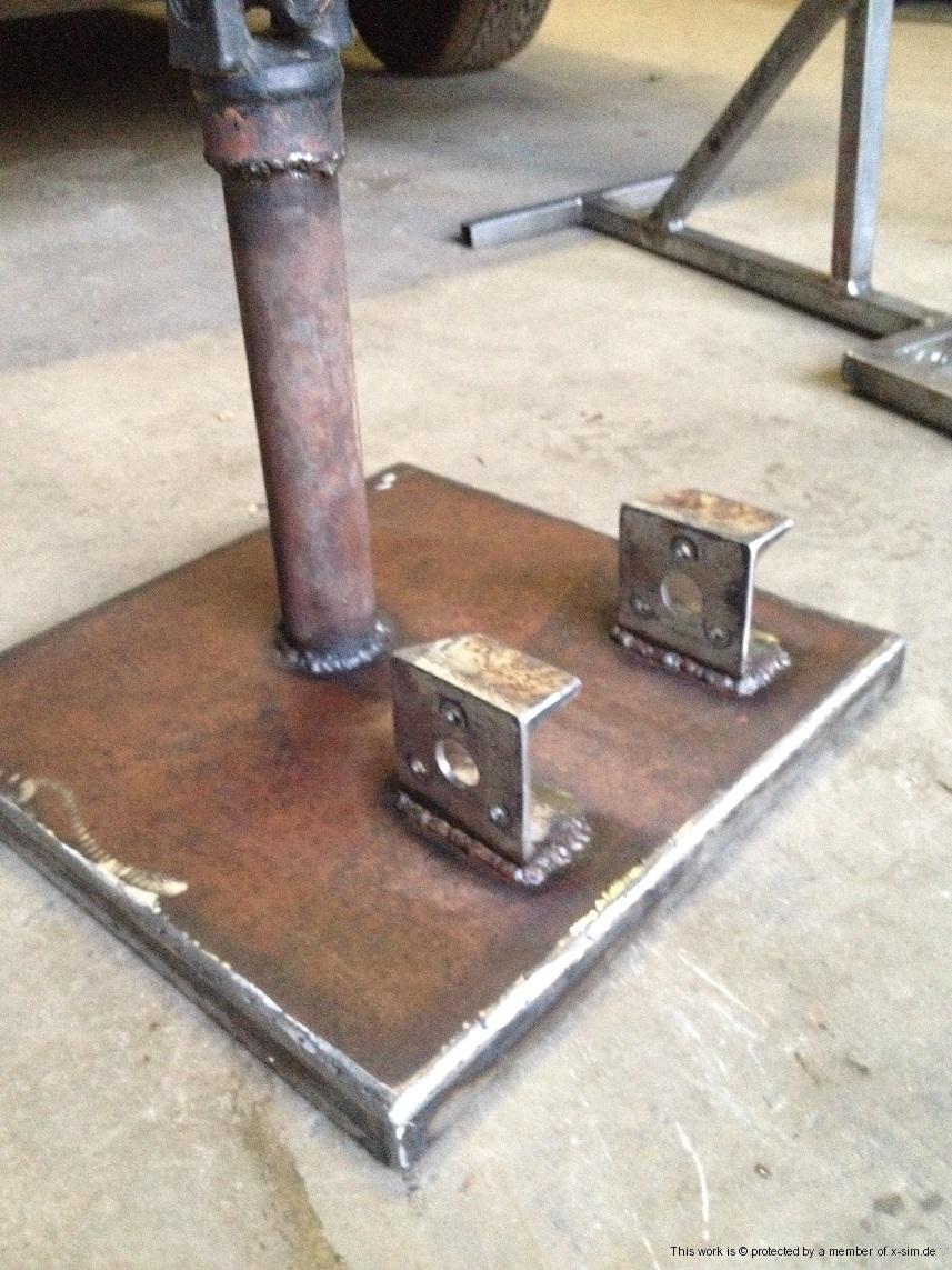

    Built the main of the base from the square plate on top of a square tube er... square [​IMG]

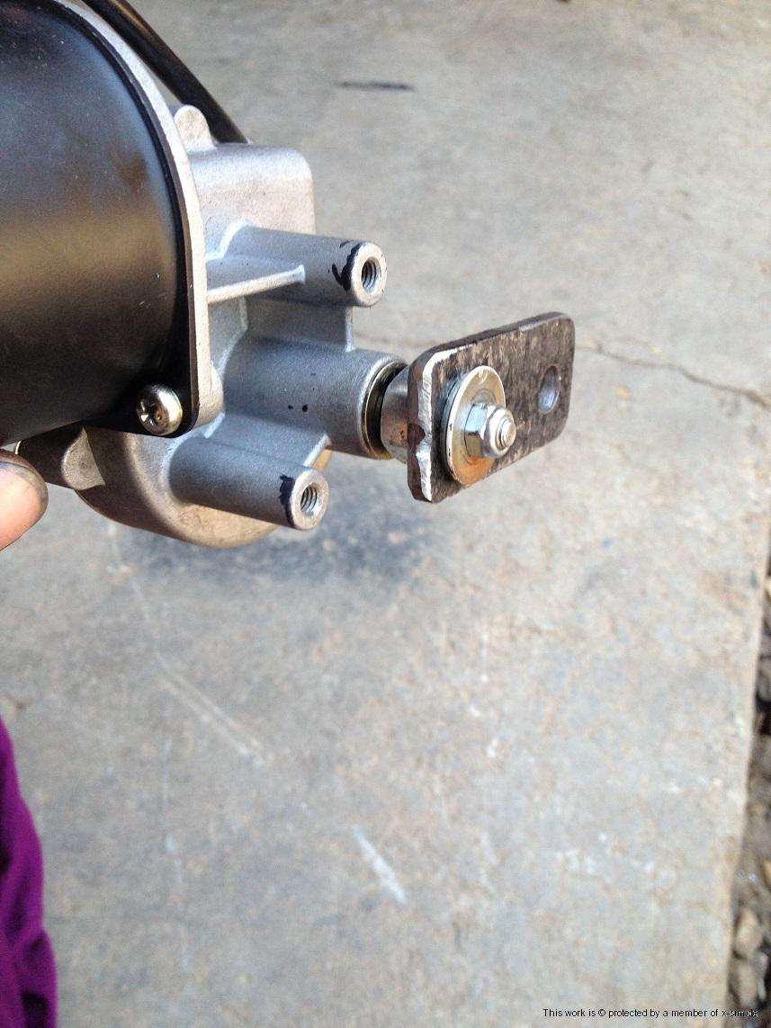

    Got some "Wonder Motors" off ebay for 60 bucks a pop (bad idea i find out later)
    And cut out some arms for them at 2" center to center (i later made that 1" center to center)
    And cut some mounts for them out of that handly C-frame

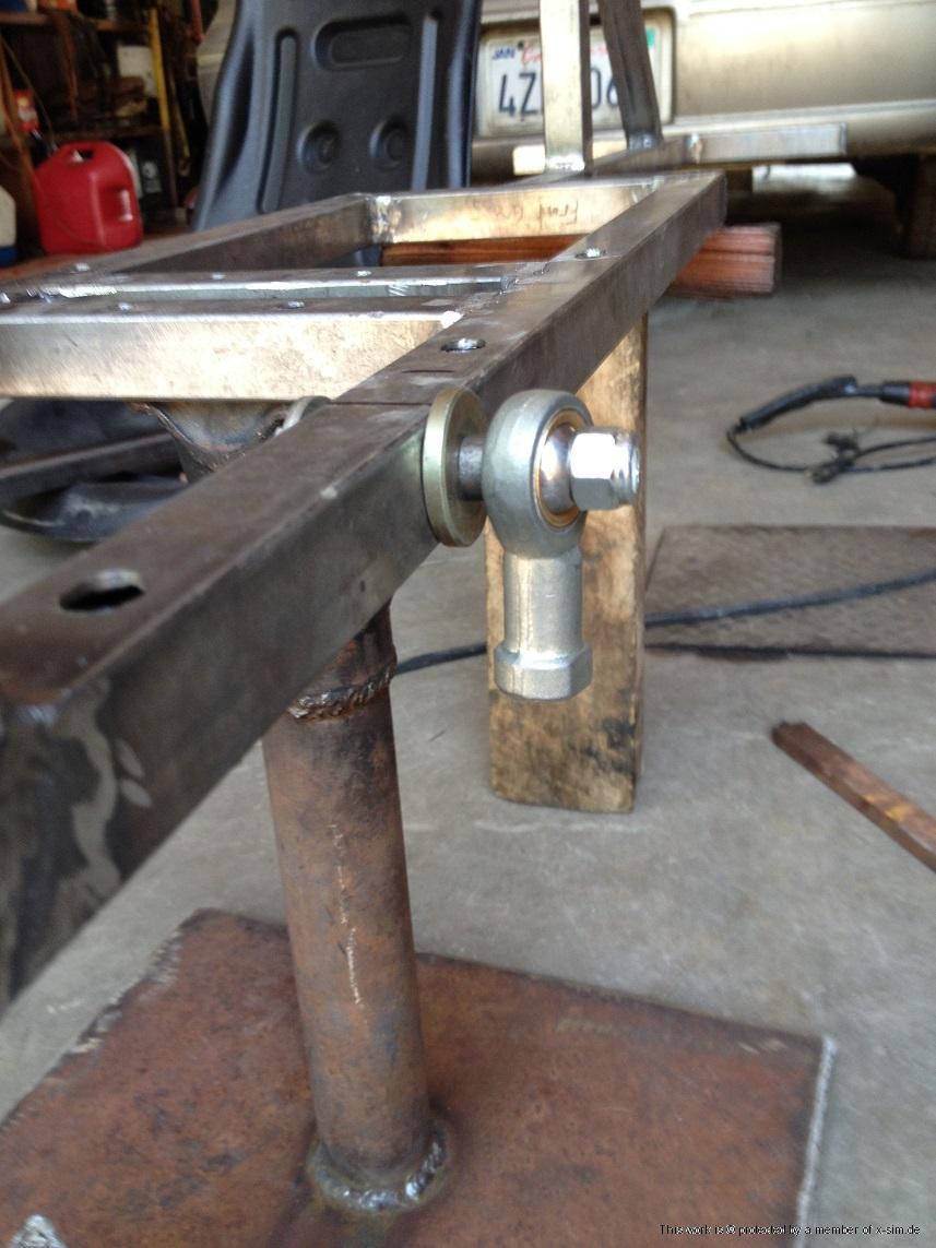

    Installed the mounts and u-joint on the base, along with the motor mounts

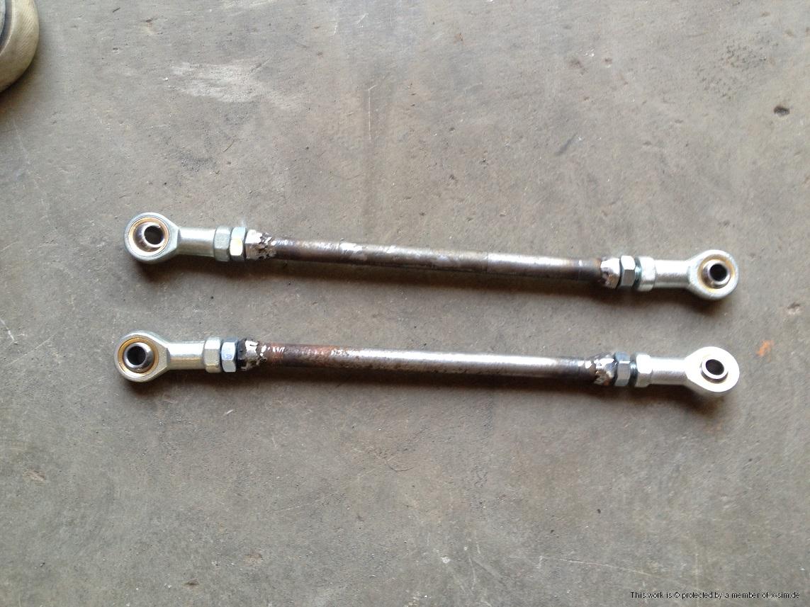

    And of course.. Built said arms. Yep you're right, one of them does look kindof crooked doesnt it? haha
    Added some legs to the base so we dont go through the "Windshield" [​IMG]

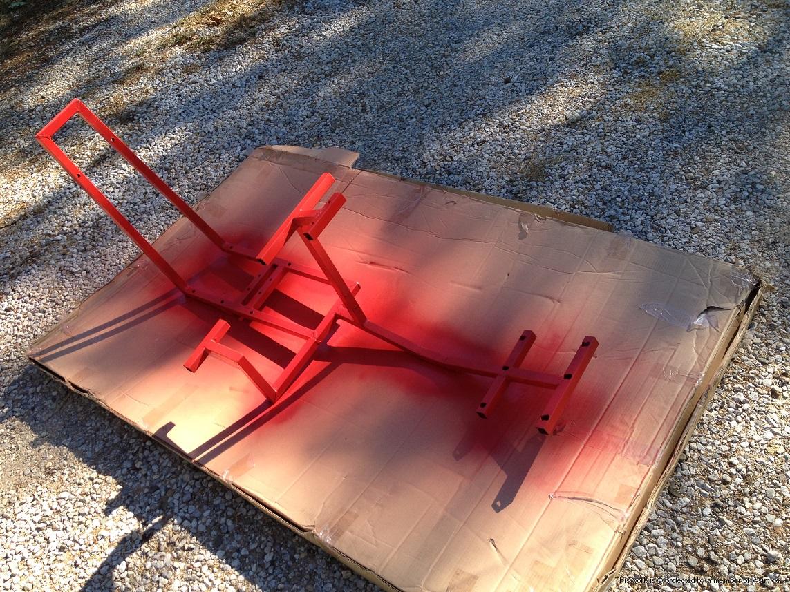

    I think we're ready for paint dont you??
    Well think again.. Didnt like the way the frame felt to sit on with my feet at the pedals, so adjusted the front area a little and fit it for the wheel setup.
    Yeah thats better, now just for a little piece for the shifter
    Now we paint!! [​IMG]

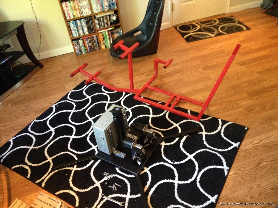

    err... i think thats it
    Ready to assemble! [​IMG]
    And the final (cough yeah right cough) product!
    Now for the "forum" part, haha. I got about 1 hour play time out of this baby and the cheap ass bushings on the output shafts of the motors developed enough play that the sim was constantly pulsing (because the pots thought the chair was supposed to be moving). This thing was a blast for that 1 hour though! I now have some different motors on order, gonna redesign that area a little and try and mount the pots a little better (sorry i forgot to take pics of the current pot setup). Anywho, let me know what you guys think! If you have any questions or suggestions hit me up! [​IMG]
