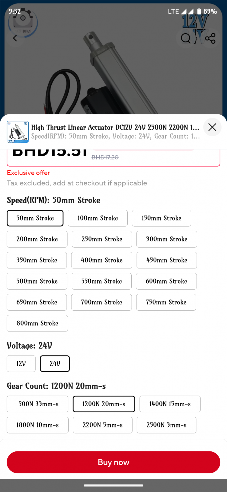

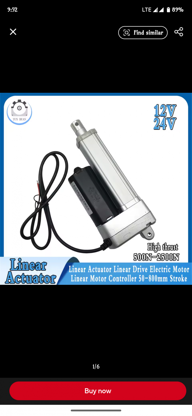

    Hi, its possible to use these sliding door actuator for motion simulator?
    All i want to do its to make 4dof motion simulator, so at least i can use it for traction loss only? I have 2dof motion simulator using worm gear motor (Smc3) , so if i use this one as third motor for traction loss will it work ? With same type of controller?

    Those type of actuators, like opening a door, are not designed for fast motion.
    Additionally, any actuator requires a controller, that then interfaces with the motion software, be it SimTools, FlyPT or the like.

    You looked at the link?
    With an minimum of 200mm/sec(what i would recommend), your torque will be 10times lower(12kg). This will not work....

    I have never seen those actuators on a sim rig but I know somebody who tried to build a walking robot with them. Those door or seat actuators are not build to work continously under load. He had burnt motor windings within ~half an hour. The motors are much to small to do any serous work, at least for more than several seconds.
    You need actuators with ball screws and motors able to deliver at least 250W.

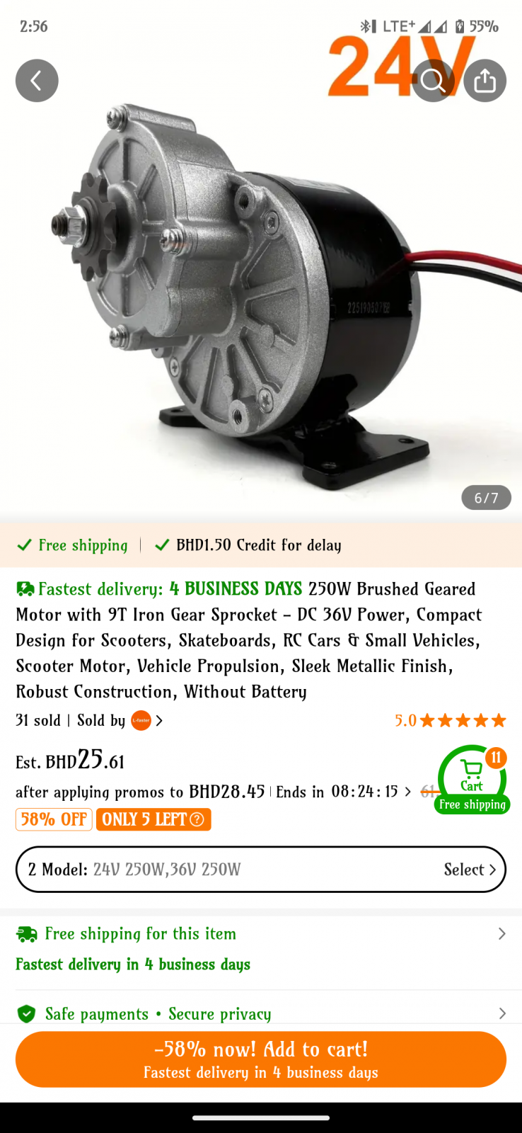

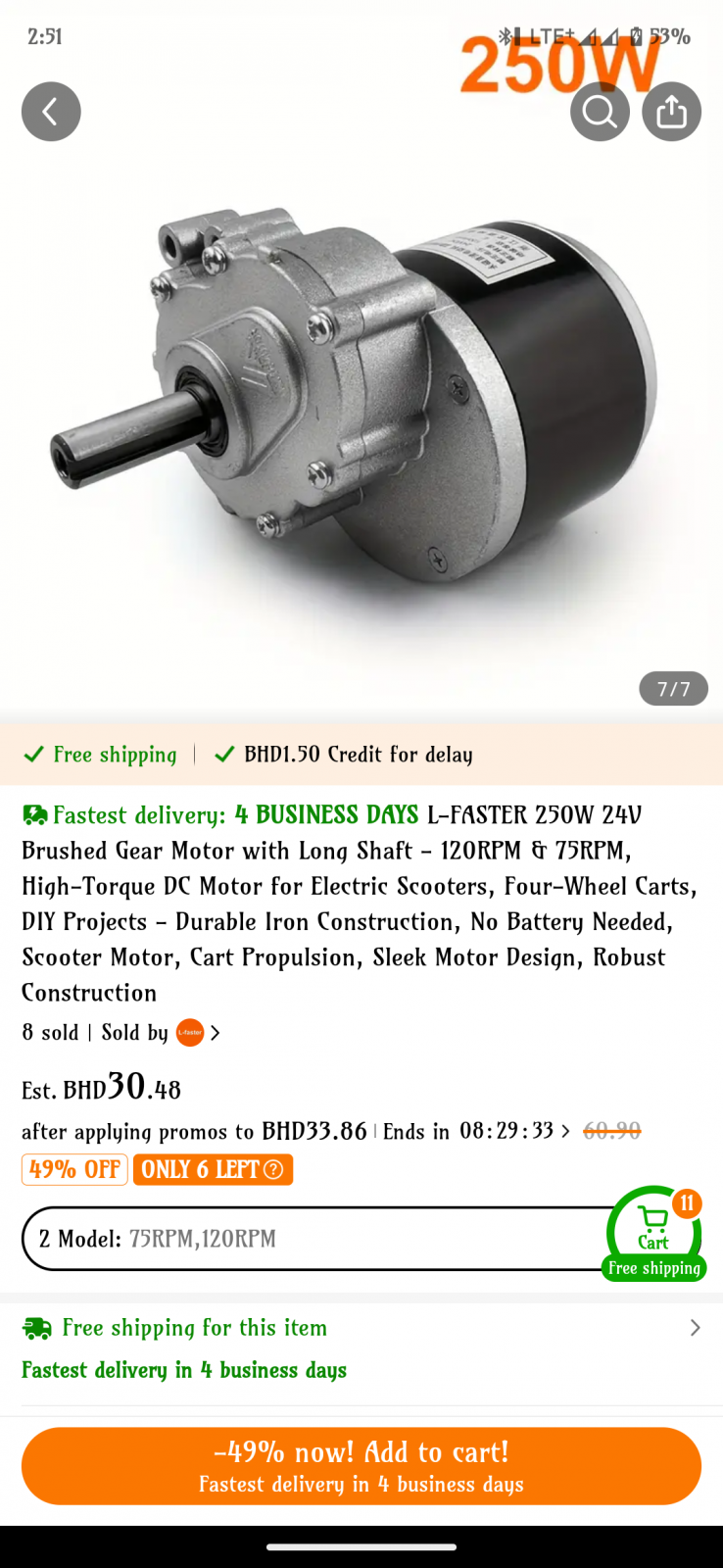

    Found these motor but its 24v and 250w and rpm 120 max
    Its dont show speed like mm/s
    Its wheelchair motor
    And this another one 24v and 250w but show 3000rpm
