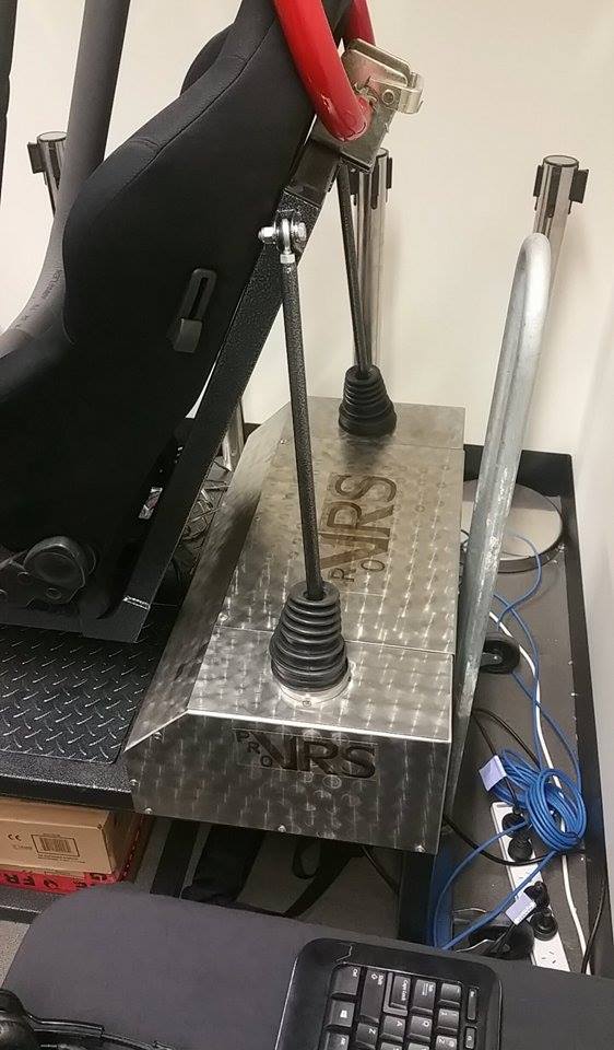

    A mate of mine did a nice cover for the back of his seat mover recently
    so you could cover it up.
