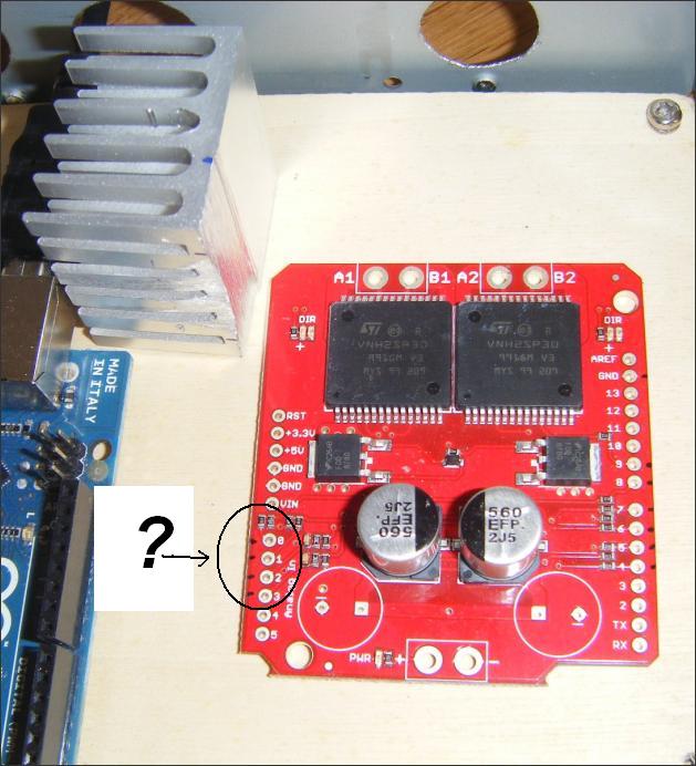

  6. Andrea 1968
    Andrea 1968 Member
    Jul 1, 2015
    65
    italia
    193Coins
    +40 / 0 / -0
    excuse my insistence , I can not understand the list of pins with the photo.
    in the picture there are pins on MM that on the list there are not , why ?
    and ' can do a bit of clarity , I not would burn some component ,
    await response to start connections between Arduino and MM ,
    Thank You

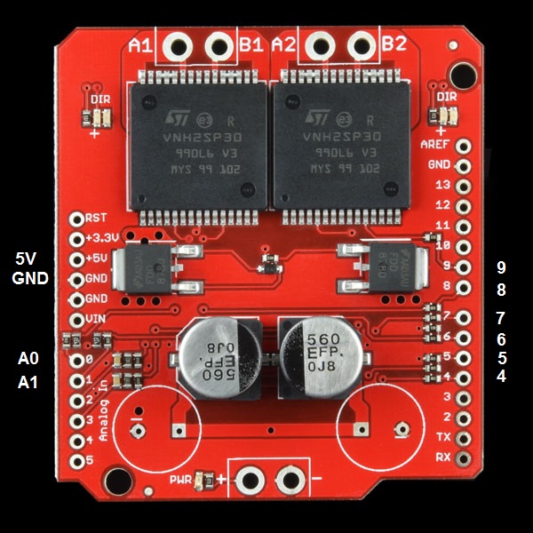

  7. RacingMat
    2,237
    21,006Coins
    +2,092 / 21 / -2
    there is no need to connect all the pins... only these :

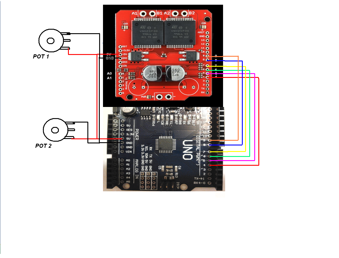

    hi , thanks for reply , I still have Doubts about A1 and A0 , but do not go on Arduino ?
    Please could you take the attached picture and complete the connections of the potentiometers simply with the p a i n t .
    I'd appreciate it , thanks again and sorry insistence .
  9. RacingMat
    2,237
    21,006Coins
    +2,092 / 21 / -2
    I don't really understand your sentence
    Pot1 on A0 (Analog 0)
    Pot2 on A1

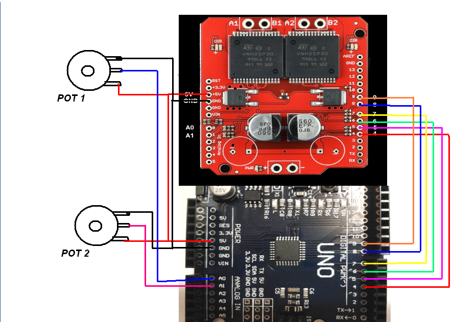

  10. Andrea 1968
    Andrea 1968 Member
    Jul 1, 2015
    65
    italia
    193Coins
    +40 / 0 / -0
    And so ' right?

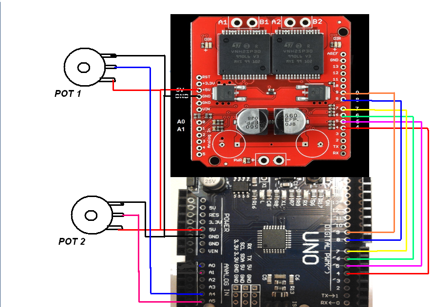

  12. Andrea 1968
    Andrea 1968 Member
    Jul 1, 2015
    65
    italia
    193Coins
    +40 / 0 / -0
    hi, the tests carried out and watching the files of Arduino inputs are A4-A5
    as illustrated and everything works perfectly, thanks MAT
  13. RacingMat
    2,237
    21,006Coins
    +2,092 / 21 / -2
    I wrote A4 and A5 in the code? I should correct the pinout
    but it's nice to have a look a the code anyway, and to understand what is done
