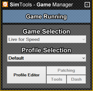

    When I go to start up LiveForSpeed, the Game Manager shows Game Running in blue. I start playing the game racing the car, and the Output Testing Visual Axis does not show any data and neither does the Game Engine Tuning Center. I've tried several times re-installing both LFS and SimTools, with no success. Does any one have any ideas?

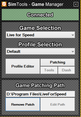

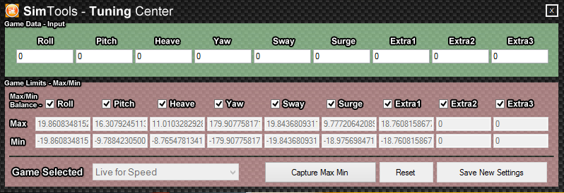

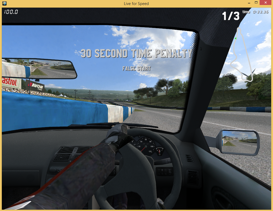

    Thank you for your suggestion. I unpatched LFS with GameManager, then exited both GameManager and GameEngine processes. I then restarted both of them as "Administrator" and patched LFS with GameManager (SimToolsLFSPatched.png). I then started LFS and started SinglePlayer (SinglePlayer.png) race. Opened TuningCenter (TuningCenter.png) and NO DATA is observed.
    Note that GameManager shows "Game Running" in blue. I can also use GameEngine OutputTesting to manually activate my Arduino Stewart Platform.

    RESOLVED!
    Another friend suggested I try installing LFS and playing SinglePlayer game FIRST BEFORE patching LFS with GameManager. THIS DOES WORK!
    What I had been doing prior to above sequence, is to install LFS and then immediately apply SimTools patch without first playing LFS game. THIS DOES NOT WORK!
  5. Historiker
    2,162
    9,214Coins
    +2,170 / 19 / -1
    I believe that is mentioned in the documentation, I had assumed that you had already started the game first. When the game starts it creates files that Simtools needs to use as well. Glad to hear that it is working for you! :)

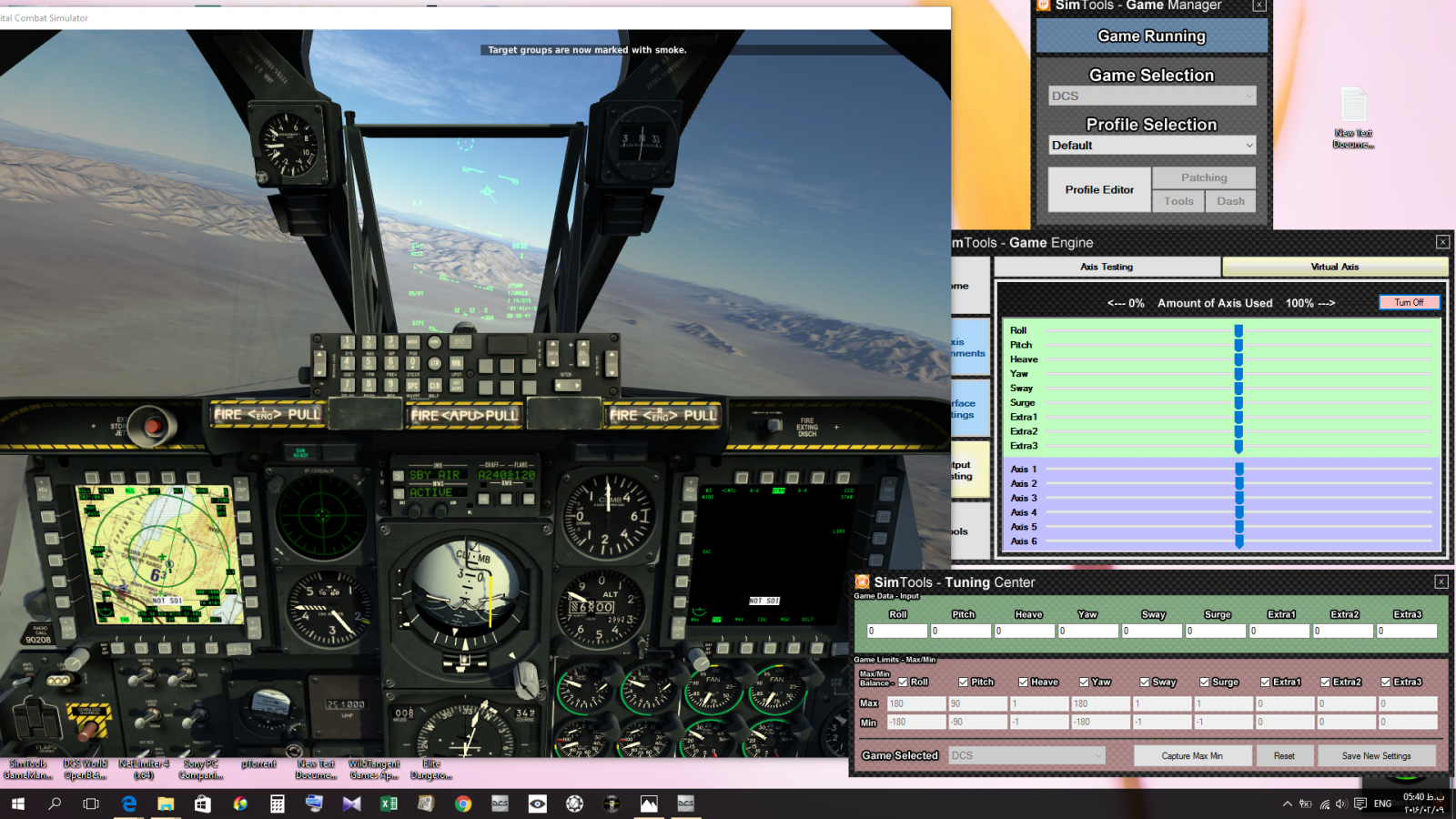

    I install the dcs patch, but in the game can not data to the tuninig center why?

    @mohammad, this is the wrong thread for your question. Please post your question in the DCS plugin thread.
