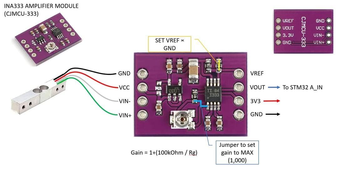

    Good afternoon Guys,
    I'm trying to assemble a brake pedal with a 100kg load cell + stm32 and INA333 amplifier, I'm following a diagram that I was given, but I'm not getting any signal from the brake pedal, has anyone used this amplifier?
