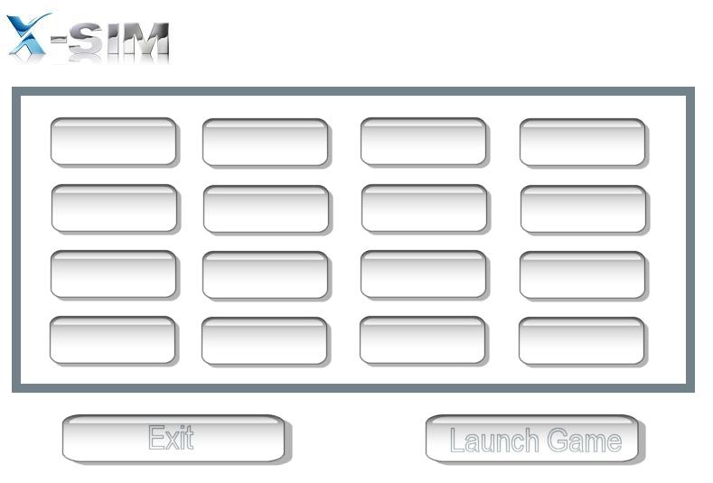

    It would be cool to be able to have some sort of xsim quick launch application. With one button game launching and profile loading. It would be neat if we could create “buttons” or a small graphic for each game. I picture a really simple layout with a button for each game and an exit and load button at the bottom.
    Quick mockup just for fun:
    Looks kind of like the wii menu - lol

    This is along th e lines of what I am working on, except for I am creating a full menuing system where users can define their own button images, an associated mouse over video, background music, and most importantly an fsd, rn2 profile combination. I am not able to make further progress until either the fsd file is able to update the profiler with the contents of an rn2 file, or until their is some mechanism to tell the profiler to reload the contents of the registry. It seesm that currently, the math setup is saved to the registry on exit, but I have no way of telling it to reload it, if I have my menu system change it when a button is clicked.
    I think in an earlier post, SirNoName said that he would build some kind of functionality into Profiler 2 that would allow ShellExecute calls to FSD files that would send the contents of an rn2 file to the profiler, but I may not have fully understood.
