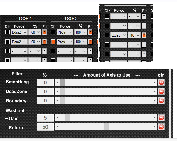

    That was very helpful Andy, got me to a decent starting point in Project Cars 2 at least. One problem I'm noticing is that traction loss (and recovery) is extremely violent and jerky. Whenever I leave or return to the track I get a very sudden and significant yaw movement.

    Use yaw/sec and look into washout or smoothing. Washout gain determines how quickly a force takes effect and washout return is a speed of returning to neutral.

    3DOF, Arduino
    would you be so kind to explain where i should adjust those values please?
  9. Spit40
    Spit40 VR Flyer
    Nov 3, 2016
    351
    United Kingdom
    2,944Coins
    +201 / 3 / -0
    Do you mean how to adjust washout? If so, click the small square to the right of the tuning line. The one to the right of 100% in this pic. in the Flt column If you don't have the Flt column then there is another plugin mode. I think one's called Basic and I forget the other on. It might be interface settings - sorry I don't have access to my main PC now.
    In Aerofly Fs2 and probably as a convention in SimTools plugins
    Extra1 = roll/sec
    Extra2= pitch/sec
    Extra3=yaw/sec

    +49 / 0 / -0
    3DOF, Arduino
    Thank you for your explanation! However i don't have such Flt option.. Just Dir, Force and % amount

    448Coins
    +8 / 0 / -0
    That's because you're using Basic mode and need to be in Standard
  12. hazardic
    hazardic m3gt2 fan
    Jan 1, 2015
    68
    345Coins
    +49 / 0 / -0
    3DOF, Arduino
    oh i see, thanks! so i just swap to standard and apply all my settings from basic and technically i will get the same but with the ability to fine tune with Flt?

    448Coins
    +8 / 0 / -0
    That's how I understand it
