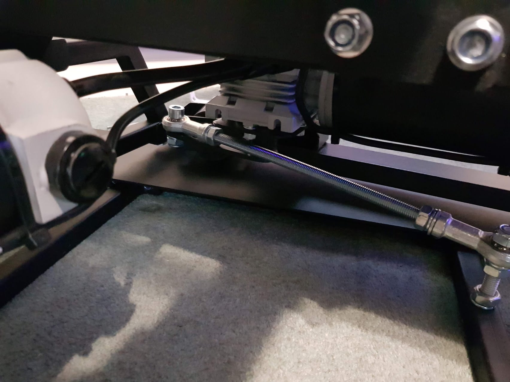

    Anyone know how to reset the traction loss motor position on the P3?
    Mine is stuck and I cannot even move it with SMC3 "manual" mode.
    Basically the sensor on the motor had issues, that issue is resolved, but I am not able to reset the motors position, even after following the calibration steps in the Instructions PDF.
    Help please. Dying to actually get to use this rig!

    Regarding USB. I had 2 USB3 ports on my mobo. I bought 2 4 port powered USB hubs and never had the sort of problems you talked about and I think I had 7 USB devices running in total.
    As for resetting the Traction loss motor. I have had that problem a lot over the time I've had the rig. I found I had to loosen the grub screws connecting the motor to the pots. I was able to manually move the motors back into position and then re-tighten.

    Hi Andy, thanks for your reply.
    Sadly moving the sensor after loosening the screws on the motor side shaft does not move the motor arm in the correct direction for me. All I get is lots of nasty noises coming from the motor! Currently the arm is jammed solid up against the frame, where the traction loss wheel is located. See the pic below.
    The initial problem I had became apparent as soon as I finished assembling the rig and then started to test the rig with SimTools. Moving the two front motors caused the rear traction loss motor to move into the position as shown in the picture above. Turns out that the small shaft that sits in the motor had came loose, probably during transportation. See this picture, sorry for bad quality!
    I assume that the vibration caused by the front two motors movement made the small shaft in the traction loss motor to move, therefore knocking the sensor out of its range.
    I have now secured the shaft in the motor and its now fine. And the sensor is working as I can see the correct output in SMC3
    But I am still unable to get the motor in the correct position. I thought about taking the motor off and seeing what happens, but it looks like those arms are not going to come off easily at all!

    That jammed up motor/arm issue is reminiscent of what happened to me with the Next Level Racing v3, plus it was dead with zero power.
    No external fuse to check, and I would have had to open it up to check anything, voiding the warranty. Minimum $200 to ship in for repair...so back to the store it went.
    Hopefully with the DofReality machines being more open source & made from generic parts that you will have a quick & easy fix.

    Motor is fine, well at least it is making some noises when trying to move it, so at least it has power.
    If it was one of the other motors, it wouldn't be a problem as there is nothing for the arms on these motors to jam up against!
    The arms look like they dont come apart easily, otherwise I would have done this already.
    I am sure its just a calibration issue now that the motor shaft has been properly secured. But I still cannot get the motor to move in either direction no matter what procedure I try!

    Physically by hand, or electronically by software?
    You say that you have the P3, which I believe also has upgraded motors if I'm not mistaken.
    Are they 50:1 ratio gear motors on that unit, and if so then perhaps that's why you are having a difficult time moving them (by hand?).
    I was in the same situation with the NLRv3, there was no way I would have been able to force them back to position by hand (plus there wasn't any power :mad:).
    But that was a sealed unit, which also imposed the issue of not even being able to see what was going on inside :mad::mad::mad:.

    Maybe jammed up in the gearbox. Have you tried unbolting the motor from the stand so it is free to move the arm?

    Cant move them by hand or software. Having said that, the manual option in SMC3 does make the motor do something as when the slider is moved in the software, the motor makes a noise. So it is certainly receiving an input from the software.
    As for moving the arm by hand, nope, that is not going to happen!! I dont know what the ratio is.

    Its possible to unbolt the motor from the stand, but you would not be able to fully remove the motor due to the arm being attached to the motor. And I am worried that the motor will just spin out of control while unbolted from the frame, this could end up doing more harm than good!
    What looks like more of an option after looking a little more closely is to detach the motor from the gearbox, at least that way I could probably be able to move the arm into position, and then use the software to calibrate the motor and then reattach and further calibrate .
