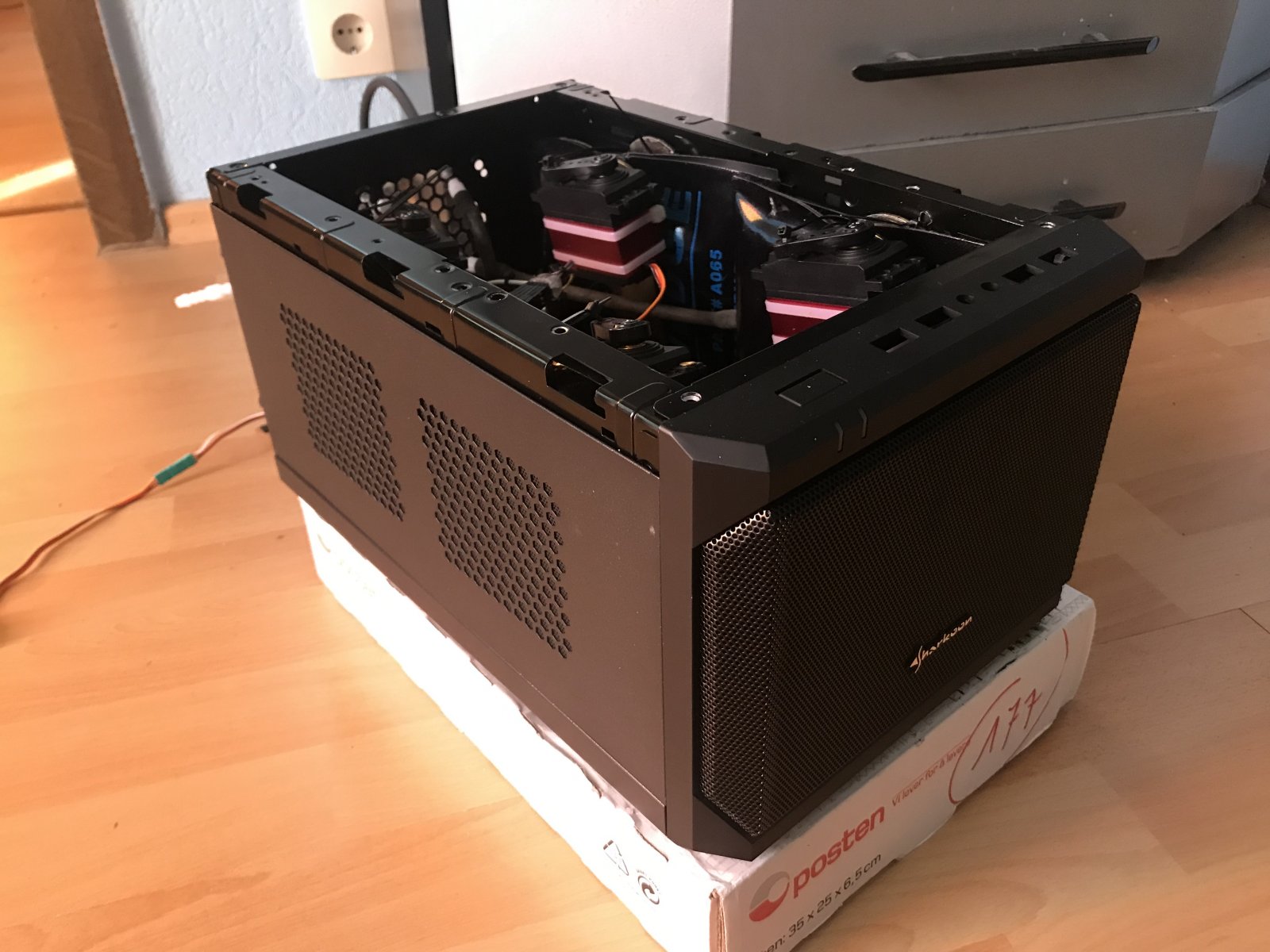

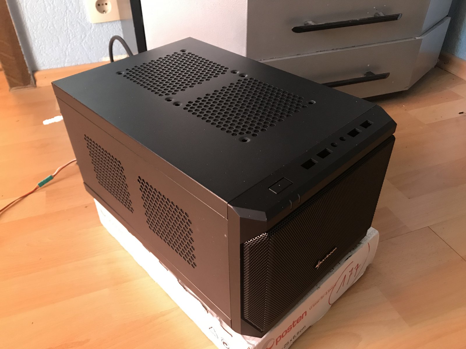

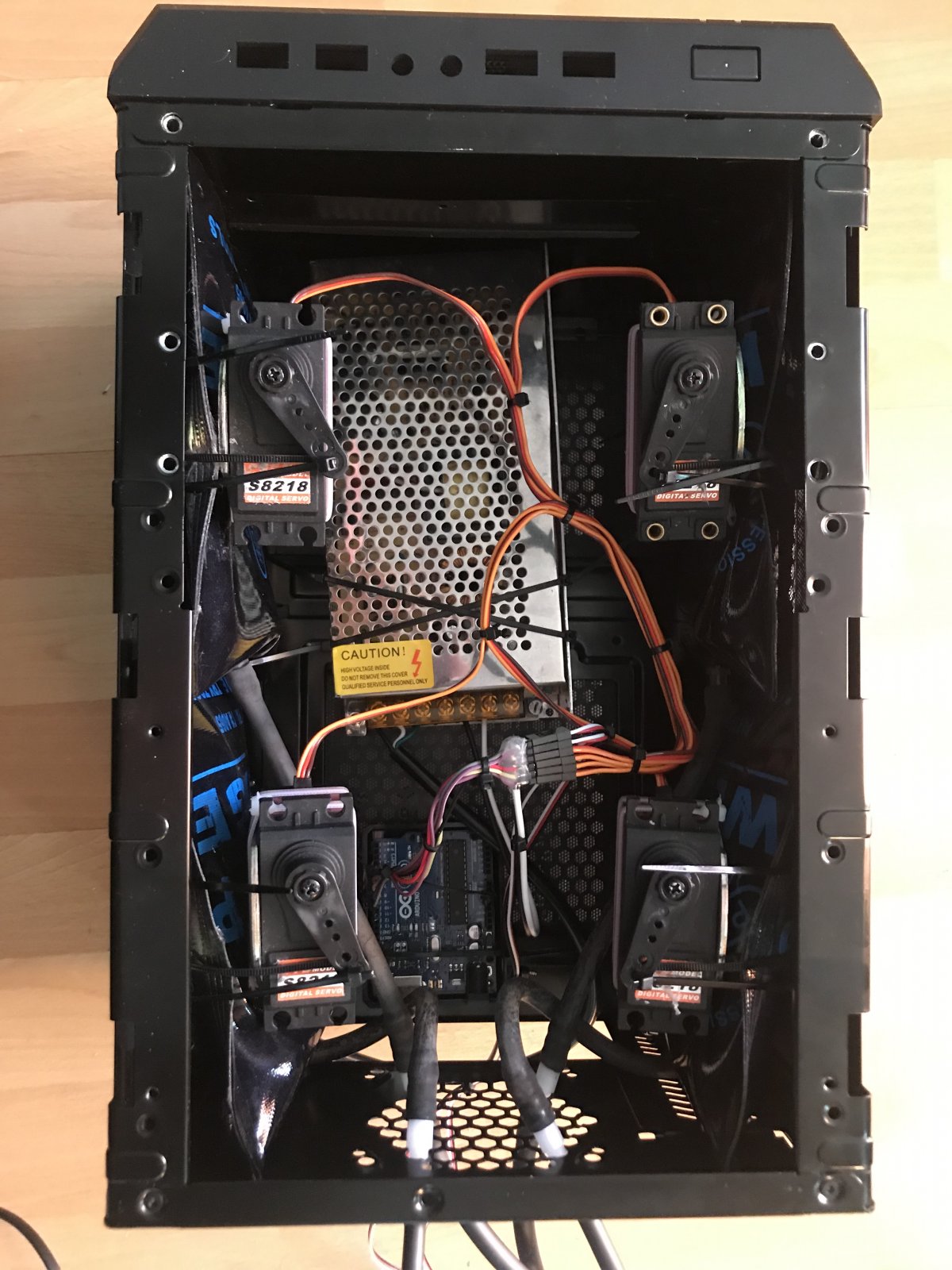

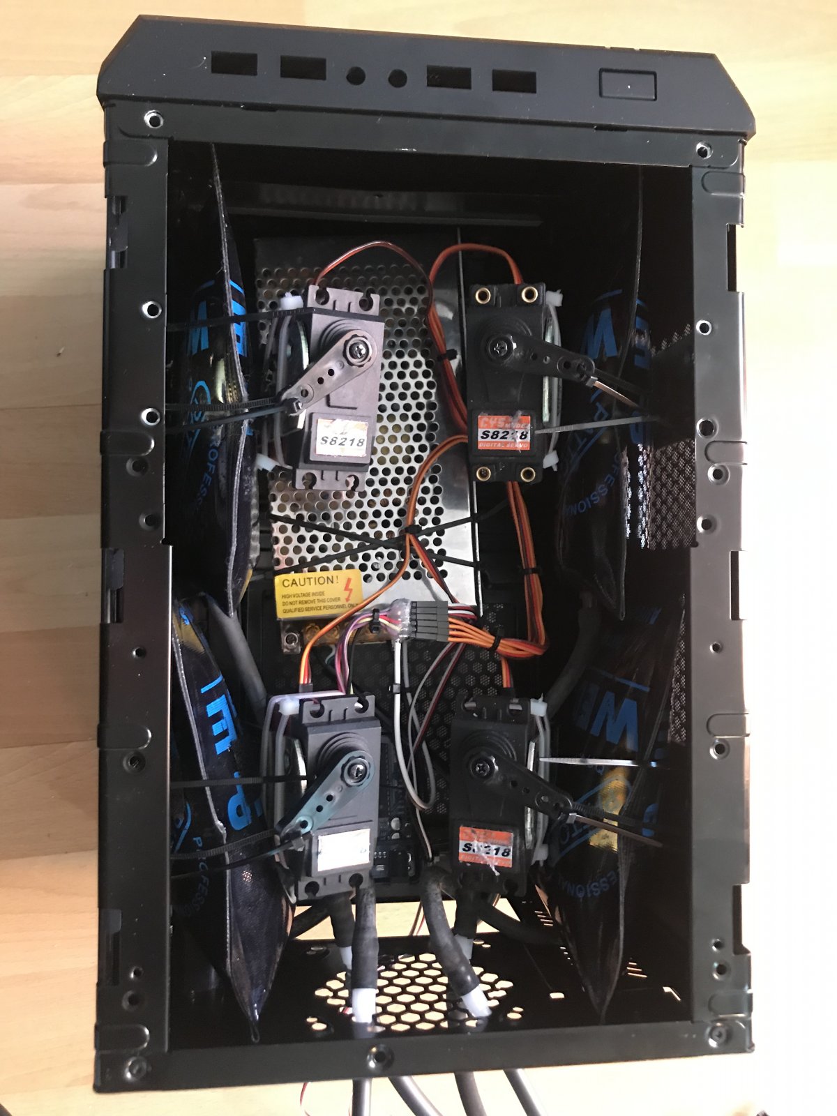

    I have installed my actuators for the G-seat in a PC case.
    and I am using a new Arduino code.

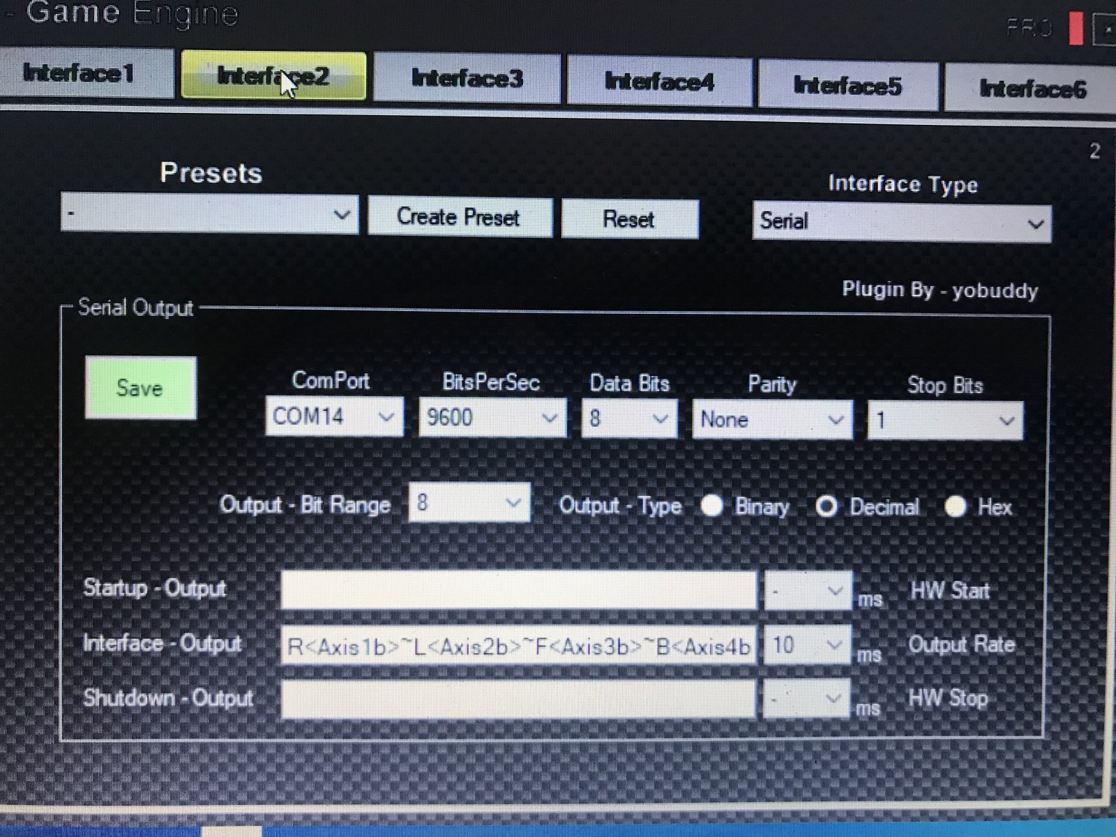

    Thanks for the suggestions. Email dof reality, was instructed to use the manual driver installations method. So far I have manage to go as far as installing preset in the tool tab in Simtools. But when I click on the tools tab, it show me an error code and disappear very quickly. Anybody experience something like this?

    Just managed to identify the problem by changing the computer name to standard English as it was on different language. by the way, is there a troubleshoot section for Simtools?
