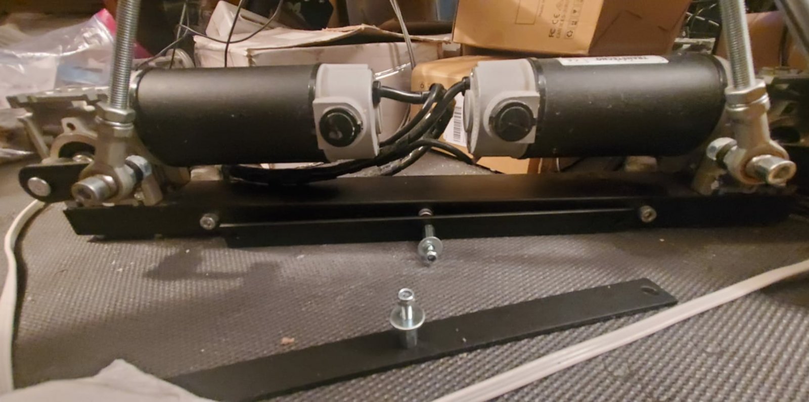

    Hello guys.
    Is there anyone here that has the 1st version of the dofreality P6/H6 and that is facing the same issue I have with mounting the 3rd Damper on each side ?
    What have you used to properly mount the 3rd damper (3 in total, 1 on each side) on your old version of the p6/h6 ?
    Unfortunately the solution has been given me to mount the 3 dampers, does not satisfy me/it puzzles me.

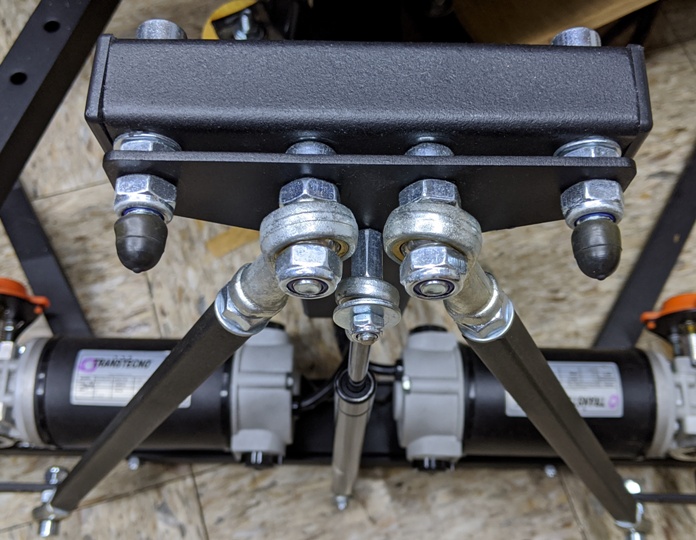

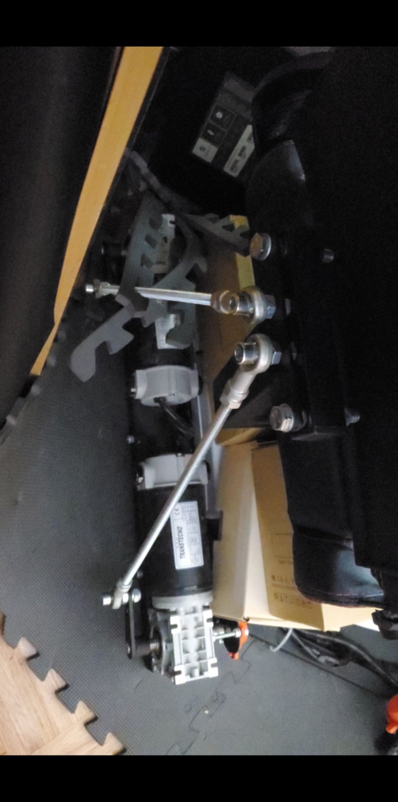

  14. Mousetrap
    Mousetrap New Member
    Aug 17, 2018
    14
    Retired EE
    Deep North of Minnesota, USA
    312Coins
    This is what my P6 looks like.

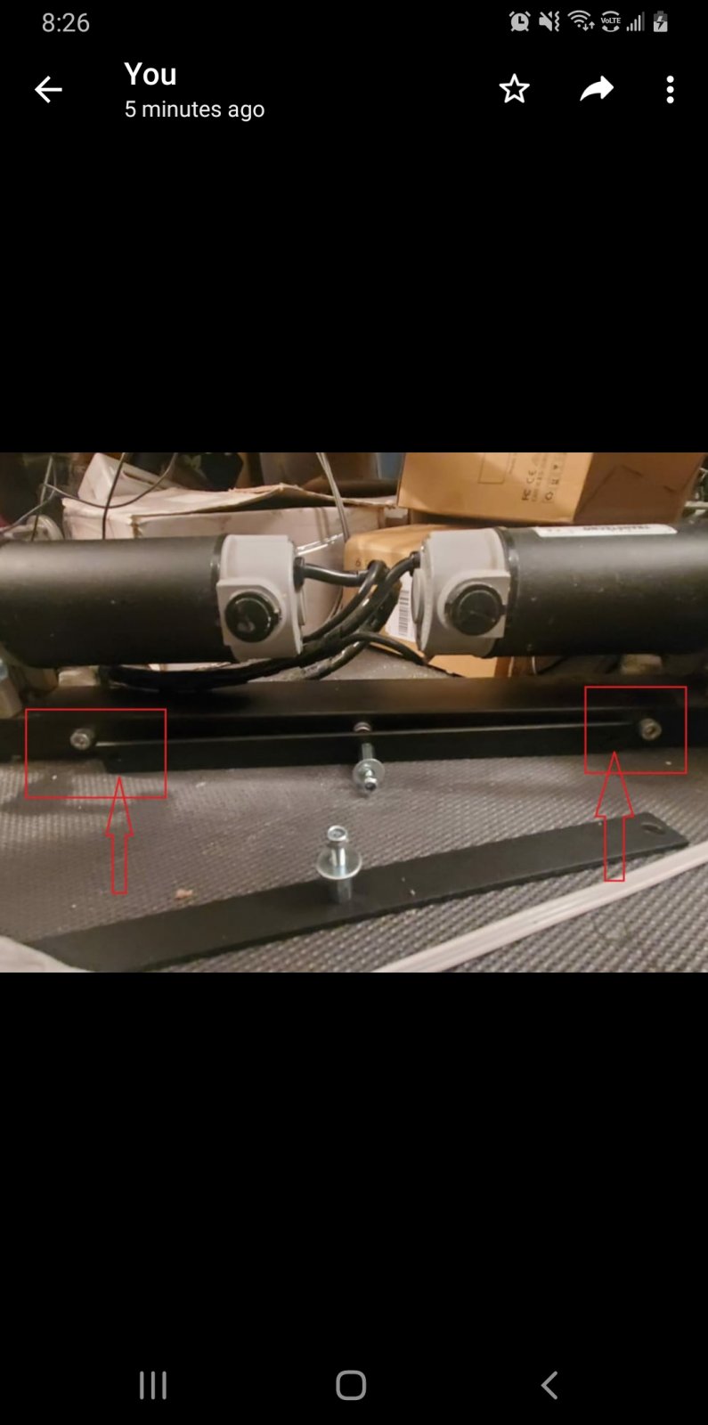

    Screenshot_20200822-205520_QuickPic.jpg Screenshot_20200821-202624_WhatsApp.jpg You have a later version of the p6.
    Mine does not mount the 3rd damper in the center.
    The problem with my version is how to connect the 3rd damper to the center bolt at the bottom of my frame.
    They sent me a bar that does fit only the new model of P6 (it is too short for my p6 - see attached picture) and then they sent me a screw that has a slack.
    If i would have understood back in time that this rig would have been such a pain because in need of DIY work on my end, i would have made diffefent choices.
    This is a still an ongoing issue for me, at least 3 months after I brought up that i had this issue
