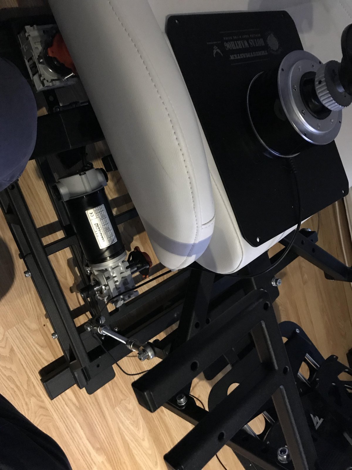

    I received my DOF Reality P3 Monday, I mount it, but I've some questions
    First of all, is there a tuto video of simtools setup?? I think that everything is working well ( at least when I test it on Simtools) but in a game (I tried P3D V4 and Aerofly FS2) the motion from the platform doesn't match with what it should be, and I lost the pitch motion, and at the moment it doesn't work on XP 11
    My explenation is that I surely mis understood the way that Simtools works and I'll appreciate if someone gots a video tuto of how to setup the Game Engine and Manager
    My other question is about the extra that I ordered for the flightsim use, it is suposed to handle my Warthog Joystick but I don't know how to put the Joystick on tht part, the only solution that I found (don't know if it's the correct one) is to drill my joystick, but it's sad to drill into this thing when default holes are present on the Joystick on each corners
    My last question is about the size of the screws and bolt for the Joystick and throttles, I don't know if it's a mistake or not, but for some parts I received more screws and bolts that I required and for some parts not enough, it wasn't a problem except for my Hotas, and since I'm a total noob for those kind of things, I'd like to know the dimensions that I need to attach the joystick and the throttles. I ask that because at home I have some other screws and bolts but none are the exact size of the holes and I want to be sure that I'll buy the correct one

  5. SEHATanguy
    SEHATanguy Member
    Sep 25, 2017
    42
    Belgium
    96Coins
    +7 / 0 / -0
    Here is the picture of the Joystick and the holes

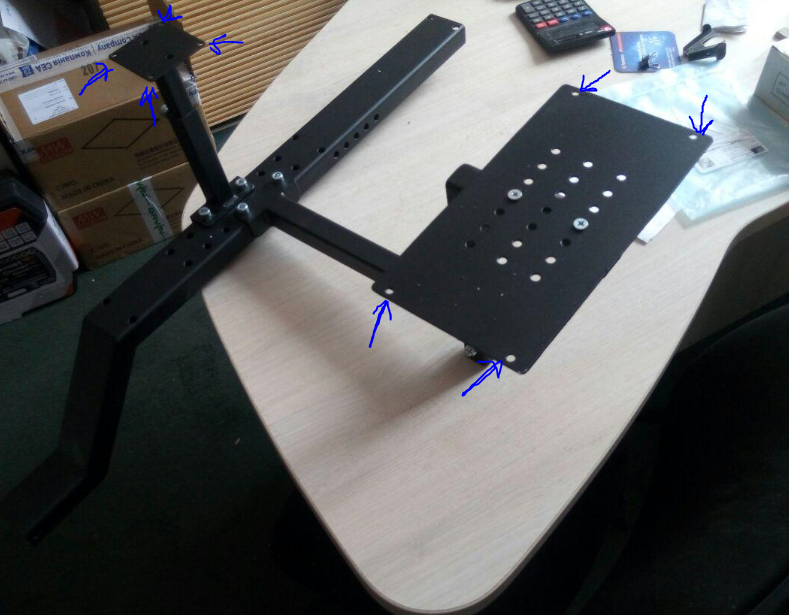

    Pls check attached pictures where we marked throttle and joystick mounting points.
    For the joystik use same bolts that it is mounted to its stand /pad. For throttle you need to check the length of bolts needed visually. You can also move throttle plate to any side.
    For the SimTools settings set one effect at a time, than check and add next one and check in game etc . Only when you done set general profile for the game.
