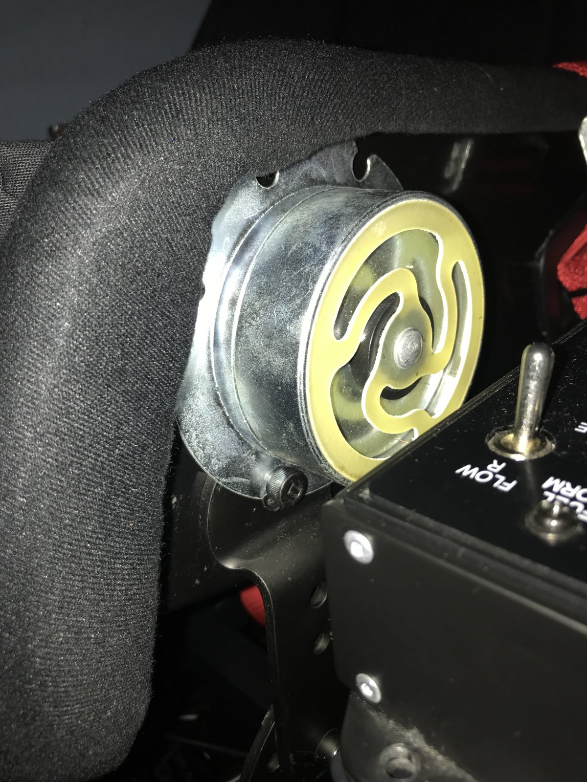

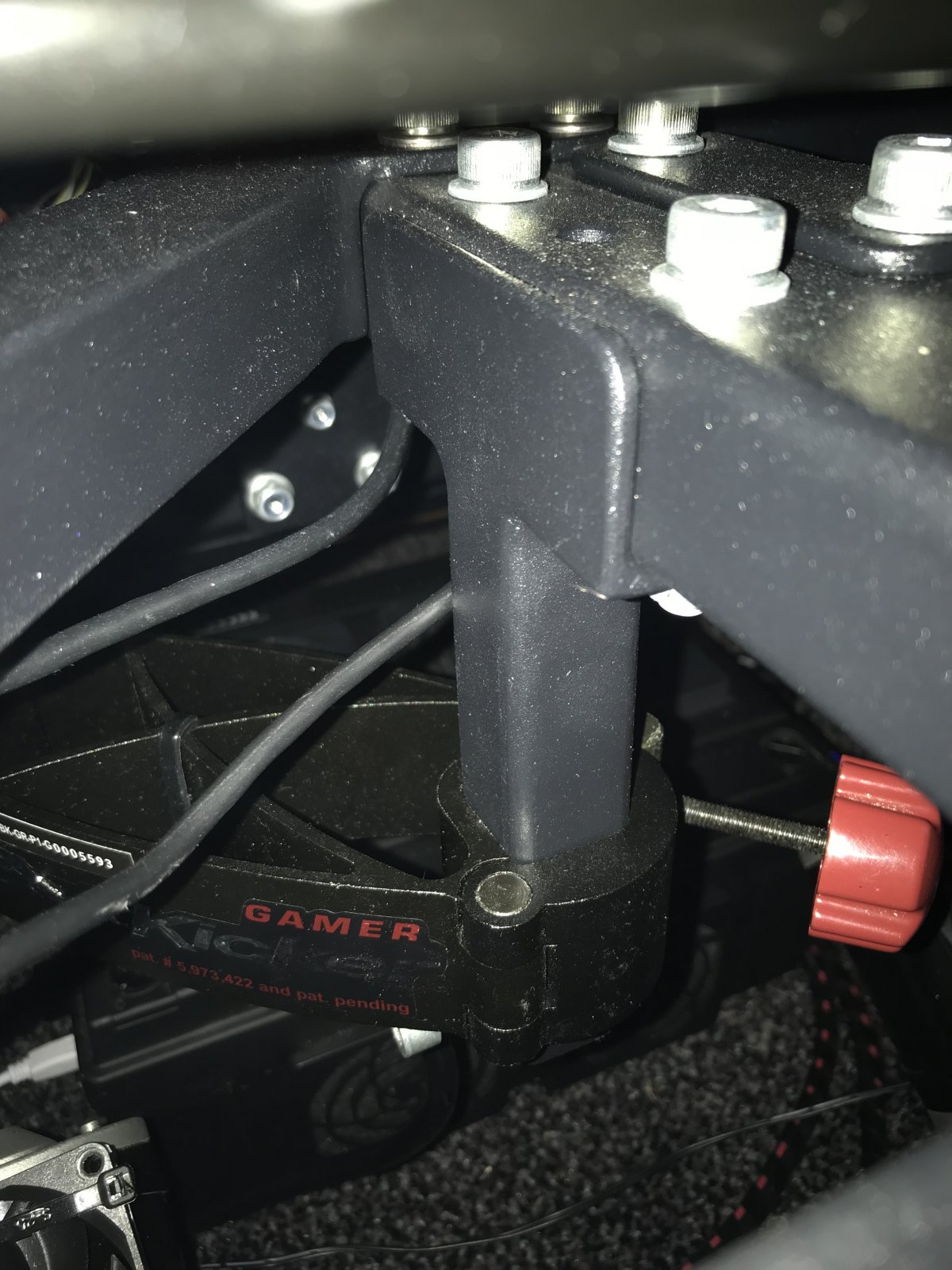

    So you do have both the transducers and the butt kicker mounted at the same time?
    What do you have for audio card inside your pc to connect to these devices ?
    I am not sure I understand instead what u use for the pedals and the wheel to add vibration to them.

    My P3 Is comming this week, and i already have 2 buttkickers and 2 lighter transducers.
    Maybe you can write down in the other forum how to built the G-seat?
    Whats the total cost and built time you think?

    Would you please share the locations where you will be mounting the 2 buttkickers and the 2 transducers, after you finish mounting/setting up your new p3?

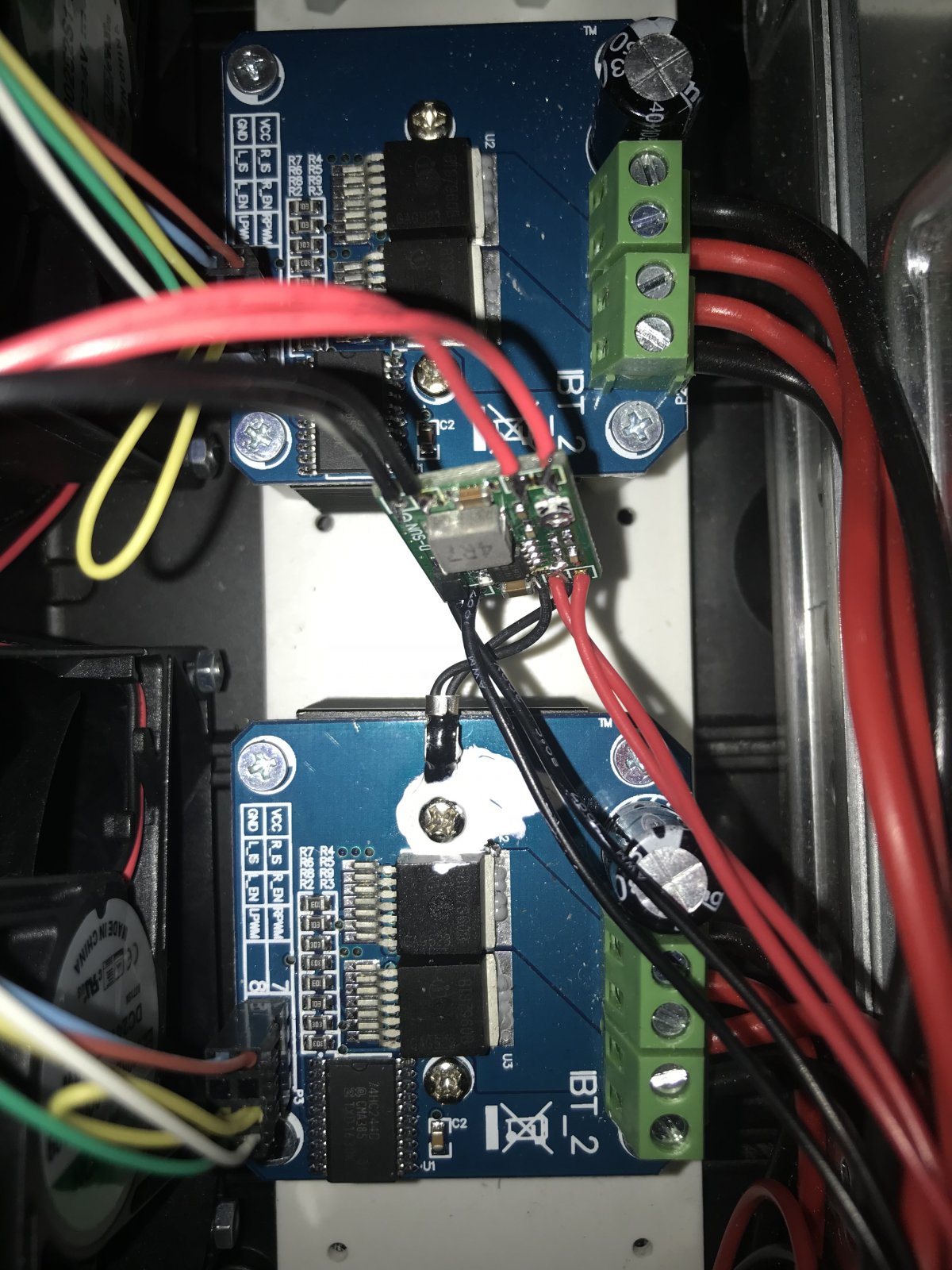

    I simply disconnected the leads from the power supply to the fans and soldered the temperature controlled regulator in between.
    Then attach the temperature sensor with thermal paste to a motor controller.

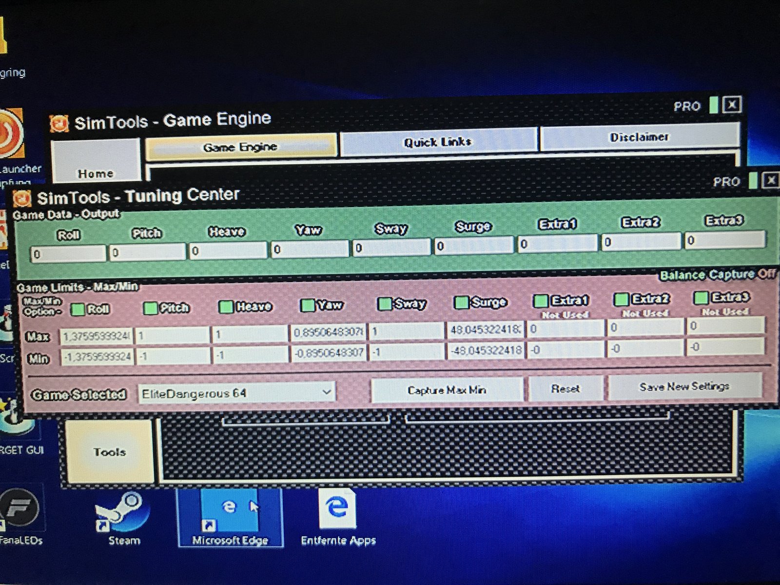

    Using SimTools
    I’m now learning how to use SimTools. It’s not the most user friendly software. I’ve read the manual and have been scouring these forums, but still have lots of questions. I’ll be posting some of them to get help.
