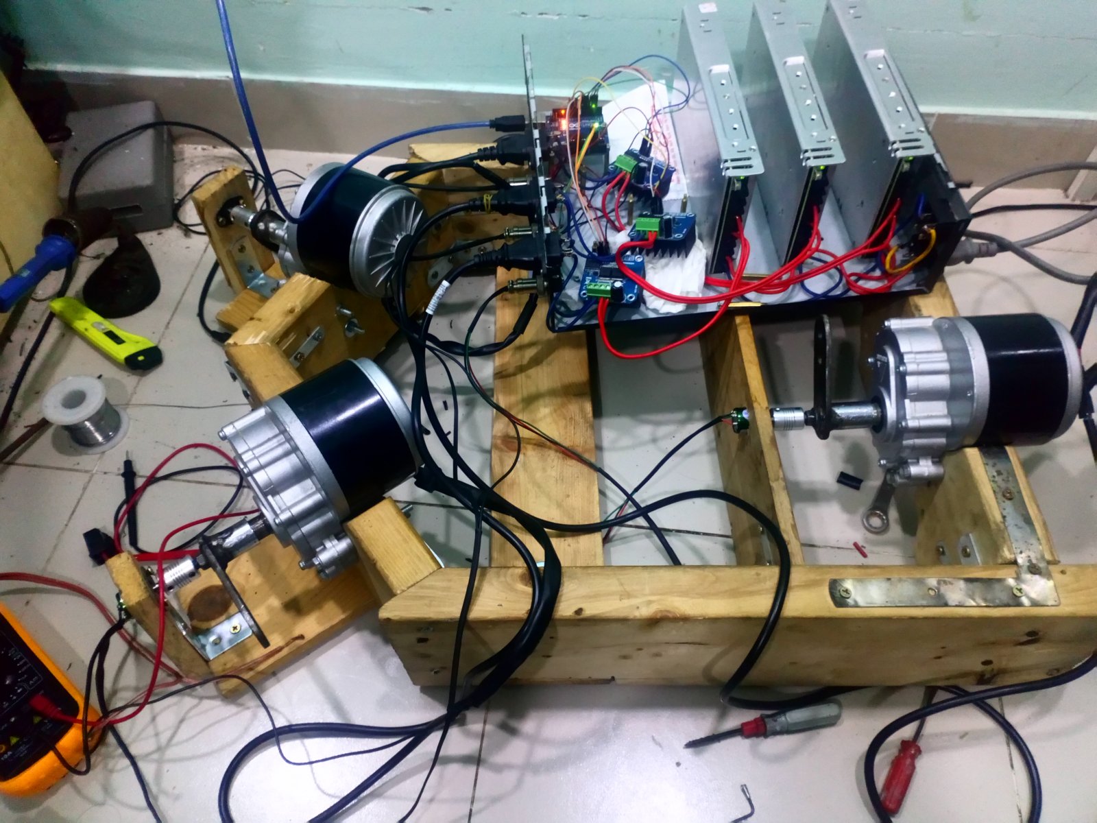

    Hi guys. after about a year of reading the documentation and asking a few questions on the forum. I did the same as above video but with wheelchair motor. I'm stuck at SMC3 and don't know what to do? ?
    motors 1 and 3 rotate in opposite directions and motor 2 does not work.
    when pressing "ON" 2nd motor, 3 motor rotates a bit and then turns off
    Hope everybody help please

    Rotating in opposite directions is likely a wiring issue.
    Can you please post pictures of all of your SMC3 settings.
    For the motor that does not work you can swap hardware between those that do work and those that don't work to try and pin the issue down.

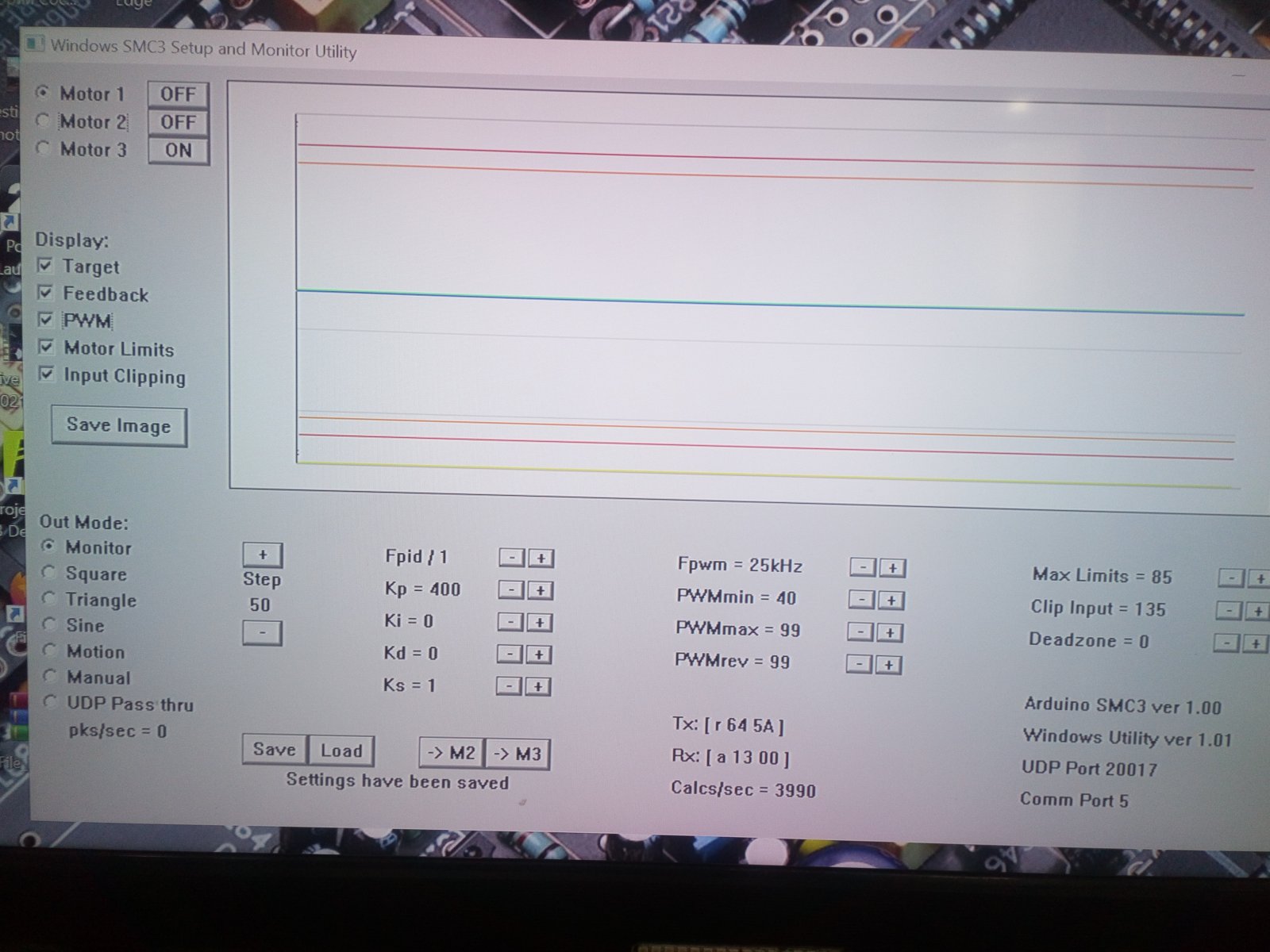

    When I disassemble the 3 sensors, is it normal for the 3 motors to rotate like that?
    -When attached, the motor rotates beyond the 5v threshold of the sensor, the motor turns off.
    - my smc3 settings

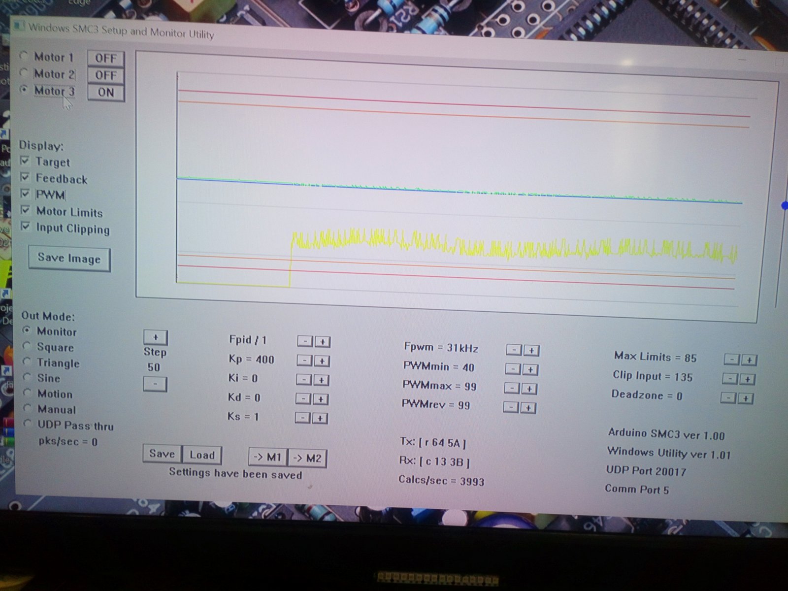

  10. luu trung
    luu trung Member
    Apr 4, 2022
    74
    160Coins
    +7 / 0 / -0
    my setting smc3 sensorless mode

    Seems like the motors are not staying within SMC3 boundaries, is that correct?

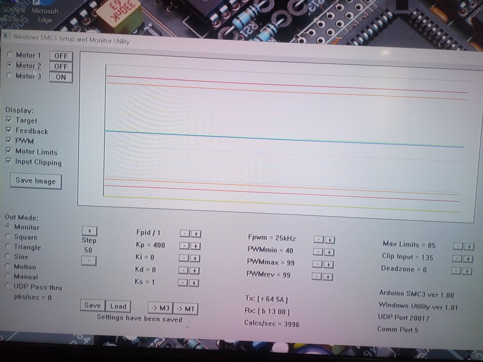

    I don't quite understand about scm3.
    Is it ok for motor number 3 to work like that?
    motor 1 and 2 when attached to the sensor rotate a bit and then turn off

    What is scm3 yellow line? it crosses the red line

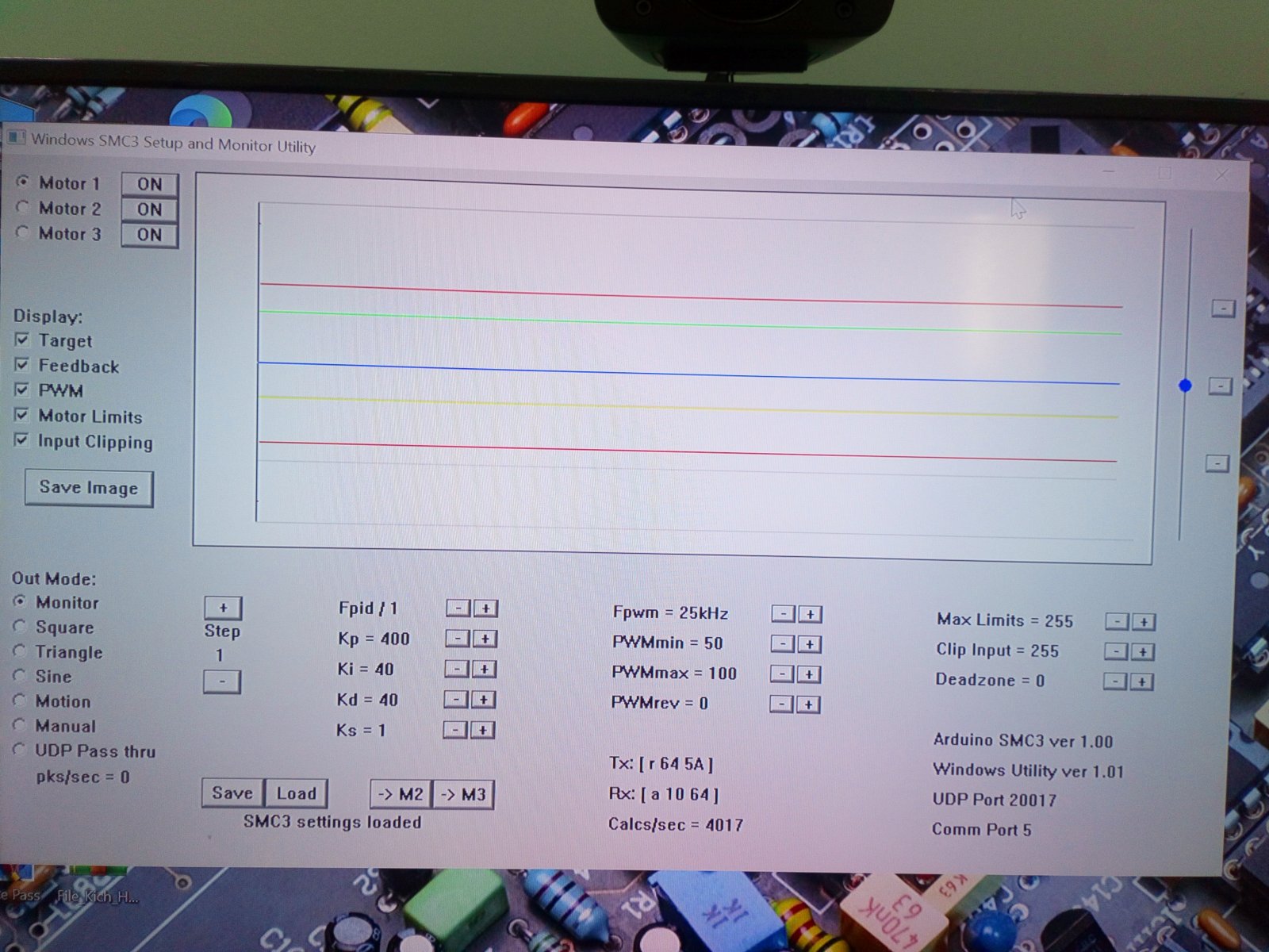

  19. luu trung
    luu trung Member
    Apr 4, 2022
    74
    160Coins
    +7 / 0 / -0
    hi. can you explain why the yellow line of motor 1 and 2 is at the bottom. Not in PWMmin and PWMmax. only 1 motor number 3 is in the PWMmin and PWMmax region
