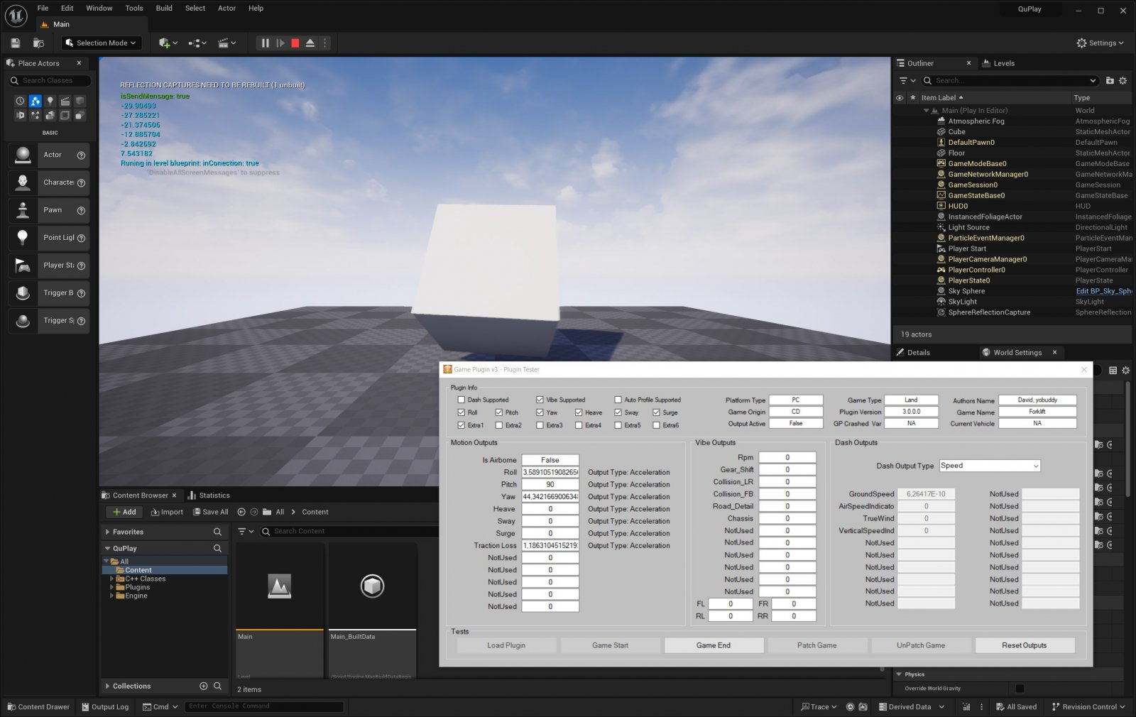

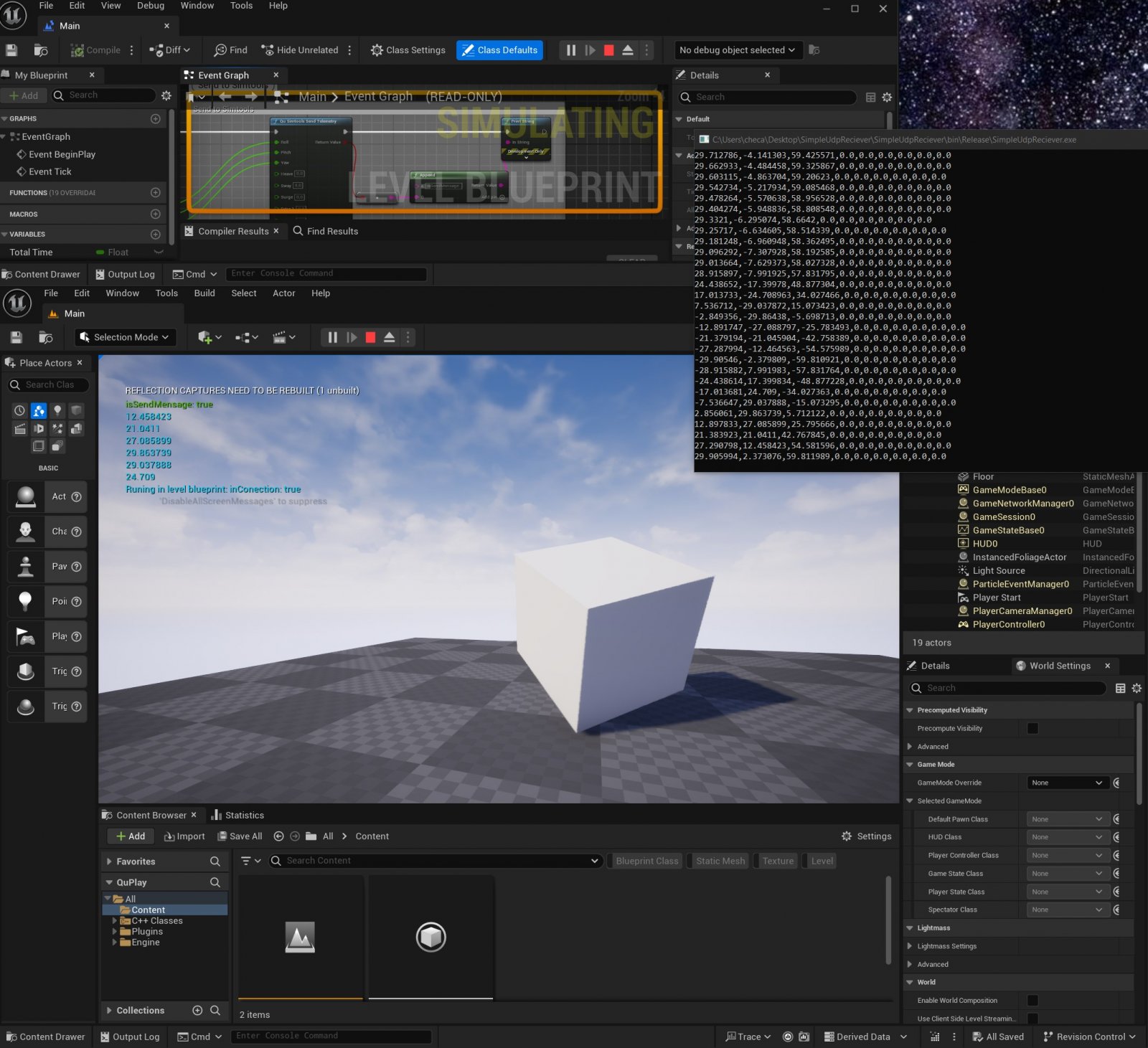

    @yobuddy Hi, I am also interested in the binary receiver application. I have migrated tupluging from unreal to ue 5.3 and i have tried with the simpleudpreciever and it is sending the data fine. I have tried with the DirtRally example v3 plugin, and it receives the data but I don't know how to wrap it to display the data correctly. Any example where to see how to modify the dirtrally plugin to correct show what ue4 sends?
