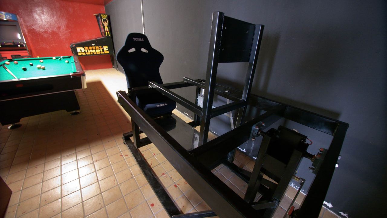

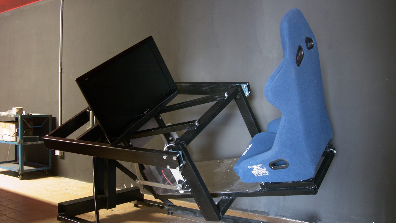

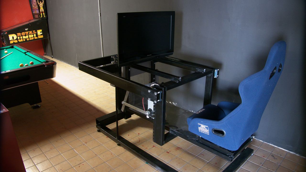

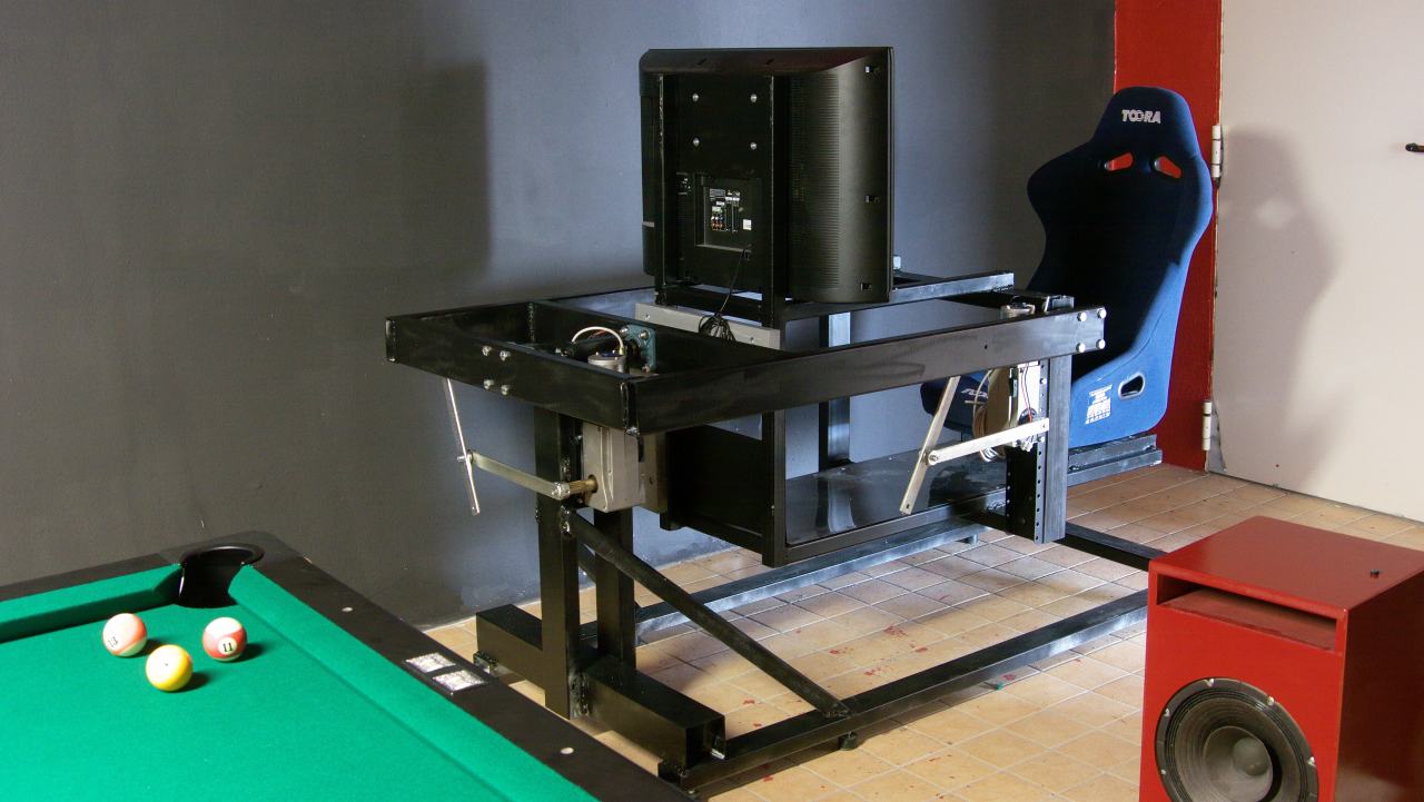

    I have lurked for some months on this forum and i have seen a lot of fantastic projects from the forum members.
    I'm a mechanical engineer, 35 years old and i live in San Marino.
    I have a great passion for videogames and for mechanics so i think i'm in the right forum. :D
    This week i was on holiday and i decided to start my project.

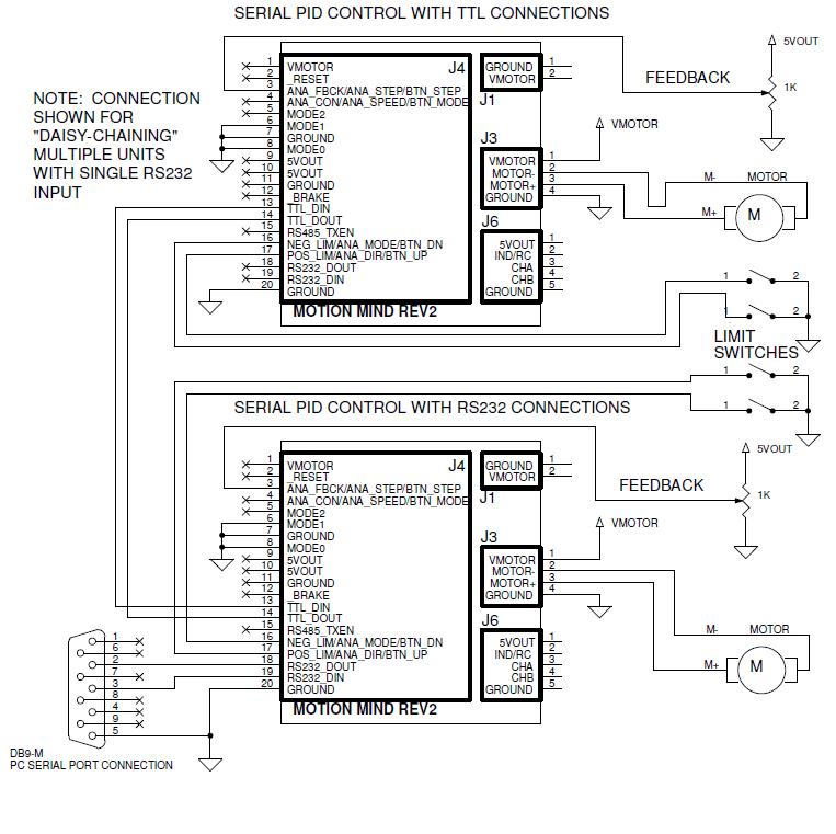

    The project is for a 2 DOF simulator with 24V DC gearmotor ( 100W, 1:1000 reduction) with magnetic encoder by
    http://www.fromautomazioni.com and electronic from http://www.solutions-cubed.com.
    I have tested gearmotor and electronic control board out of the simulator frame and it works smooth after some hours of fine tuning.
    I have spent today for balancing the system and now it's quite good.
    Now i need some days to wire the motors to the control units and to build the 24V power supply because the one i have it's too small to supply 2 gearmotors at the same time.
    I have taken some photos :

    Great job so far :clap:
    Regarding your MaxDamage Simulator... is that blood on the tiles? I hope you havent lost any extremities during the testing :D
    If you dont mind, please tell us some more about the electronics which you are going to use. Which motor controller (not driver) exactly?

    First, the mechanical design is excellent! :thbup: :cheers:
    Very clean and stong, although I would like to see it flex with 150kg in it.
    The controller??: http://www.solutions-cubed.com/Solution ... /MOTM3.htm

    the sim is not yet finished , i'm supplying the gearmotors with 16 volts instead of 24v because
    i have not yet found the correct power supply.
    I have to change also the scissors linkages that connect the gearmotor to the frame with
    a more stiff one, the ones are installed now are blending a little.

    It's very easy, the string is for axis 1 :
    p01 ~a01~ ~13~~10~
    and for axis 2:
    p01 ~a02~ ~13~~10~
    You have to set 19200 baud for the speed of the RS232 and all works.
    Be carefull, you have to use gearmotors with quadrature encoder with MOTM3.
    You need a little tuning of parameters of PID but in less than an hour i had
    the system working with the gearmotors i buyed that have quadrature encoder.
    I use 2 serial port to control the 2 MOTM3, but it's possible to use only 1 serial
    and connect more MOTM3 eachother with a special bus so you send the
    command to the first MOTM3 with the serial port and it route the command to
    the other MOTM3, you have only to send the commands :
    p01 ~a01~ ~13~~10~ for axis 1
    p02 ~a02~ ~13~~10~ for axis 2
    p06 ~a06~ ~13~~10~ for axis 6
    It's useful if you have a 6DOF system and you miss 6 serial port on the PC.

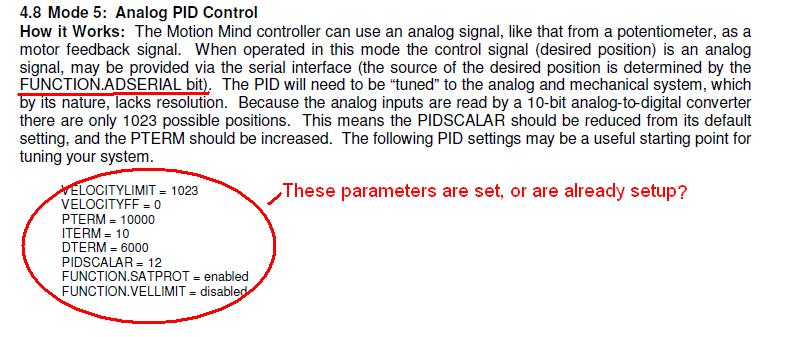

    I have another question, reading the datasheet I see that you can use a potentiometer as position feedback, to use a potentiometer as feedback I have set the MOTM3 in mode 5 and set the FUNCTION.ADSERIAL function and other parameters, I set them to enter in binary mode?
    or should I set them?
    if I wanted to create a configuration like this my string use could stay like
    p01 ~a01~ ~13~~10~
    p02 ~a02~ ~13~~10~
    could you post the specifications of the engines and their cost?
    maybe some pictures.
    :clap: Congratulations for your project :hi:
    many thanks for your patience

    Yes you can use mode 4 with encoder but you can use mode5 with FUNCTION.ADSERIAL bit ON so you can
    use p01 a01 13 10 on the serial and use potentiometer as feedback with a 10bit analog-to-digital conversion.
    I think that in the last firmware you can use more than 10bit for the conversion.
    You have to choose the values for PIDSCALAR, ITERM, DTERM, there is a tutorial in the manual to calc
    this values at first approximation, then you can tune the system, a thing of 1 hour in my case.

    The dimensions are 1000x2000x1400 (heigth) mm, it weights about 140 Kg.
