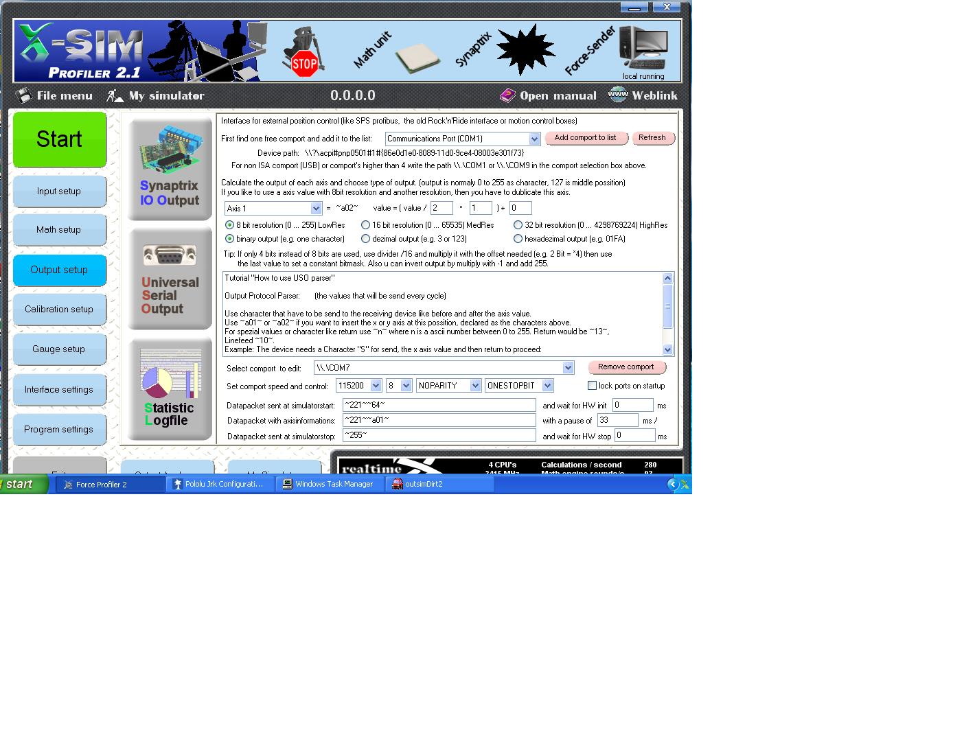

    I have a motion loss issue on axis1 (roll) of my sim. I running 2 pololu jrk 12v12 boards (1 each motor). As you can see from the attached photos I have the settings right - I think.
    This is what happens. Either playing GRID or DIRT2 after about 30 seconds into a game, I loose motion on axis1 (roll, lateral force). There is no errors , the frame stays upright. On axis2 (inside-seat) I still have motion. If I go into the math, delete axis1 motion and replace it , it works - for about 30 seconds. I have tried different settings with no luck.
    I though it might have been a codemasters game problem. Perhaps not, when I play rfactor after about 5-6 minutes, I loose motion again on the roll axis1. Once again if I go into math and replace the setting it works again for another 5 mins or so.
    This is something I hope someone can assist me with please. I am not sure what is happening. I am running the latest version of x-sim, windows xp serv pack 3. And when I game all firewalls and antivirus are off.
    Thanks, David.

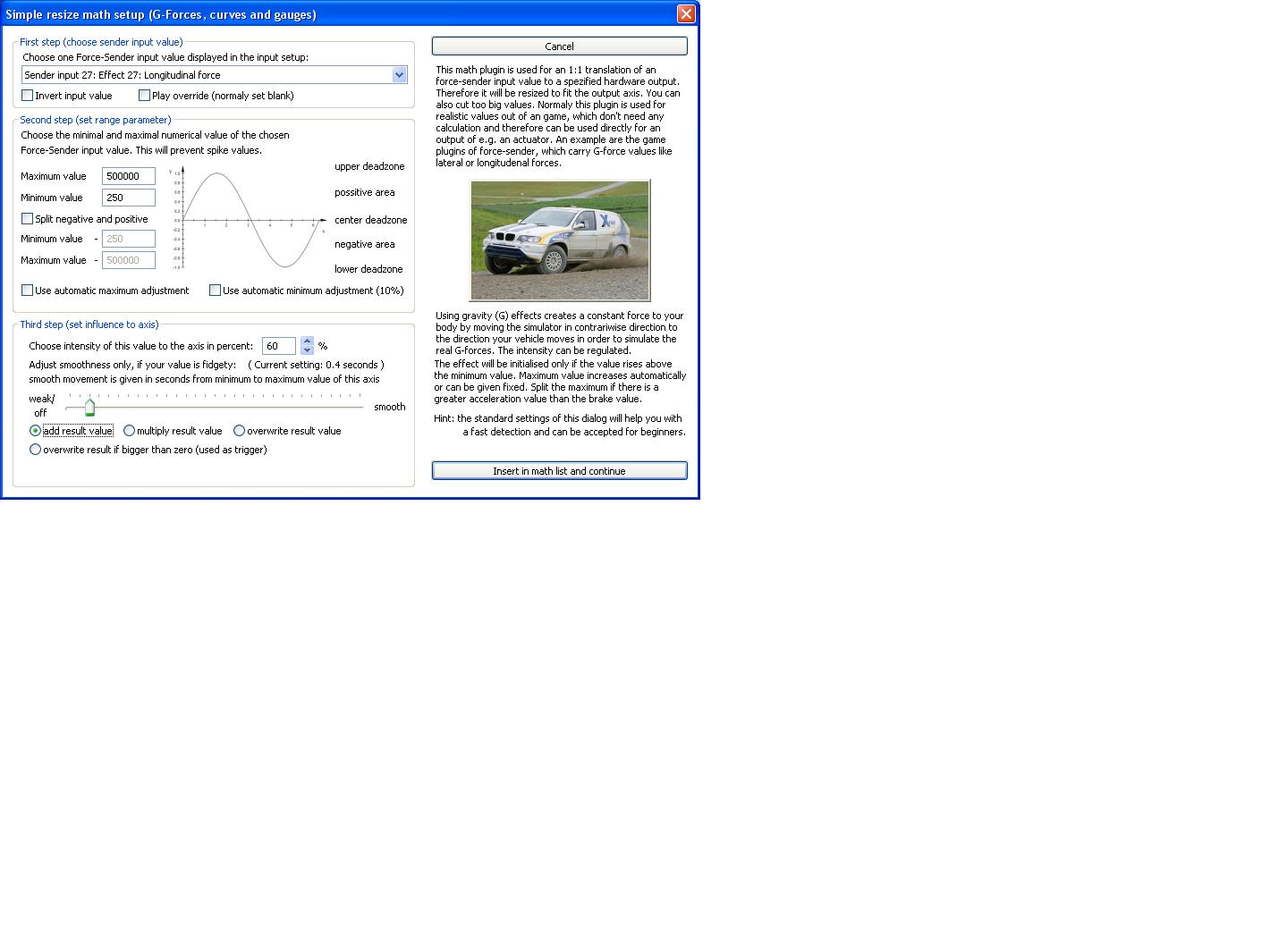

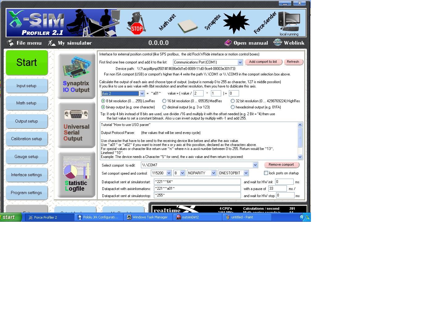

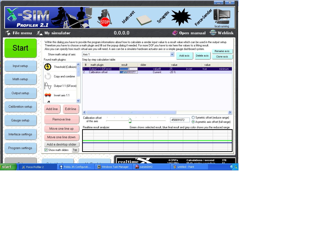

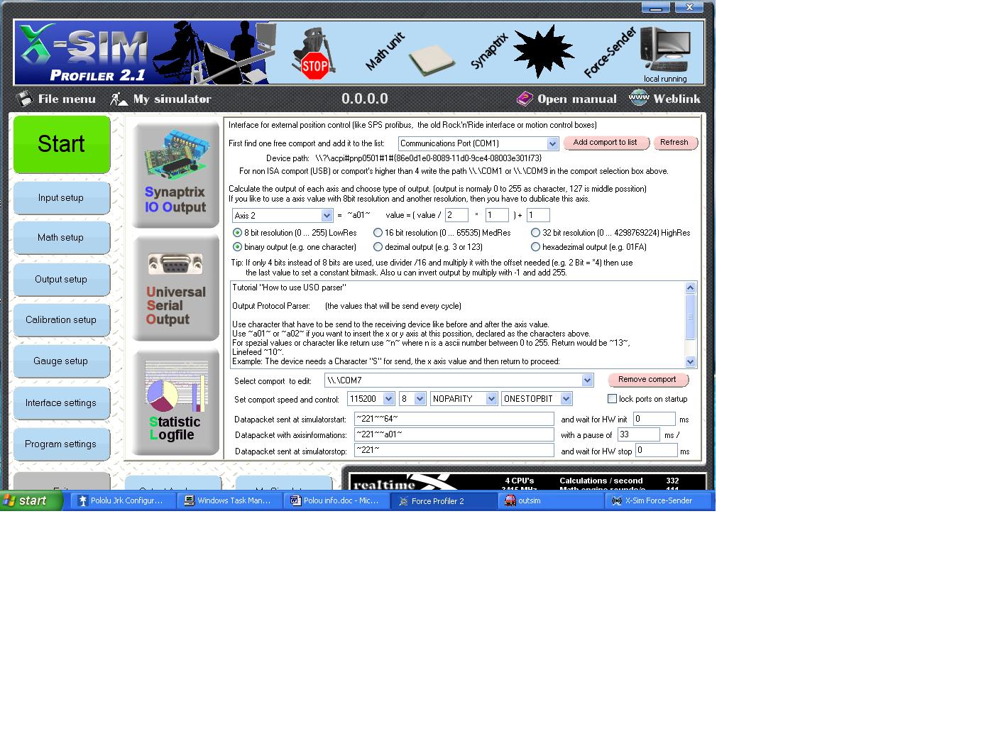

    Woohoo!!! :yippiee: got DIRT2 and GRID working!! I had to set my own values in the math section. This stopped the motion loss problem. More mucking around getting the settings right but it worked! I also changed the datapacket at simulator stop number to ~221~, and the value changed to 2-2-1. I do not know if this helped though. GRID sometimes still crashes when I go from a race back to the main menu. Dirt2 works fine. The pc seems to handle the lot fine. I run GRID at full stick graphics, which puts a reasonable load on the cpu.
    See pics.
    I am loading videos of game play, of the 8 year old kid and the 37 year old kid playing. I will link them in an hour or so.
    Aldoz, yes the fan next to the board works well, no overheating, that and I have fans on the motors. As for a heatsink, I used a piece of aluminium I cut in half, put thermal paste on the big chip and sort of secured it with some sealant on the side. It works. A proper heatsink would look better. I do not have a thermal probe. I use the finger temp probe. :rofl: For CPU, I use core temp and it registers the temp via a diode in the motherboard. FY useless info, my cpu have a BIG cooler on it with two 90mm fans on it. It will still get up to 60 deg c . The computer being in a proper gaming case helps. I have an ANTEC 902, good cooling.

    you write the value changed to 2-2-1 but in the attached pic I can see 2-1-1
    And in the datapacket at simulator stop so if you use just 221 so you do not get anything.
    221 is the command that move the motor in a certain position.
    255 is the command that put your platform in STOP mode (this is what I know)
    If you use just 221 so your command missing the where I have to put the motor?
    ~221~64 (put the motor in half position)
    ~221~128 (put the motor in highest position - max platform height)
    ~221~0 (put the motor in lowest position - min platform height)
    Good to see your cooling system works fine as your finger probe too (maybe not too precision but work!) :D

    Profile Making 101: When you have automatic maximum adjustment enabled, it will do just that. As soon as you crash the car, your maximum values will shoot up to 10G+, under normal circumstances 2-3G is the effective range of most cars. Increasing the maximum value effectively scales down the movement.
    Proper way to do it: Drive the car around the track once without crashing, auto max enabled and find maximum g-force for car. Disable auto max and increase maximum by 10-20%, then adjust intensity with sliders.
