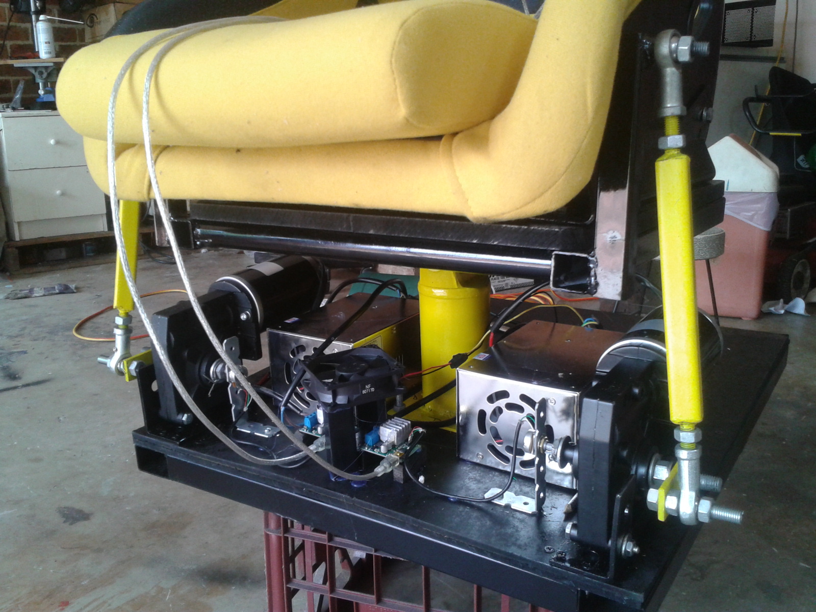

    I run 60:1 for the 2 front motors and 25:1 for the singal heave engine. I have only ever had issues with one specific 60:1 gearbox, the other is as good now as it was when it was purchased. I have changed the problematic 60:1 and have not had issues since.
    Mine is a 500x500mm base, which is very compact, but I think you would want more design leverage than I run if using wiper motors. Honestly if you have one shot at a good sim then you would be much better off with a shoulder or foot mount design where you can maximise the leverage.

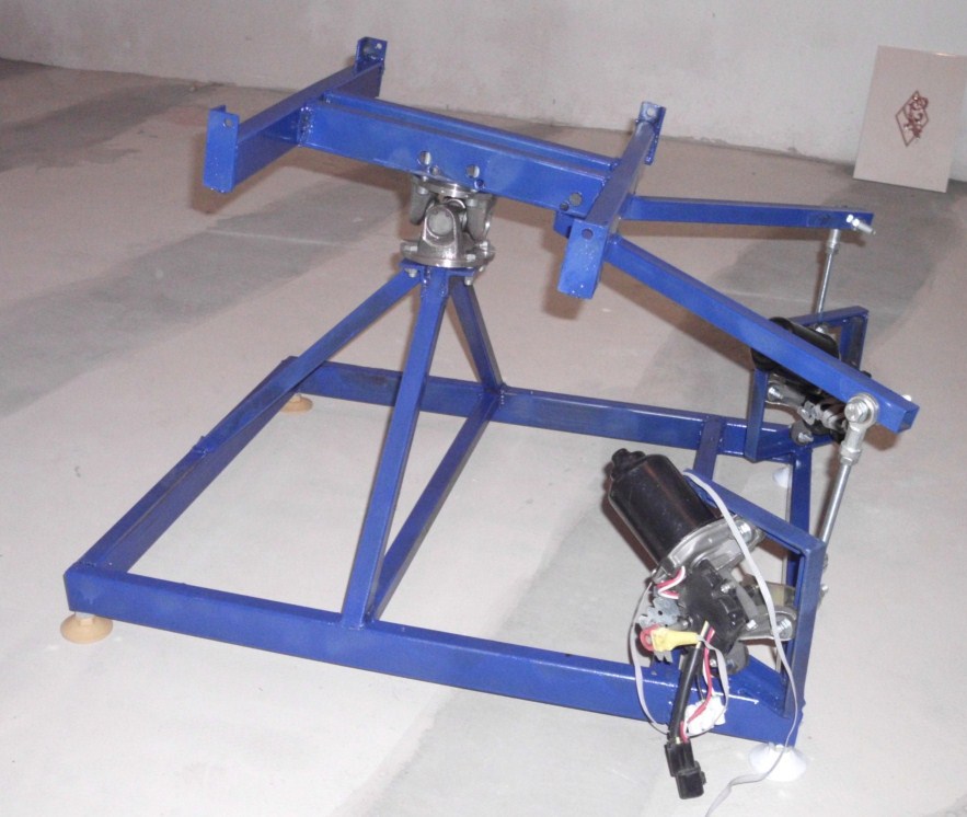

  7. bsft
    @Nacho , Id suggest more a desk racer mount, with motors connecting higher up the side and make a seat mover.
    to help the wipers work better,

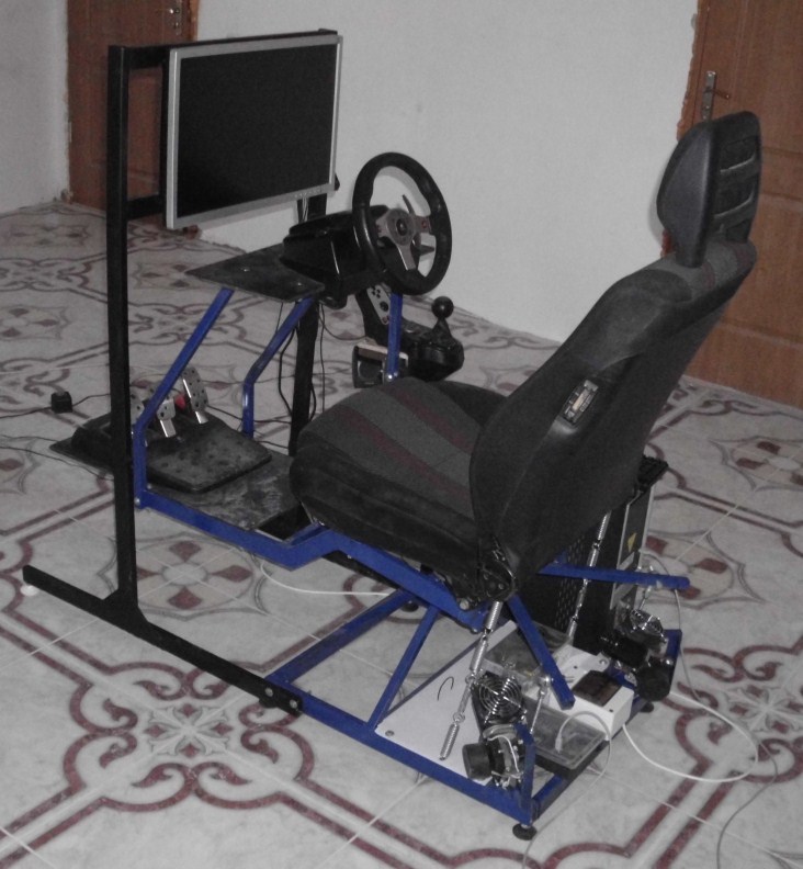

    Thanks for you suggestion (I will have it in my mind). Picture is taken from web. Here other pic (not is my proyect, but is my way):

  10. bsft
    @Nacho , if you are planning full frame, mount the motors near the feet, you WILL have better efficiency from the motors than whats pictured
    Suggestion
    And do not use springs
