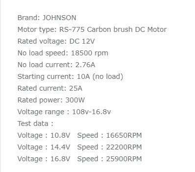

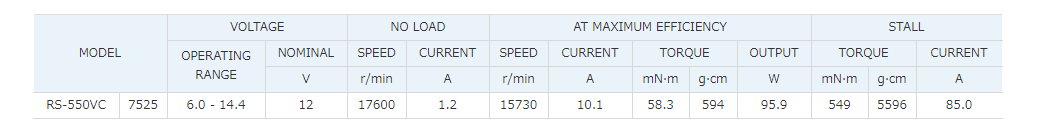

  6. WatchDoge
    WatchDoge New Member
    Jan 29, 2020
    15
    158Coins
    For example lets take Mabuchi rs-550-vc-7525 , Or Johnson rs-775
    Johnson has rated current lower than my PSU , im still confused about Stall current , in my mind if force feedback is working the motor is not spinning , trying to move , so that makes me think it s producing maximum torque and current , running on stall current , so im still little confused about all that Rated and Stall current thing
  7. Sieben
    Sieben Active Member
    Nov 6, 2018
    395
    2,240Coins
    +115 / 2 / -0
    Stall current is another motor spec. It does not mean that motor shall have that amperage to be powered with. At all.
