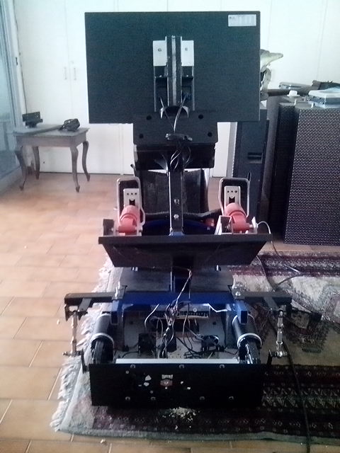

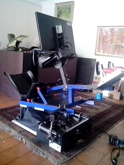

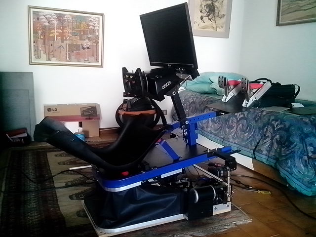

    :uups: wow! ... I spent so much time concentrating on my simulator build I had not realized that there was a new software to control the simulator! ... where I can download the simtools?? ... I'm a little confused :? .... is used alongside simtools xsim software? or software that is used alone?? ... where I can get information?? .... Here I show you some pictures of the progress of my simulator, paint it blue to look like the formula 1 redbull, and pedals put them in an elevated position to simulate driving a f1, I would like your opinions to see if I on track in the design! :highfive:

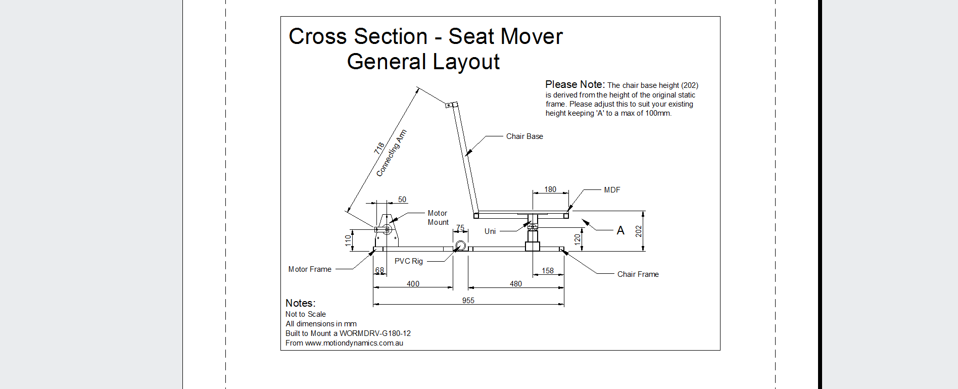

    Im currently running Jrks withs a Seatmover in V3, I have been running Jrks since 2009 and was responsible for bring them to the site. I have built 9 different combination with the Jrks.
    Latest is a seat mover running big worm gear motors to show sim racers that for $800 dollars they too can jon in the fun and keep their beloved static sim part of their new motion sim.
