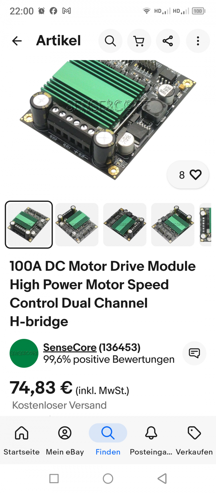

    Hello, I am a new member and am looking into the topic of race simulator because I want to build one for my son. I have ordered most of the parts such as wheelchair motors and power supplies, I already own the Arduino, motor drivers and potentiometers. I came across the following motor driver on Ebay: Screenshot_20241201-220010.png
    Can someone write something about it or does anyone know if there is already a compatible Arduino sketch for two motors?

    Oh thank you very much!!!
    I'll buy one, they seem to be really good

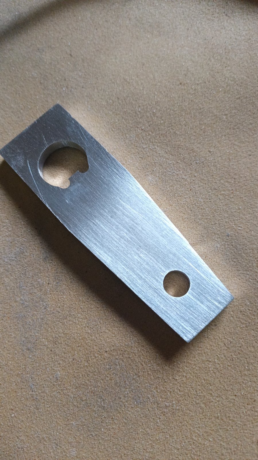

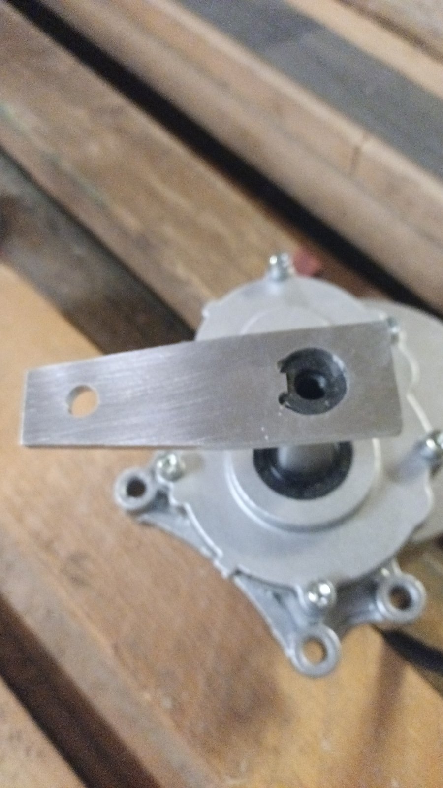

    I hope my 250w, 24 Volt wheelchair motors will lift my construction, with mounted pedals, chair and steeringwheel IT hast a lot of weight...
    What arm length should i use? I would try 5cm first...

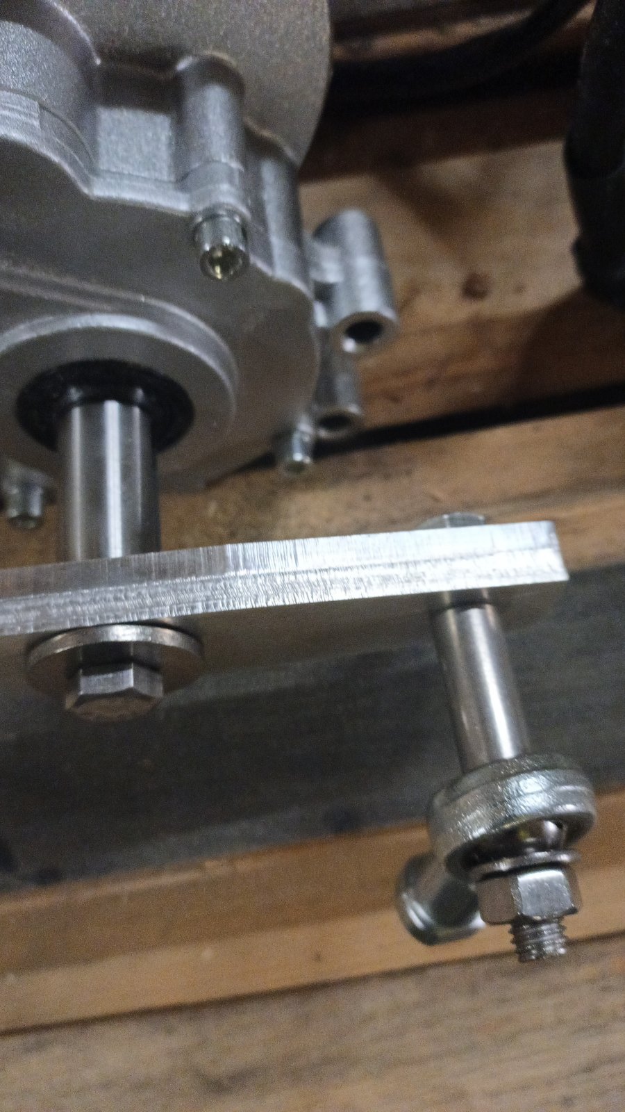

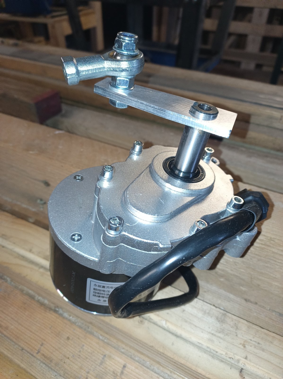

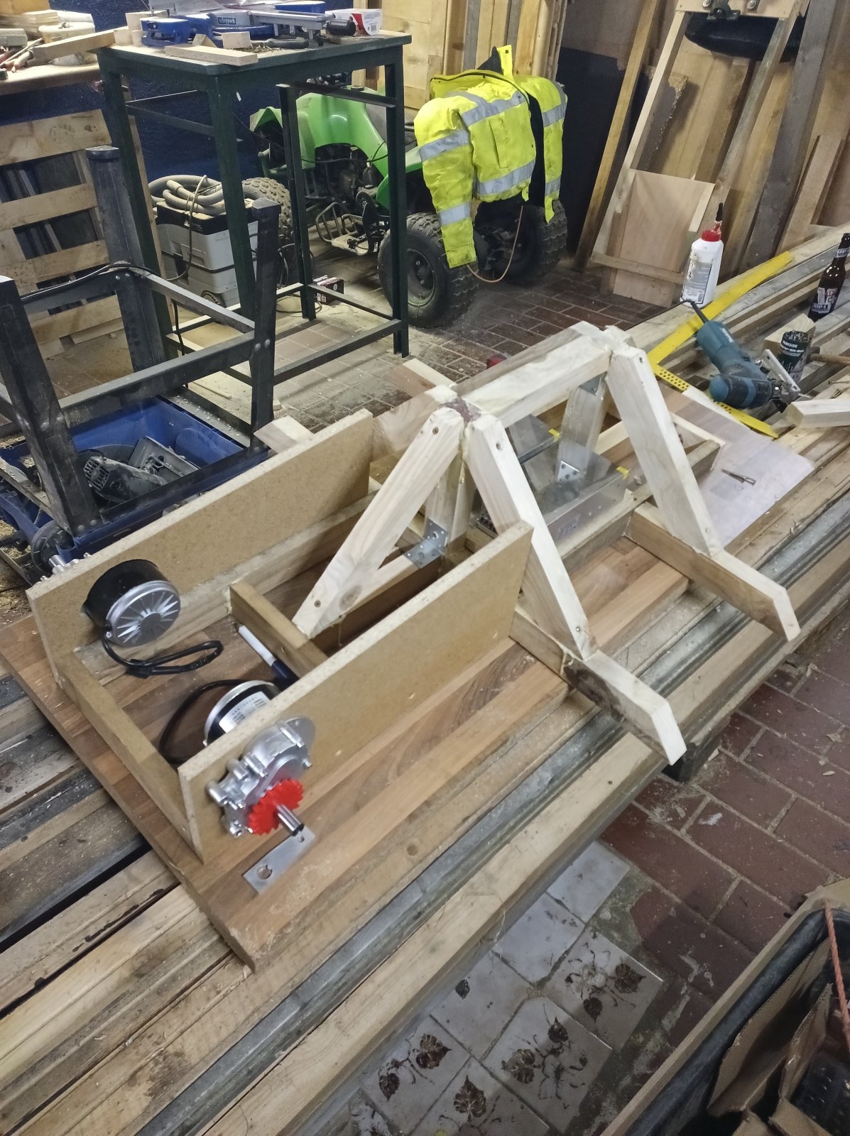

    This ist my idea so far...
  8. Stahlwolle
    Stahlwolle Member
    Nov 28, 2024
    54
    268Coins
    +11 / 0 / -0

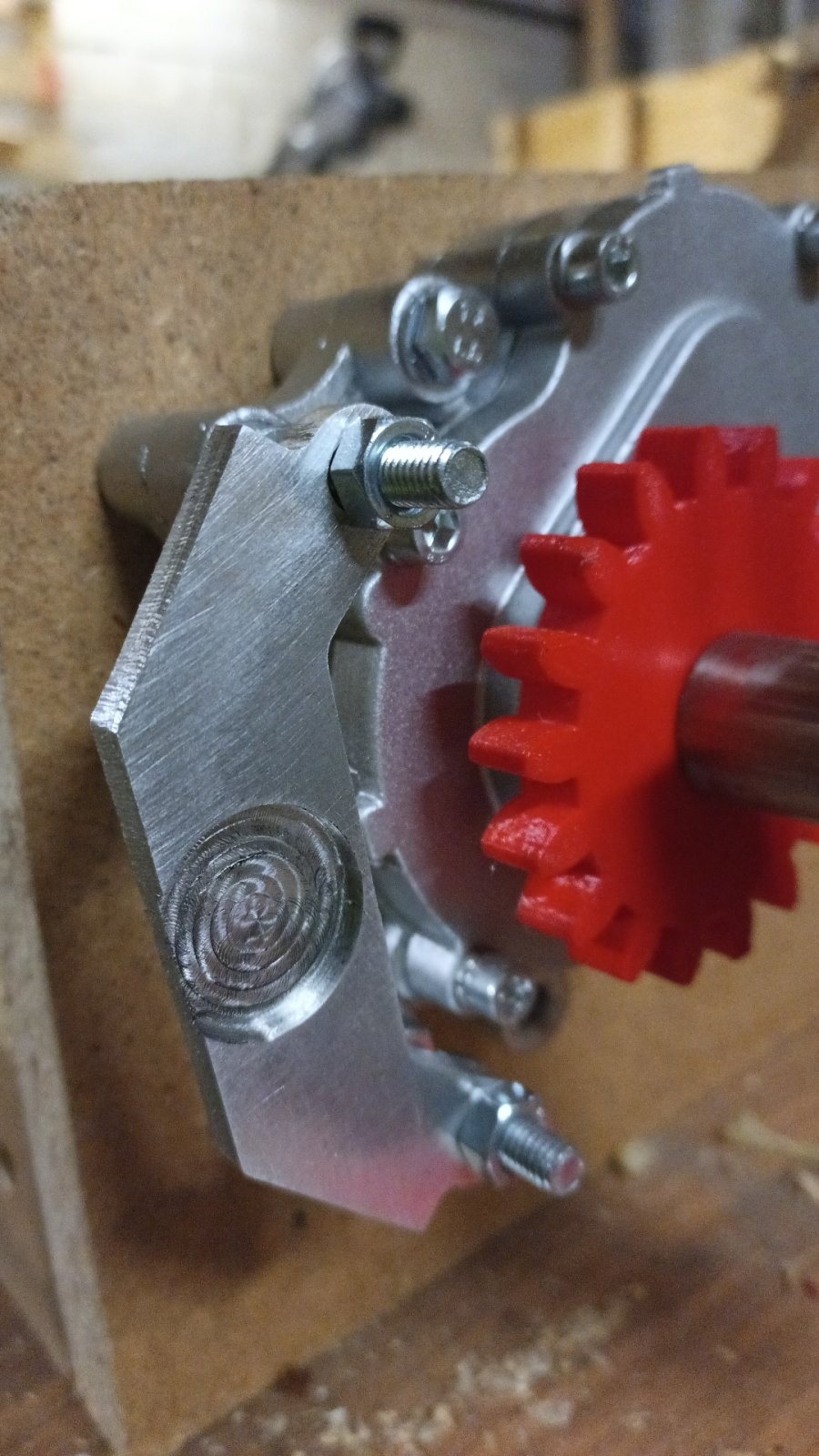

    Did them with my CNC, 5mm Aluminium

  10. Stahlwolle
    Stahlwolle Member
    Nov 28, 2024
    54
    268Coins
    +11 / 0 / -0

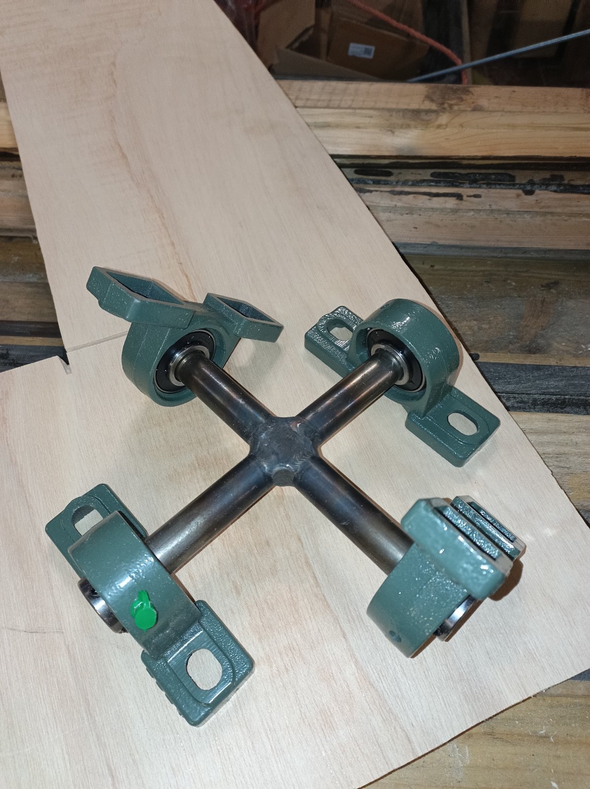

    I just had the same idea and milled two more. I had a friend weld something for me as an axle.
  11. Stahlwolle
    Stahlwolle Member
    Nov 28, 2024
    54
    268Coins

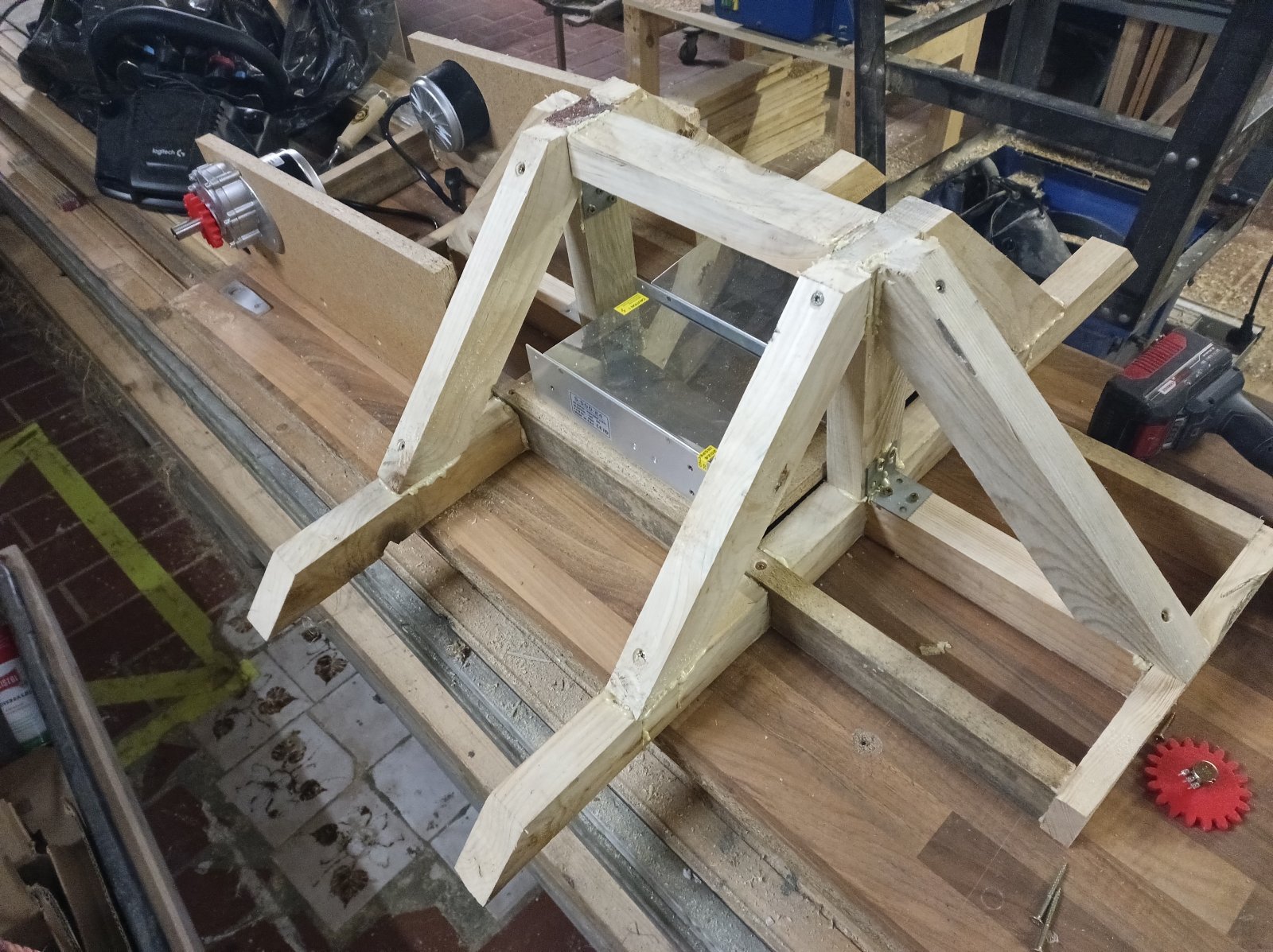

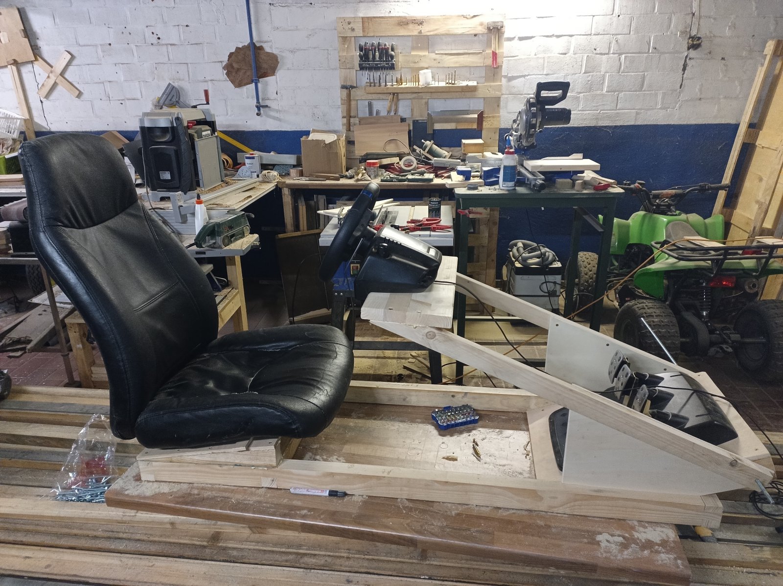

    +11 / 0 / -0

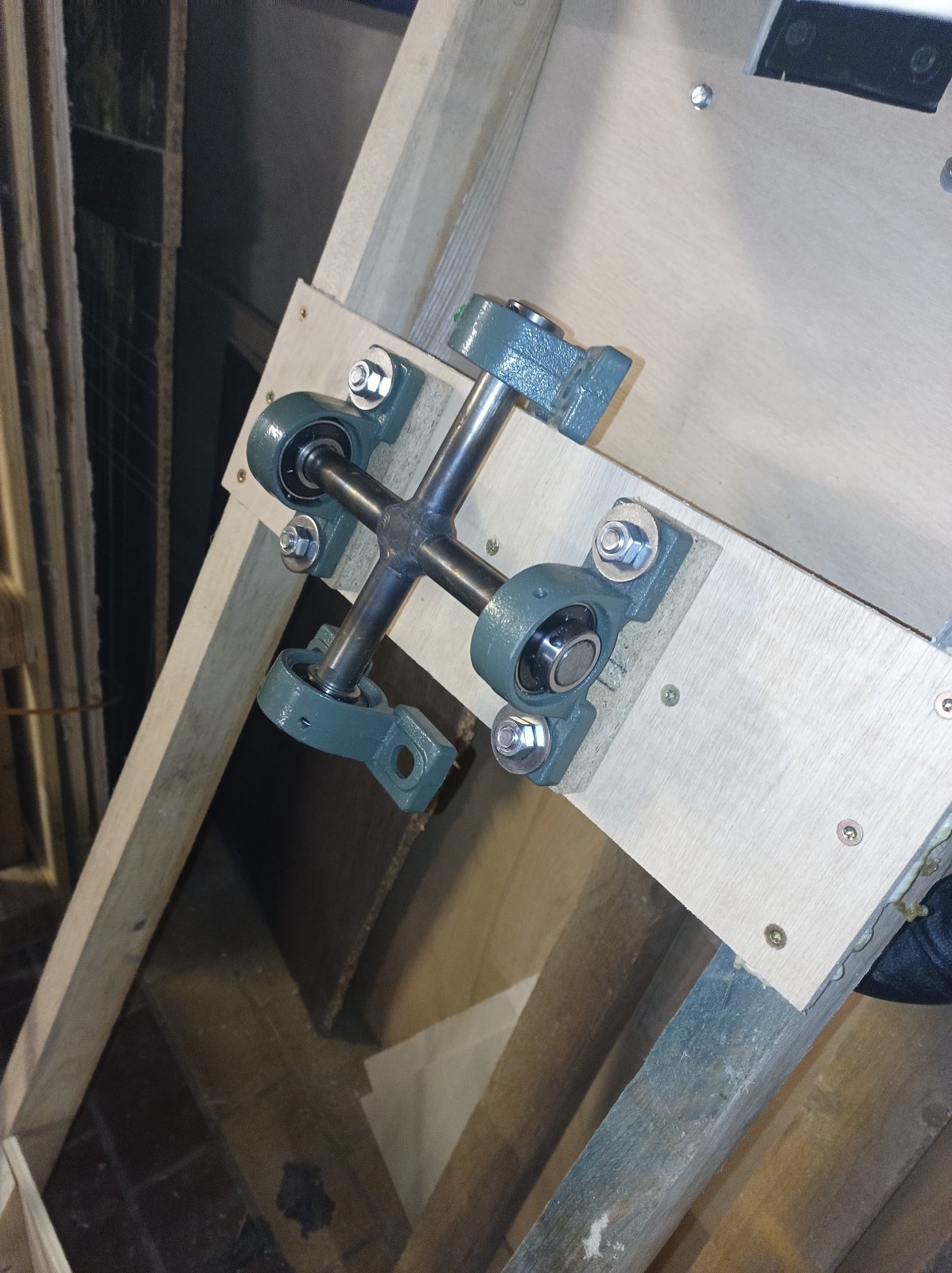

    Mounted under the seat...

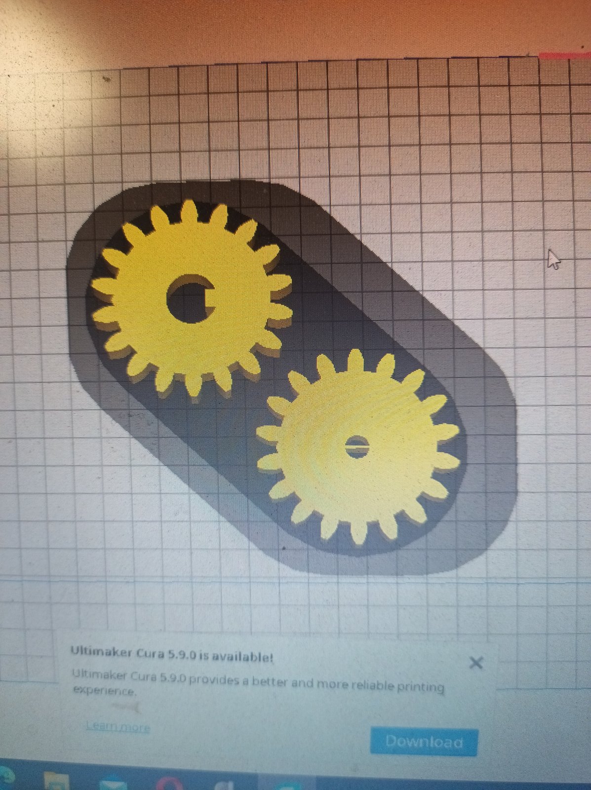

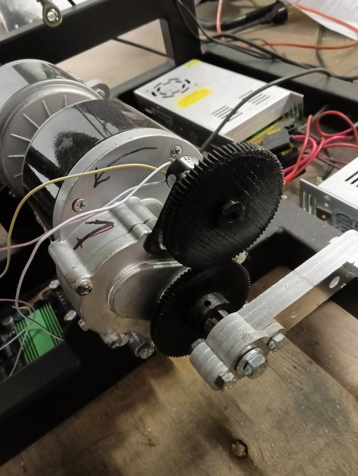

    I am currently developing gears for the potentiometers.
  13. Attyla.pl
    Attyla.pl Active Member
    Oct 1, 2023
    308
    Polska
    1,338Coins
    +93 / 2 / -0
    Are you designing gears with direct contact ?
    As in the attached picture or will the belt be between the sprockets?
    If direct, it seems that there will be too few teeth, and it will be difficult to set the level of the signal from the potentiometer/halo sensor precisely.
    My gears have 84 teeth and align perfectly:)

    I'm planning the gears with direct contact, actually the number of teeth doesn't matter as long as they mesh tightly, don't you think?
  15. Stahlwolle
    Stahlwolle Member
    Nov 28, 2024
    54
    268Coins
    +11 / 0 / -0
    I tried it, even the smallest rotation is transferred exactly to the other gear.

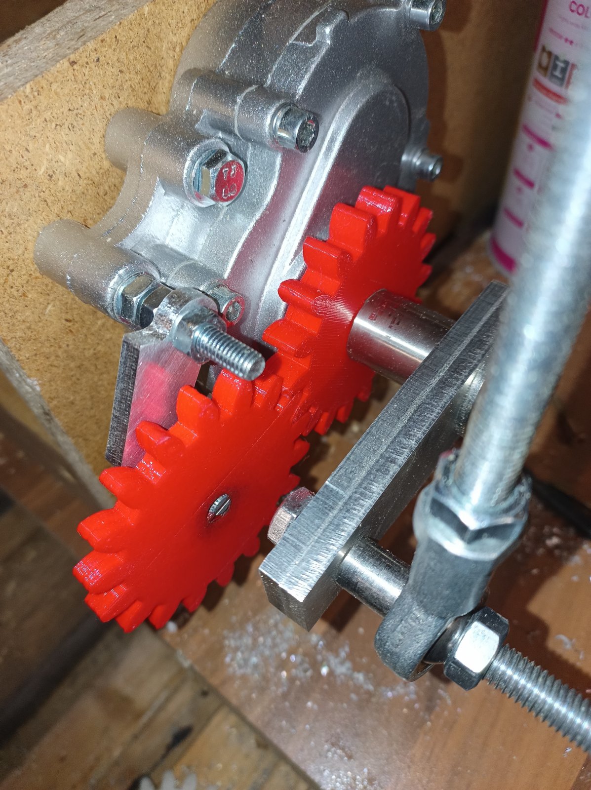

    The substructure...
  17. Stahlwolle
    Stahlwolle Member
    Nov 28, 2024
    54
    268Coins
    +11 / 0 / -0
    Gear holder made of aluminum.
