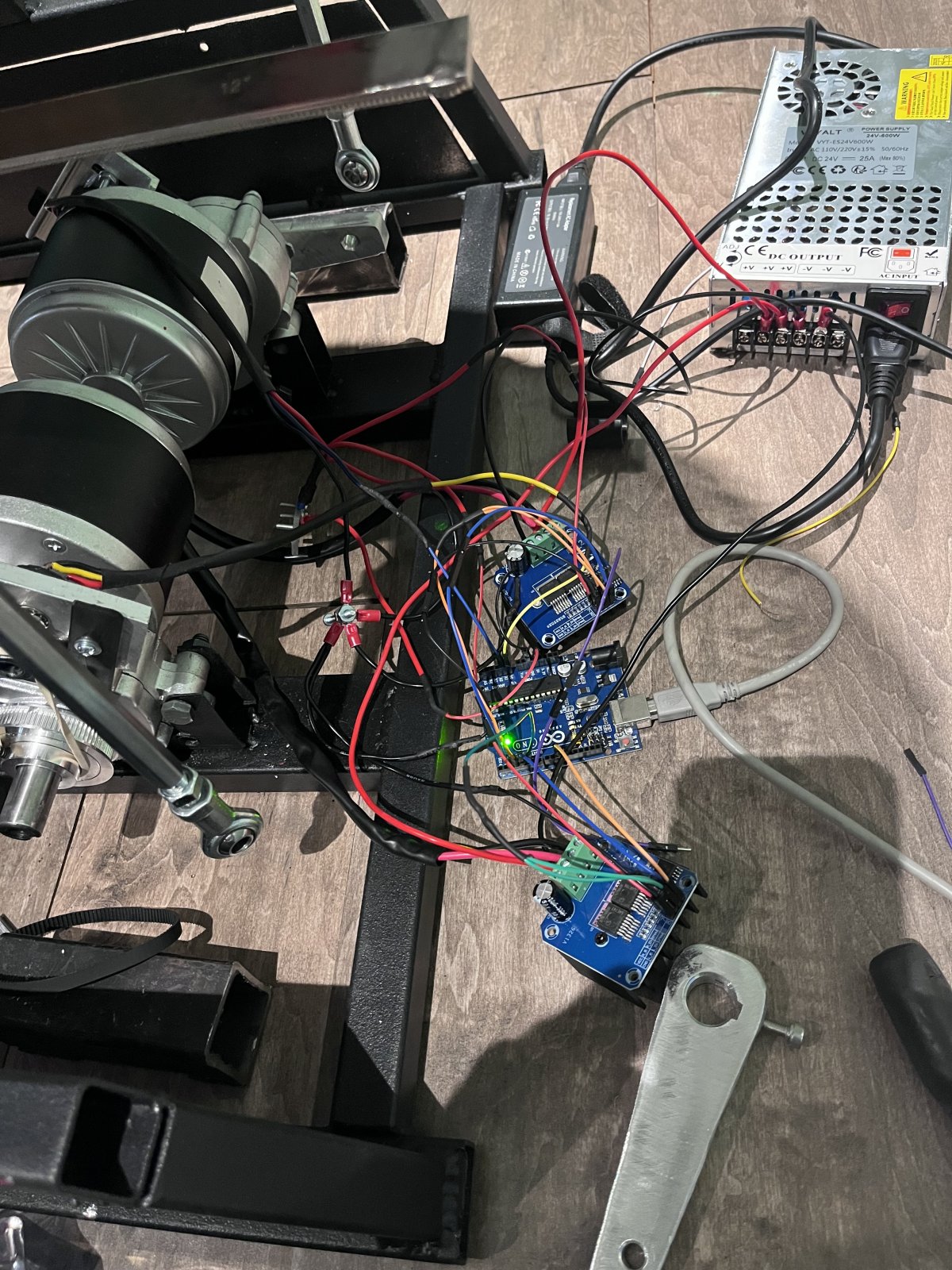

    IMG_3474.jpeg IMG_3473.jpeg Just built a new 2dof and have had issues getting the motors to work.. working with Arduino Uno and 2-IBtT-2 drivers.. with Wheelchair motors 24v..I have replaced the drivers as I was getting no movement at all.. replaced the drivers and now just spins.. have followed the instructions with putting everything at “0” then 255 on clip and limits but still spins.. any help would be greatly appreciated!

    Keep in mind that other members have advised as to IBT2 quality control issues, even with brand new units.
    That said, at what point of the SMC3 setup do you encounter issues: https://www.xsimulator.net/communit...3dof-motor-driver-and-windows-utilities.4957/

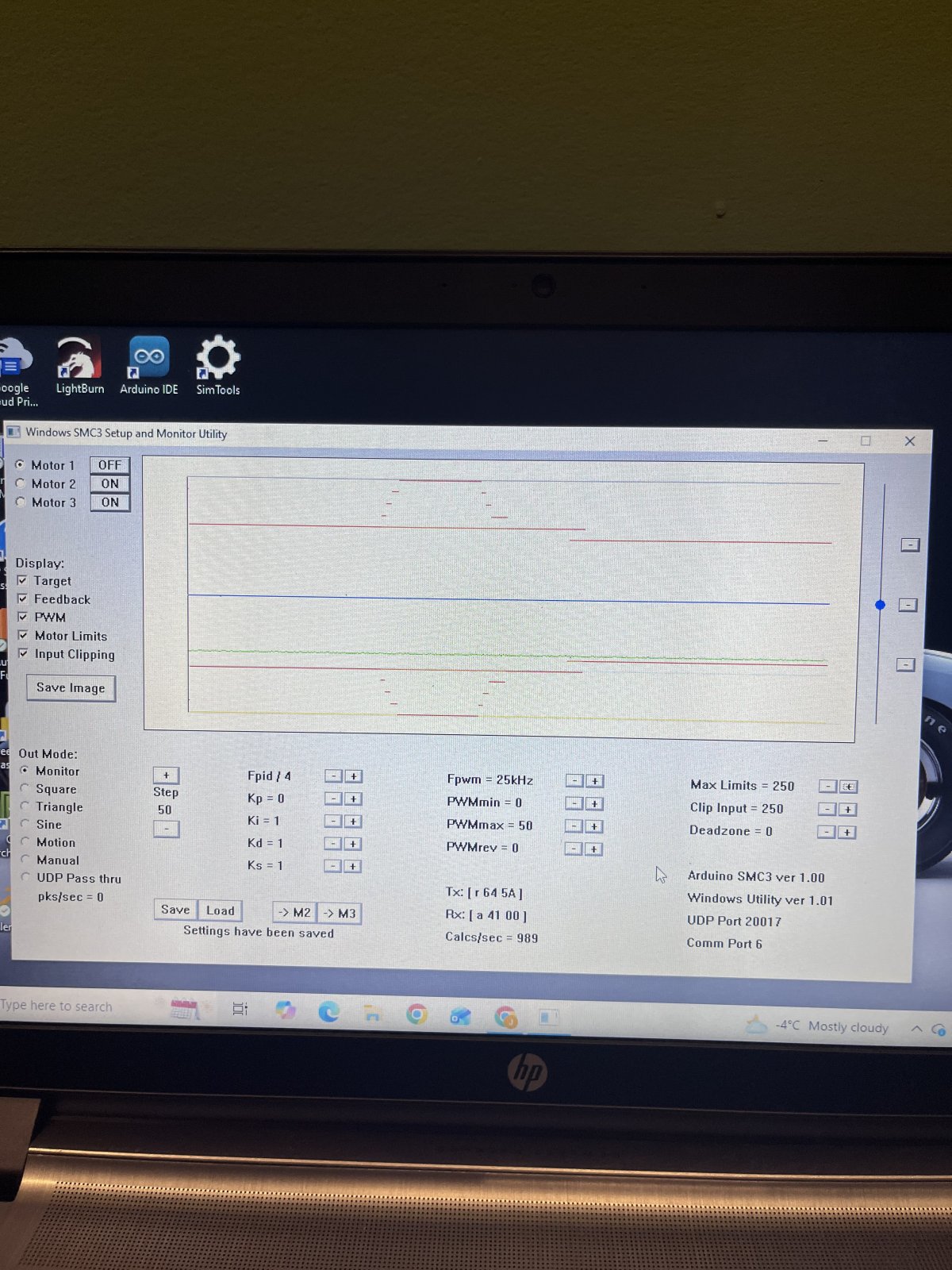

    As soon as I power up the motors after setting everything to “0”

    Have you tested the IBT2s?
    As an aside the pots do not appear to be centered in the SMC3 picture.

    I have centered them multiple times.. but turning on motors they go back out of whack

    What specifically have you been doing?
    If you disconnect wiring/power to the motors when they are in what should be their middle position, open SMC3, disconnect the pot to the motor then rotate the pot shaft by hand, its green line should move and be positioned in the middle of the SMC3 graph. You can then carefully reconnect the pot to the motor while mainlining its central position. You then reconnect power to the motors.
    If that does not work there is something very wrong and more detailed testing of your hardware and wiring is required.
