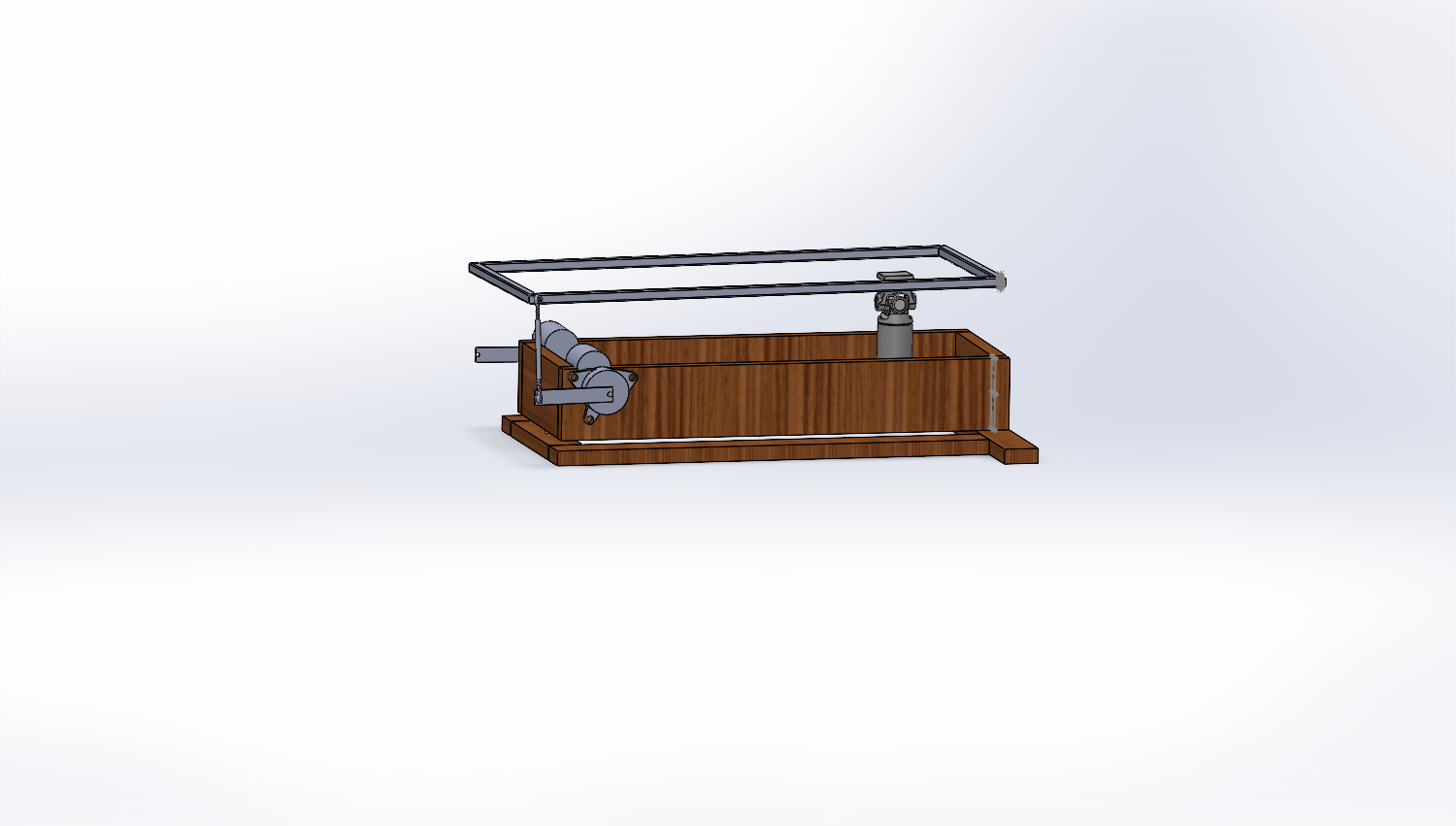

    The wheelchair motors I will be using are 24V, 150+ RPM, with an 18:1 gear ratio, but I will be running them at 26V, achieving 165 RPM. Can I use a lever size of around 10 inches (250 mm)? The distance from the motor center shaft to the U-joint center will be approximately 40 inches (1 meter), depending on the center of gravity of the chair, which is still unknown. The width of the top frame is 25 inches (635 mm). Also, I was planning to use 1-inch, 16 gauge steel square tubing with bracing. Would that be good enough for rigidity? I really don't want to use 11 gauge since it might be overkill. See the picture below
    It would be nice to use a design clone Reality H3 but I really don't think it's possible with the motors I have. Also, power consumptions is much higher with that design and not really suitable on a breaker 1500W, 120v running everything such as PC, monitor, 3d printer, lights and motion simulator.

    There is a problem with SimCalc due to the interface between the chair and the monitor. For some reason, the numbers don't add up in my head, or maybe I don't fully understand what pitch and roll force mean. Regarding the driver, I'll be using a modified IBT 2, probably with BTN8962 drivers with custom radiator, or possibly 100 amp drivers of Ebay. At the moment, it's too early to say. What do you think about lever length? Is it doable with such a long arm to achieve the results I'm looking for?

    You can check out the mathematical assumptions behind SimCalc here: https://www.xsimulator.net/community/threads/simcalc-by-tim-mcguire.11277/page-2#post-140469
    IBT2s are not suitable for what you plan, as many members have reported quality issues, and the consensus seems to be that reducing the voltage below 24v helps with those issues.
    There are some possible budget options, this 100a board seems popular: https://www.xsimulator.net/community/faq/reasonably-priced-100a-motor-controllers.412/
    I can't say for sure, given you are yet to work out all the design and hardware elements, but my guess is likely not, though the upside is that it it easy to make levers with a whole range of CTC options and experiment with the actual rig in real-world circumstances.

    Do you think with the motors I have would work with a clone Reality H3 designed by Gabriel the simracer member or gearing is way too low?
    In my head, the plan was to have the longest distance between the motor and the U joint to work as leverage, and to have a longer lever to move the bed in order to substitute the travel angle. But, as usual, you turned down the idea. To be honest, I'm totally confused about which design to choose. I have no problems with building or electronics, that's the easiest part, but I'm completely stuck on which design to go for. Since I'll be welding most of the pieces, changing the entire design later on won't be fun.

    The longer the distance between the motor and the U joint the greater the inherent design leverage, and hence the bigger CTC lever distance you can use, just keep in mind there are a range of tradeoffs, for example if the wormdrive gearbox has play, the longer the lever the more amplified that play is.
    No rig design is perfect, or ideal, it is always about some tradeoffs.

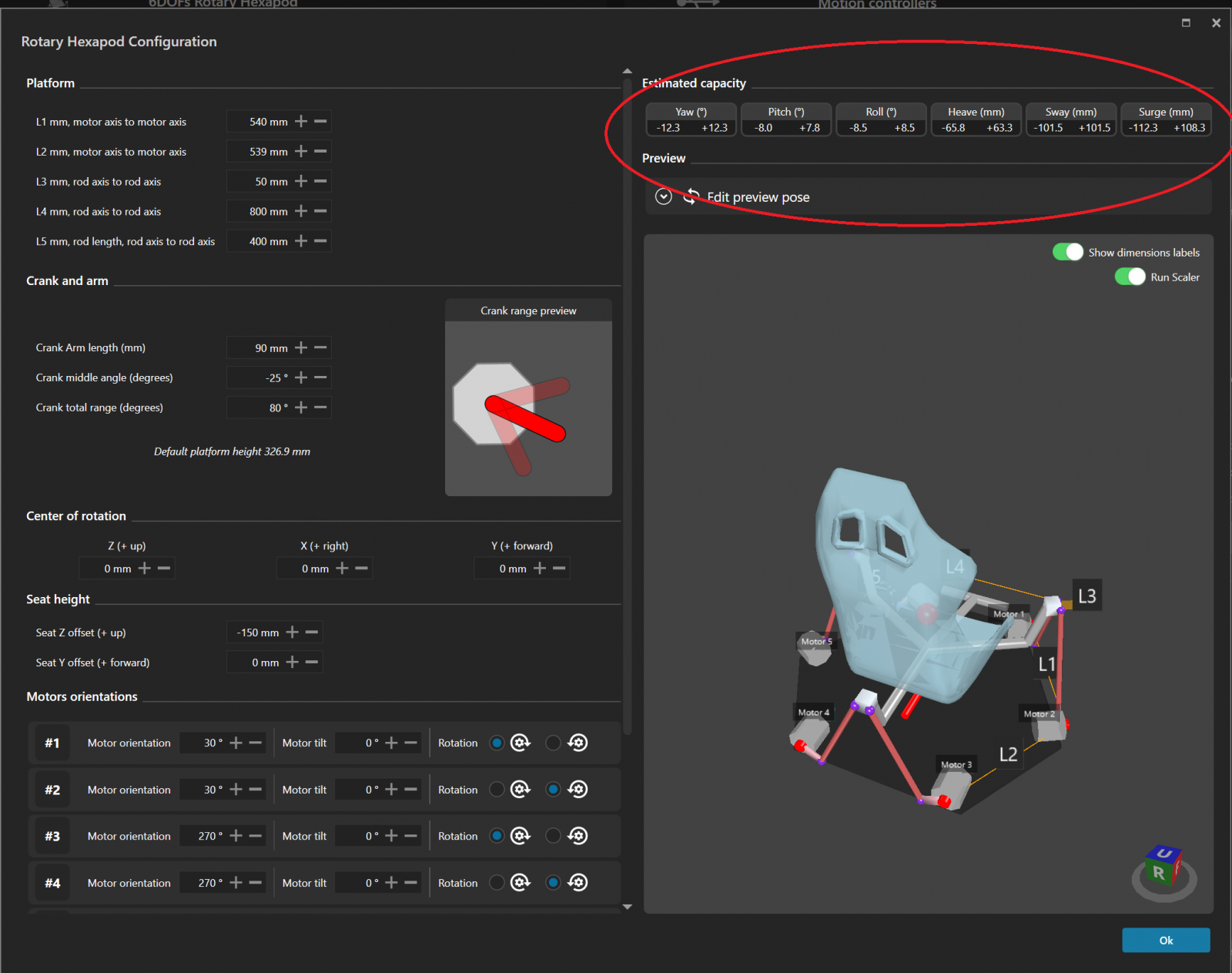

    If you have 250W 165RPM motors, that means they are weaker than 250W 75RPM motors, so using such a long lever will be impossible.
    I understand that you are building a sim rig for car racing, in which case you don't need too much range of motion, but rather a more responsive signal from the road, gear changes, acceleration, etc.
    The H3 design will work, just give it 5-6 cm levers for racing and that will be enough.
    You can also download the SIMHUB program, even in the free version, enter the dimensions of your design, and it will show you a preview of the range of motion your design will have.
    In general, SIMHUB works very well, is easy to use, and has a built-in soft start.
    Download version 9.8.4. I have now noticed that the settings for the 2DOF rotary have disappeared in the latest versions.
    As an example, I am posting a photo from my 6DOF.
