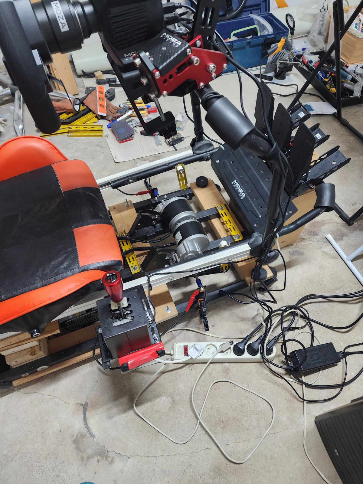

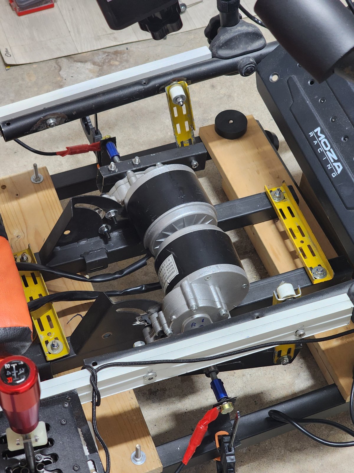

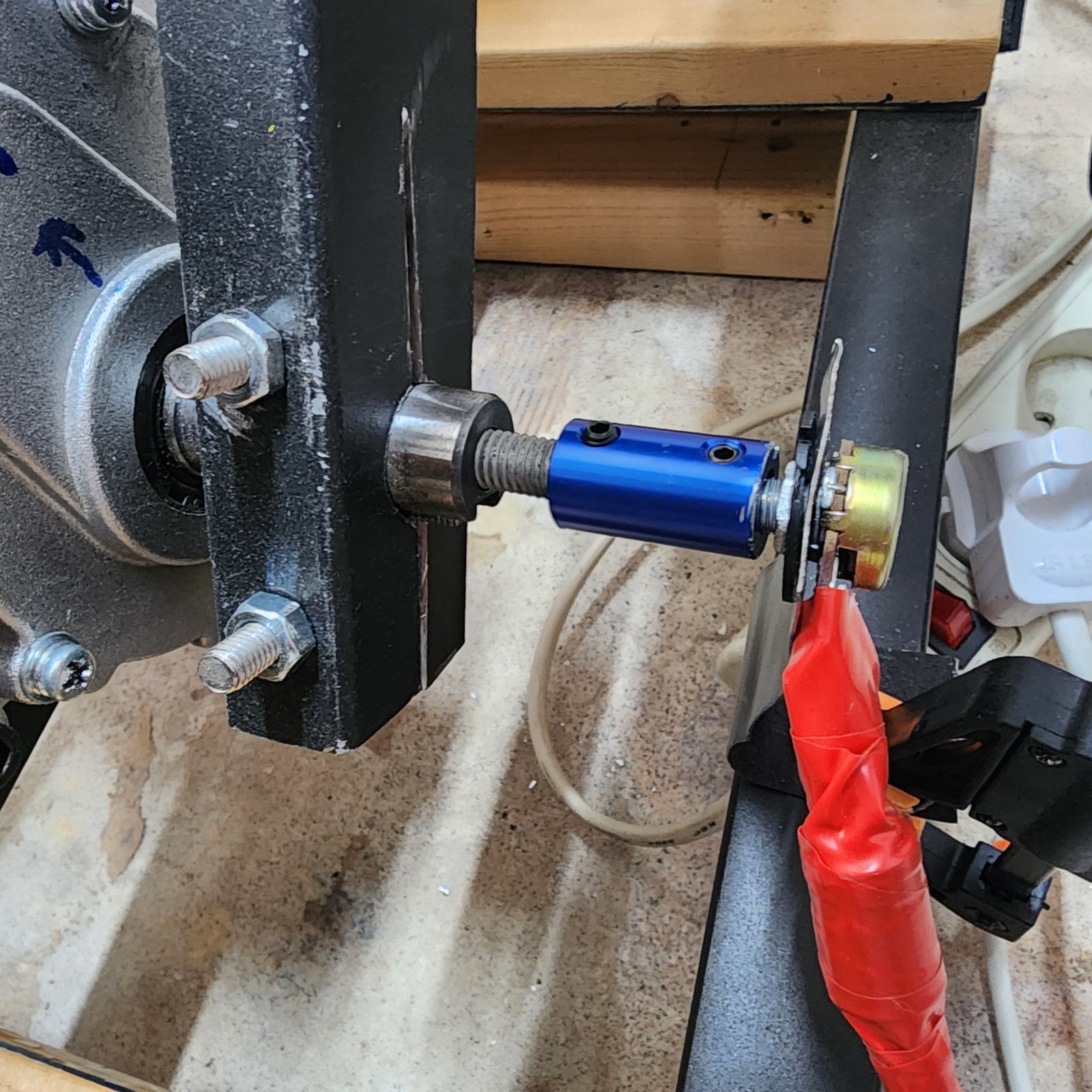

    In sine wave measurements, when the axis of the motor goes up, it goes up normally, but when it goes down, it goes down quickly. What should I adjust?

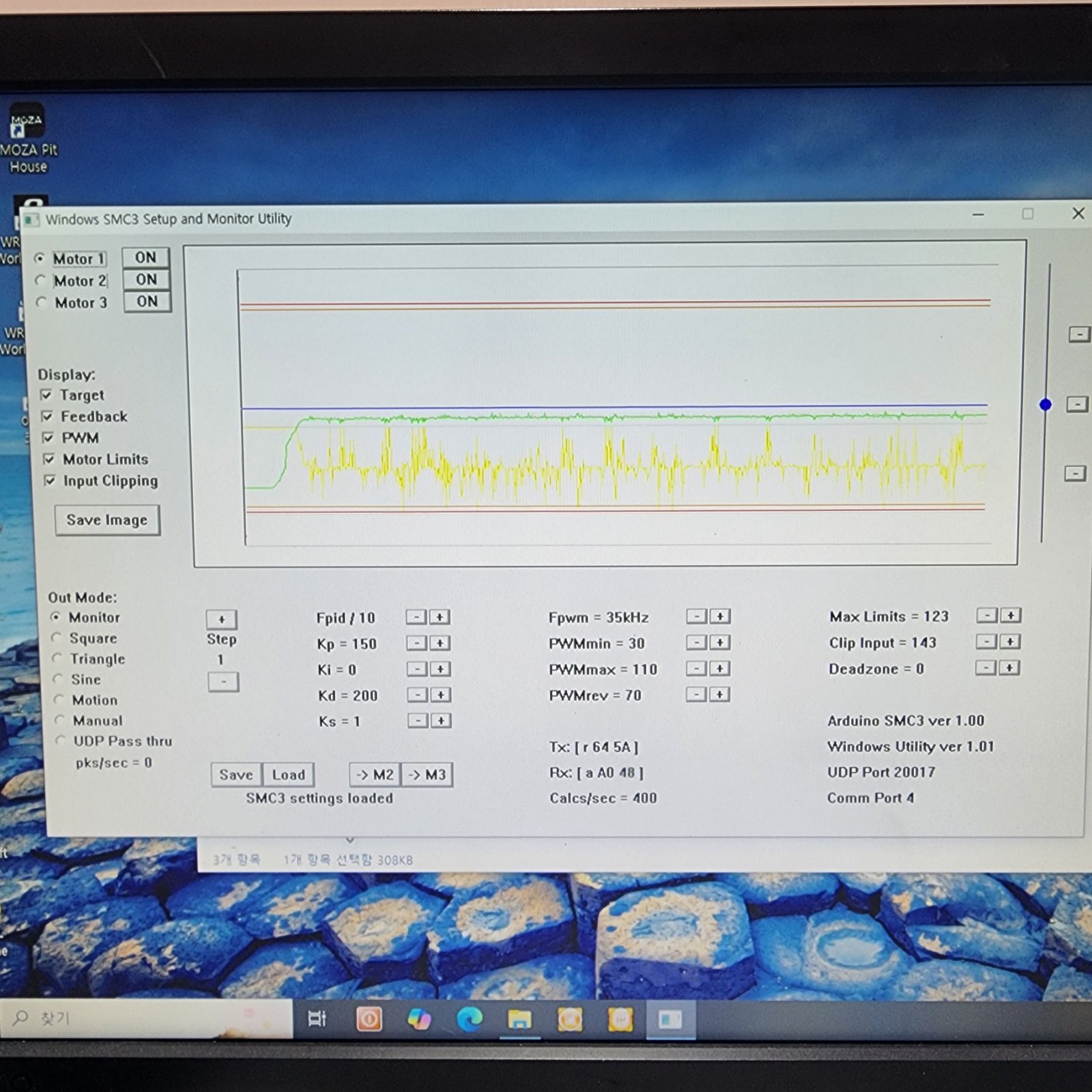

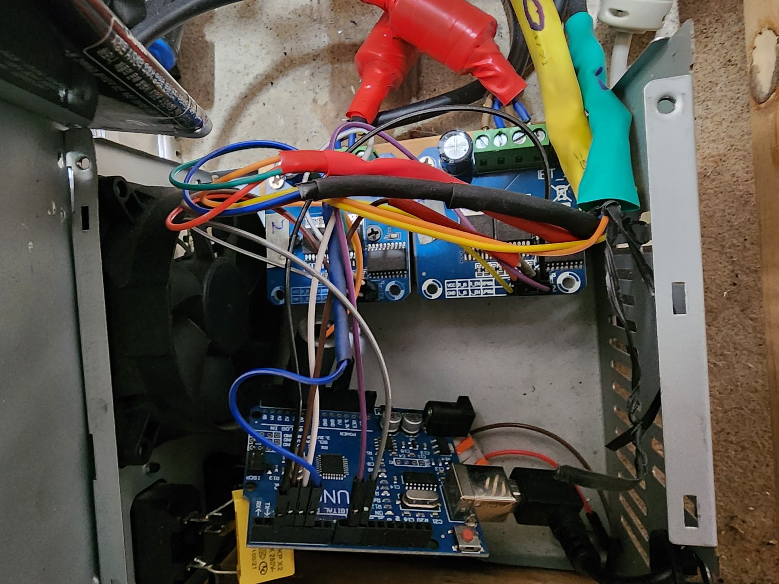

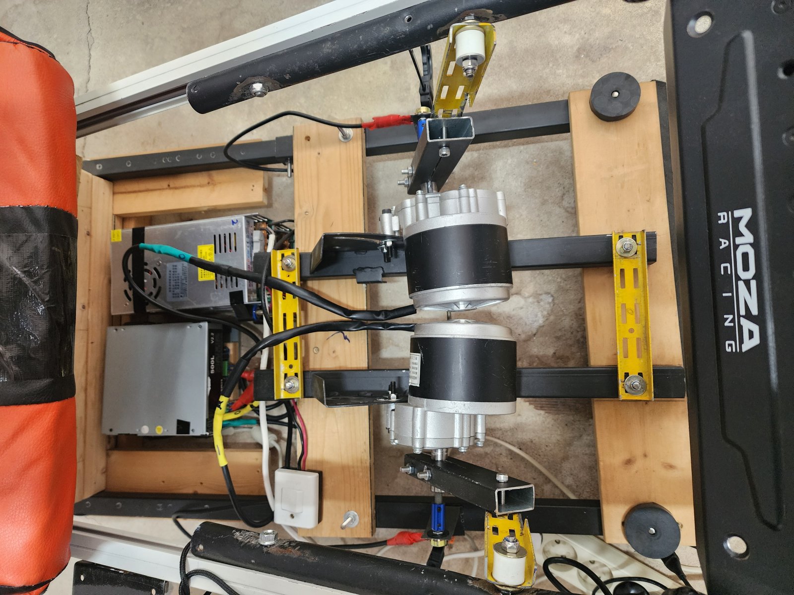

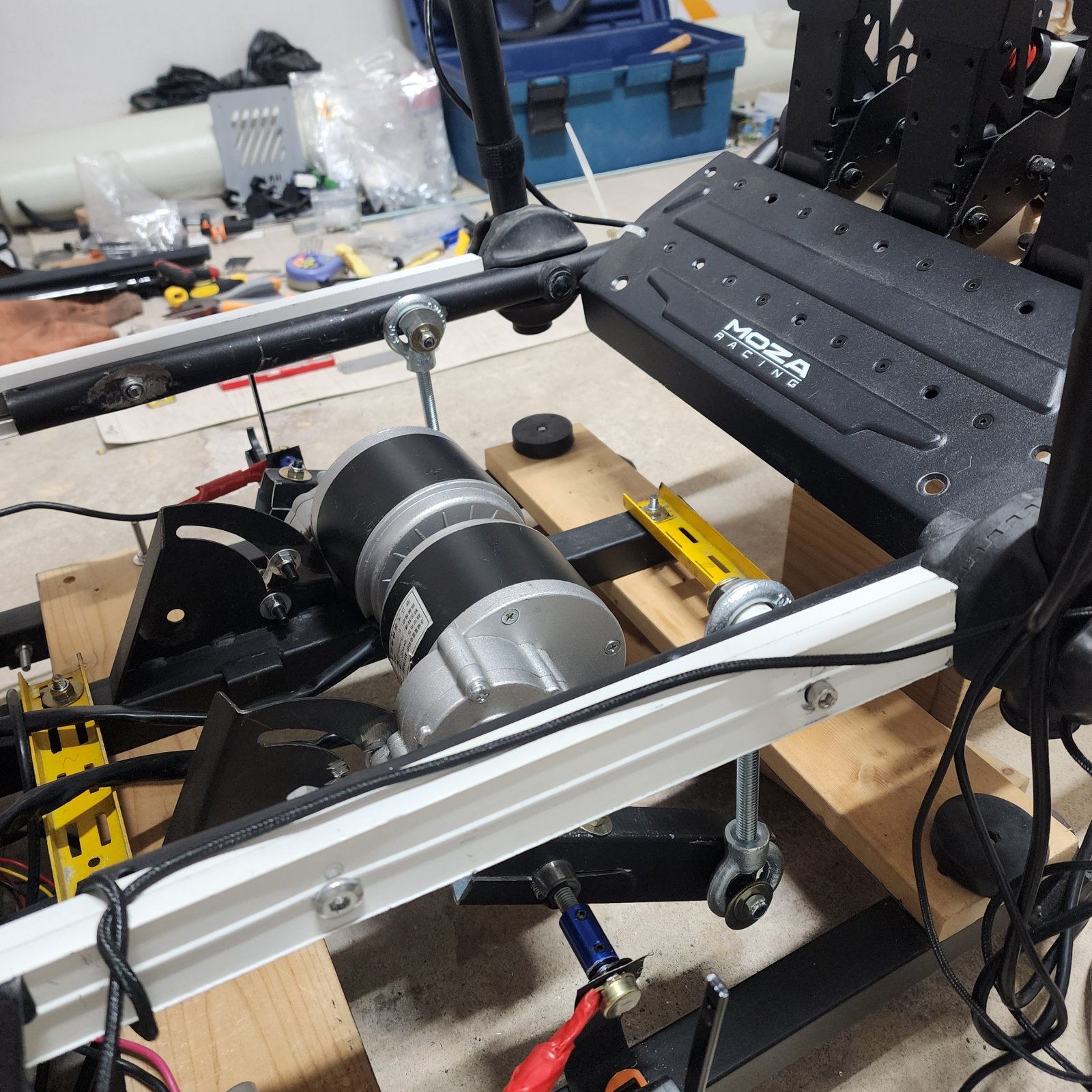

    My system is unstable. I want to know the cause.
    21,907
    153,053Coins
    +11,117 / 56 / -2
    There are a bunch of possible contributing factors.
    First, make sure the computer is set to English Local: https://www.xsimulator.net/community/faq/simtools-language-setting-bug-change-to-english-local.233/
    The SMC3 settings look like they need refinement, set Fpwm to 25kHz, at a guess increase Kp to 400 and for now set Kd to 0, then run the Sine test and post pictures of the results:
    There is also an error message when using SimTools, so hit Details and please post the full error message here, plus pictures of all SimTools settings.
    As an aside, the yellow U channel used as a a connecting link does not look robust enough and really should have spherical joints either end:

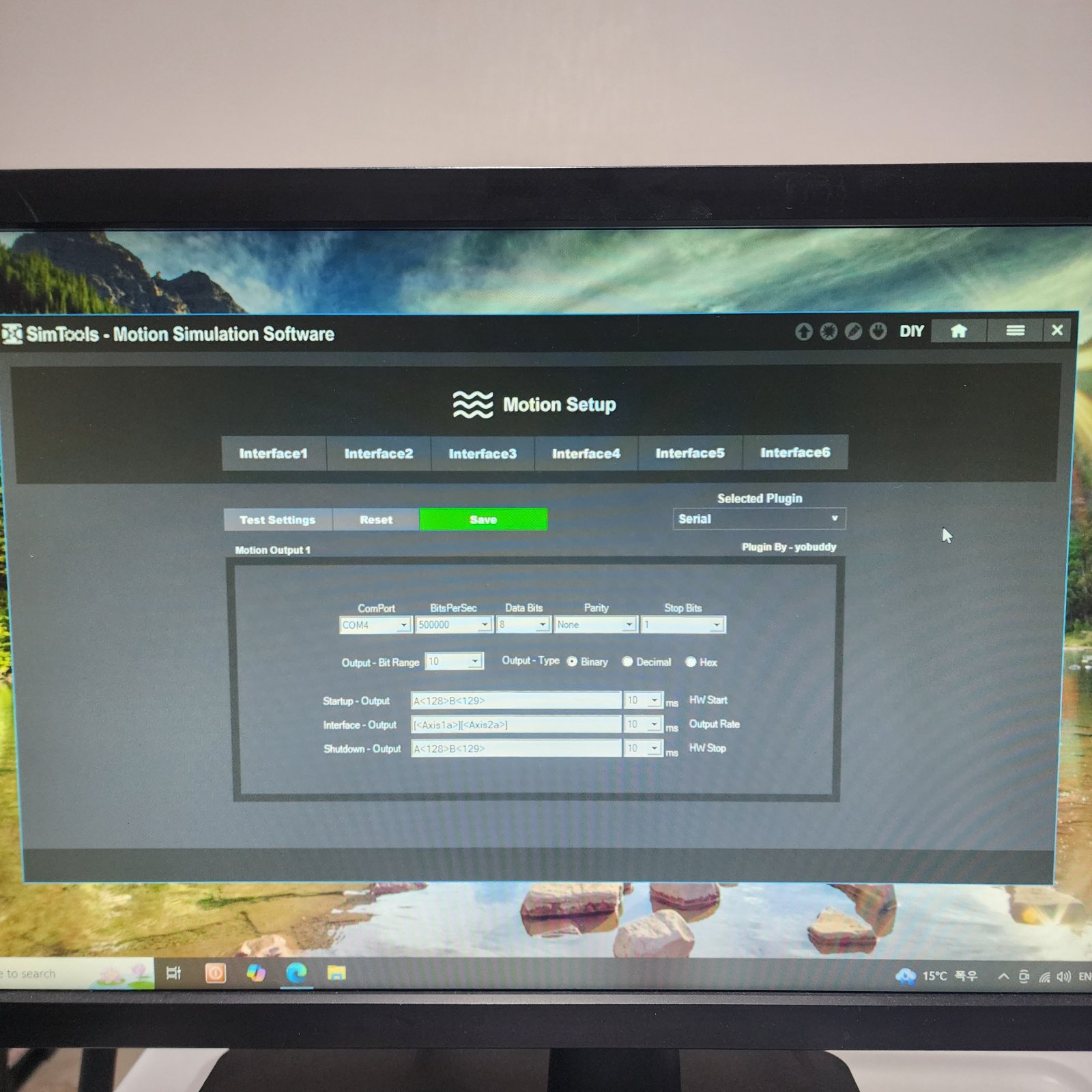

  8. riki99
    riki99 New Member
    Dec 8, 2024
    15
    korea
    27Coins
    Thanks to norbeast, it worked out well. And I want to add a description related to interface-output in sim tools3. If you write Axis1a, it doesn't work. If you write A<Axis1a>, it works. Thank you.
    https://youtube.com/shorts/NfArE_7Kf40?si=ps7GoUqyqSy8wzDN
    21,907
    153,053Coins
    +11,117 / 56 / -2
    Glad to hear that, great job :thumbs
