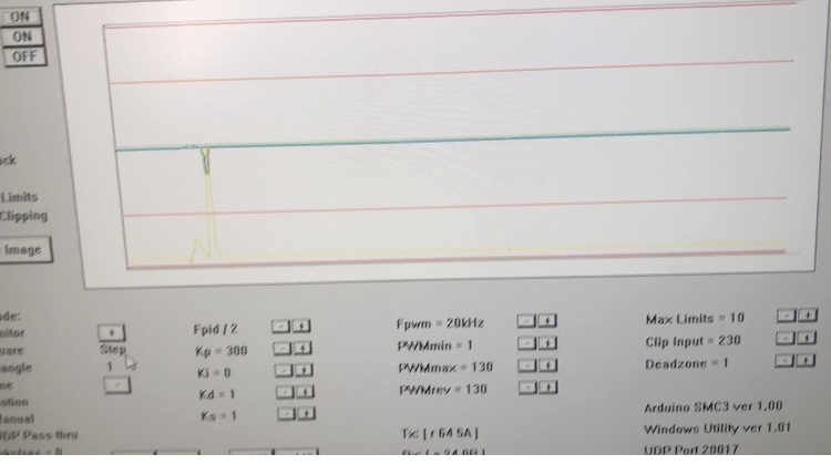

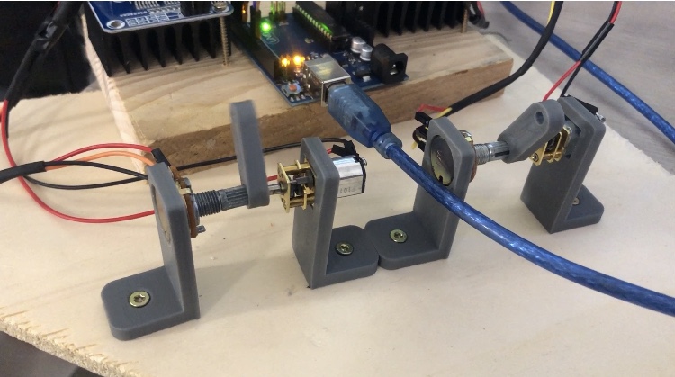

    I don't understand why I can't get everything to work well, I'm trying to do a miniature test by following all the instructions, for the moment I have connected 2 motors powered separately at 6v and joined them using 3D printed supports to potentiometers 10k, when I connect the arduino to the usb and power the motors, it starts immediately to make small quick movements, and if I open smc utility it stops for a moment and then starts again. does not make longer movements!

    Please post pictures of all of your SMC3 settings.

    At the moment I don't have a pc because during the tests I accidentally gave 10v to the usb and it doesn't work anymore.. but it's normal that even if I don't open any program but only connect the arduino and the power supply, the motors move without stopping making small movements fast?

    It is impossible to guess what the motors may do without any idea of the settings controlling them, hence the request for pictures of all settings.

    I found a picture in my phone while doing tests, these are the settings but I had also tried changing the parameters.

    yes, I followed all the instructions, I also watched the tutorials and tried to do the same but my fear is that there are current problems because I tried to use only one motor and one potentiometer and I noticed that it worked better, I managed to make it move even with the sim tool which, on the contrary, did not work with 2 engines. I don't know how to share a video otherwise I could show you better what it does.

    The settings in the video looked to be copied from here, rather than being dialed in to suit your particular hardware:

    so do you think it's just a settings problem? as soon as i get my pc back i'll try to change them. Thank you

    Likely so, follow the recommended setup steps and report at what PWMmax value the motors start to move:
    Initial Setup
    I strongly recommend you follow the steps below if this is the first time you are using SMC3 with your simulator to reduce the risk of damaging anything.
    8. Set Kp to about 400
    10. Do the above for each motor
