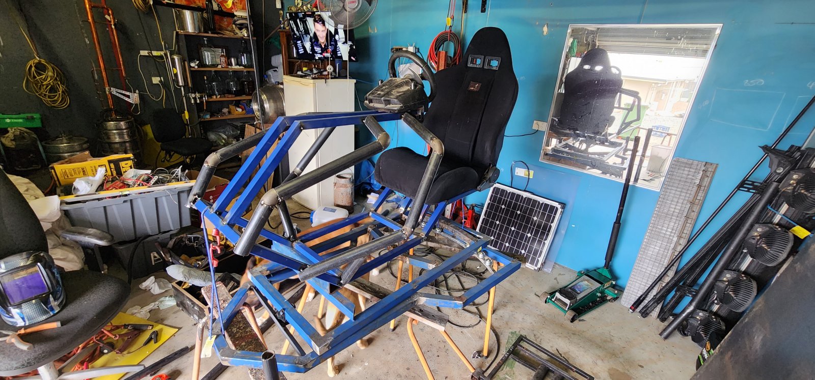

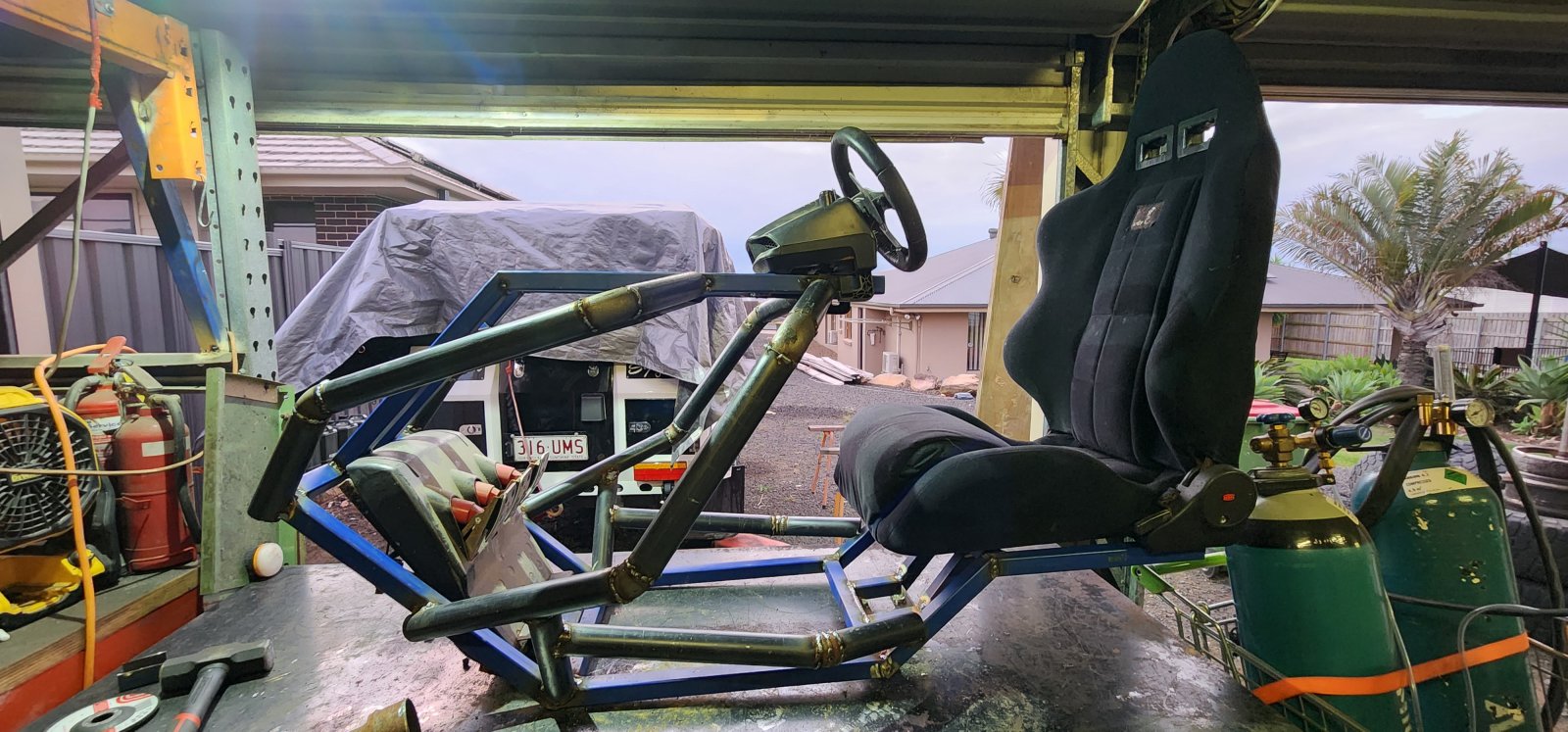

    He there sim community folks, I am a ne member and just setting out on my 3DOF build. Fabrication and design are my stronger attributes, electrical... not so much.
    I am hoping to make contact with fellow Aussies for purchasing advice on some of the components. If anyone can help advise what electric motors I should purchase would be greatly appreciated. I am not sure what I need and want to avoid spending $$$ on the wrong item.
    Hoping to be racing you all really soon
