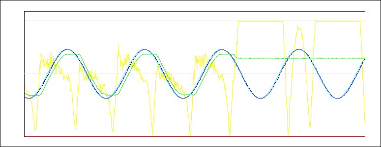

    motor-quitting.jpg I have been have a very long running issue with a motor I am using for heave quitting on me.
    I have this on its own arduino by itself. I have daisy chained 2 IT-2 motor controllers so it has double the power.
    I have swapped out for new IBT2. I am activly cooling the IBT2s with a fan.
    It's a powerful 600watt motor (this is it: https://www.ebay.ca/itm/394945206008)
    I am using a 1000 watt PSU so it should have sufficent power.
    I have attached the smc3 utility screen shot to show how it eventually quits. This is after maybe 1 minute of the sin wave pushing me up and down. Any thoughts?
    Thanks!
    ps: i have set the upper limits to the max because I am using Simtools to handle the limits
    21,324
    149,609Coins
    +10,950 / 54 / -2
    By the looks of it SMC3 needs further refinement, as there is consistent overshoot.

    ok, well that sounds positive to me @noorbeast! I was worried it was a hardware issue.

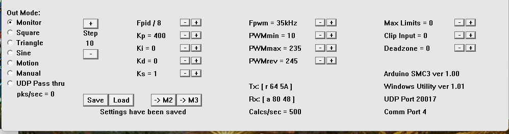

    I have tried tweeking the settings in various ways but I am not sure what to try. (I am also noticing now that the actual values didn't show up in my screen shot). I will take a photo of that part

    @noorbeast I have the limits set in simtools, fyi so I am only using 50% of the axis in there.
    Also to note, I have tried messing with a lot of these settings but the motor cutting issue still remains
    - I have adjusted the PWMin from 0 upt to maybe 40
    - I tried increasing the Kp to 500- i changed the fpids and the khz
    If you have any other ideas of adjustments , I will give those a try tomorrow
    Thanks!!
    21,324
    149,609Coins
    +10,950 / 54 / -2
    I am taking a bit of a stab here but set Fpwm to 25, Set Clip and Max Limits to 255, Kp 400 and run the Sine Test, just as a base line.

    Hey @noorbeast I tried with those settings and it seemed to last a lot longer, actually during my sin test it dxidn't quit at all. Do you think the Fpwm has something to do with the problems I was facing?
    21,324
    149,609Coins
    +10,950 / 54 / -2
    My guess all were contributing factors, as I understand it IBT2s can misbehave at higher Fpwm, but limits also need to be set properly:
    Clip Input Used to create a band at either limit of the target range beyond which any values sent to the SMC3 are clipped. In addition to this clipping, if the motor feedback does move beyond this range (typically through inertia), the SMC3 will attempt to brake the motors hard by driving them in reverse until they are back out of this limit zone. The value can be anything from 0-255 (however can’t be less than the current limit setting). Reverse braking is applied in the band between the Clip Input and the Max Limit settings. Reverse braking can be disabled - refer to PWMrev.
    Max Limits Used to create a band at either limit of the feedback range beyond which if the motors move (typically through inertia) the SMC3 will automatically shutdown the drivers and keep them disabled until reset. This is essentially a safety mechanism if something goes wrong. The value can be between 0-255 (however can’t be greater than the current clip setting).

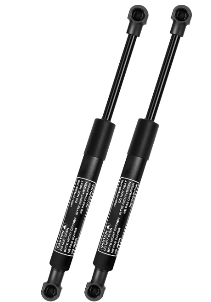

    Your sin wave looks to me like its hitting a limit or maybe is too straight up. It for the most part lags (normal) but at the extremes something wierd happens. Maybe move in manual mode to those limits and see if there is an obstruction or some odd mechanical alignment issue.

    @Joe Cortexian I do have 3 of these lift supports to help the motor with my weight so you might be seeing when the motor is starting to compress these perhaps
