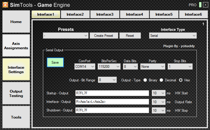

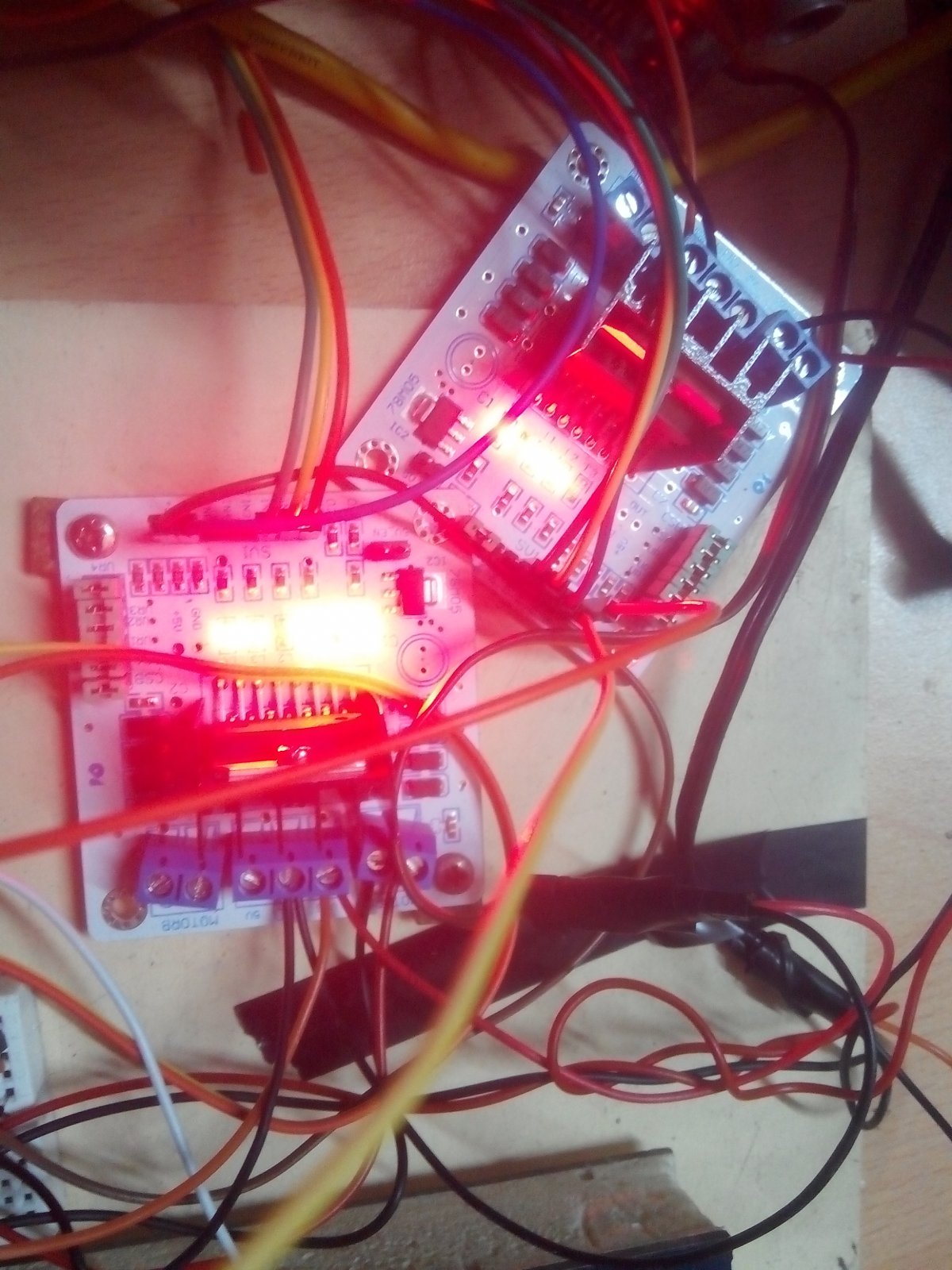

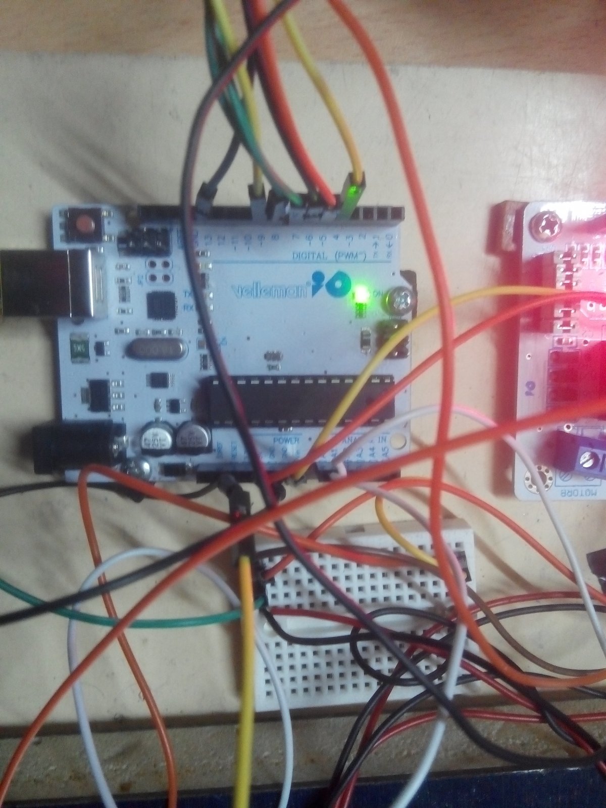

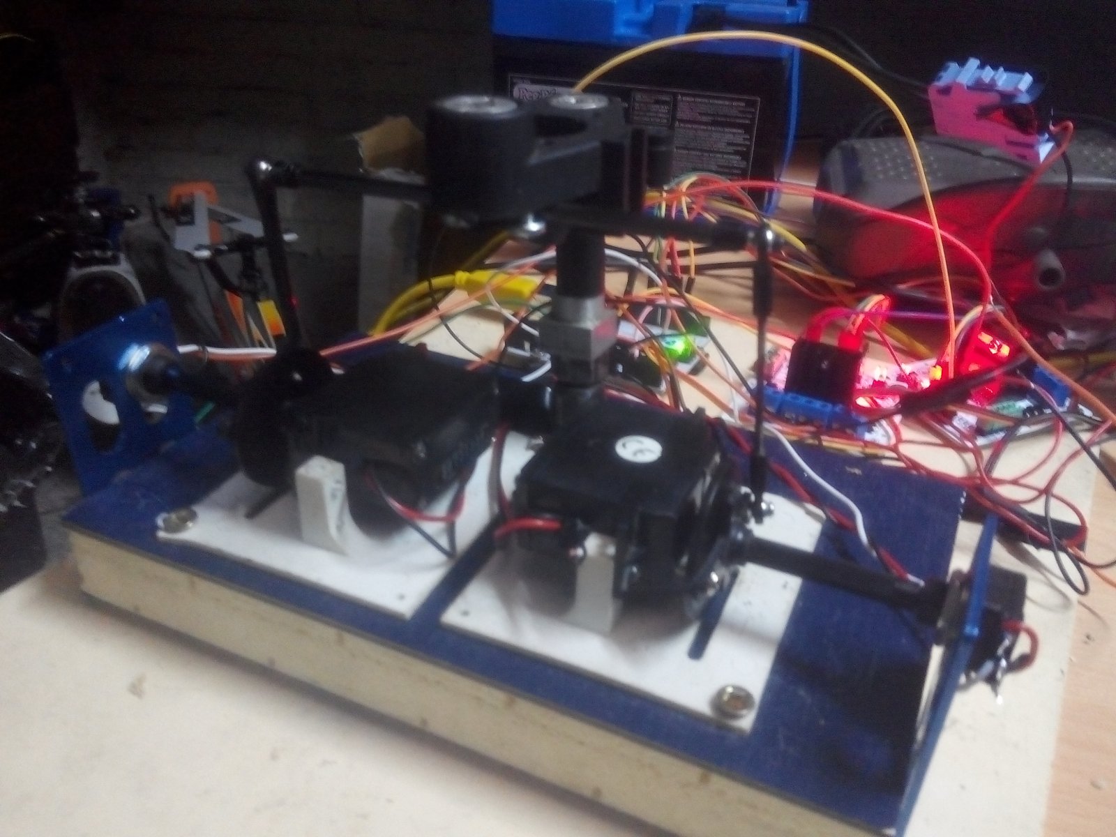

    i need help with my 2DOF projet all work fine in motion but
    when i reverse motor in the setting simtools no reverse motion in motor please help me
    hardware : Arduino UNO + 2 Hbridge + MOTOR DC
    arduino code : racing_mat2DOF
    interface setting : in attachement
    axis setting :in attachement
    projet simulator picture : in attachement

    Do you mean checking the Dir orange on one axis for roll has no effect?

    Yes , without inverse that work ( 2 motor turn in the same direction )
    when i check reversing no reverse motion ( 2 motor dont work in inverse direction but work in one direction )

    I think you need to check your Arduino and its settings.

    you mean programme code of arduino ?

    Yes, and hardware.

    I think you need to detail the hardware being used with links to it, for boards and motors.
    Also validate the setup steps with the code.

    so,i work with a arduino uno generique (clone low cost),2 motor dc 6v, 2 potentiometre 10k ,and 2 h bridge L298N low cost too : ), i used them for my first test only.......what do you think about my ardwear??it's compatible??
    thank you for your help
    21,030
    147,878Coins
    +10,880 / 54 / -2
    I am guessing the 6V motors and L298N are likely pretty limited in terms of their capacity.
    I am not sure if the L298N is supported, perhaps @RacingMat or others could advise.

    in the virtual work fine but in the motor no reverse

    i found the problem i just check my hardware wiring and i found the solution :
    My hardware was not in right wiring , now it work fine
