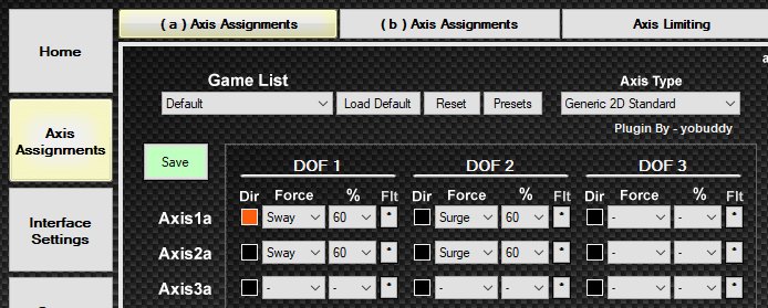

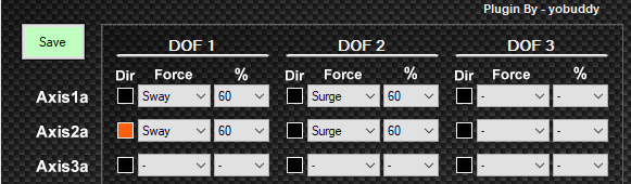

    Now i ran the simtool utility, and also there i just loaded up a basic profile with sway and surge.

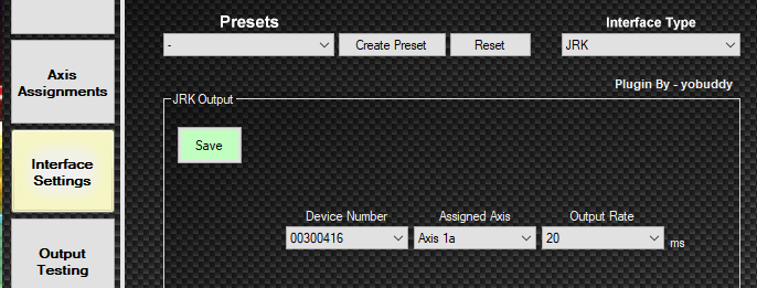

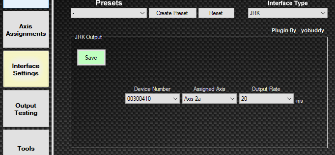

    Defined two interface's for the 2 JRK boards and assigned them to either the Axis1a or Axis2a with 20ms.
    During the DOF tests (while not under load, still only the motor), the motors reacted for both the sway and surge.

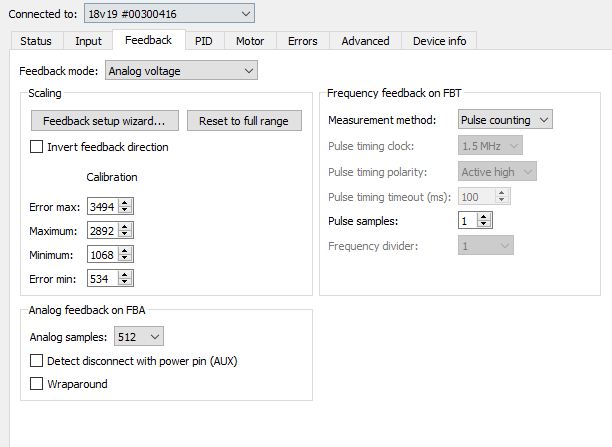

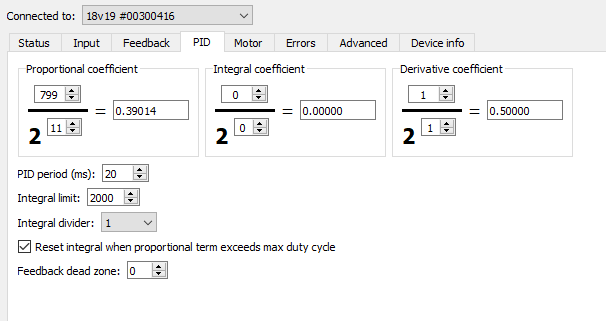

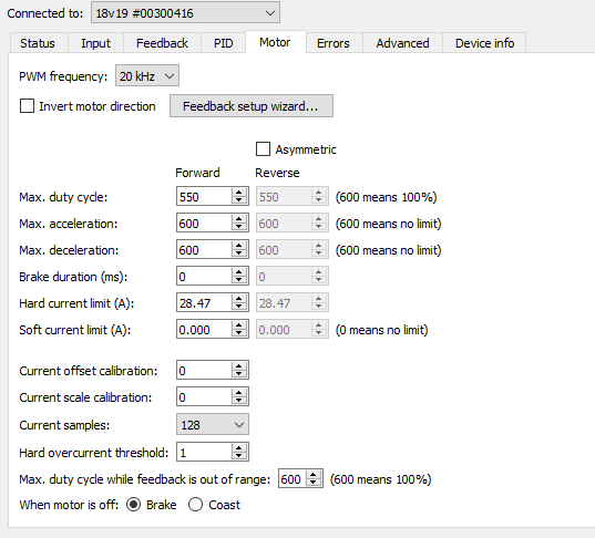

    Here are all the settings i currently use. The problem im have with the '416' board.
    JKR
    upload_2021-4-2_14-47-26.png upload_2021-4-2_14-47-59.png upload_2021-4-2_14-48-31.png upload_2021-4-2_14-50-29.png upload_2021-4-2_14-50-56.png upload_2021-4-2_14-51-24.png
    The crazy part is that yesterday morning everything worked (as far as i kow) and we played Dirt Rally 2.0 with DOF motion. But those settings where made without precision and thus i redid the feedback settings in the evening.
    After that thing went to sh... I'm just not allowed to have some fun with the machine ;).

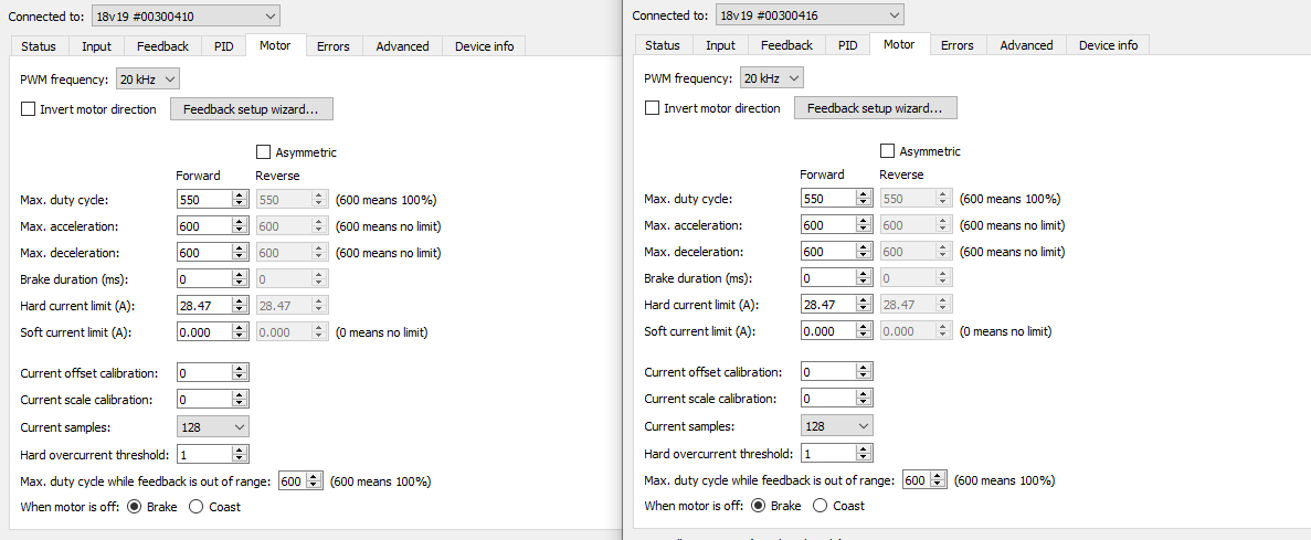

    Hey Vincent - what are the motor and power supply ratings you are using? I think the JRK utility can monitor motor current. If it can, what is the current when your motor stalls out?
    And just a suggestion but in one of the JRK setup pages you allow max current when feedback is out of range. Feedback out of range should be an error condition. In normal operation, the feedback should always be in range. Not sure what to recommend but might consider turning that down depending on your rig. If you lose connection to your feedback pot/Hall sensor or it somehow fails, your motor will go full bore in whatever it thinks the right direction to go is.

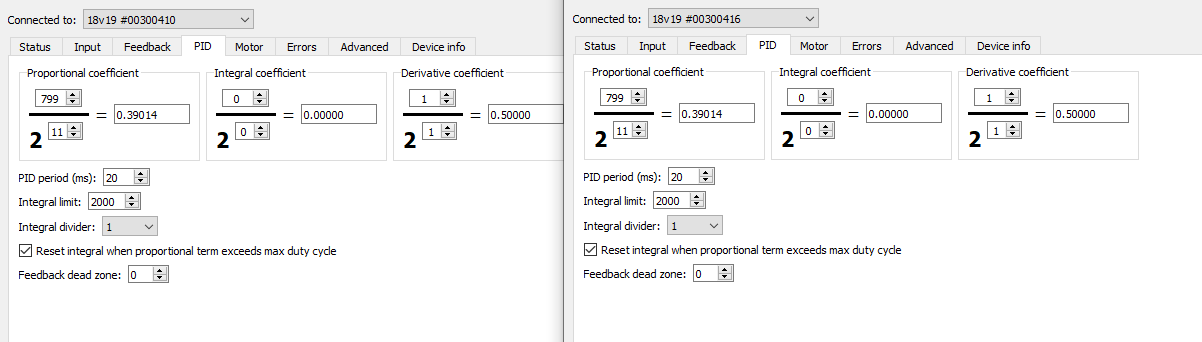

    Try increasing your PID values, does that make a difference?

    Wel i relocated the motor more to the front and that seems to help a bit, still the motor stalls at some points. I also figured out how to do this inside the JKR utility.
    It looks like when i try to do small steps for example:
    - The left motor i rotate to the top
    - Then i rotate the right motor to the bottom (max sway almost)
    - Then i try to rotate the right motor slowly past the center, and at that point (past the center) it stalls and begins to whine
    The PID values does seem to affect this a bit, but i need to play with it some more to understand it better.
    @Zed These are the Power supplies i use: Dell 870W 80-Plus Silver Power Supply 0YFG1C (2x)
    And these motors: https://www.benl.ebay.be/itm/120W-1...earbox-Speed-Reducer-High-Torque/333681535603
    As for the current, the variables show that is normally stays between the 6000 a 14000 mAmps with shots to 22000
