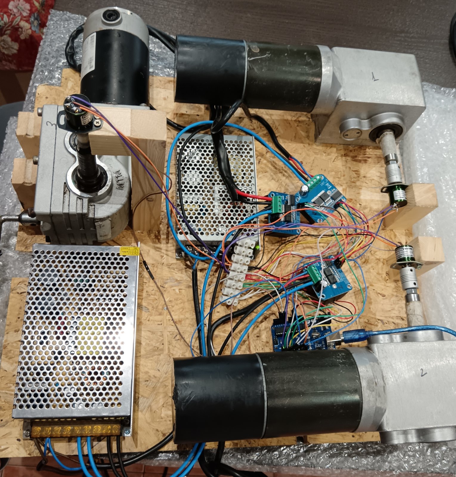

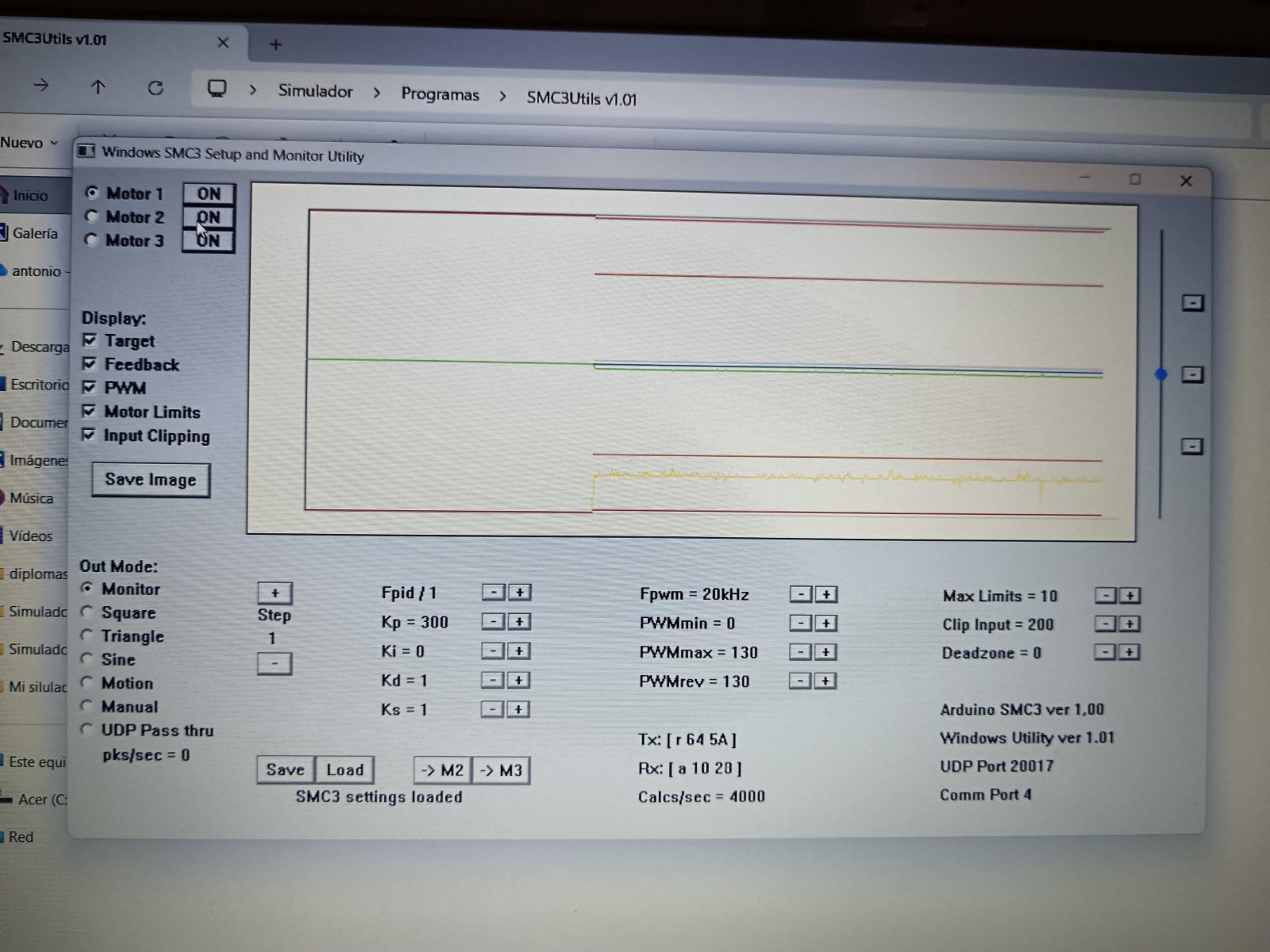

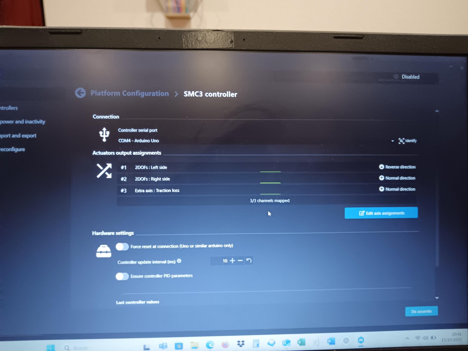

    Hello. I am testing my 3DOF simulator with loss of traction, but when configuring it with SMC3, only one of the motors is on. When testing, I see that if I move the Hall sensors, I can now turn the motor on and I manage to move it, but it won't let me do anything else and it goes back to off. Can you help me?

    I think I found the solution, I reversed the wiring of the motors that were not working for me.

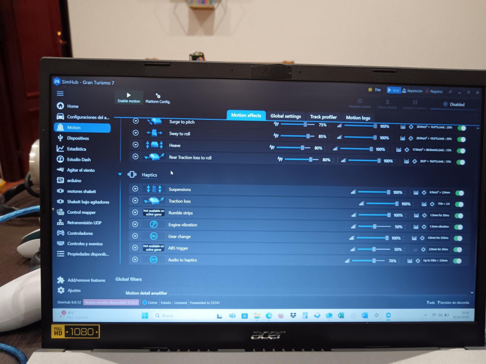

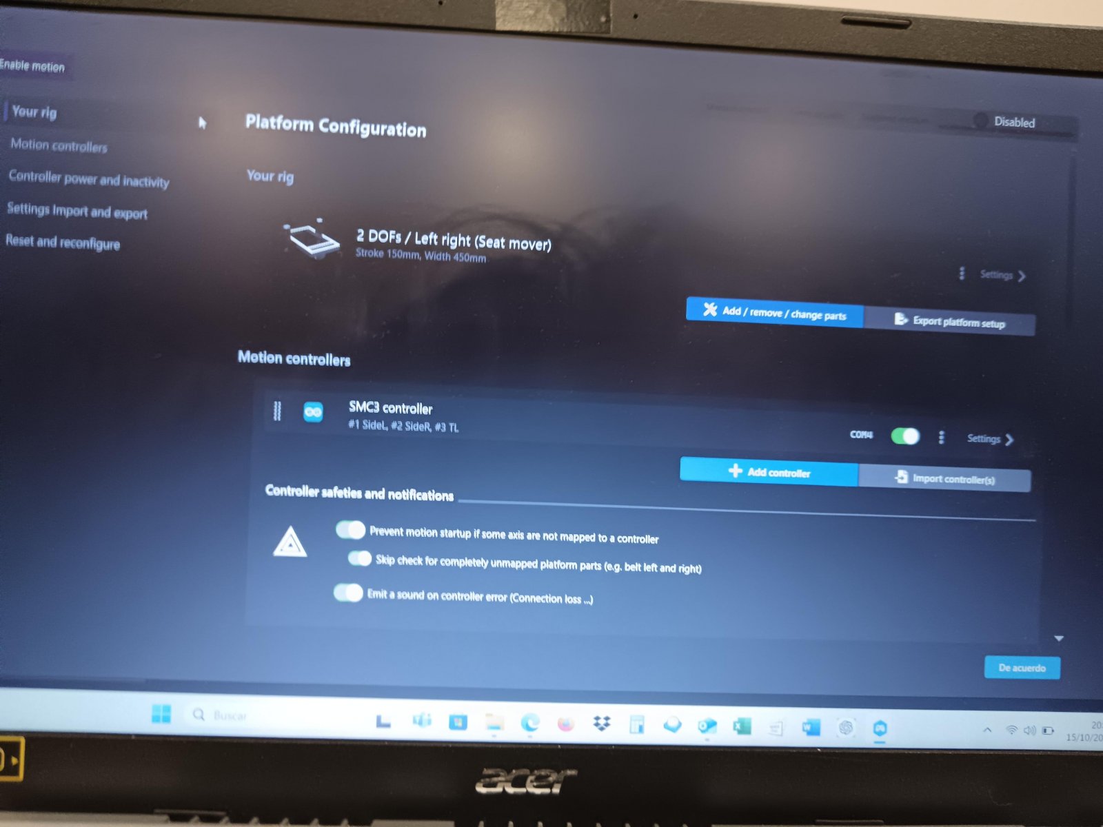

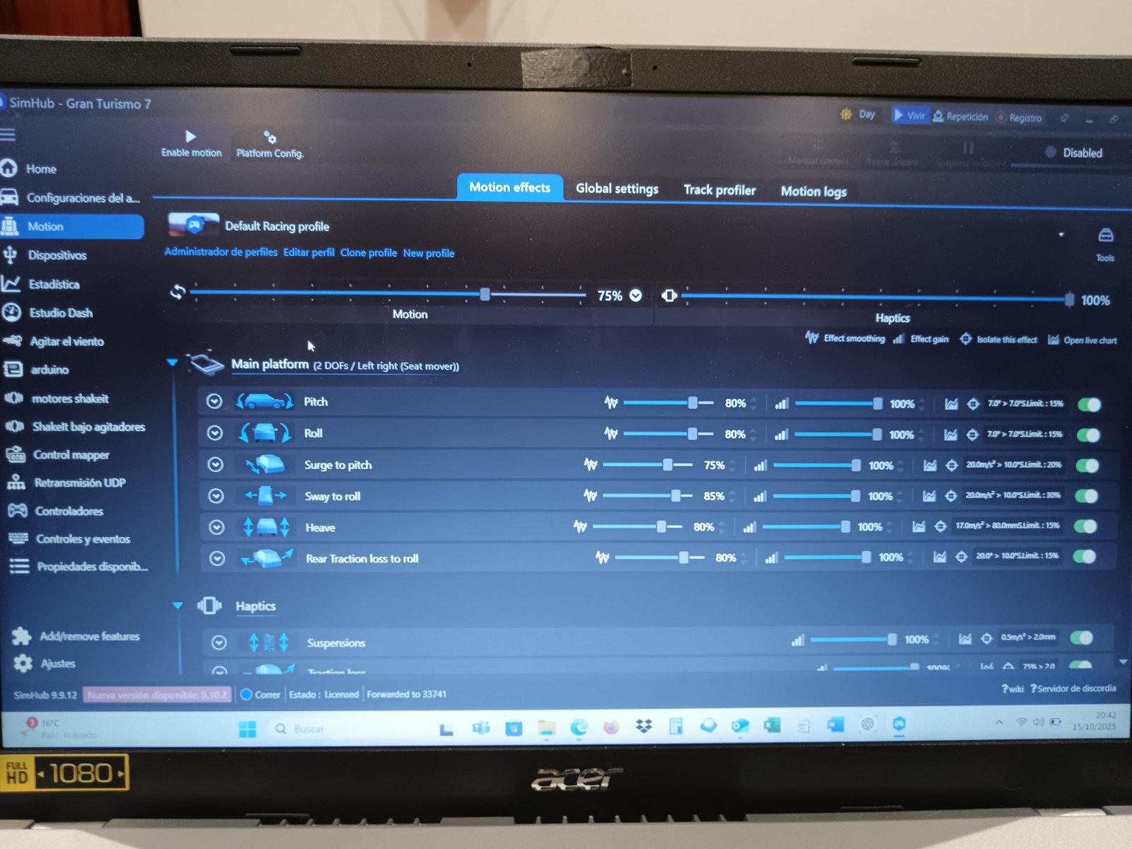

    Can you help me with the configuration of the traction loss motor?
    I have the SimHub connected to my PS5 to get telemetry for the F1 24 game, but when I start the Arduino, the traction loss motor doesn't do anything. The other two do move. SimHub does let me move the motor manually. I don't know if I need to add something to the Arduino program? Or do I have something wrong with SimHub?

    Try it in LFS or Assetto Corsa. F1 may not support traction loss.
