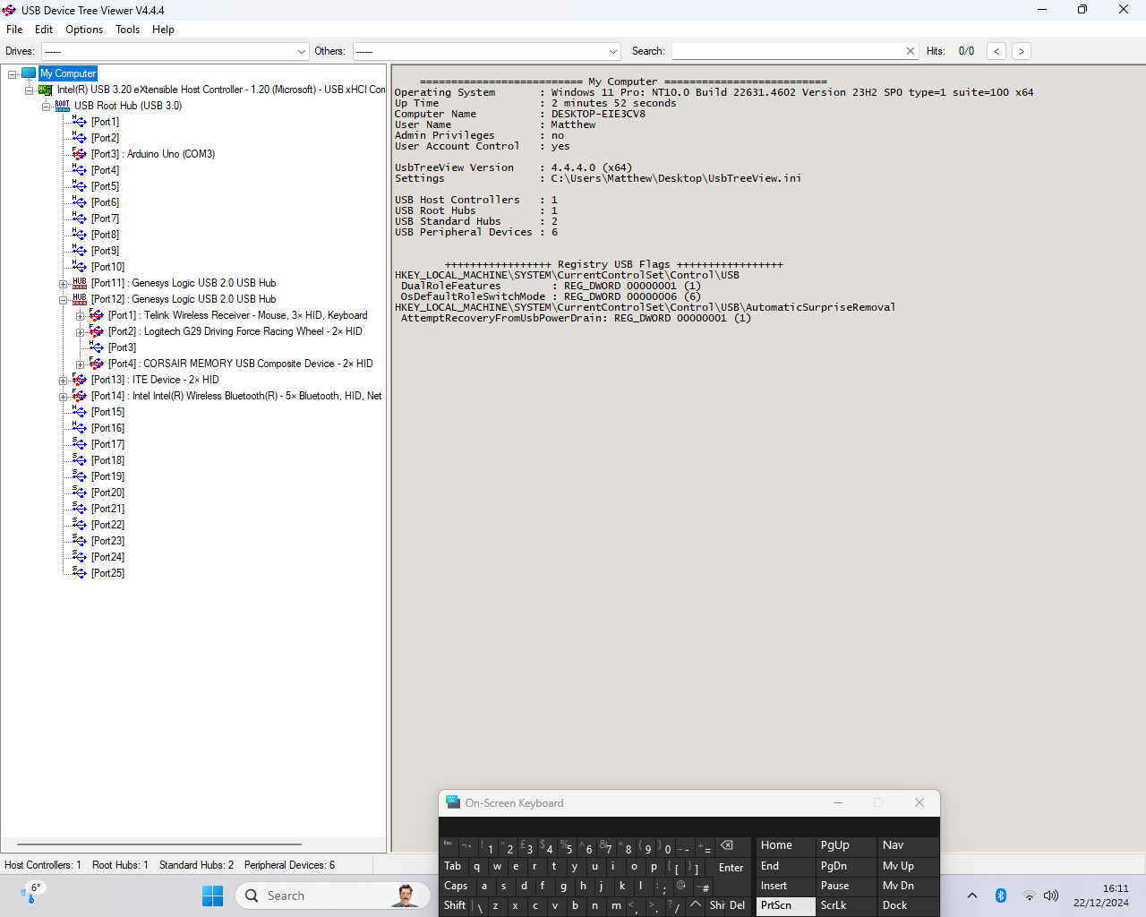

  10. Matthew Sibley
    Matthew Sibley Member
    Mar 10, 2024
    37
    209Coins
    I disabled USB Selective Suspend and downloaded device tree viewer
    ive attatched the file

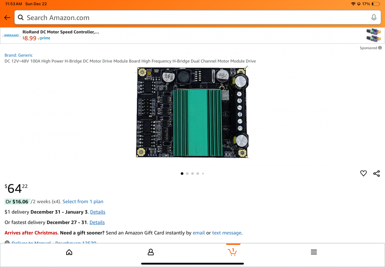

  12. Manuel Gonzalez
    Manuel Gonzalez New Member
    Dec 11, 2024
    16
    New York
    97Coins
    I used to had a very similar problem where I was able to run just one motor , when I was trying to run the second motor both ibt-2 blowing,but I was running 24v. I fixed my problem using this motor controllers.
  13. Matthew Sibley
    Mar 10, 2024
    37
    209Coins
    Mine cost me £2.90 and they're not blowing they seem fine not over heating sometimes 1 motor sometimes both but the ibt-2s seem ok I think its happening in the arduino sim tools shuts down aswell
    Thanx for the suggestion though I really appreciate it
