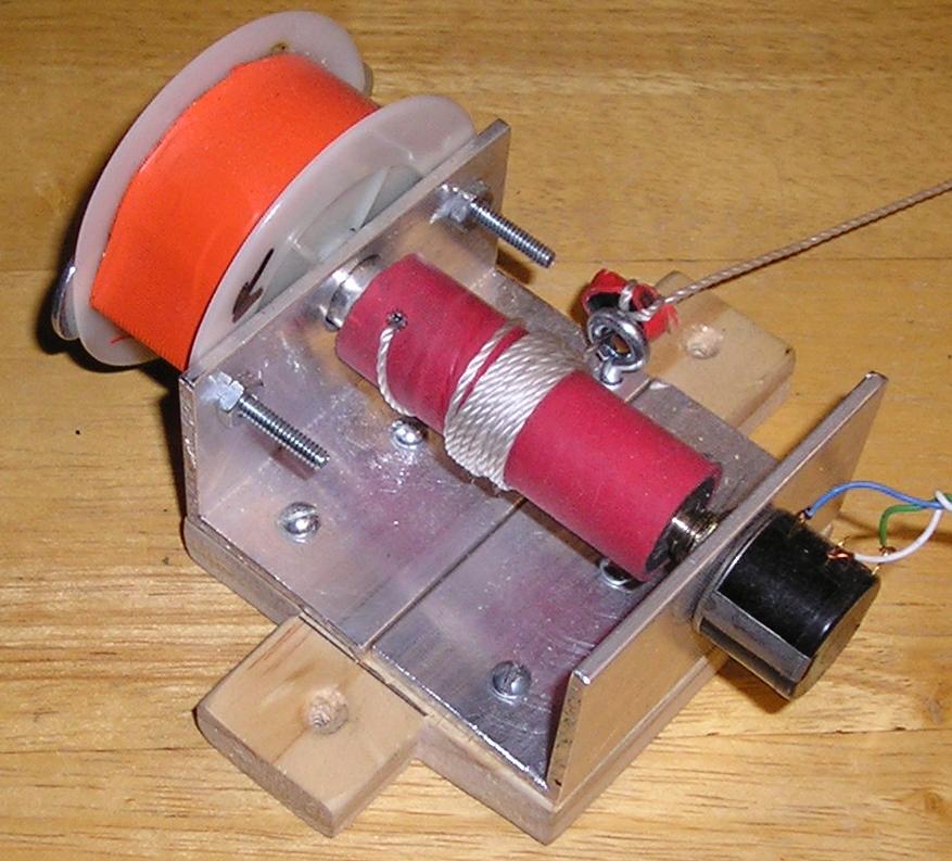

    Hello
    i search information (pictures) on the mounting potentiometer (faders) on pneumatic cylinders?
    Sincerely yours, Charles :cheers:
    sorry: for my bad english :tape:
  2. yobuddy
    5,416
    50,826Coins
    +5,170 / 19 / -0
    You could make homemade string pots with the springs from cheep tape measures.
    Once you find the right size tubing for the sting to wrap around, they are pretty easy to make.

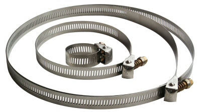

    You can connect then to the cylinder with pipe straps.
    anyway, just one idea.

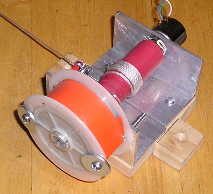

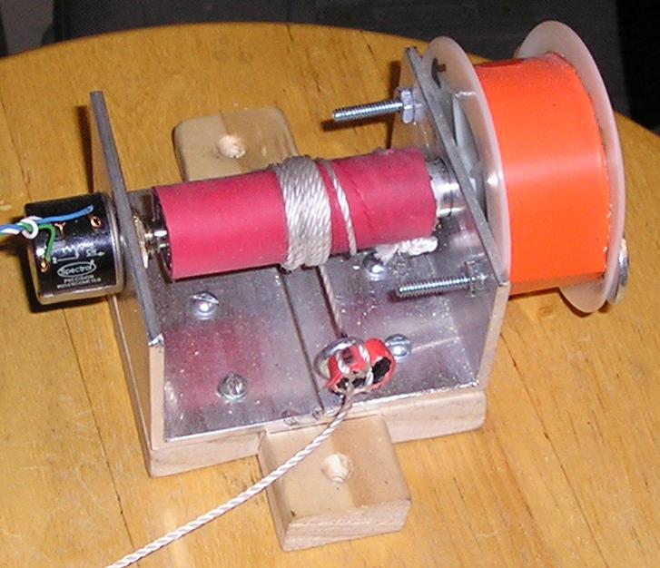

  4. ch@rles
    ch@rles New Member
    Jun 22, 2010
    26
    Bever (Belgium)
    353Coins
    Thank you for the pictures it gives me an idea how to achieve
    Merci pour les photos ça me donne une idée comment les réaliser
    Thanks Charles :hi: :thbup:

    Thanks for all these great ideas everyone!
    The string could introduce some error in the position, but great results could be achieved if done properly especially with multi turn pots.
