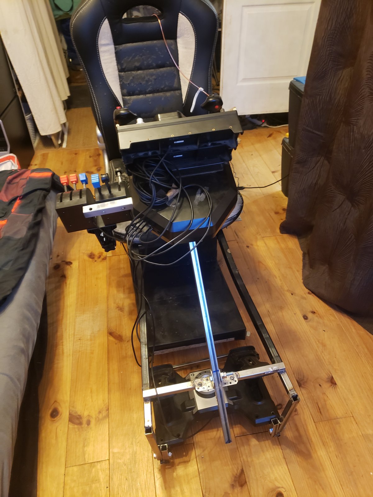

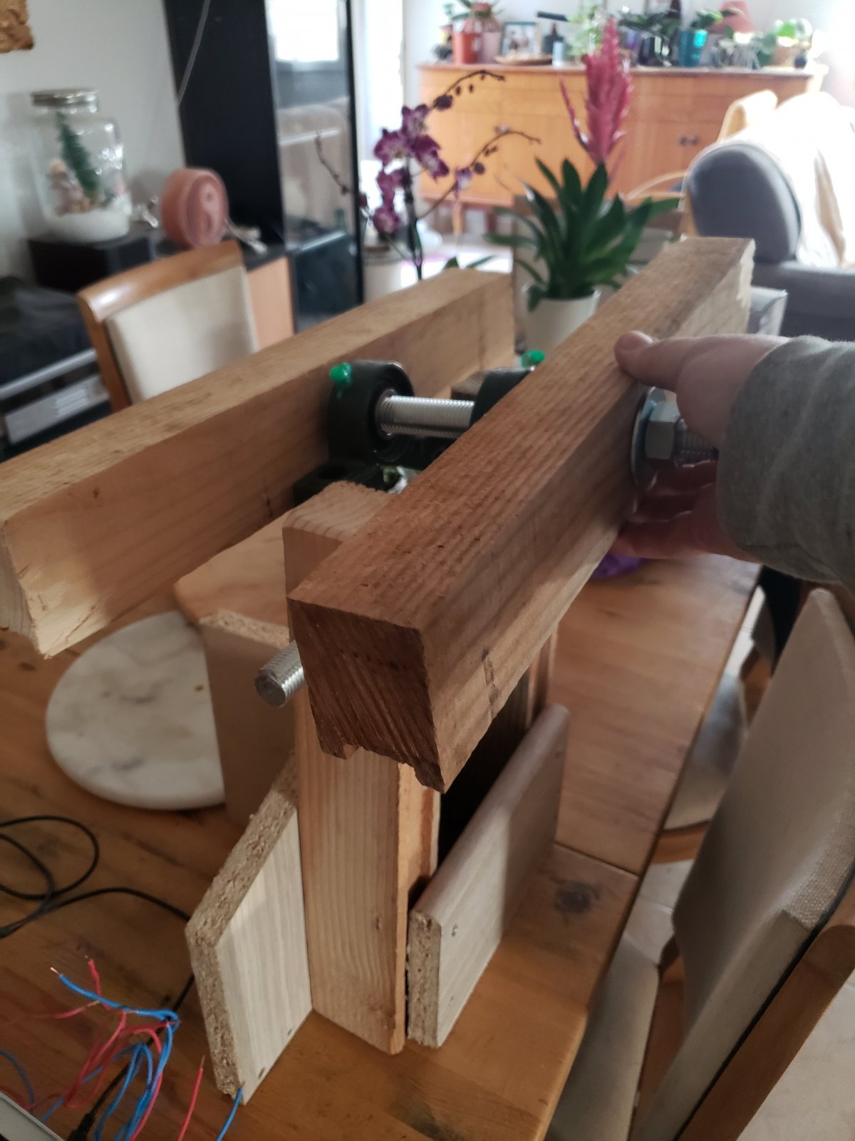

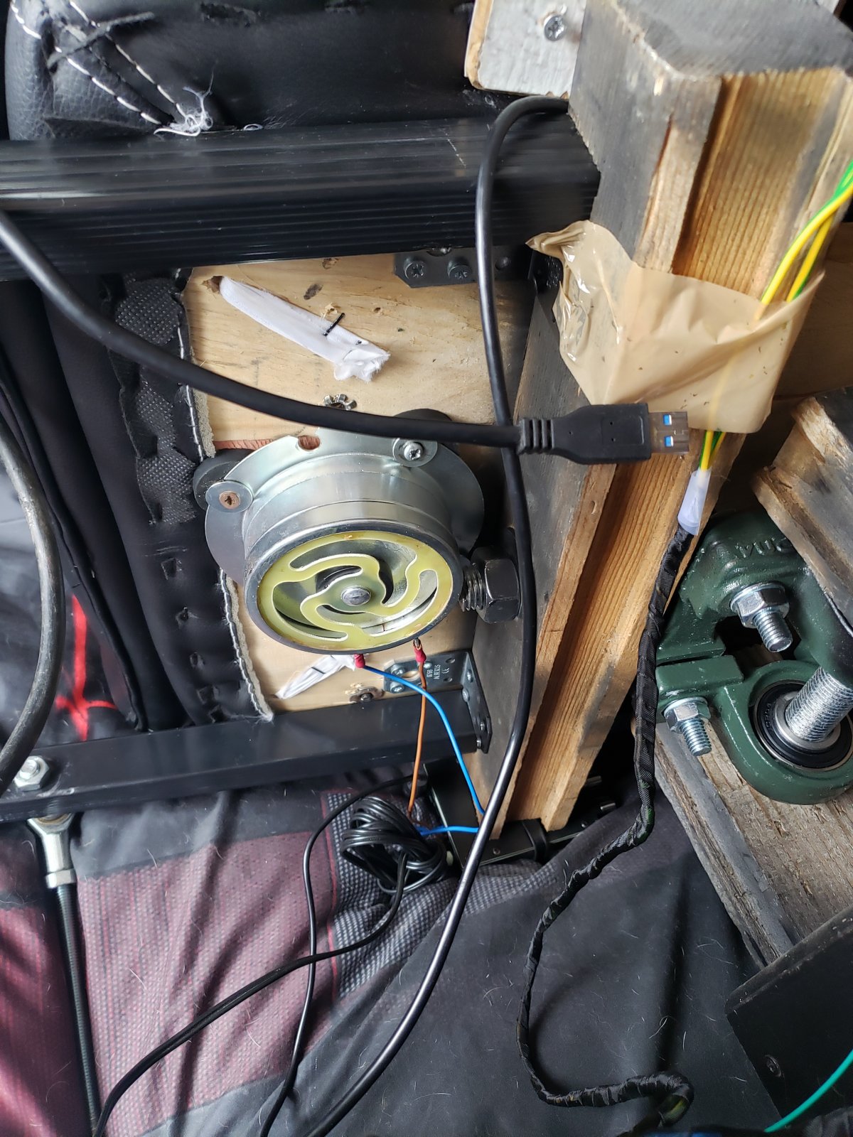

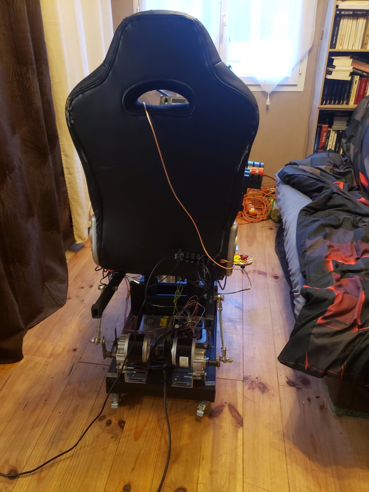

    Hello, attached are the photos of my 2 Dof project carried out thanks to Ronan's plan and base and all the advice and information found here!!
    Here the link for Ronan site :
    https://flightsimulation.romandesign.ca/roman-design-motion-vr-cockpit-project/
    3 weeks of work were necessary.
    A big thank you to all the contributors, software creators (Flypt Mover!!! fabulous!) and others found here.
    Here the goal was to make a 2 DOF as cheaply as possible; I had the chair found at the recycling center, the wood, some screws and the metal bars.
    The rest, motors, cards, controller, power supply, gimbal cost me €350 (same in dollars not far off...).

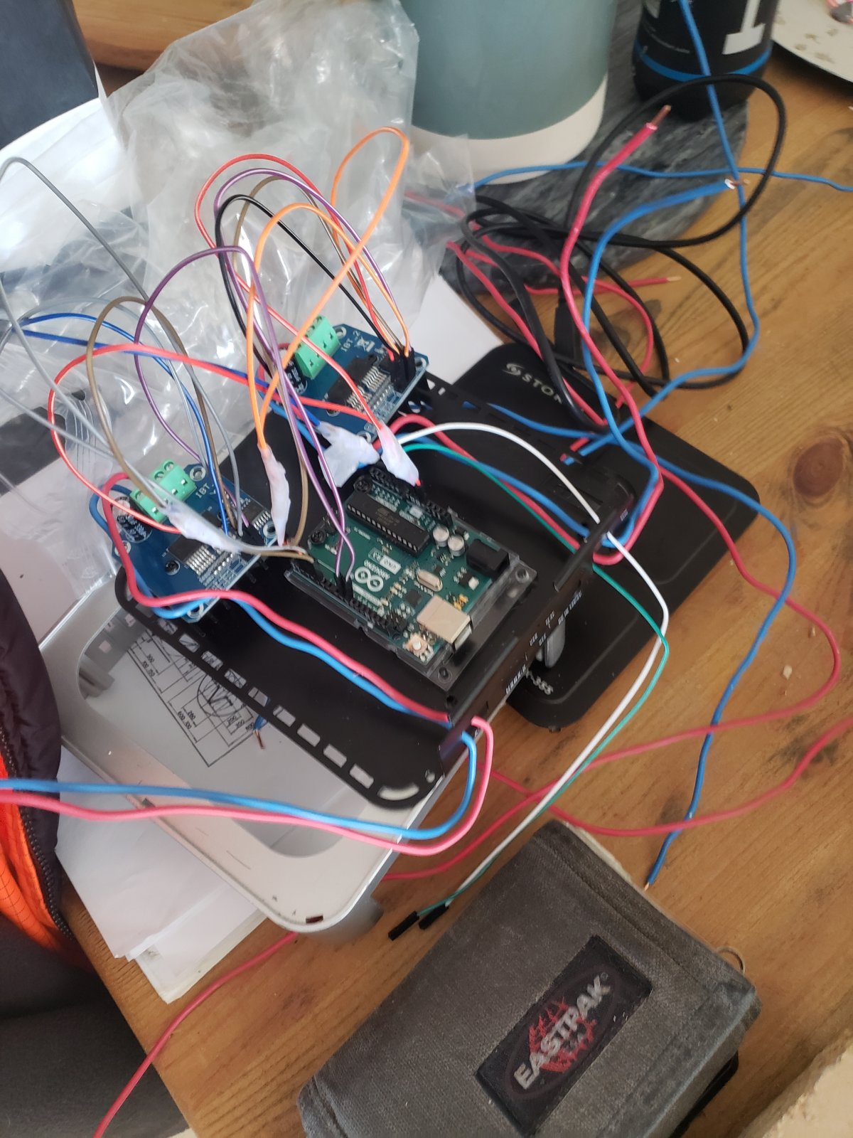

    I complete with the list of materials :
    Low speed brushed DC gear motor for electric wheel, 250W, 24V, 75 foldable, 120 foldable, 44mm long, diameter 17mm
    Gebildet Stainless Steel Metal Latching Emergency Stop Push Button Switch 22mm 12-220V 3A 1NO 1NC with Connection Socket
    4 Pieces Si10t/k Rod Ends Bearing Metric Female Thread, Right Hand Spherical Joint Bearing, Relia Bearing, Spherical Bearing, Female Thread, Oscillating, Right Hand Spherical
    DeWin Capteur Hall, Résolution du Capteur d'angle Hall 0,088 ° 0-360 Degrés Capteur d'angle Hall Rotatif 0-5v Sortie Cercle Complet 12Bit
    Youmile BTS7960B Motor Driver Module Dual H-bridge PWM DC Stepper Motor Controller Arduino Current Limit Smart Car Driver Module with Dupont Cable
    Arduino UNO REV3 microprocesseur
    The rest of the hardware from your dealer (threaded rod, bolt, screw).
    I lost the gimbal references...
    .. sorry !

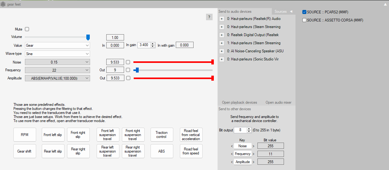

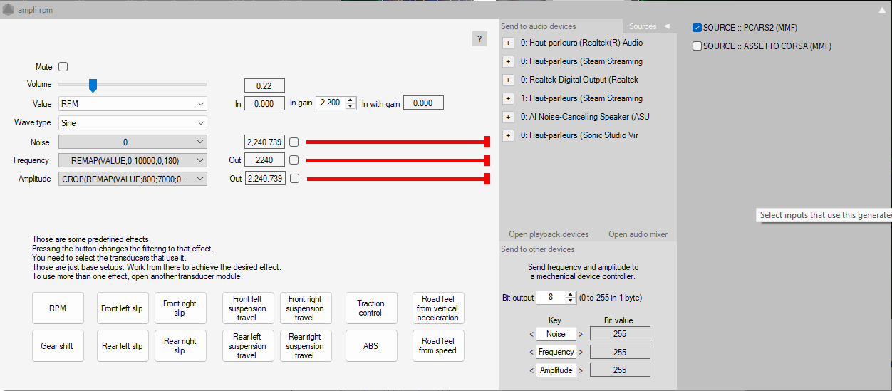

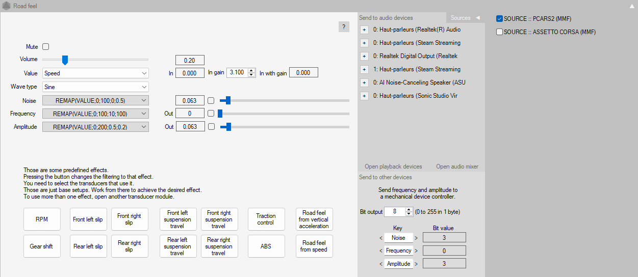

    Update for the pot, and for the stability
    The last it's a basshsaker (with simhaptic),

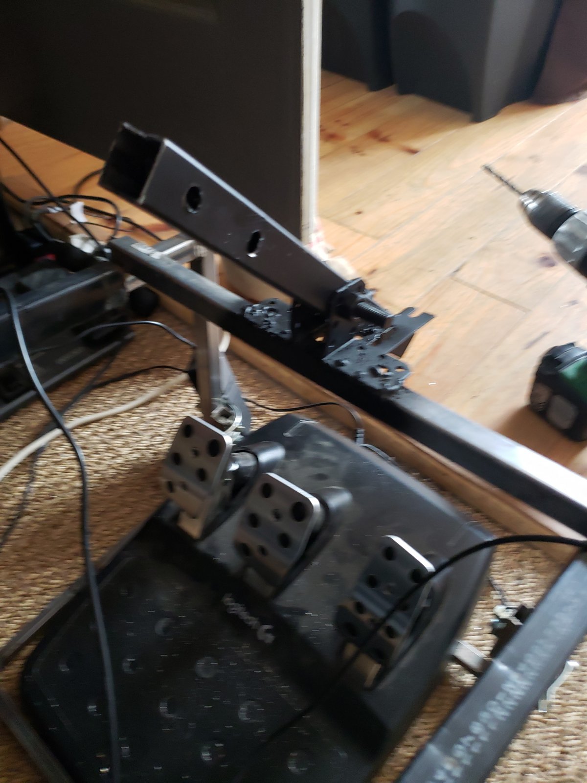

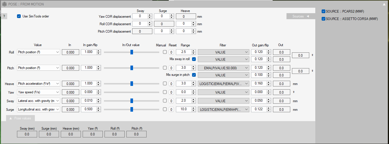

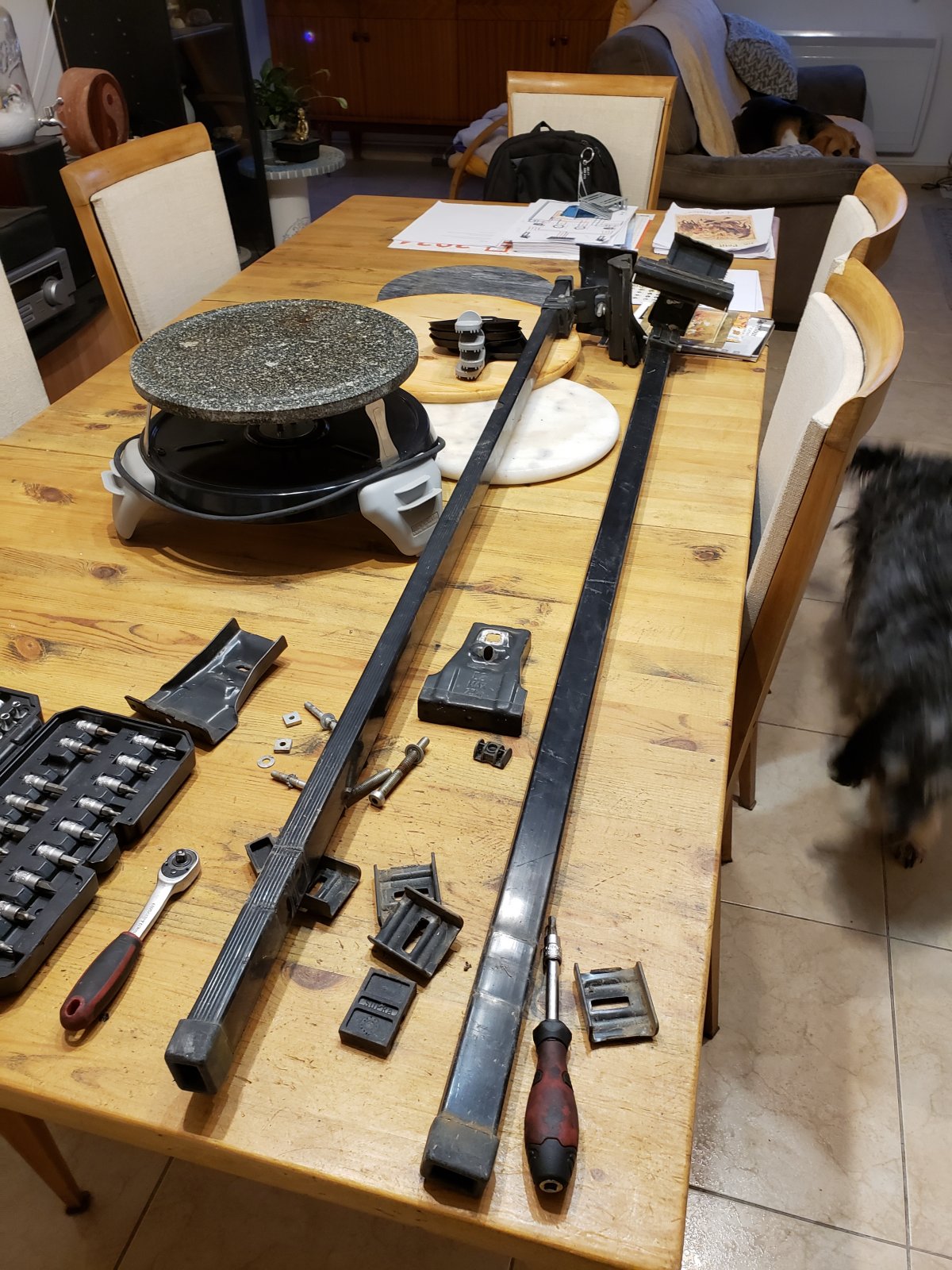

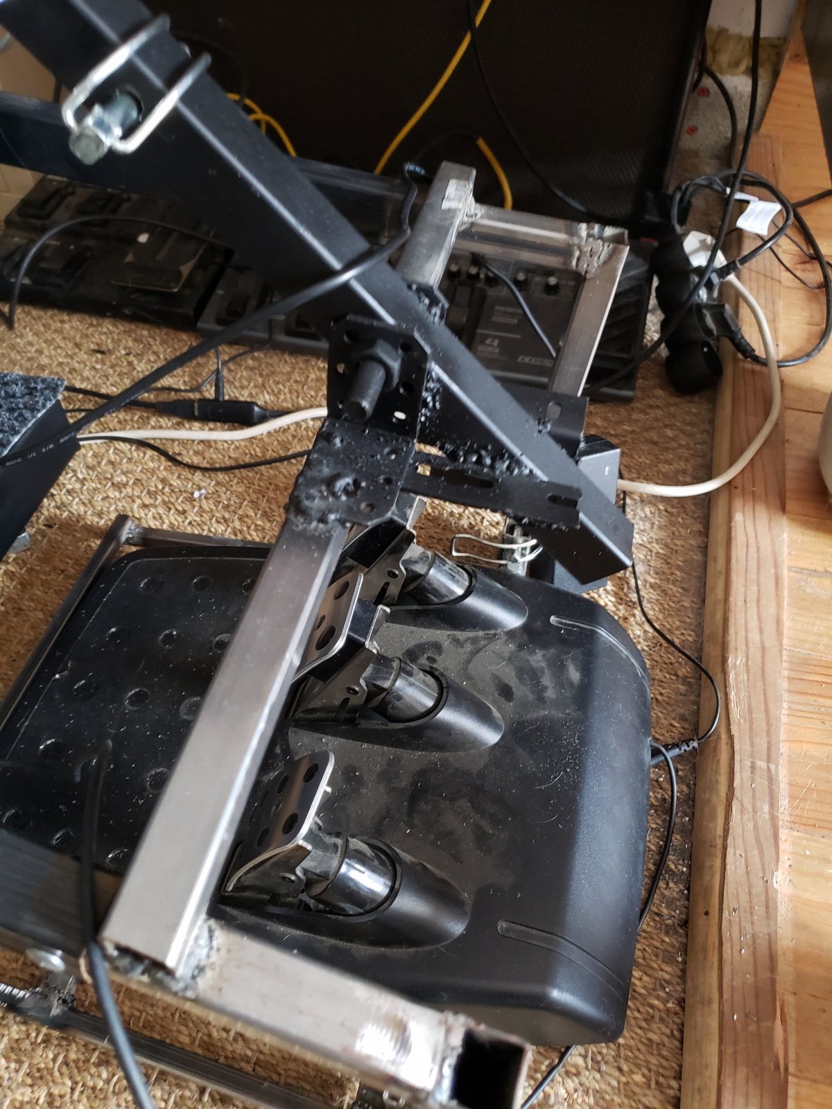

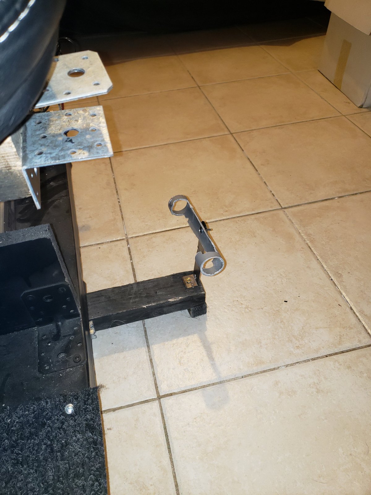

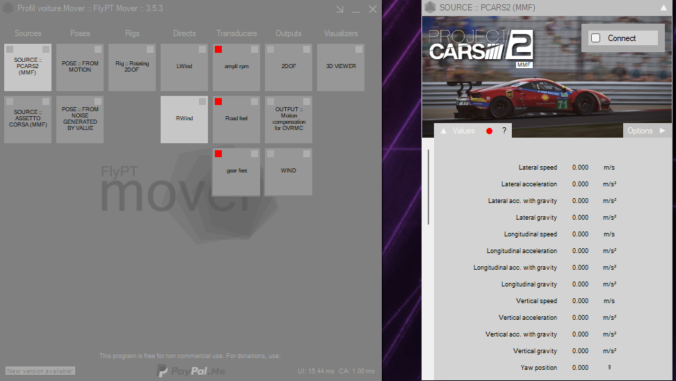

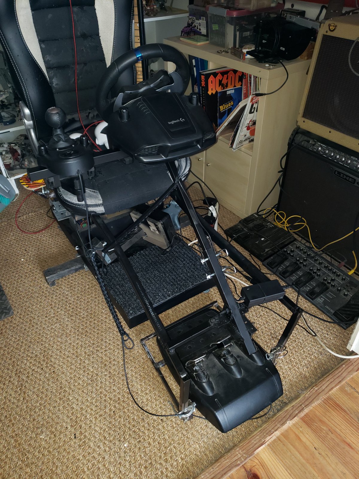

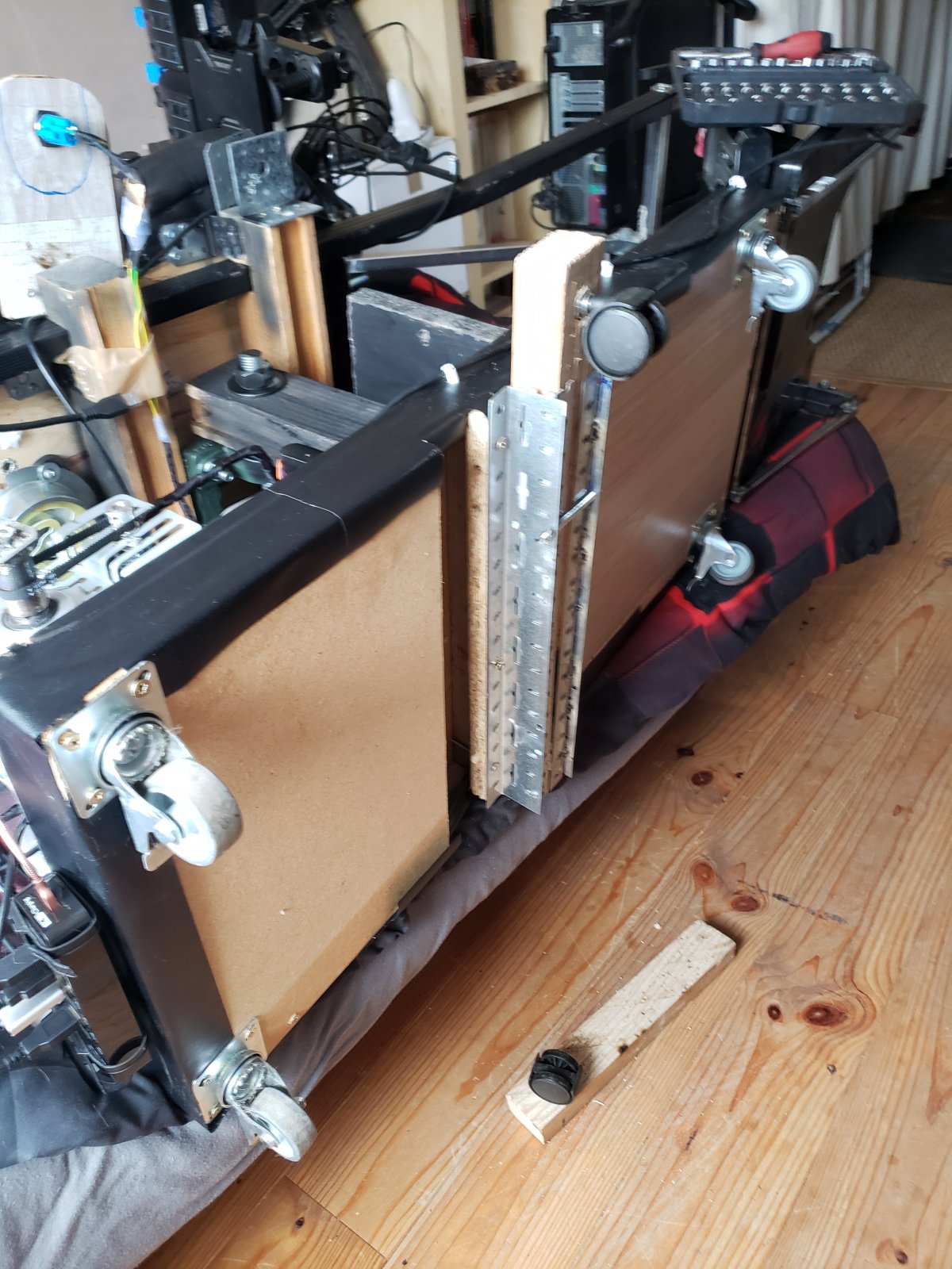

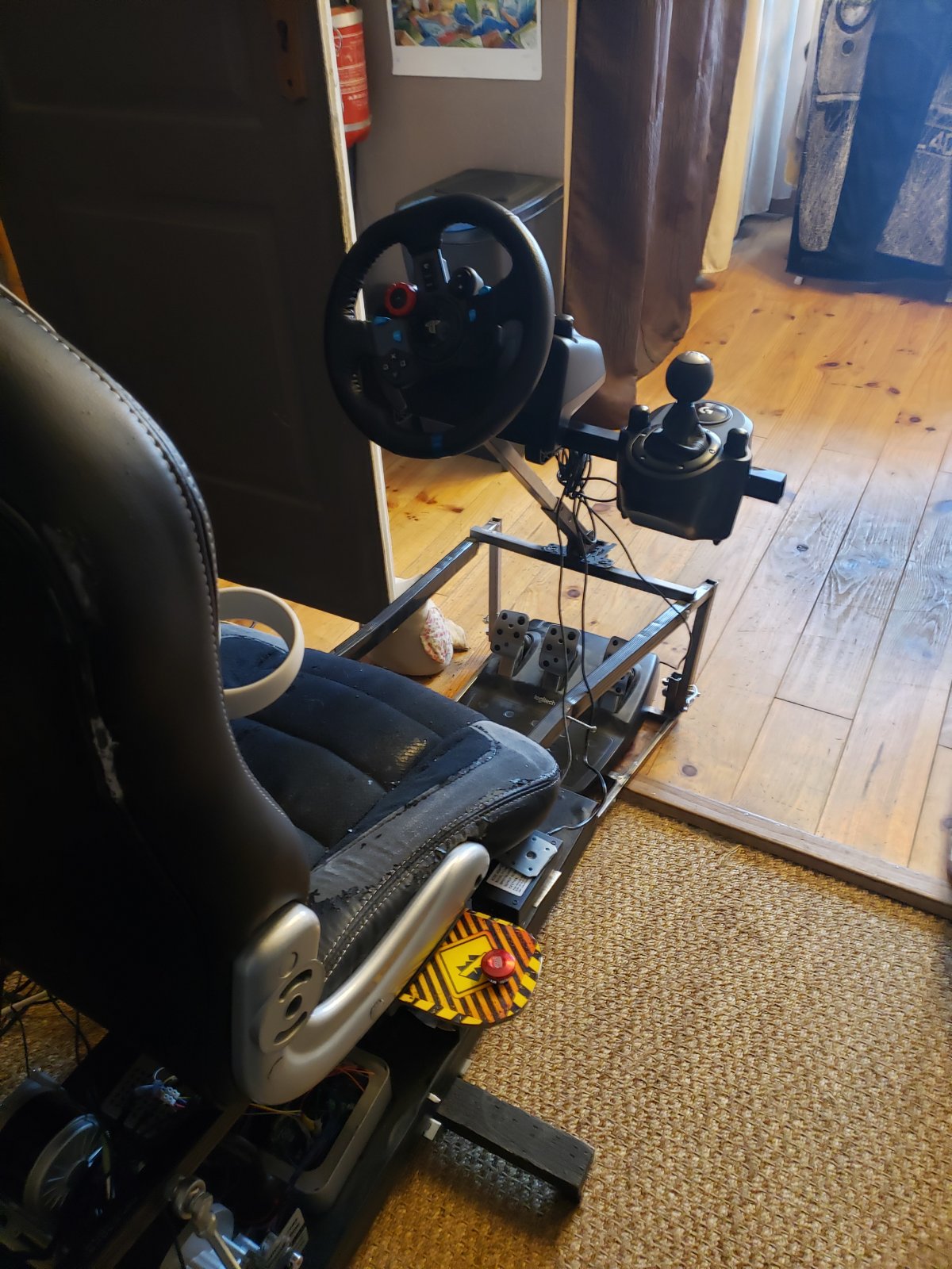

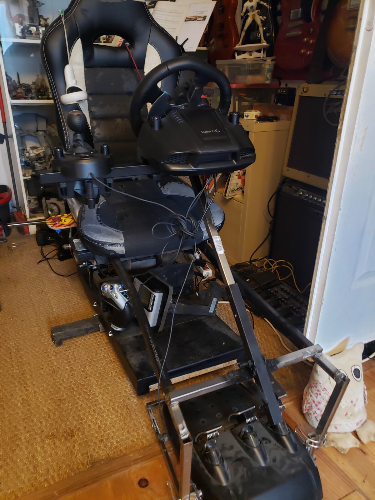

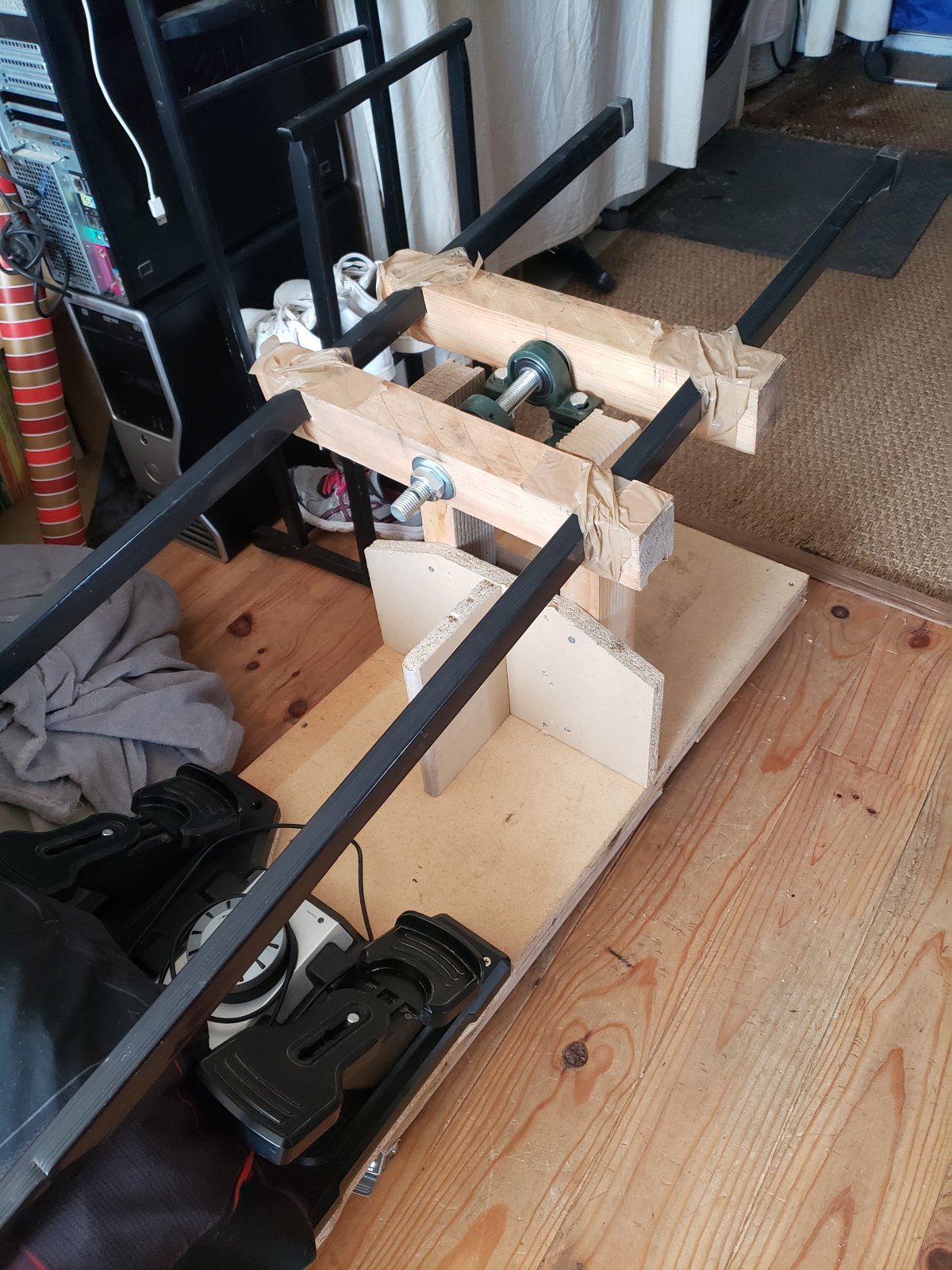

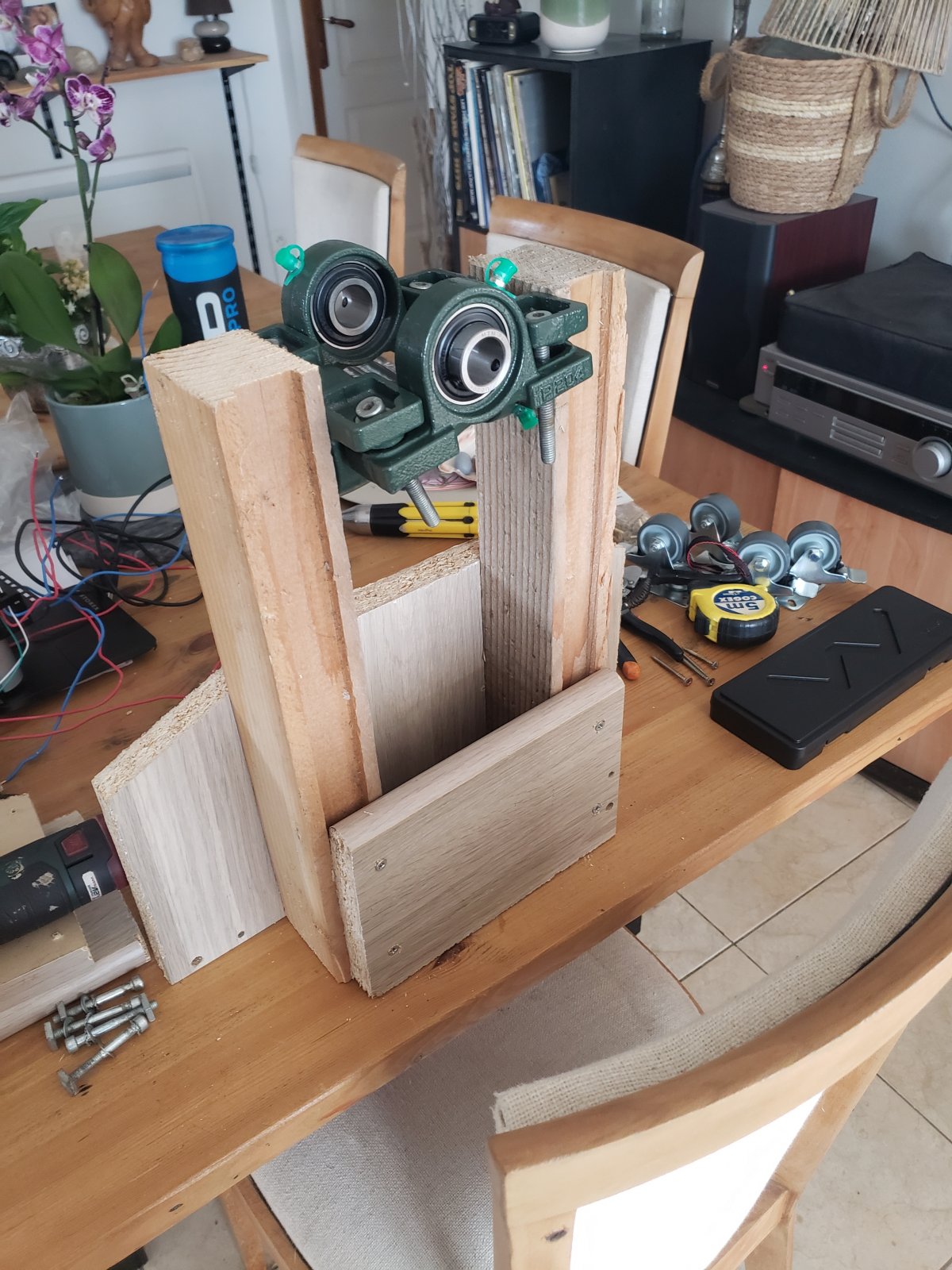

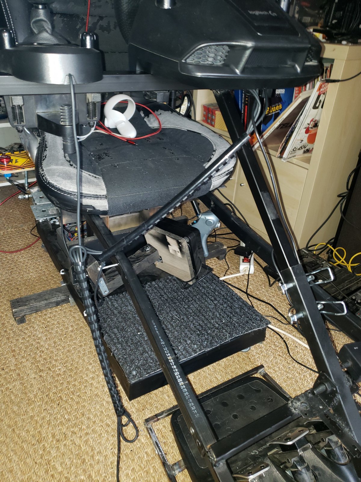

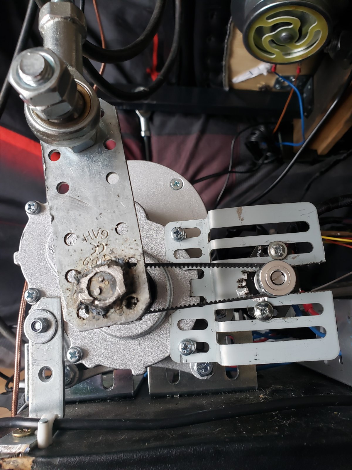

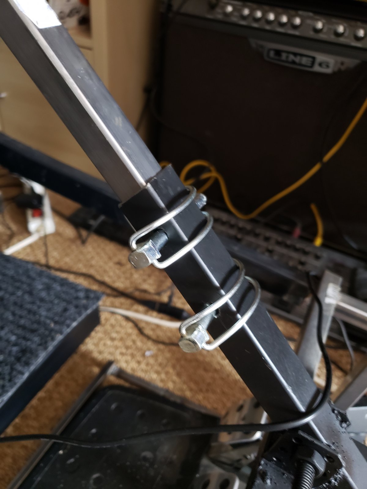

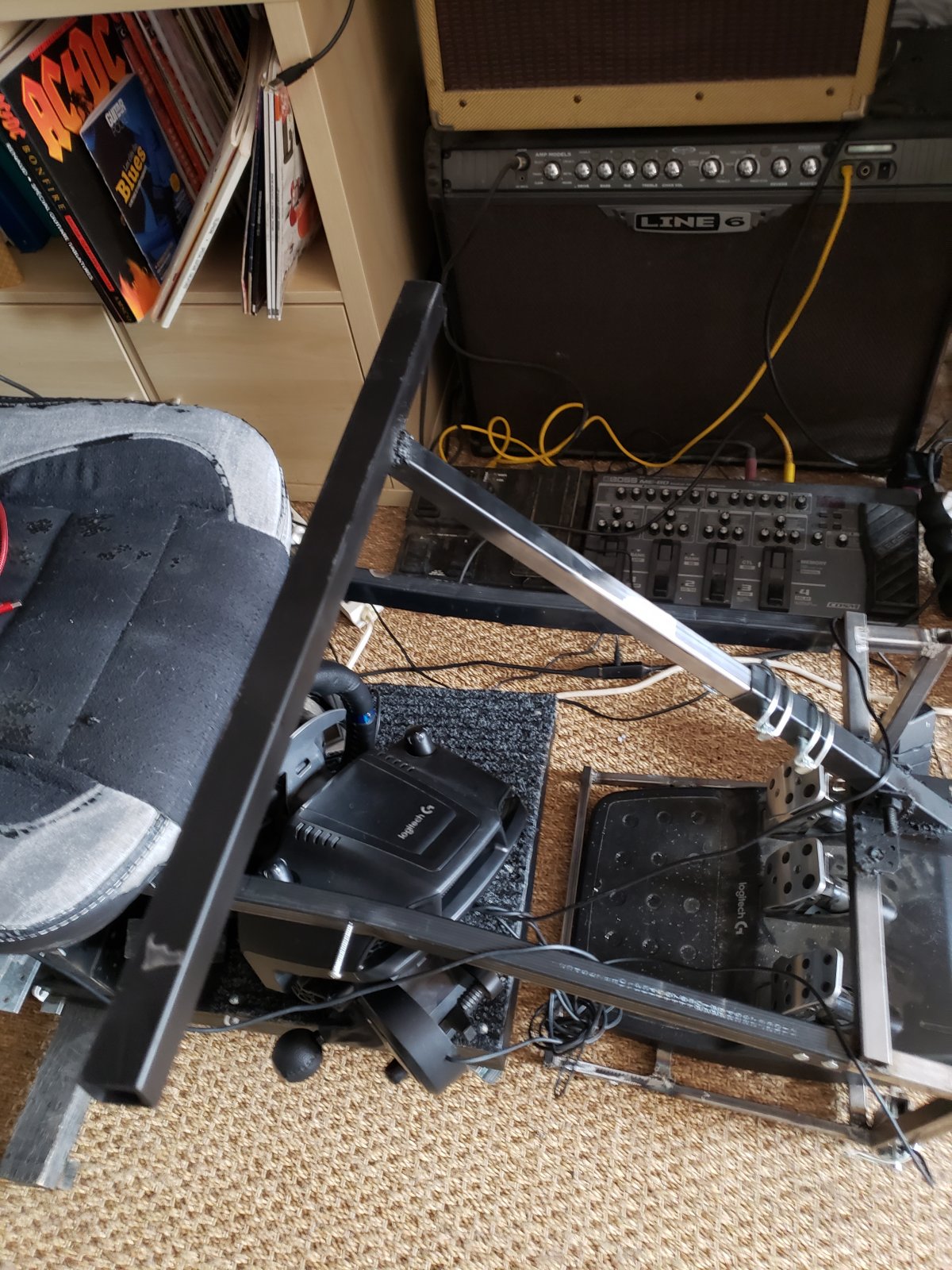

    Hello everyone, I have just finished modifying my chair to be able to change from the plane cockpit to the car simulation.
    For the moment I'm settling with Project Cars 2, and it's still a little rough, I'm having trouble with certain filters.... I have to test and therefore have a lot of time.
    So my adaptation carried out in several stages:
    [​IMG] [​IMG]
    The last 2 images show the completed car version simulation, I had the idea for the cables to use school notebook clips ;)
    The advantage of having done so with a central sheath, I can go from the plane version to the car version in 10 minutes!
    And here the link to the test video under Project cars 2 (too violent, I have to soften a lot otherwise my chair won't hold up!!)

    Hello, here is a code arduino who run with my 2 DOF (start slowly found here at the "
    Arduino code for use with various hardware and SimTools") :
    // #define ENABLE_POT_SCALING
    it was active and paralyzed my potentiometer, it took me a moment to understand that it came from this single line!

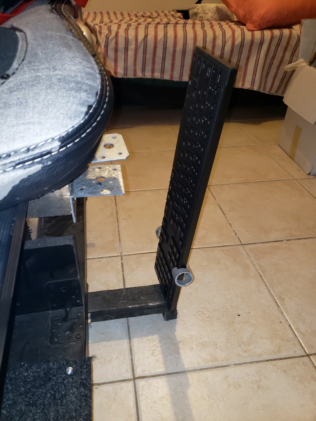

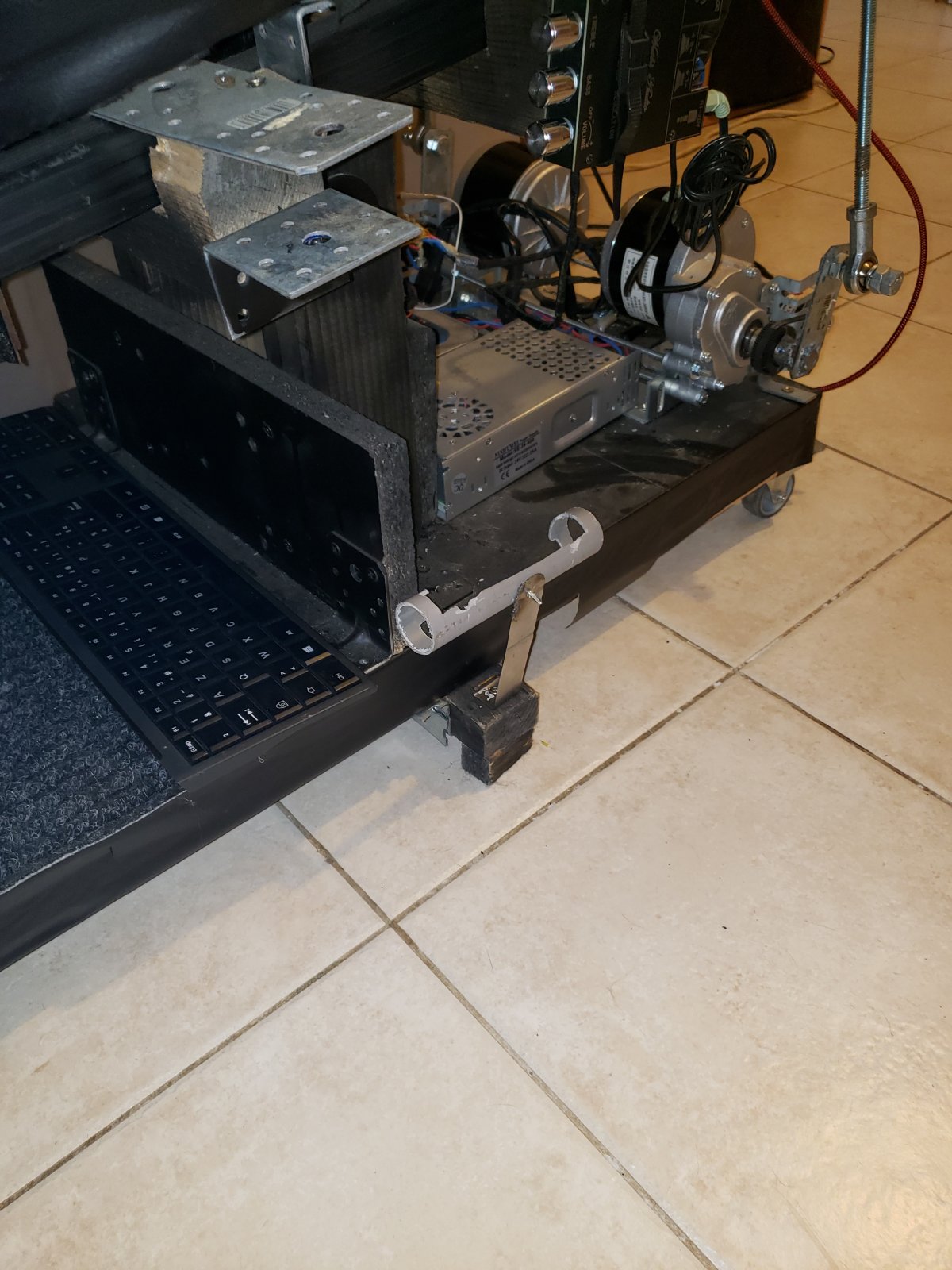

    [​IMG] [​IMG]
    Just with a small piece of PVC tube to work with Dremell to hold my keyboard ;)

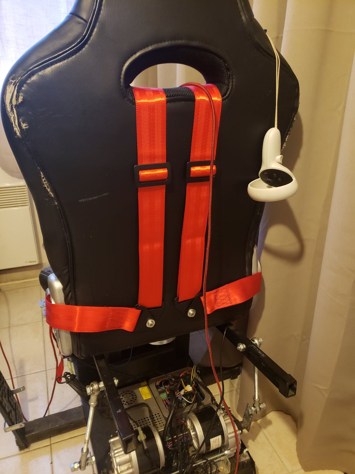

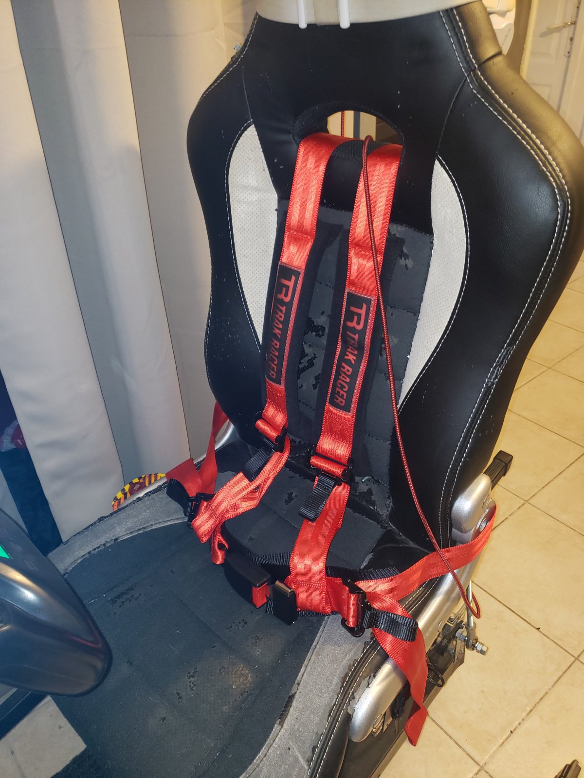

    Addition of 4-point belt (used €50)
