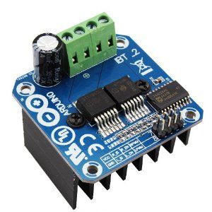

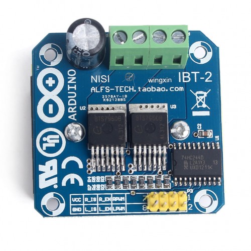

    bts7960 ibt-2 for all motors i used

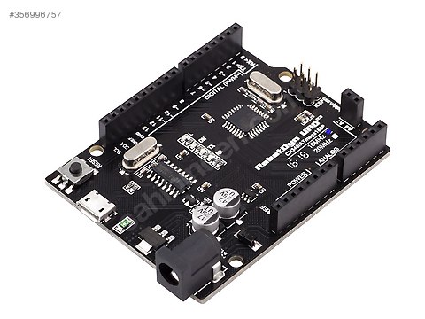

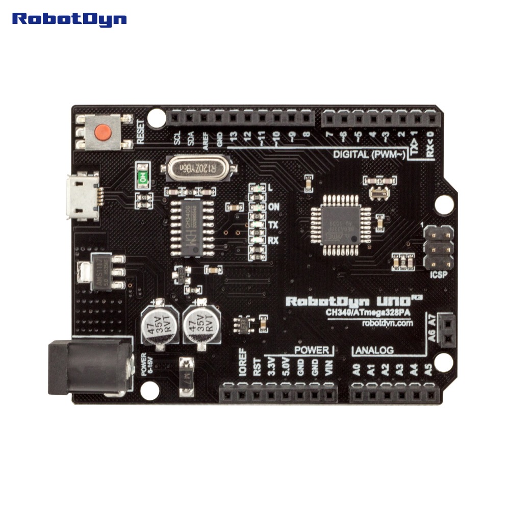

    i used a clone arduino for my 2dof sim. smc3 working good with clone arduino.
