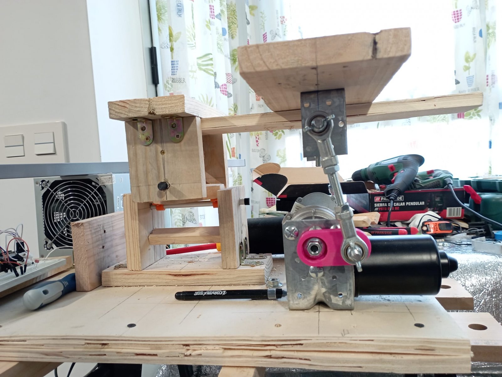

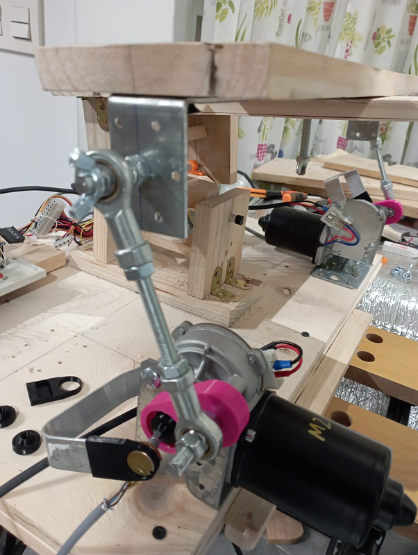

    Hi all. I started to build my 2dof some weeks ago but during the holidays I have progressed a little bit.
    I have used wood (from recycled pallets) and PLA. These are the tools I have in my appartment and I think they are enough.
    The universal joint is made up of 2 8mm steel rods, wood and some 3d printed parts that work as mounted bearings (I will change them by mounted bearings in the future.
    The motor crank is also 3d printed. My wipers have a dented cone but de did not bring the crank, so I had to design one (magenta piece)
    I also chose regluar 10k pots which I fix them an aluminium flat bar and 3d printing parts (black parts), a cap for the axis nut and a holder for the pot.
    I still need to tame SMC3 not to go beyond limits and break the pot holder.
    I attach the stls in case you are interested.

    Hi Issalig, are you using wood and bolts as your u-joint? will it hold?

    Check this video:
    This guy did the u-joint out of plastic, then it broke and he had one welded.
    Mine is also based on pillow bearings and then i use wood as flanges - i'm still building it, I weigh 95 kgs and hear the wood creaking when i sit - and the sim platform is not yet finished yet.

    Nice video. Mine also creaks (as an old ship) even with the 12kg (water jugs). I don't have a metal welder so I will still go wood and maybe use an ujoint from a car.
    Now I am deciding if the crank-rod angle should be bigger and almost 90 or just leave it in this 70 something.
    21,242
    149,126Coins
    +10,929 / 54 / -2
    Keep in mind a lever's most effective torque utilisation is at 90 degrees. and that degrades in a nonlinear manner, rapidly so after around 38-40 degrees up and down. What I mean is τ = r F sin(θ): https://www.omnicalculator.com/physics/torque

    Thanks @noorbeast , I was thinking also this but a lot of designs show angles with less than 90 and I was just curious. I will change it to 90.

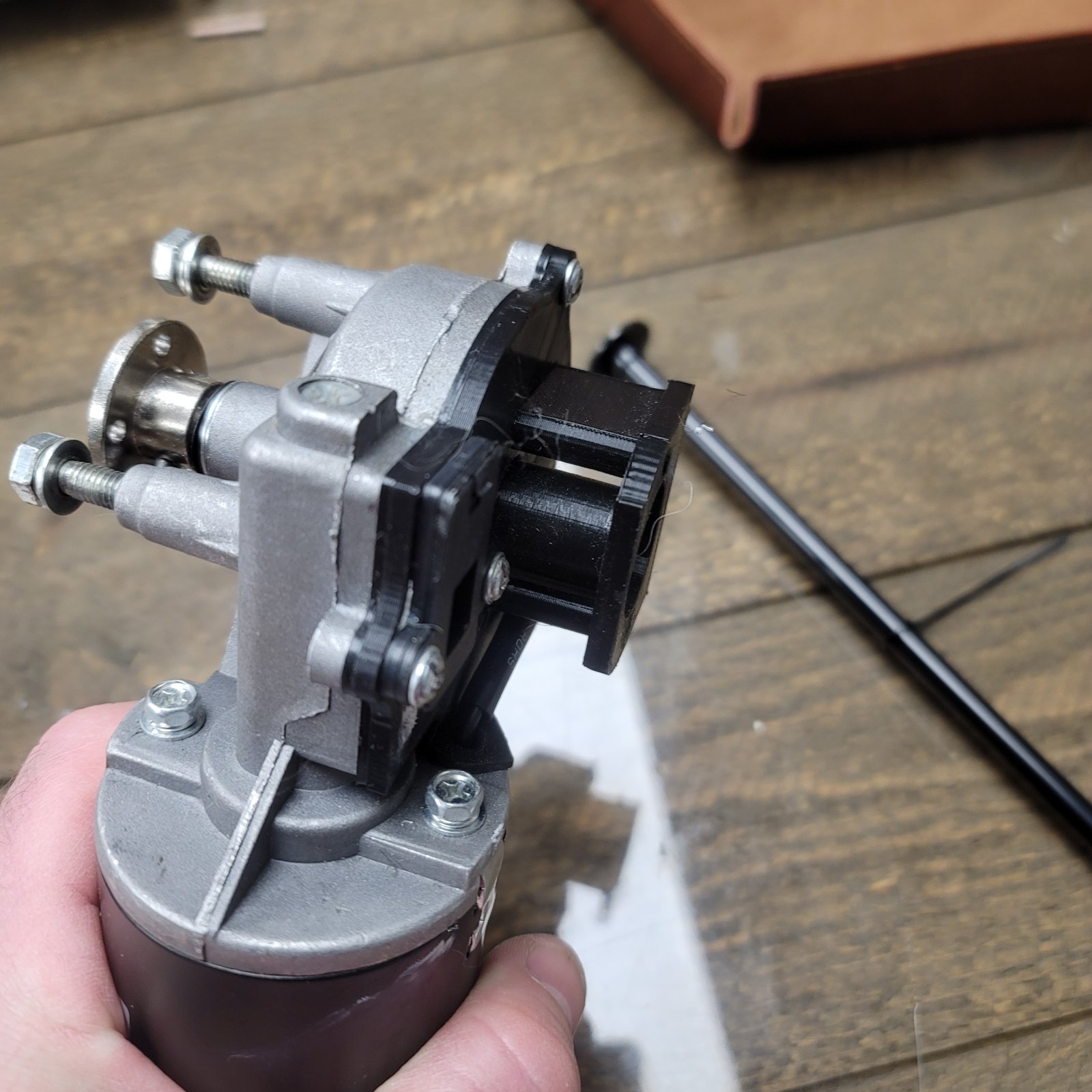

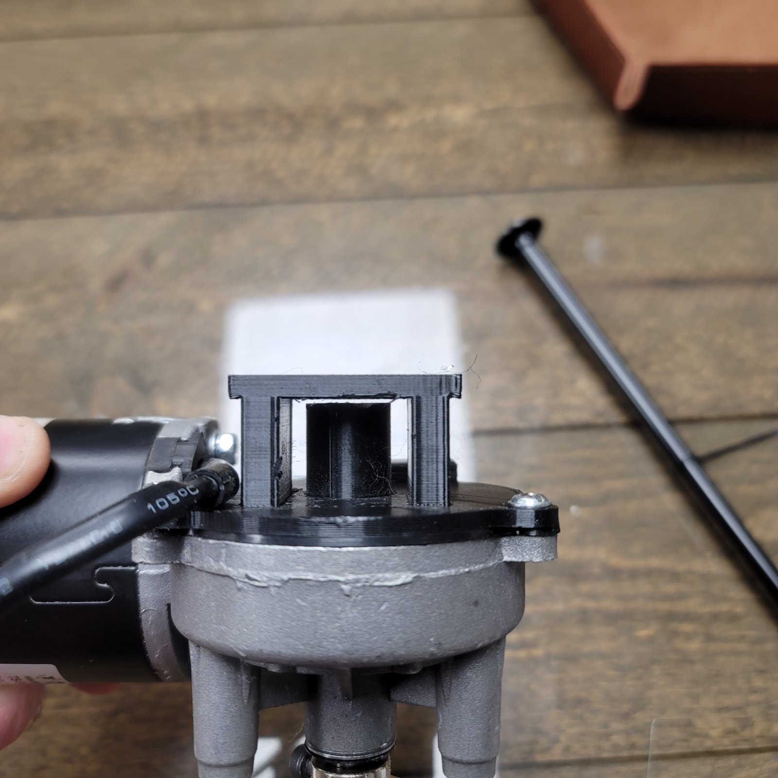

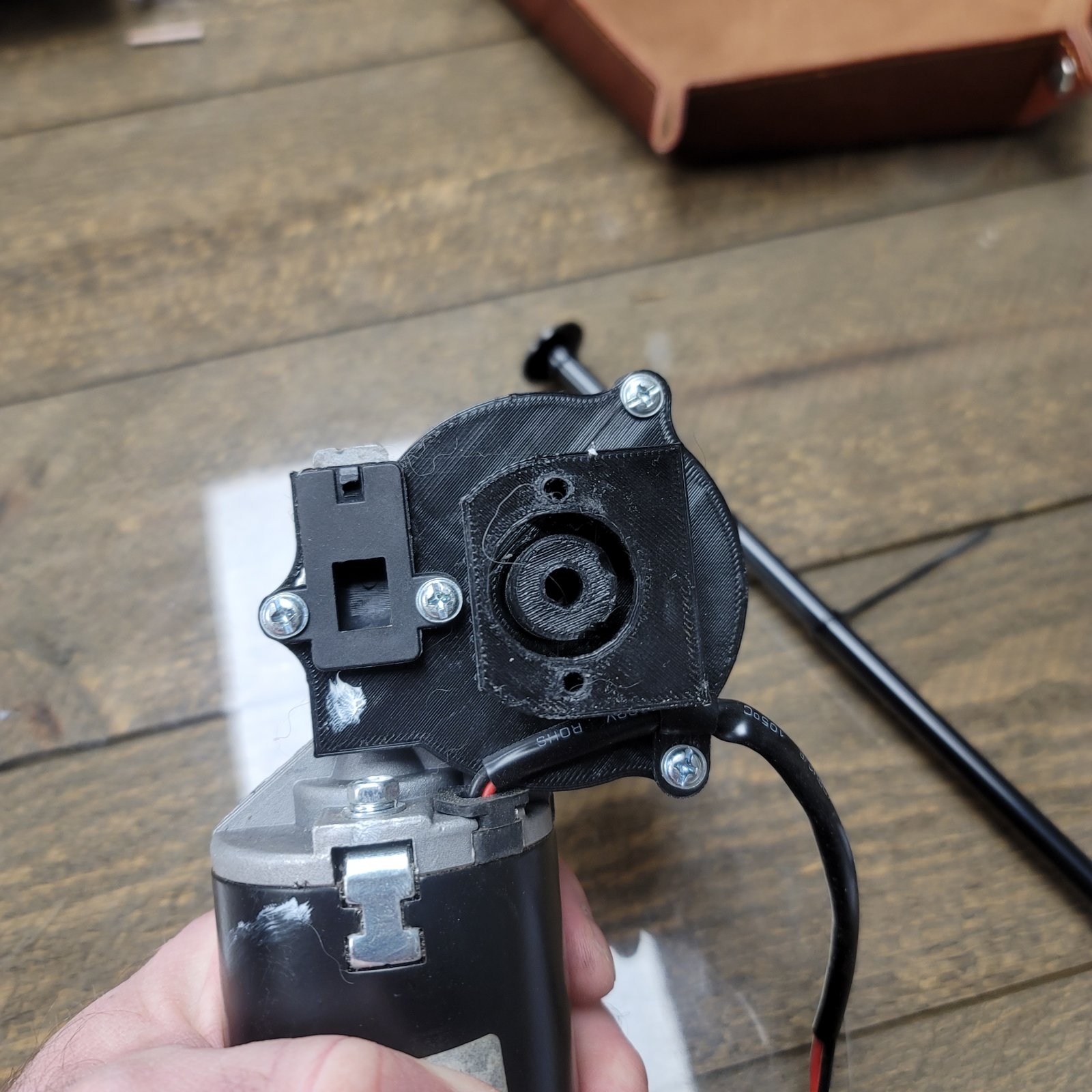

    when i was experimenting with that motor i 3d printed a new back plate to mount the pot and used the nut on the bearing to spin the pot. it was an easy design even with my limited skill at the time. if i find the motor i will post a pic.

  11. Rosebomb
    Rosebomb Member Gold Contributor
    Aug 28, 2022
    37
    147Coins
  12. Rosebomb
    Aug 28, 2022
    37
    147Coins
    It was an easy design in tinkercad

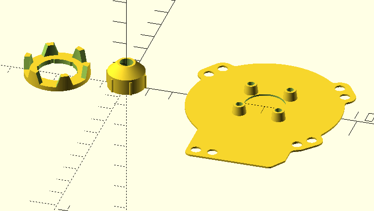

  13. issalig
    issalig New Member
    Nov 22, 2024
    13
    Europe
    56Coins

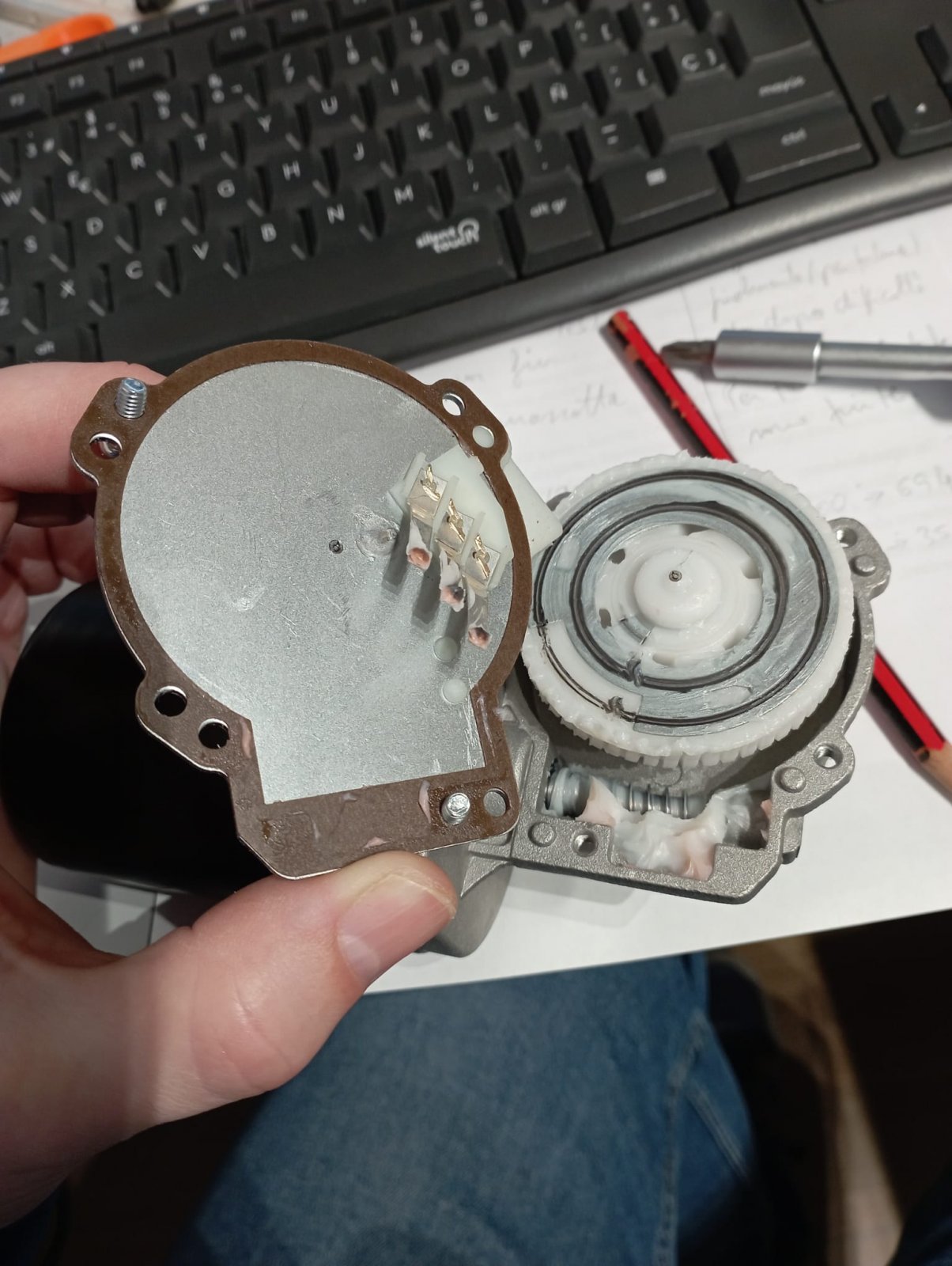

    Which motor are you using? I am using a topran 108792, the one that used to be in VW Polo and others but I think it is not easy to enlarge the shaft and make it on the other side.
    Anyway I have designed a dxf with the contour of the backplate and I attach it here.
  14. Rosebomb
    Aug 28, 2022
    37
    147Coins
    looks like different motors. do the contacts have to stay on the back plate? you may be able to design a coupler to glue on to the round nub and remake the back plate with a hole like i did but if the contacts have to stay it may be a bit harder
  15. issalig
    issalig New Member
    Nov 22, 2024
    13
    Europe
    56Coins
    No, these are for short, long or continuous movement of the wipers.
  16. Rosebomb
    Aug 28, 2022
    37
    147Coins
    I think you could do something similar to what I did then with tinkercad.
  17. issalig
    issalig New Member
    Nov 22, 2024
    13
    Europe
    56Coins
    Well, I am doing it with Openscad and qcad :)
    A crown that fits onto the gear, an adapter that joins the crown and the pot crank, and the backplate. Quite a long journey of designing but I enjoyed it.
  18. Rosebomb
    Aug 28, 2022
    37
    147Coins
    i will definitely be trying those programs as tinkercad lacks some features i want but fusion has to steep of a learning curve. your model already looks more polished then mine good job.
