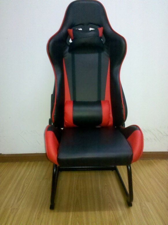

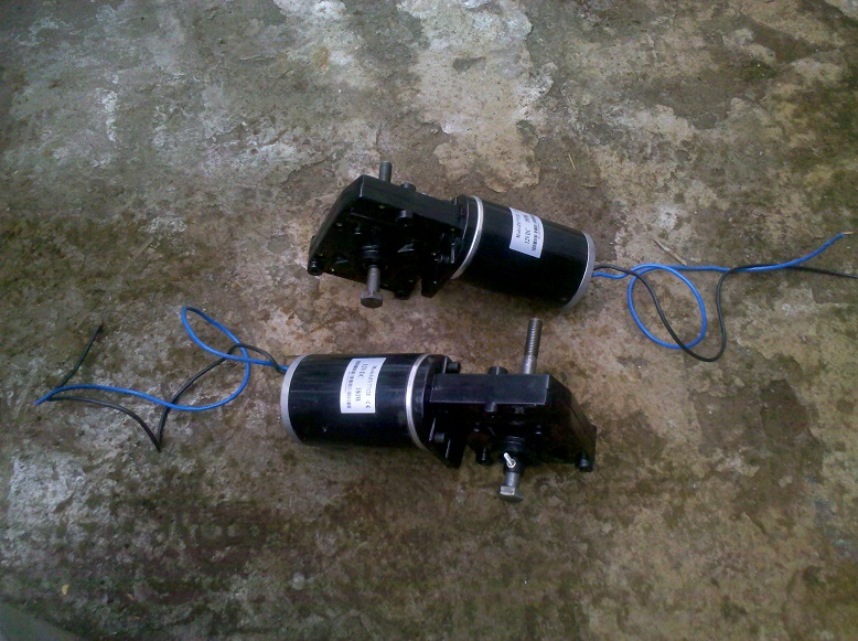

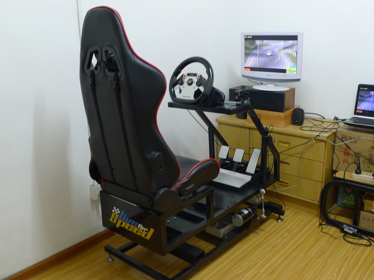

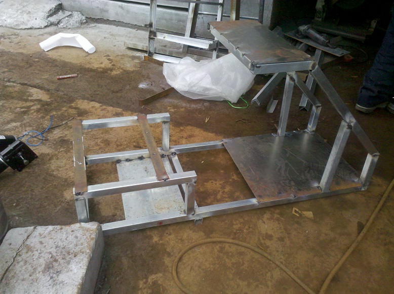

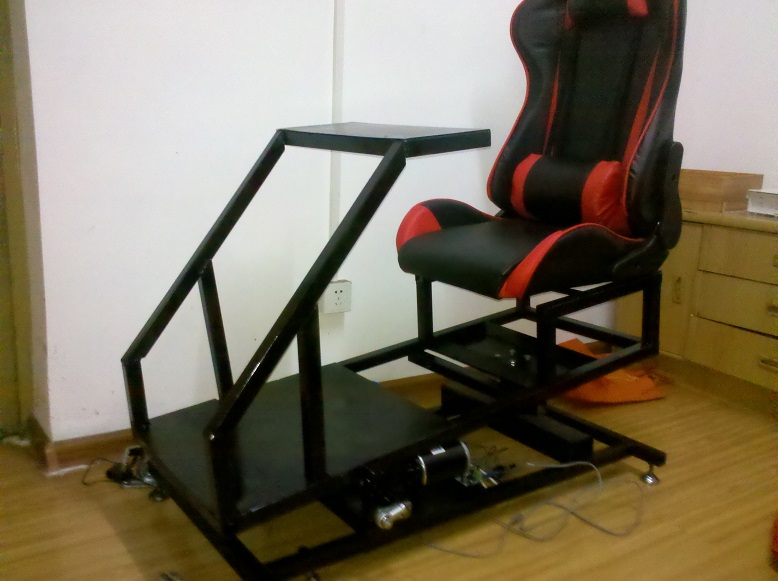

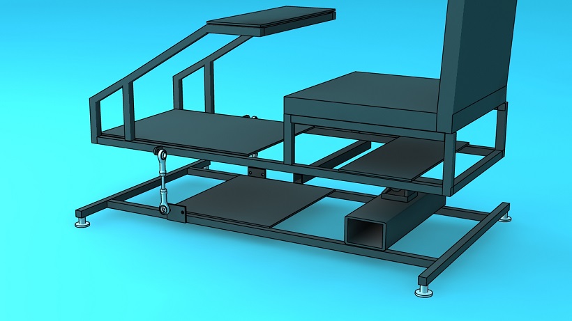

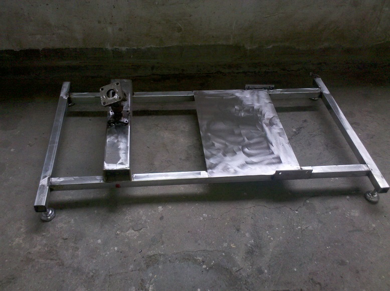

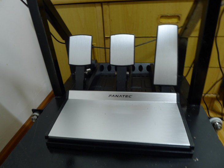

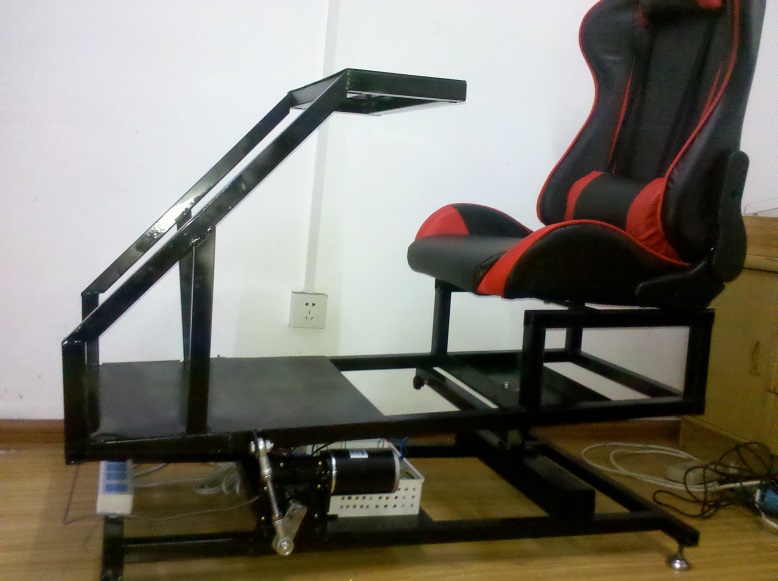

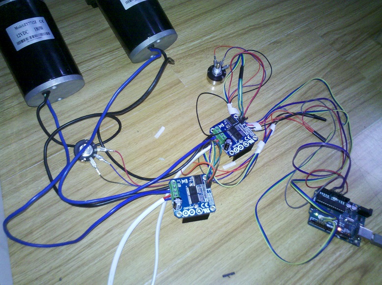

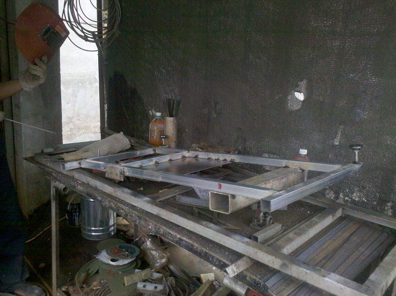

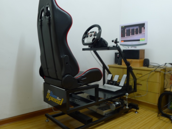

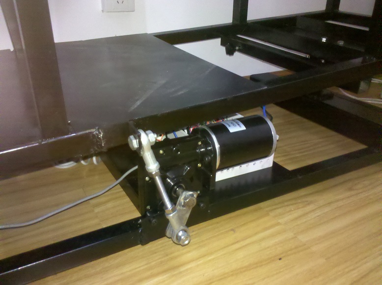

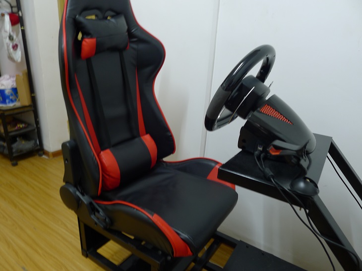

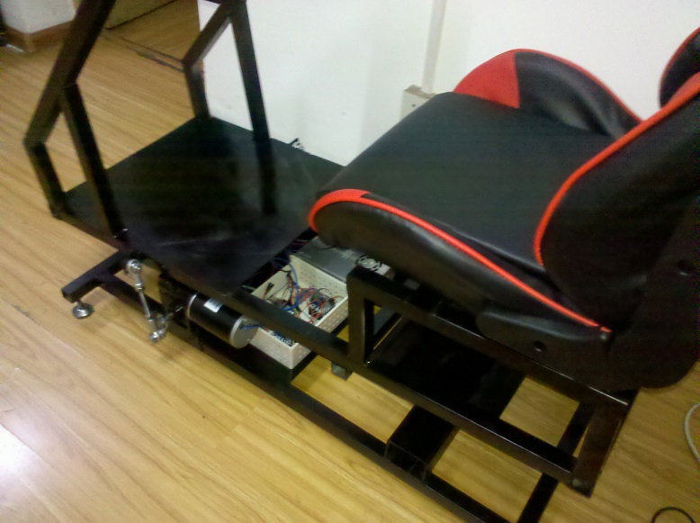

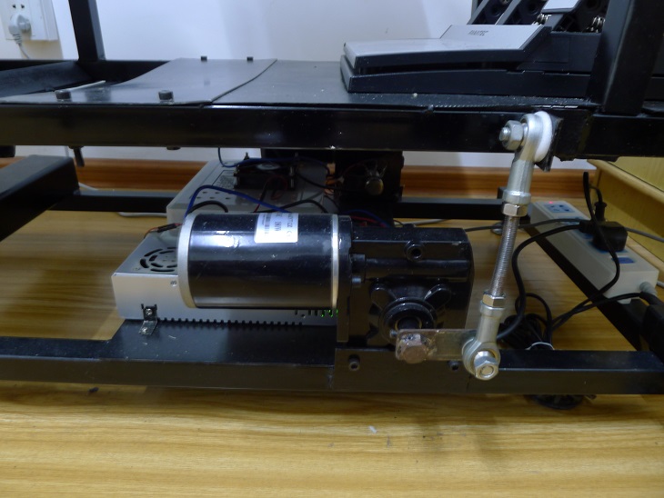

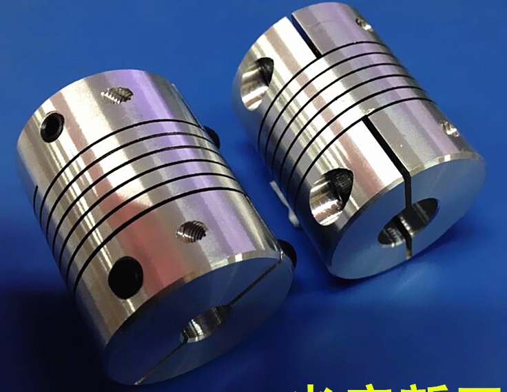

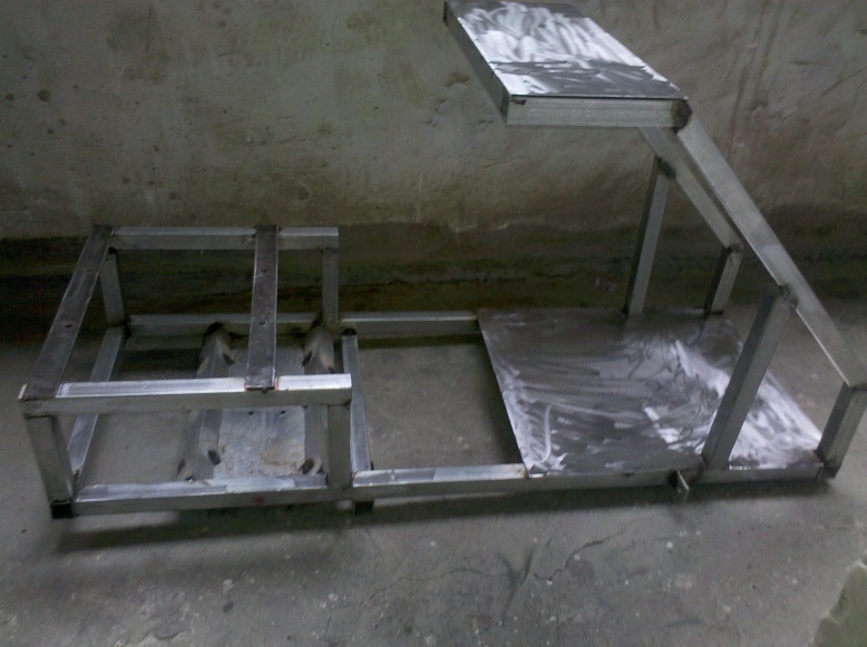

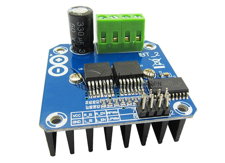

    Hello everyone
    I'm a new member, I'm from Xi'an, China, I'm not good at English, posting in Google Translate, sorry,
    This is my 2DOF simulation seat, hoping to get a DIY license,
    1 Arduino UNO R3 control panel,
    2 BTS7960 +43 A motor drive board
    1 12V500w power supply
    2 12V150W DC worm motor
    1 computer seat
    2 10K potentiometer
    2 couplings
    And some hardware
    Early in the beginning I seldom photos, make up before the shoot some,
    02.jpg 03.jpg 04.jpg 05.jpg 06.jpg 07.jpg 08.jpg 09.jpg 10.jpg 11.jpg 12.jpg 13.jpg 14.jpg 15.jpg 16.jpg 17.jpg 18.jpg 19.jpg 20.jpg 21.jpg 22.jpg 23.jpg Arduino UNO R3.jpg BTS7960+43A.jpg power supply.jpg
