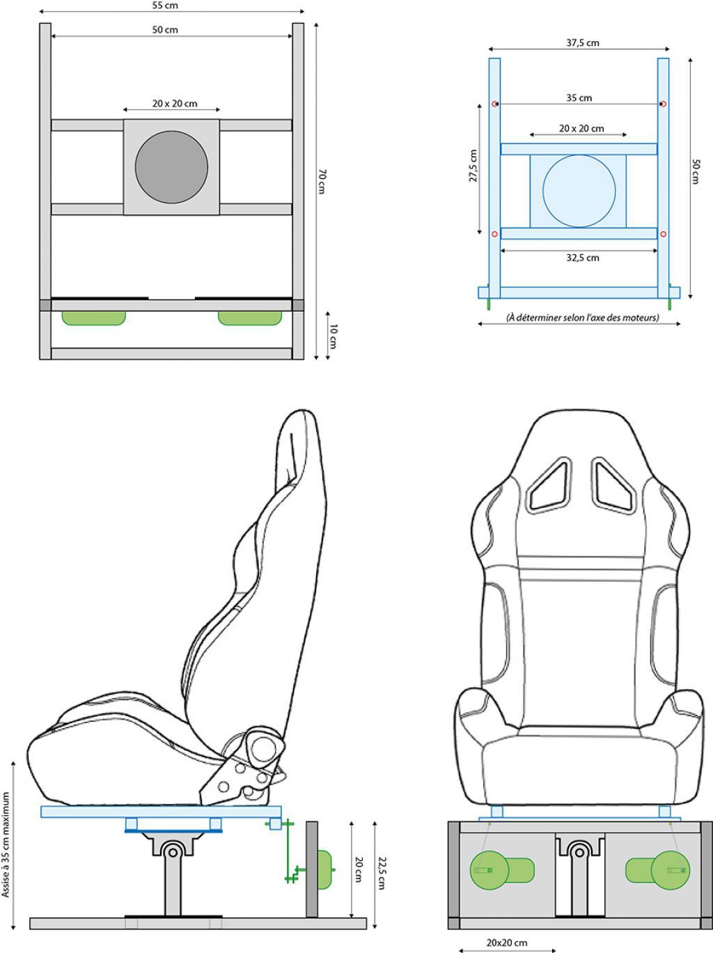

    Here is a presentation of my finished simulator.
    I use 2 Smolka 24 V motors, arduino uno card, a sabertooth 2X25et card and a power supply 24V.

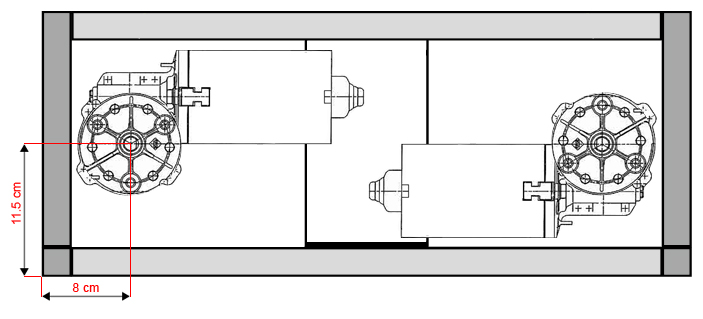

    Here first the patterns that I made to make the simulator :

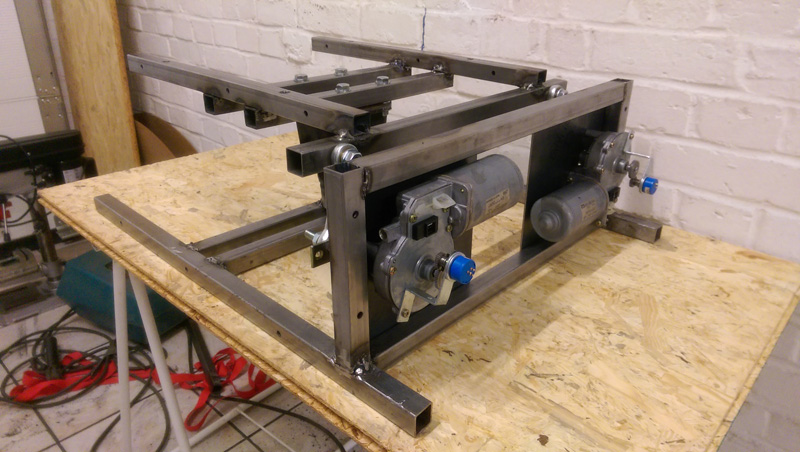

    Here are two images of naked frame after welding :

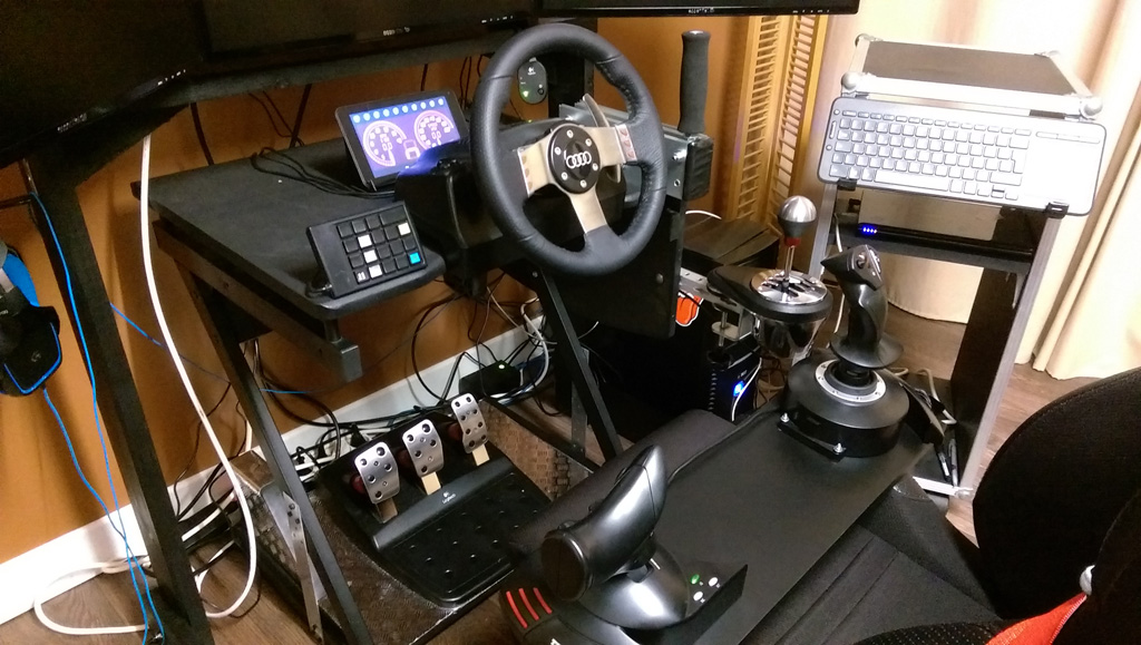

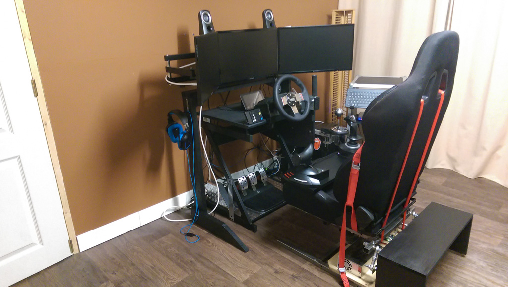

    And here ended:
