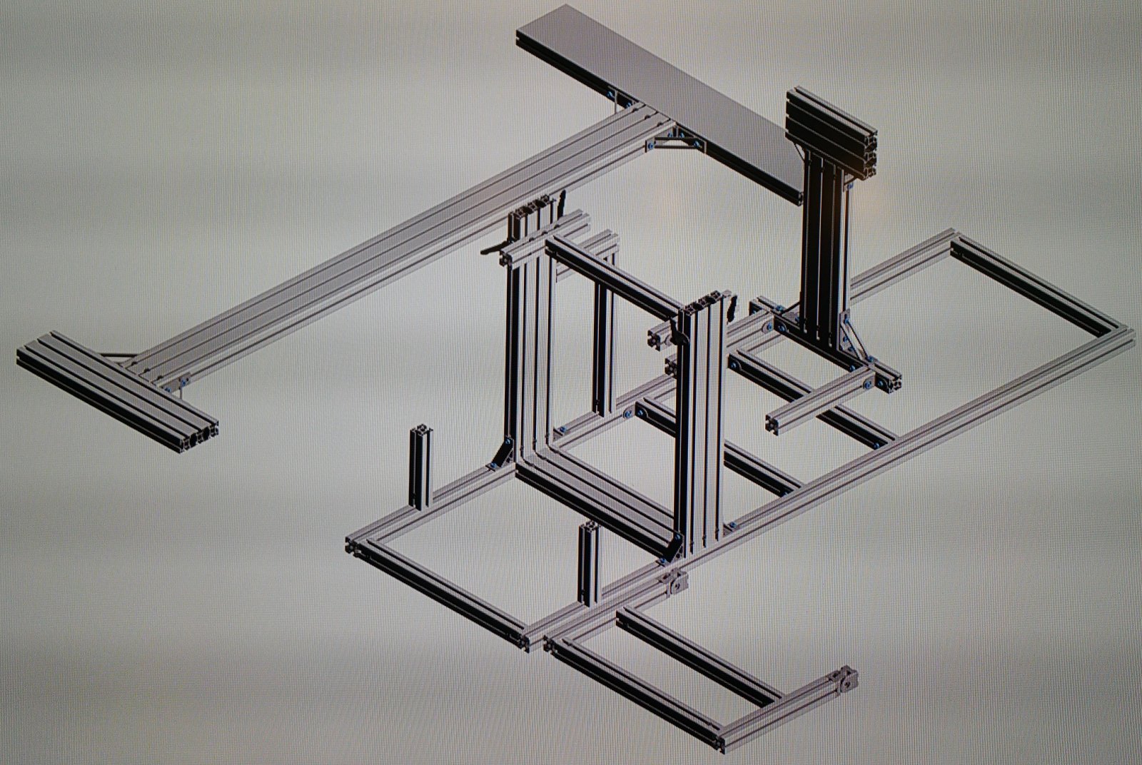

    I´ve started my sim interest just recently. First I bought a GtOmega chair, but very soon I discovered Xsim and realised I wanted a motion rig.
    So here is my project.
    I`d download a CAD program at MayTec and made my sketch
    38147
    Size 190cm*85cm

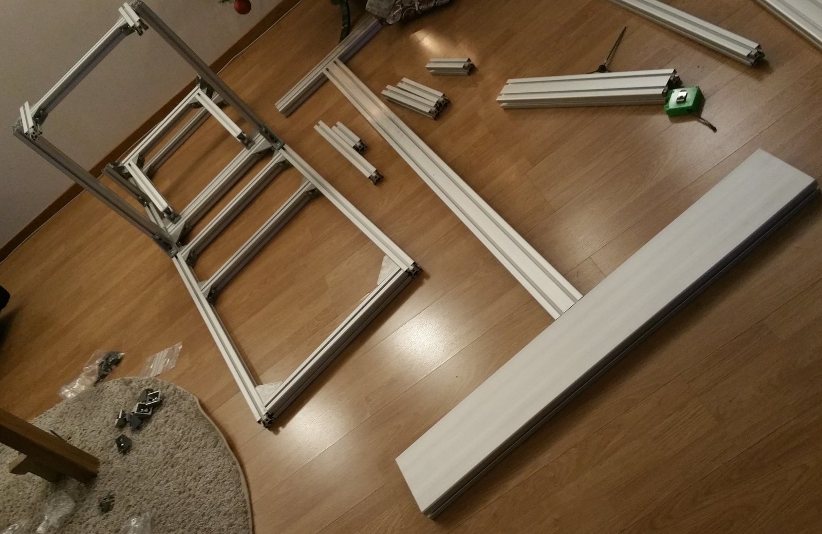

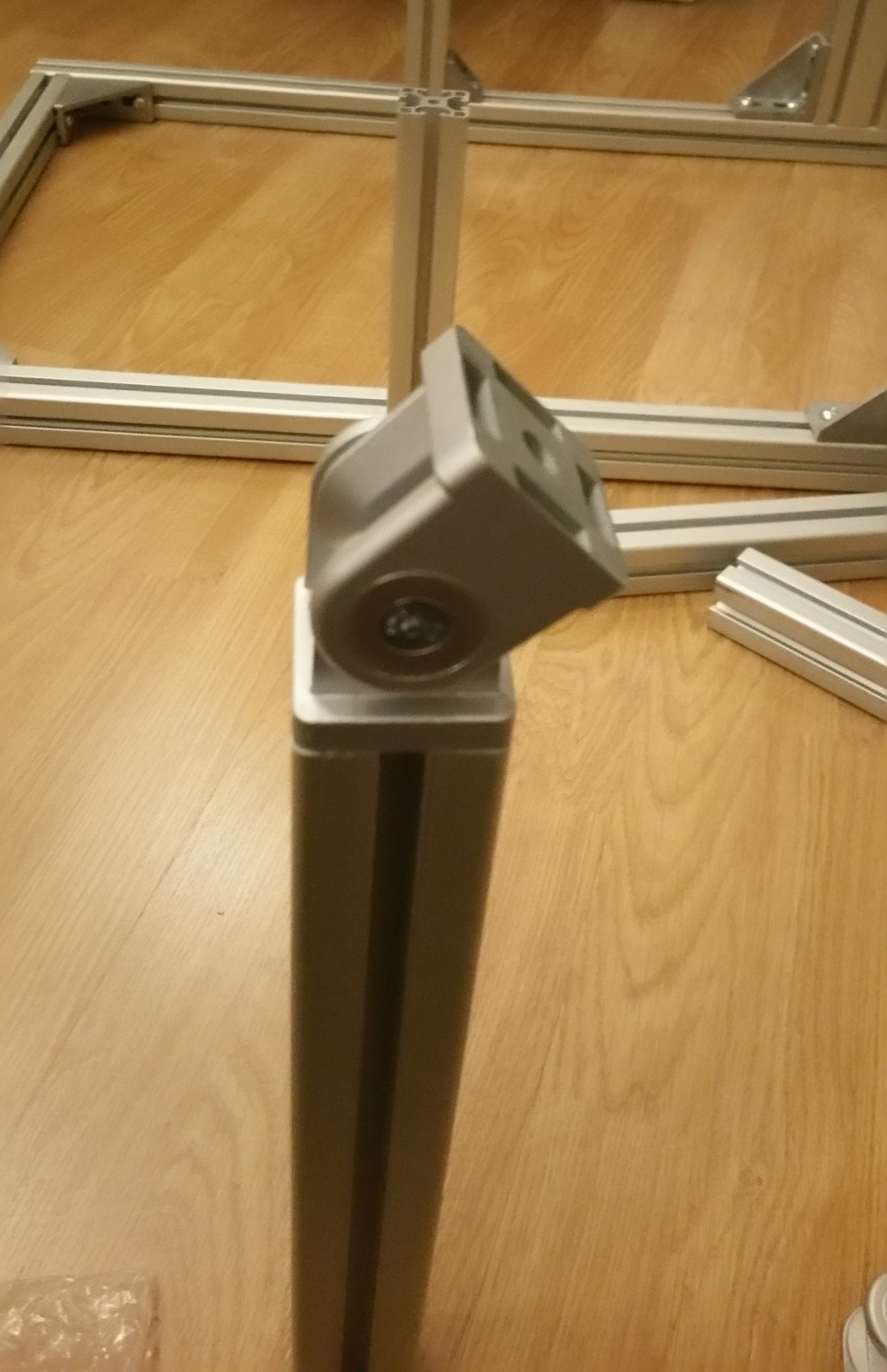

    I order from Motedis and it all did arrive few weeks later.

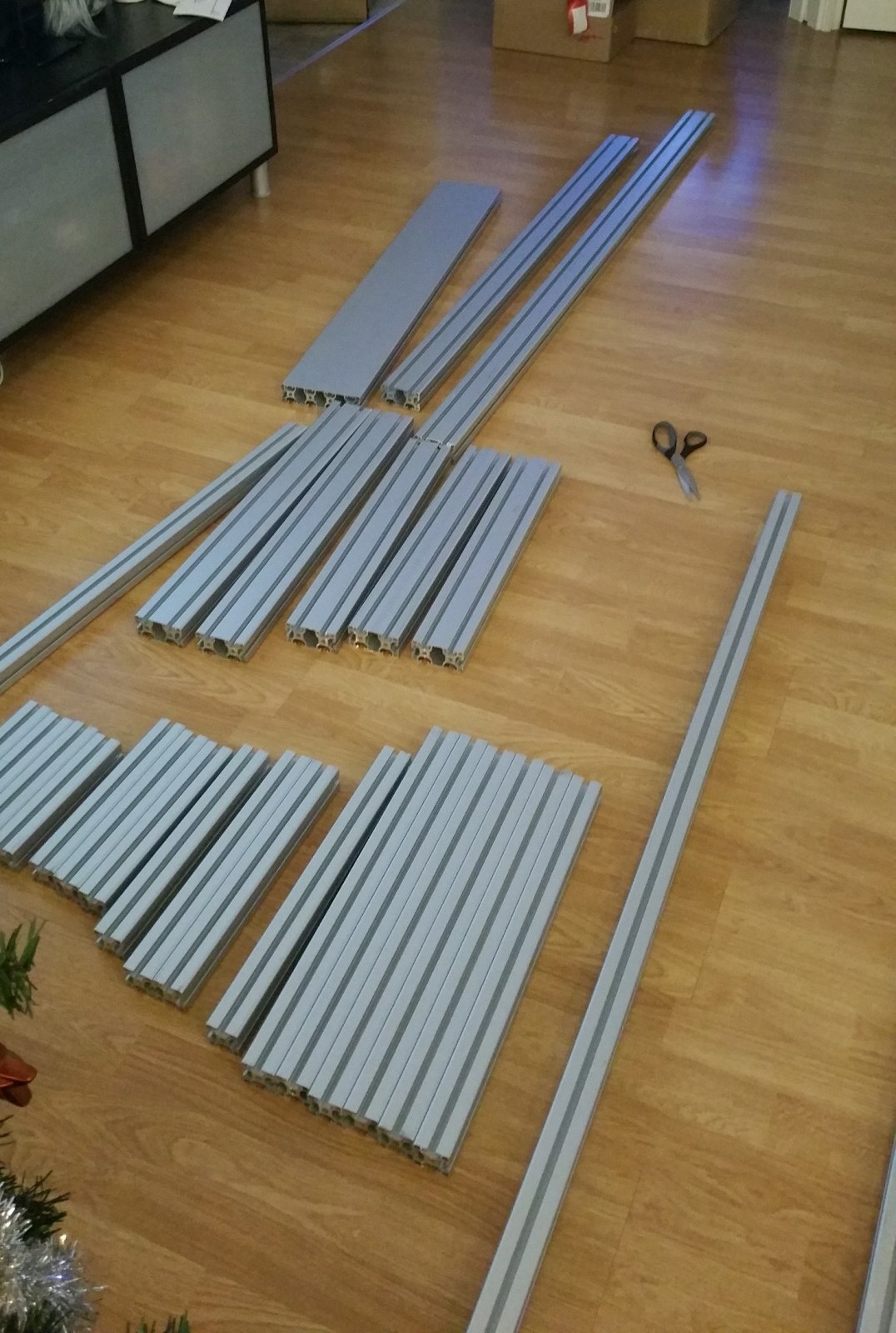

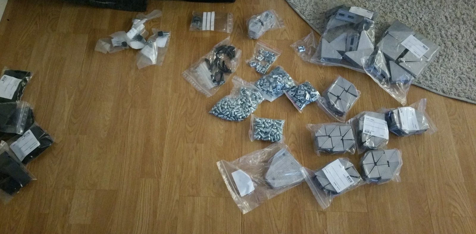

    38148 38149

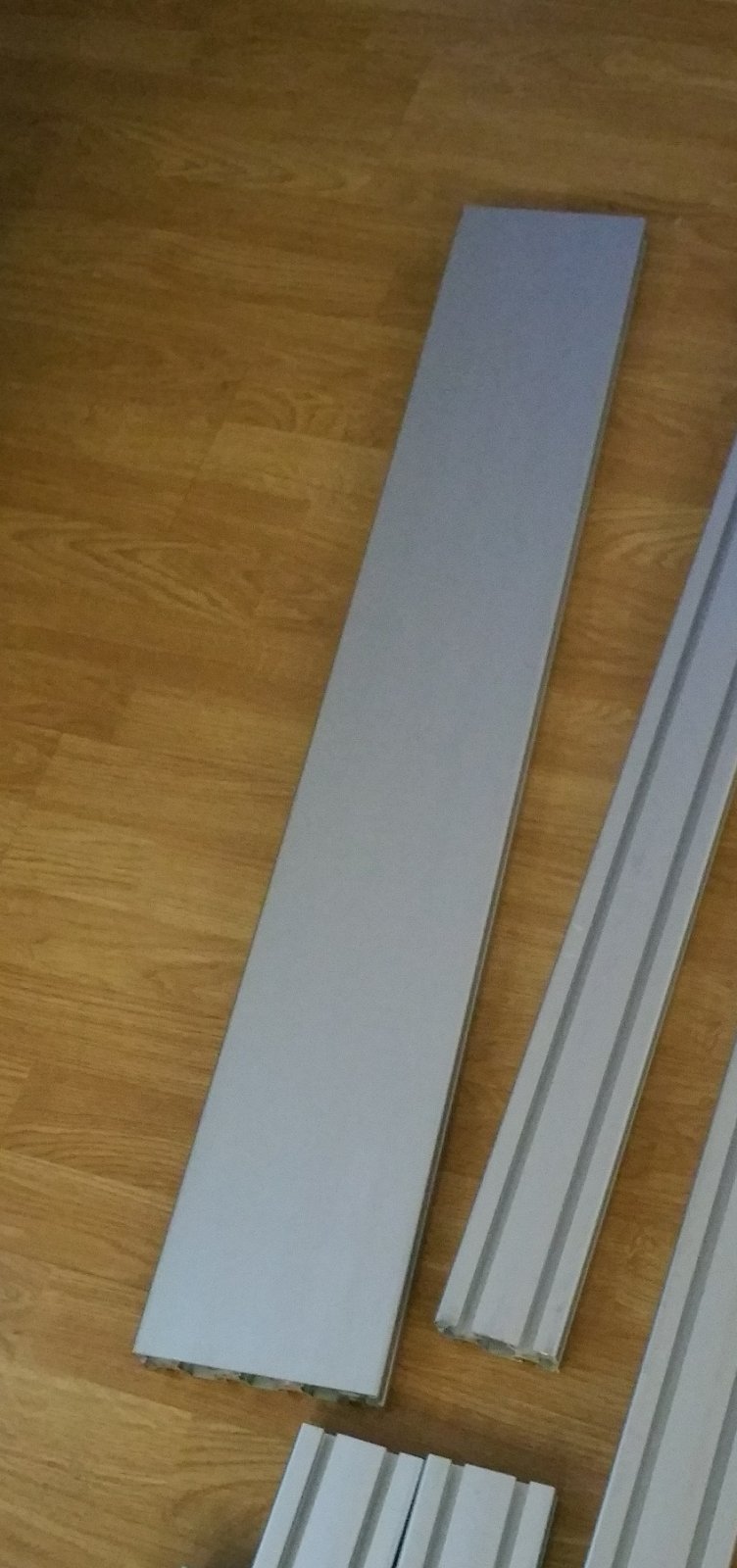

    I choose aluminum profile Type I 40x40 and 40x80. I also bought a profile 40x160 with one blank side, this one is for my traction loss.

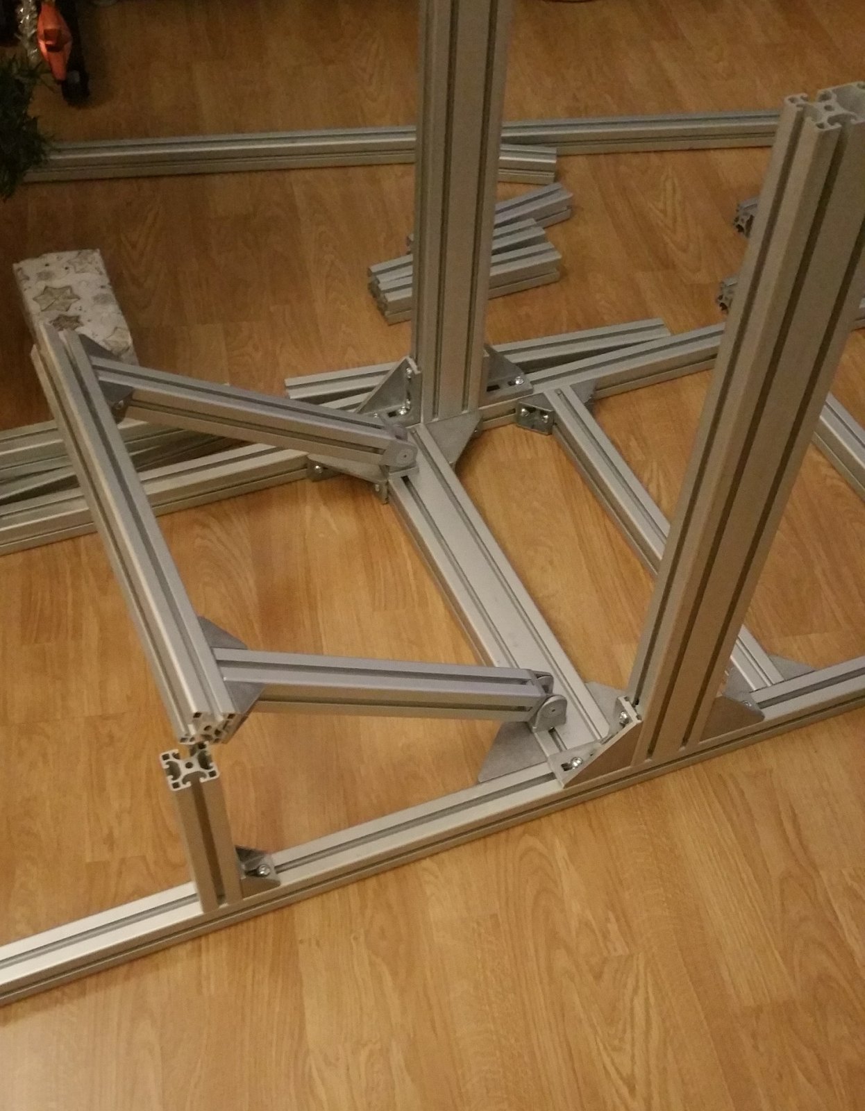

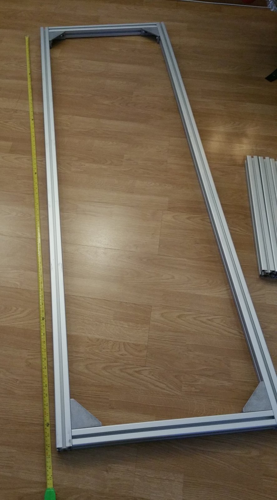

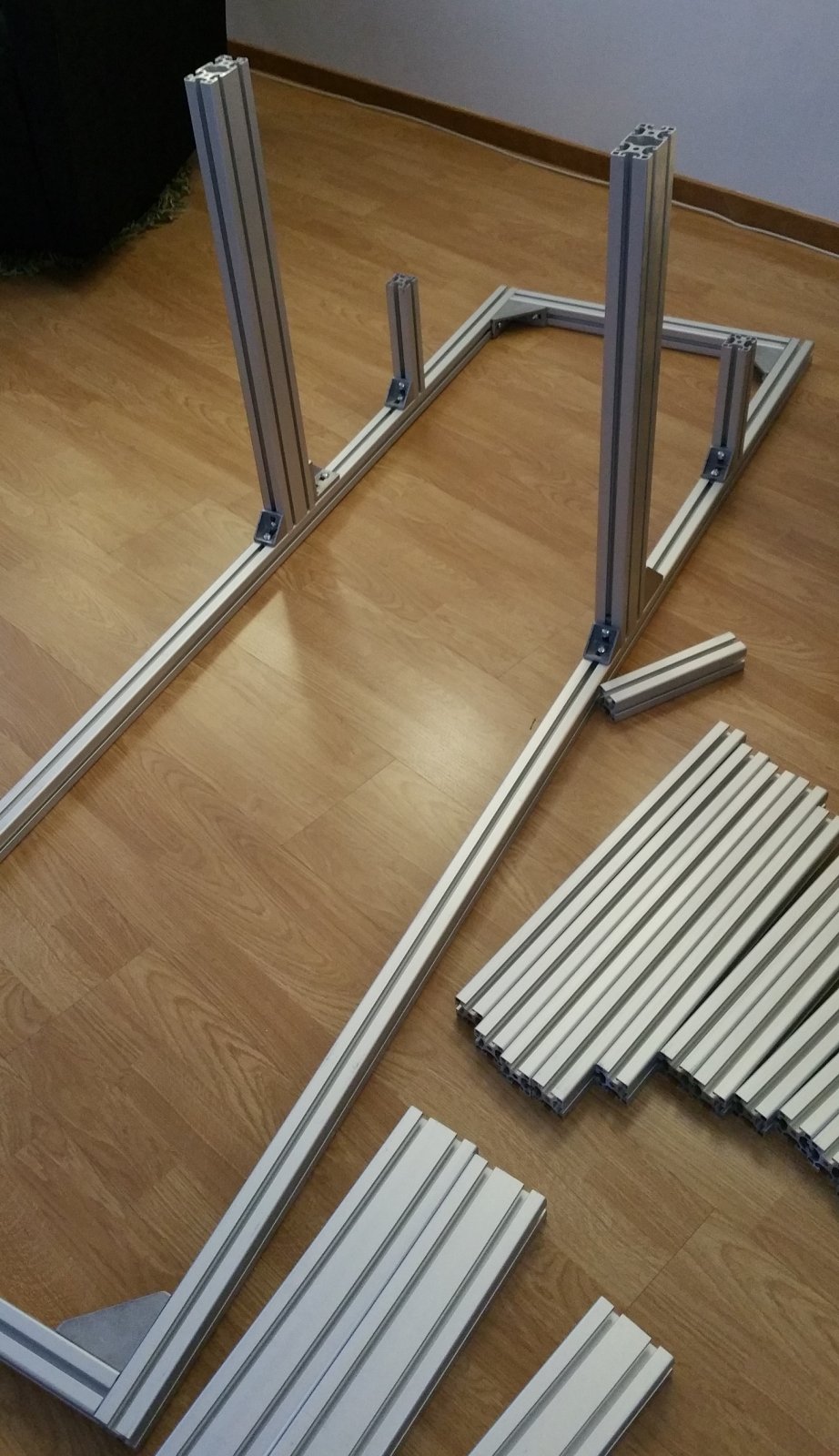

    Some picture from the process.
    38151 38152 38153 38154
    And finally my first step was done.
    38155
    to be continued...
