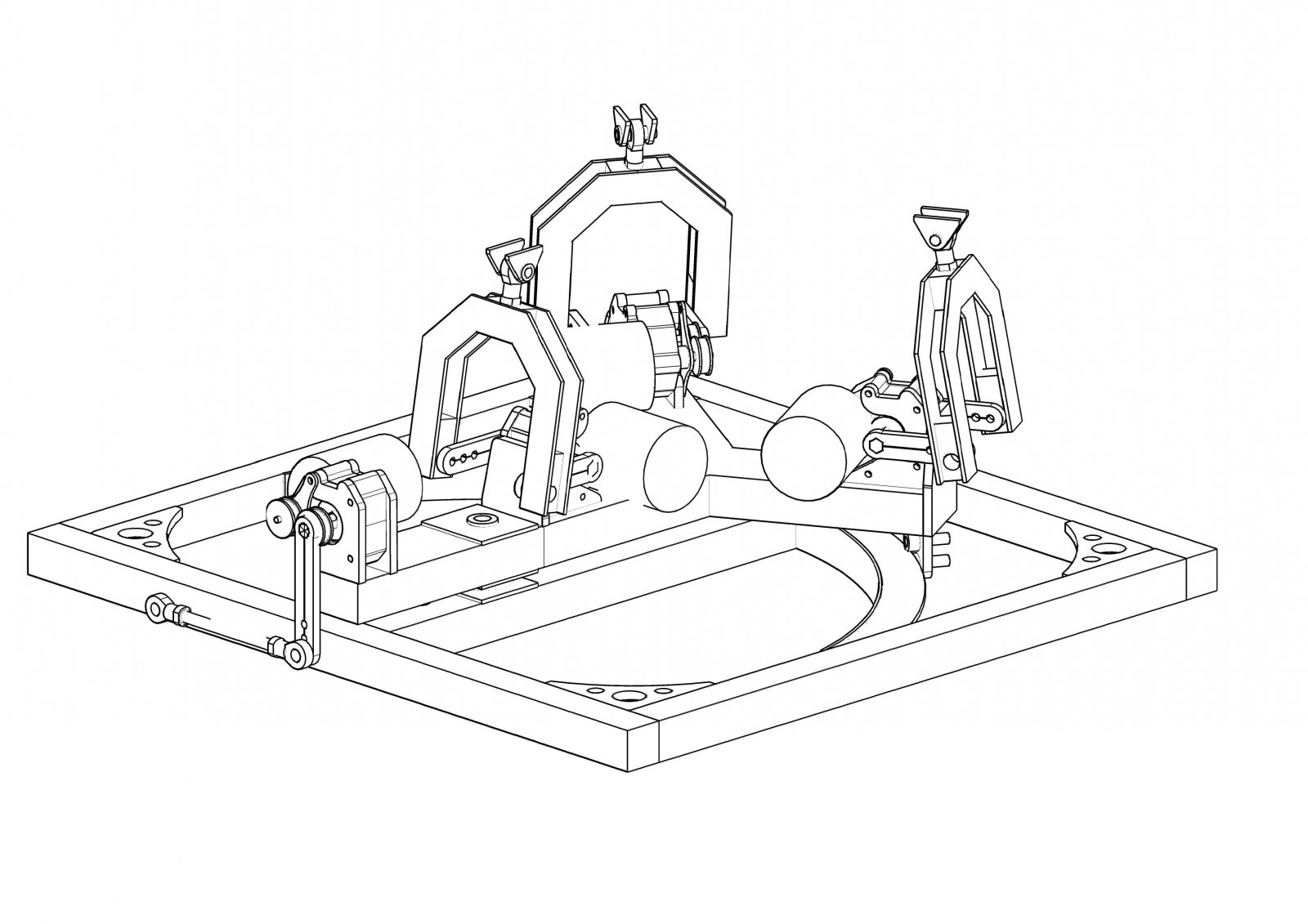

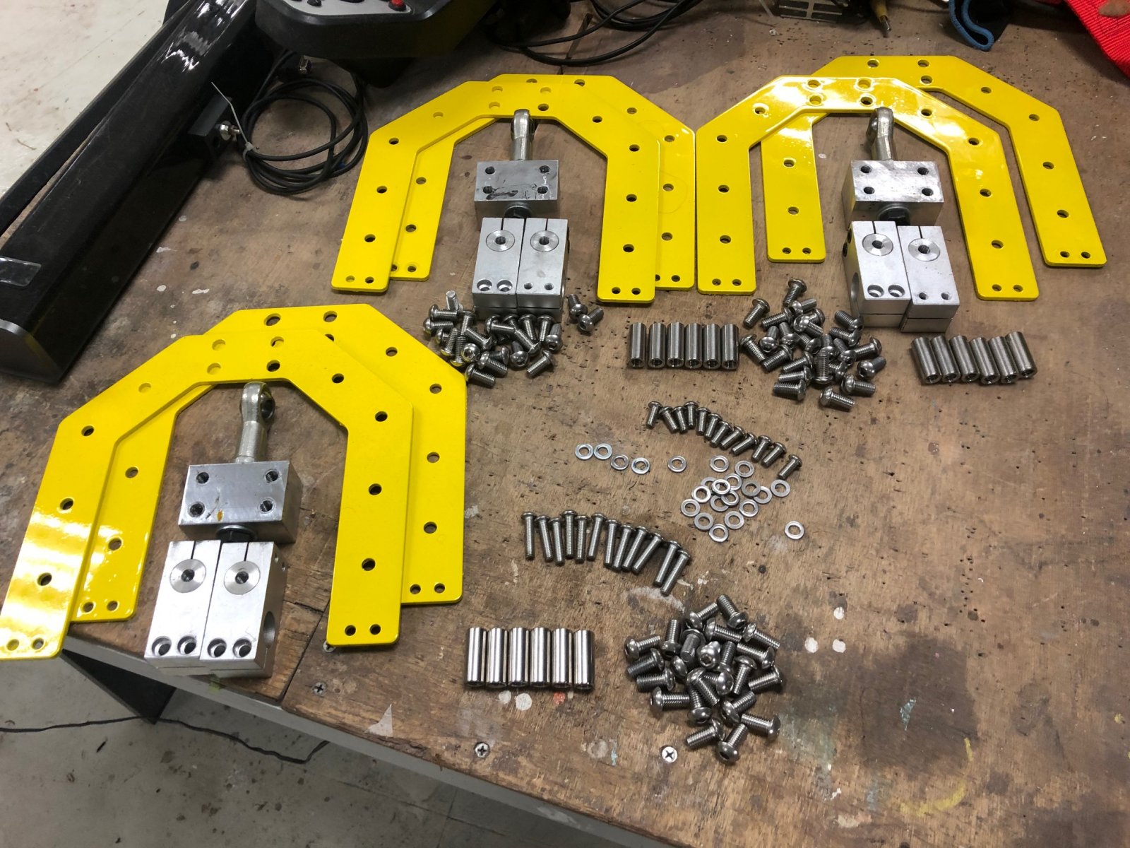

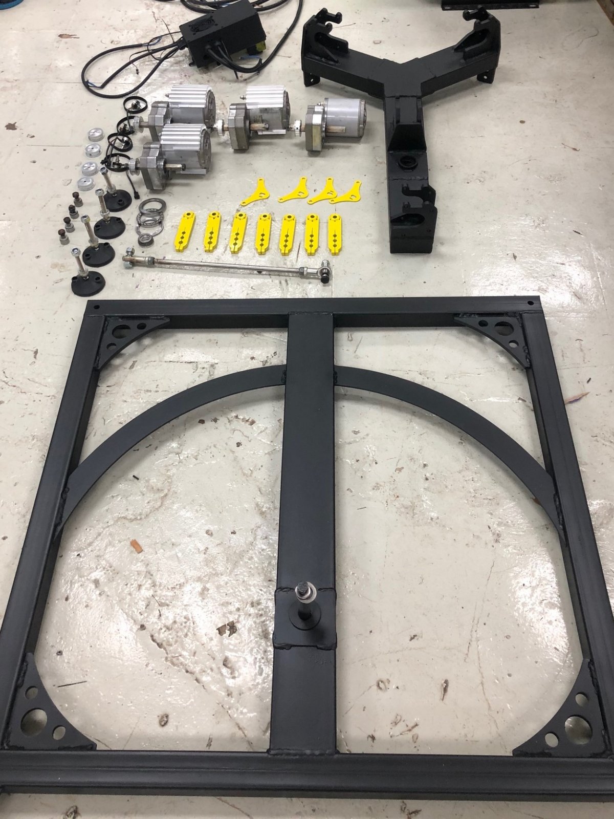

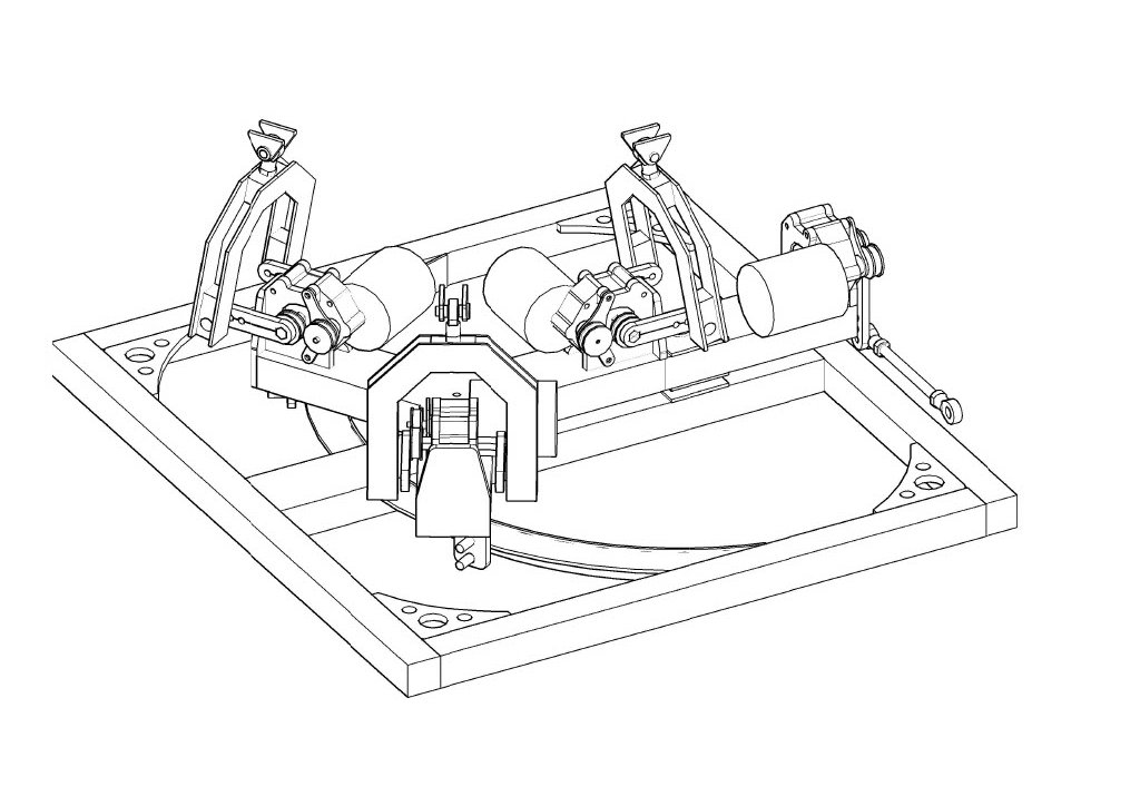

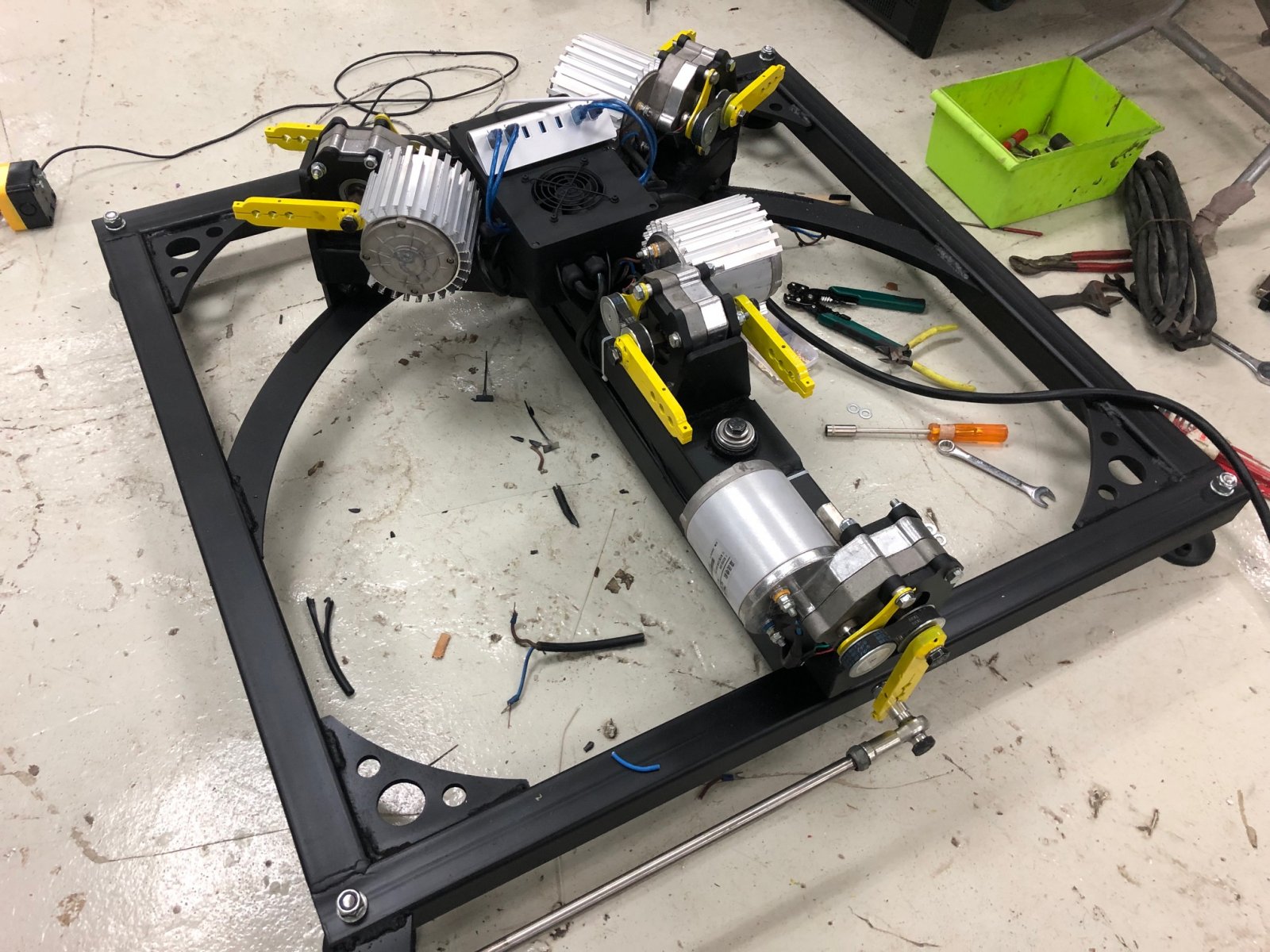

    Hello everyone!!!
    Making platform for the first time! please give advice!hug:
    -MOTOR 24v 600w 65rpm 15Nm x4
    -100A H bridge x2
    -Arduino uno x4
    -10k Potentiometer x4

    I am not sure what you mean by "startup-shutdown setting annoys me long time!", can you please elaborate more fully what the issue is that you are experiencing.
    If you are using SMC3 is it properly configured and work as expected with the hardware you are using?

    SMC3 and H bridge already working!platform can normal operation! start is in the middle position ,but i really want it to be in a LOW position before it start operating! so what should I write in startup output and shutdown output? :)

    @yobuddy can you please assist @alango.

    I think you only need it for shutdown operation, as it will center automatically on startup.
    Also, i believe you need to send a complete SMC3 string like this for shutdown. [A<128>][B<128>][C<128>]
    (btw, V3 has a parking location where it will park, and unpark, before and after a game at an adjustable speed.)

    thanks for your reply! [A<128>][B<128>][C<128>] i tried! but it didn't work . instead i use [Axx] , motor will go to high position . xx string change has no effect , only double digits ! more than two digits is no action!
    thank you very much for your help!!:)
