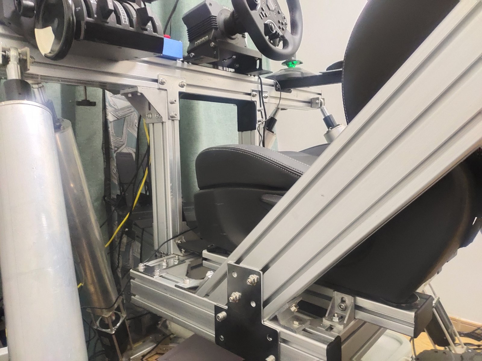

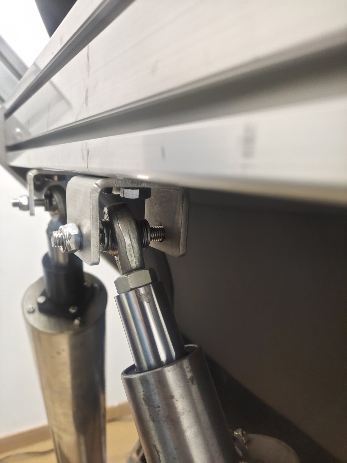

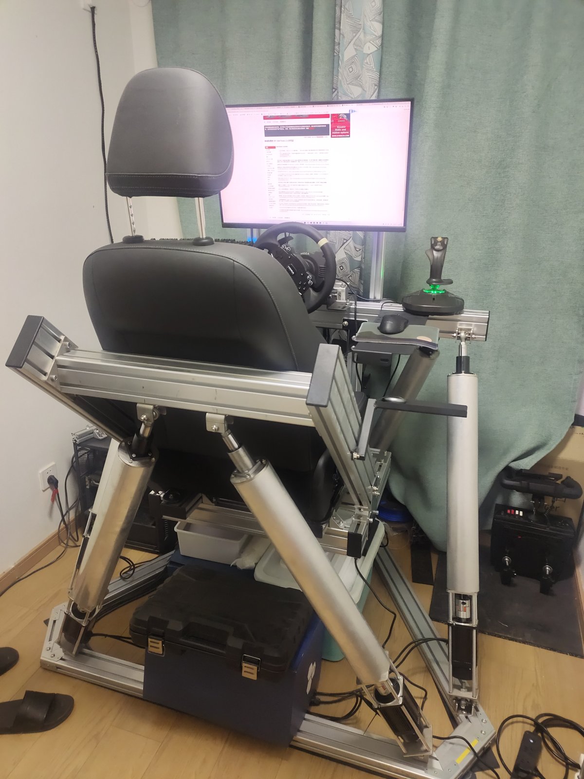

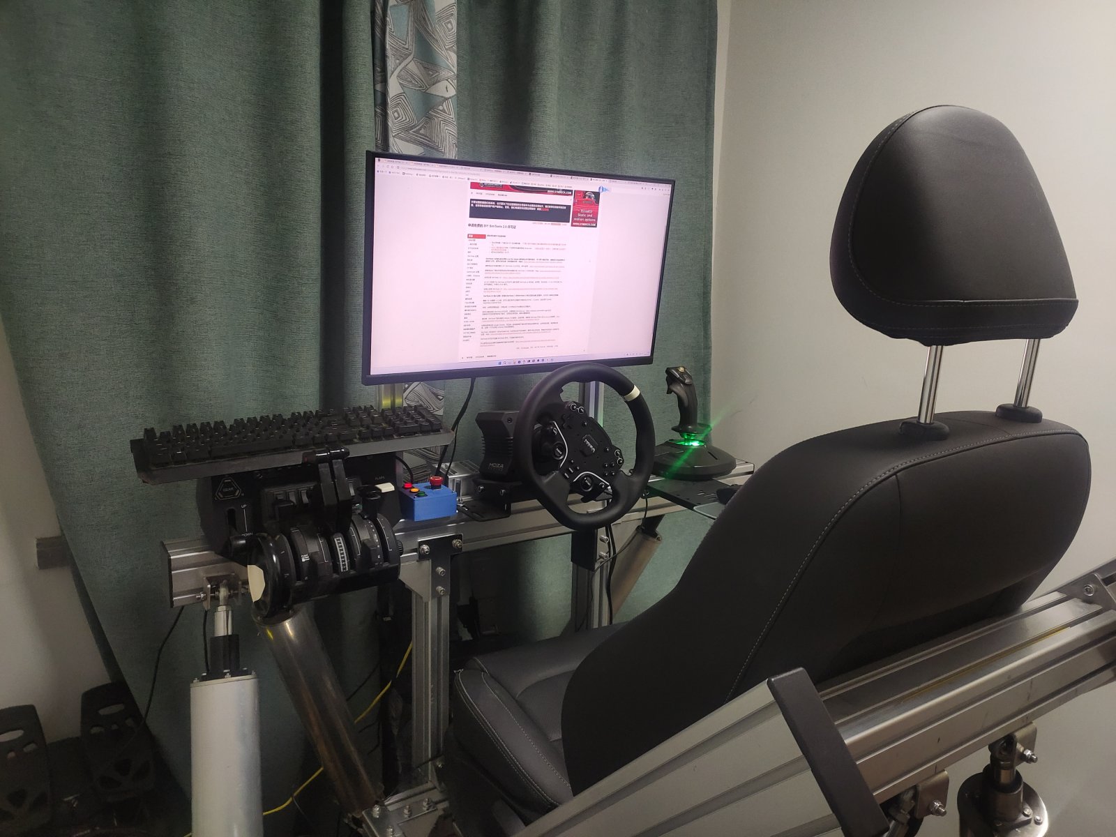

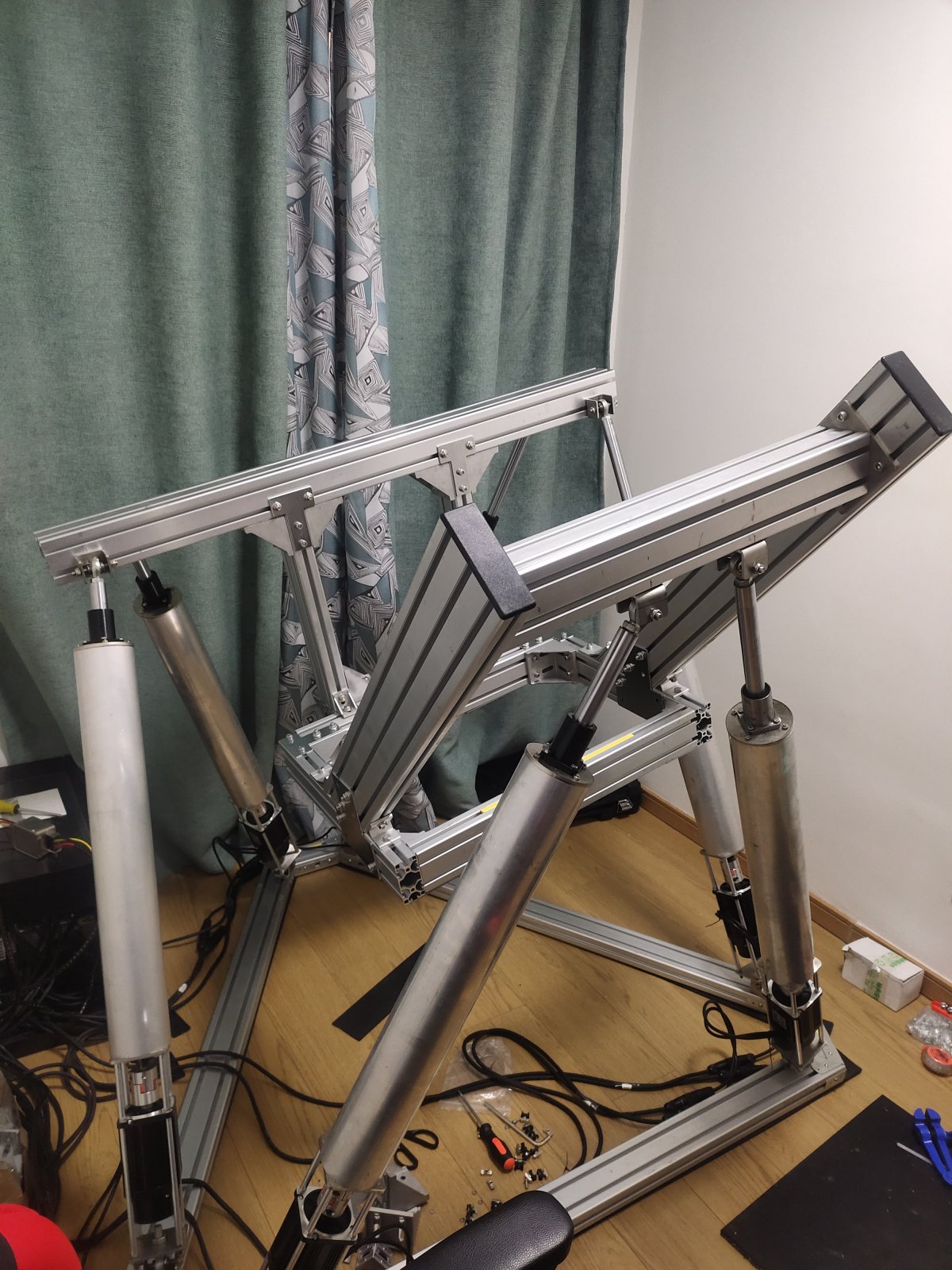

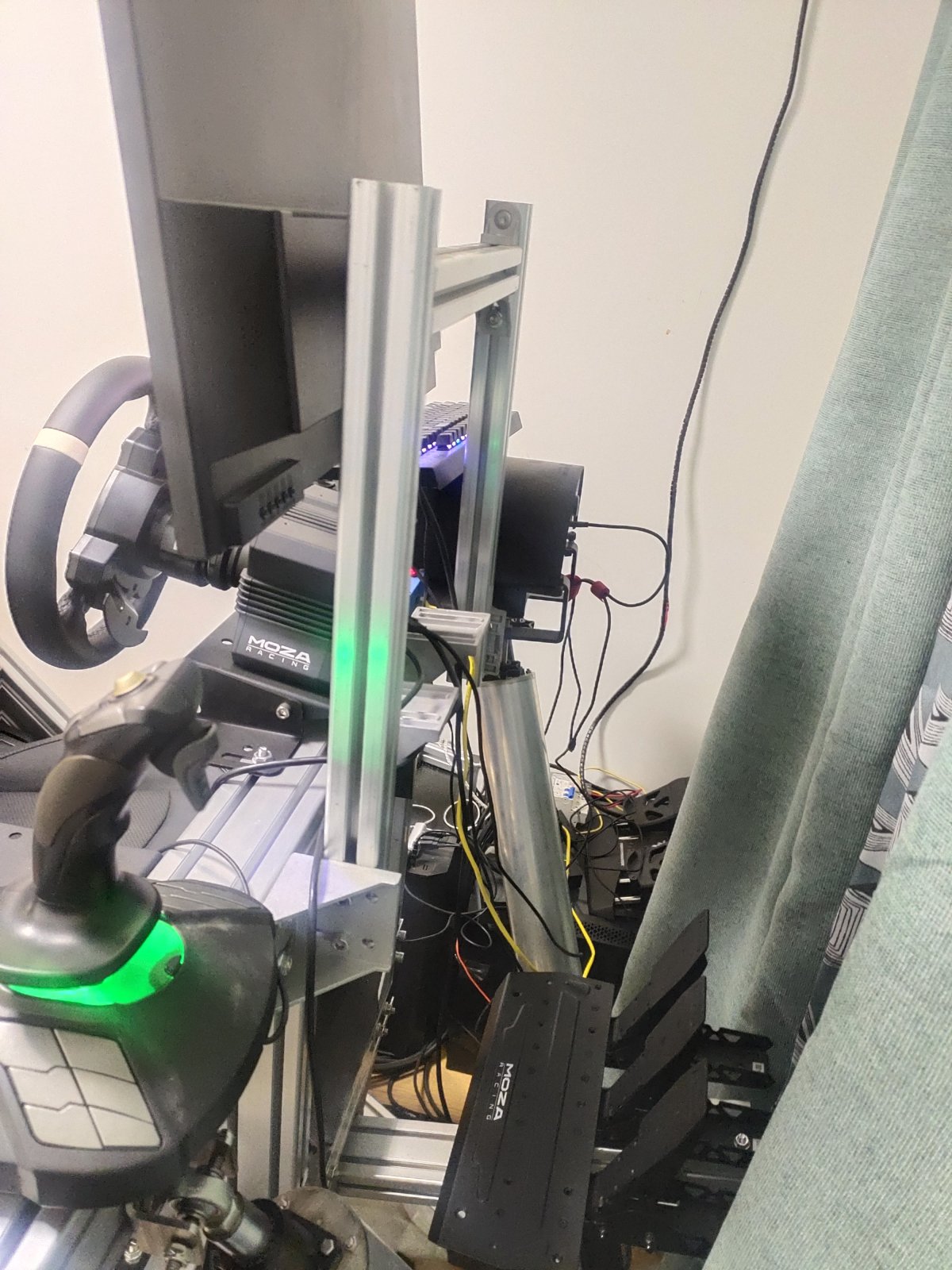

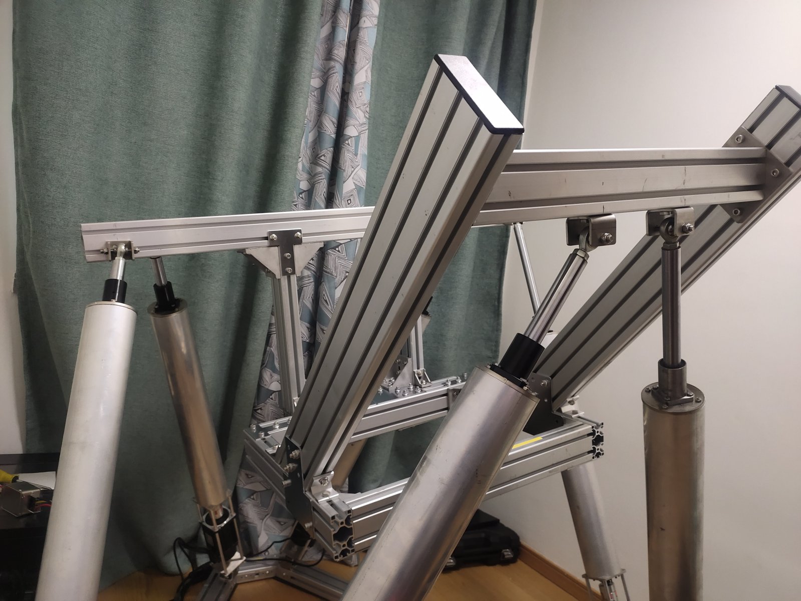

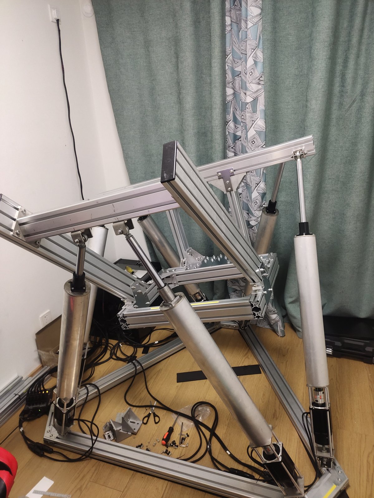

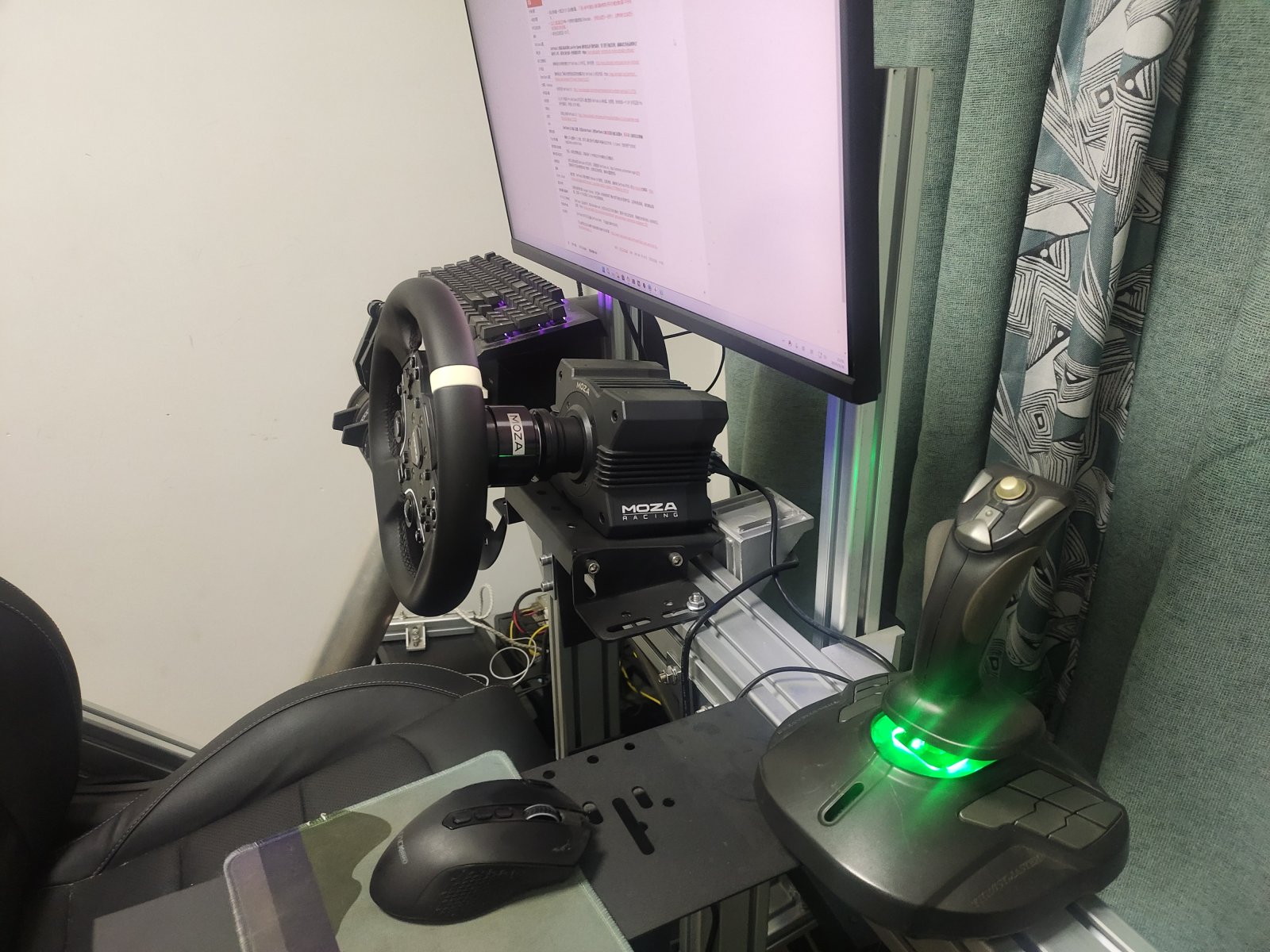

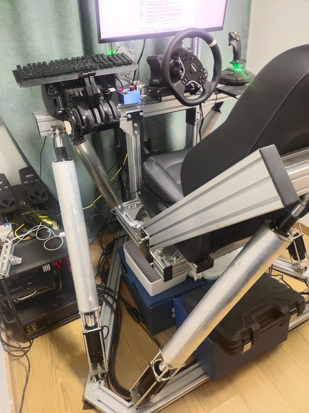

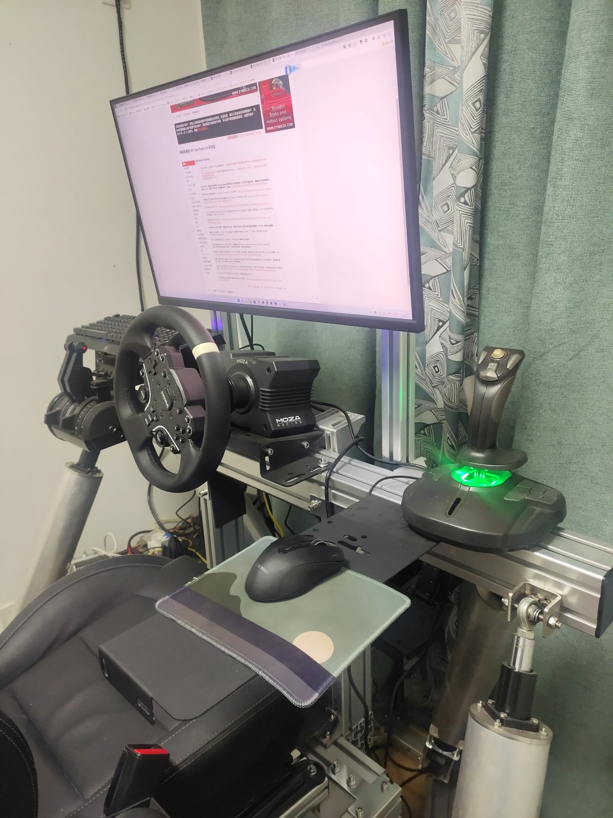

    My 6DOF simulator design and production have been helped in the forum. Now it is very good, so I want to show it to everyone and teach everyone how to make their own 6DOF. I hope everyone can have their own platform.
    My career is a structural designer, so I will mainly explain from the structure. The electricity and control solutions can only tell everyone how to set it,Please understand.
    My courses will be more episodes. I will update it for everyone when I have time, and I will provide the corresponding model. Because of the problem of mother tongue, my tutorial will use the language of our country. You can use a translator or I will add subtitles in the future.
    Now please appreciate my 6DOF platform and start our tutorial.

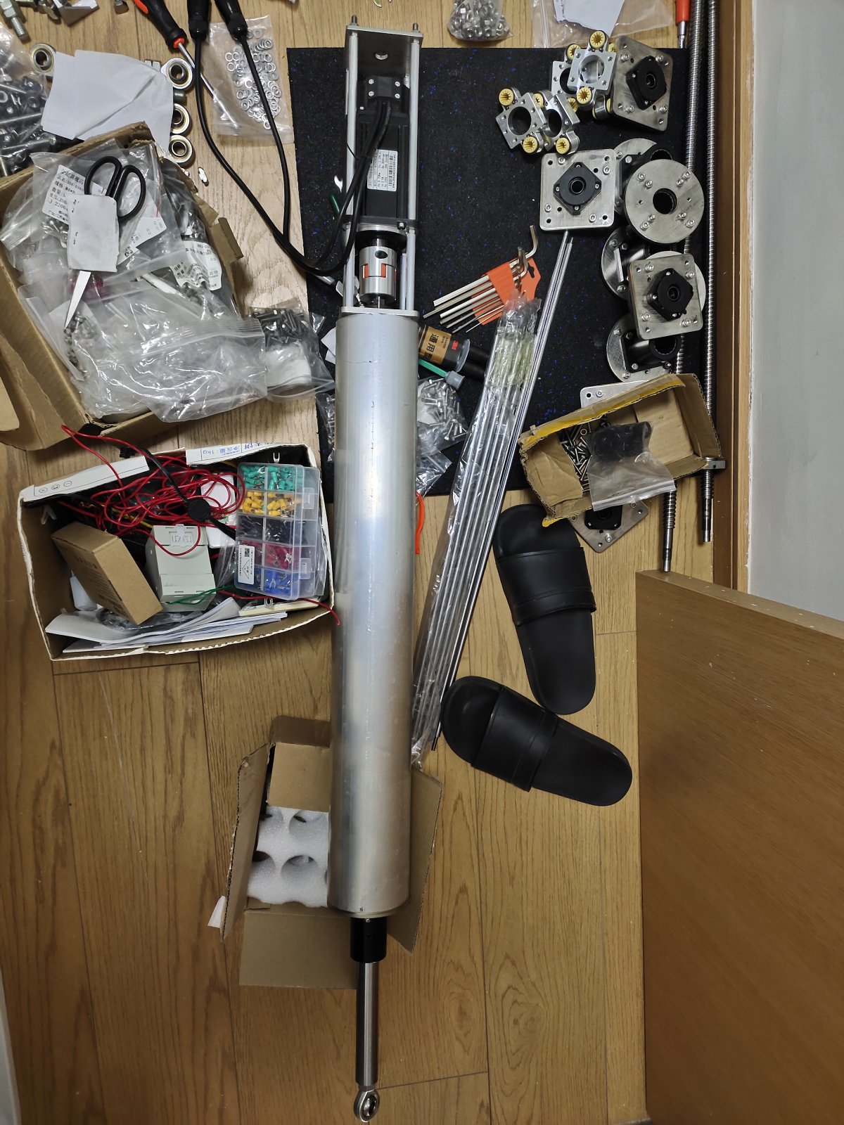

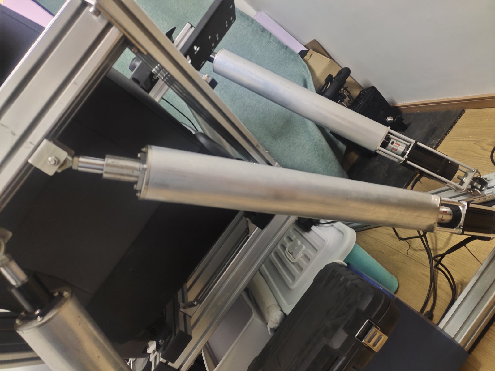

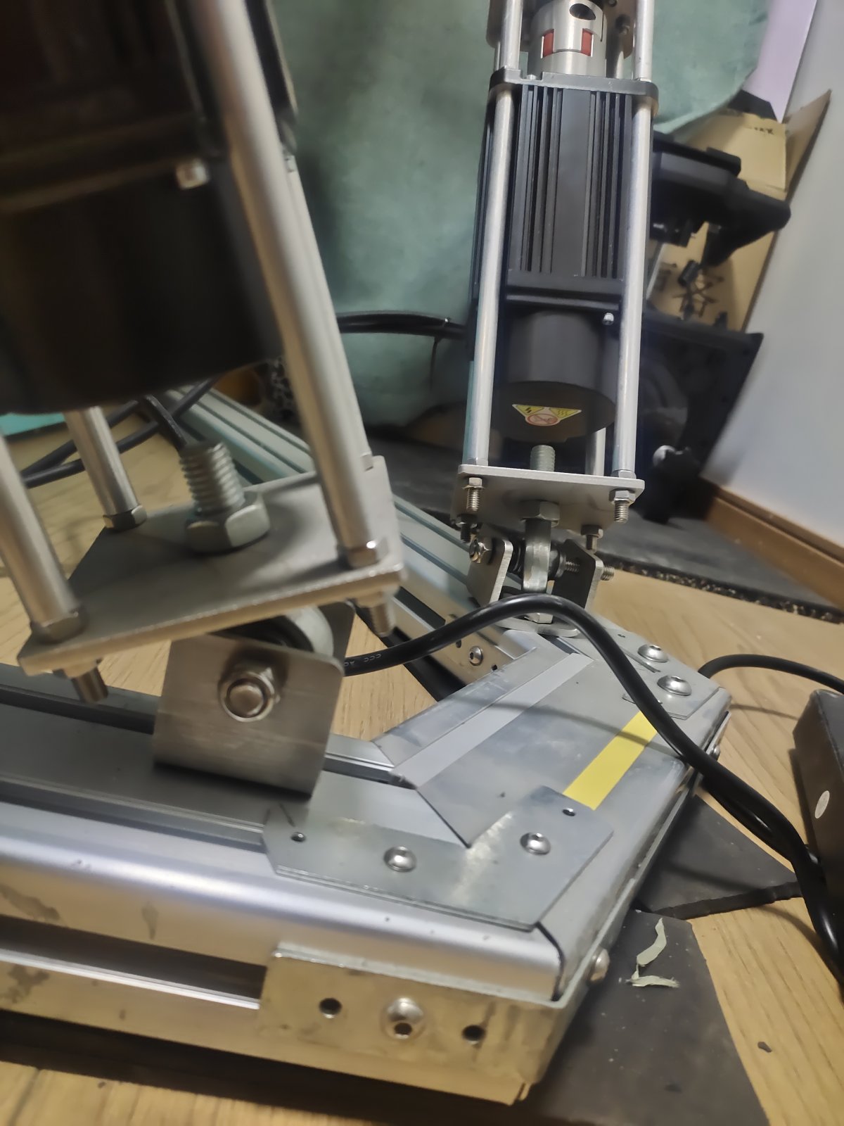

    This is the 3D model of my electric cylinder design.I will upload the teaching video as soon as possible, but I can only upload it on the platform of our country. I am sorry for inconvenience caused by it.

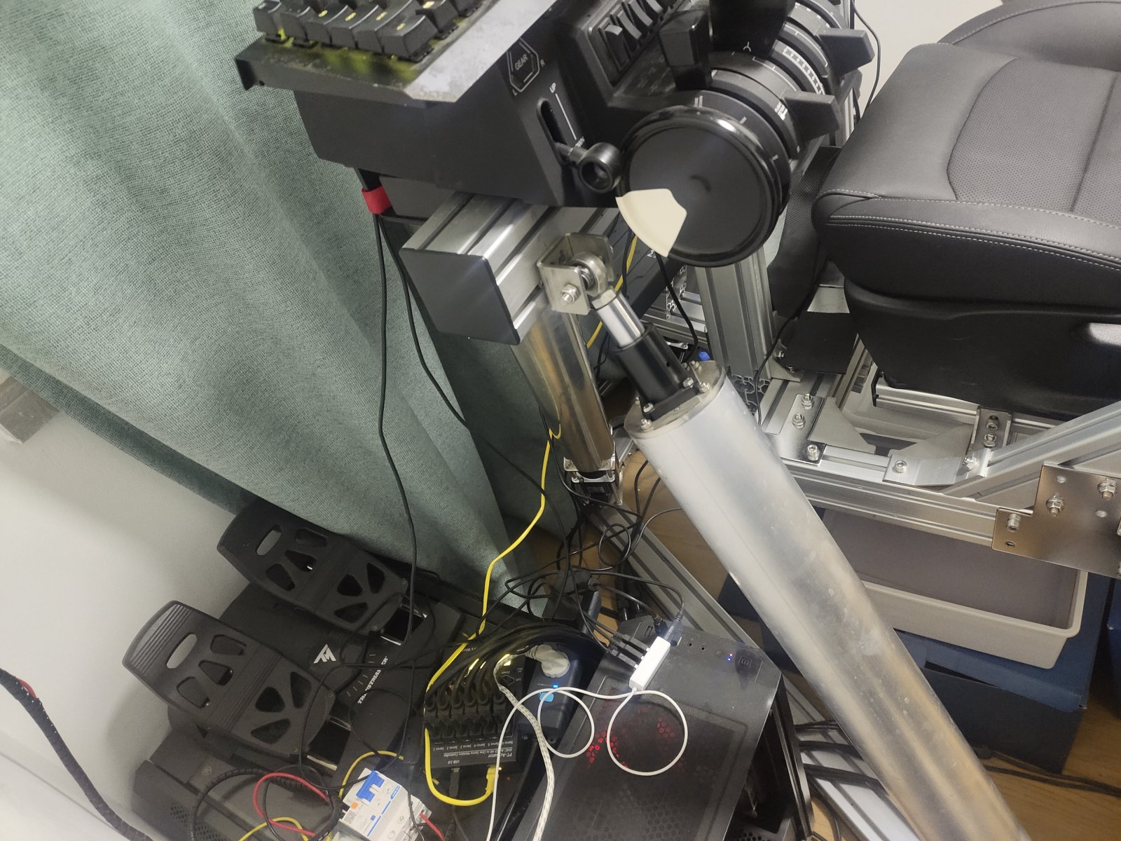

    What servos and servo control board is being used?
  5. 930175620
    930175620 New Member
    Dec 24, 2022
    15
    75Coins
    +10 / 0 / -0
    AMC AASD15A

    i use thanos AMC-AASD15A

    20,866
    146,918Coins
    +10,846 / 53 / -2
    The base footprint seems pretty compact, what are the dimensions?
  10. 930175620
    Dec 24, 2022
    15
    75Coins
    +10 / 0 / -0
    L1=900 L2=162.7 L3=200 L4=1100
    20,866
    146,918Coins
    +10,846 / 53 / -2
    That is indeed compact, does the base try and move during fast motion?
    A video of your rig in action would be great to see.
  12. 930175620
    Dec 24, 2022
    15
    75Coins
    +10 / 0 / -0
    Usually, the base will not move. But when hitting, there will be some shaking.
    When I have time, I can record a video for you.
