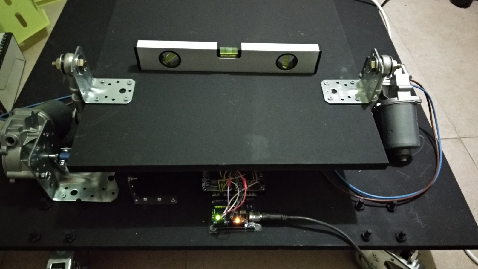

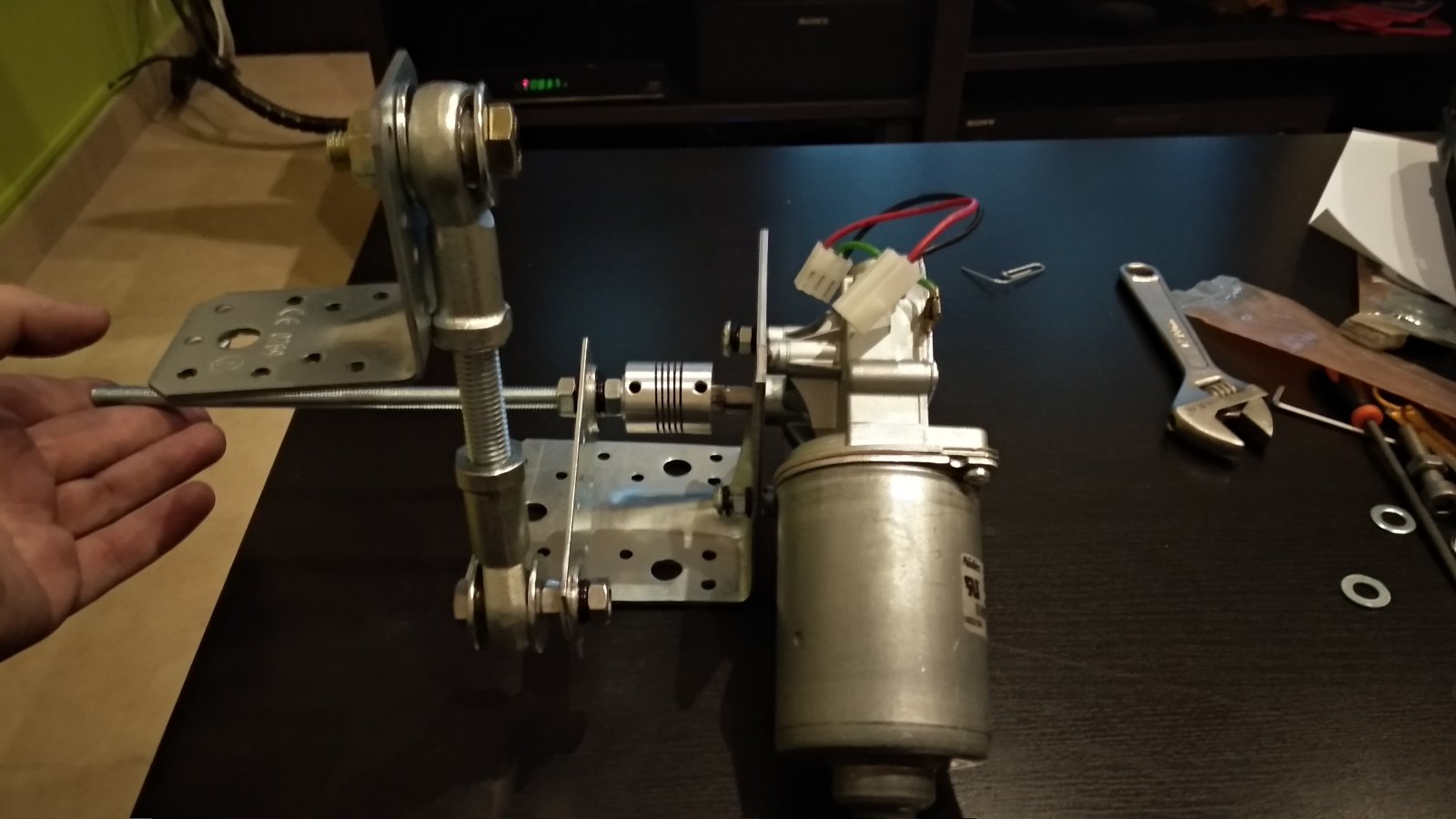

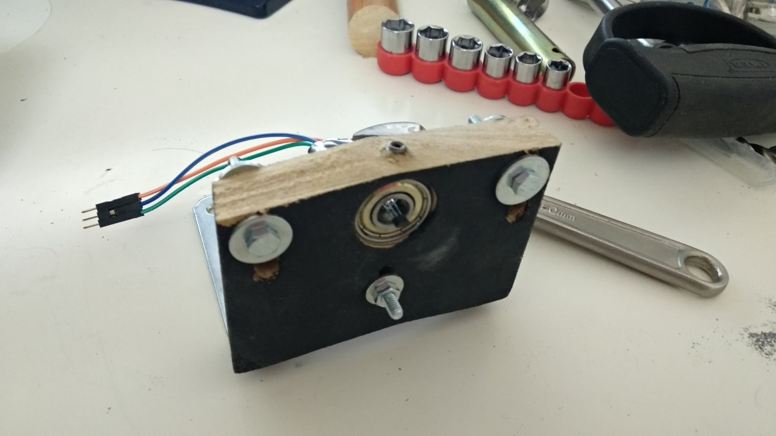

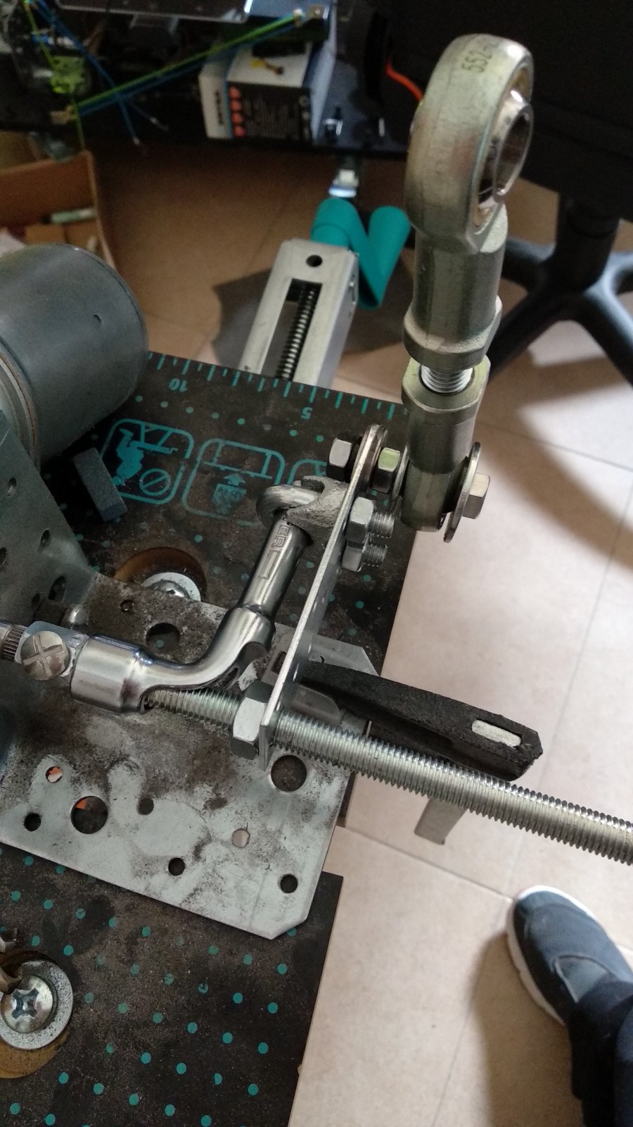

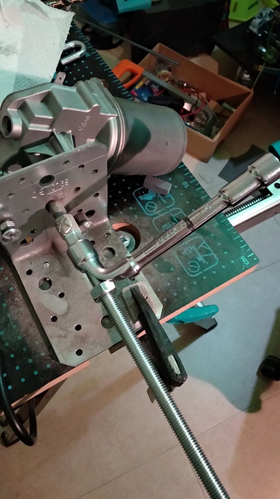

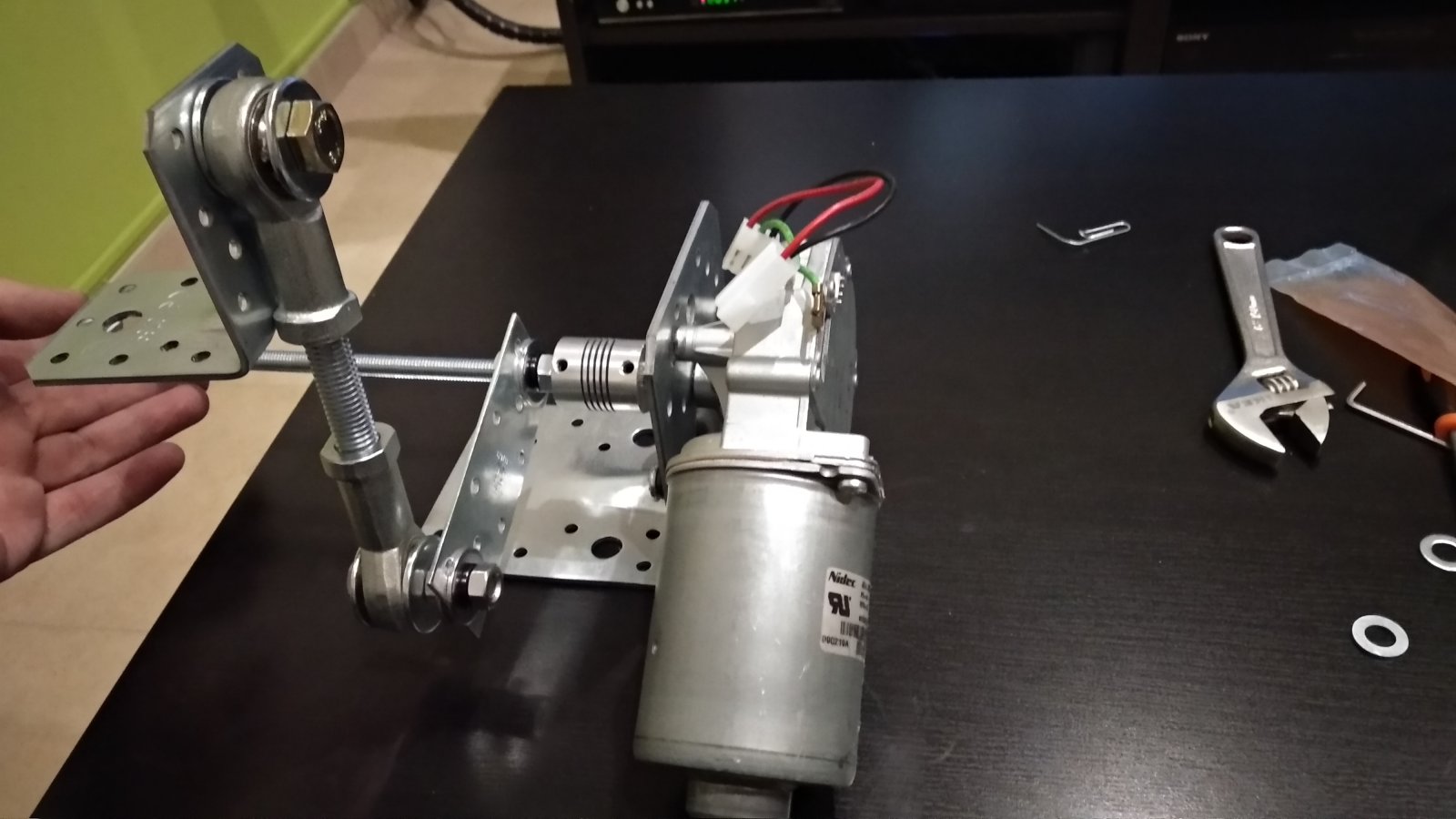

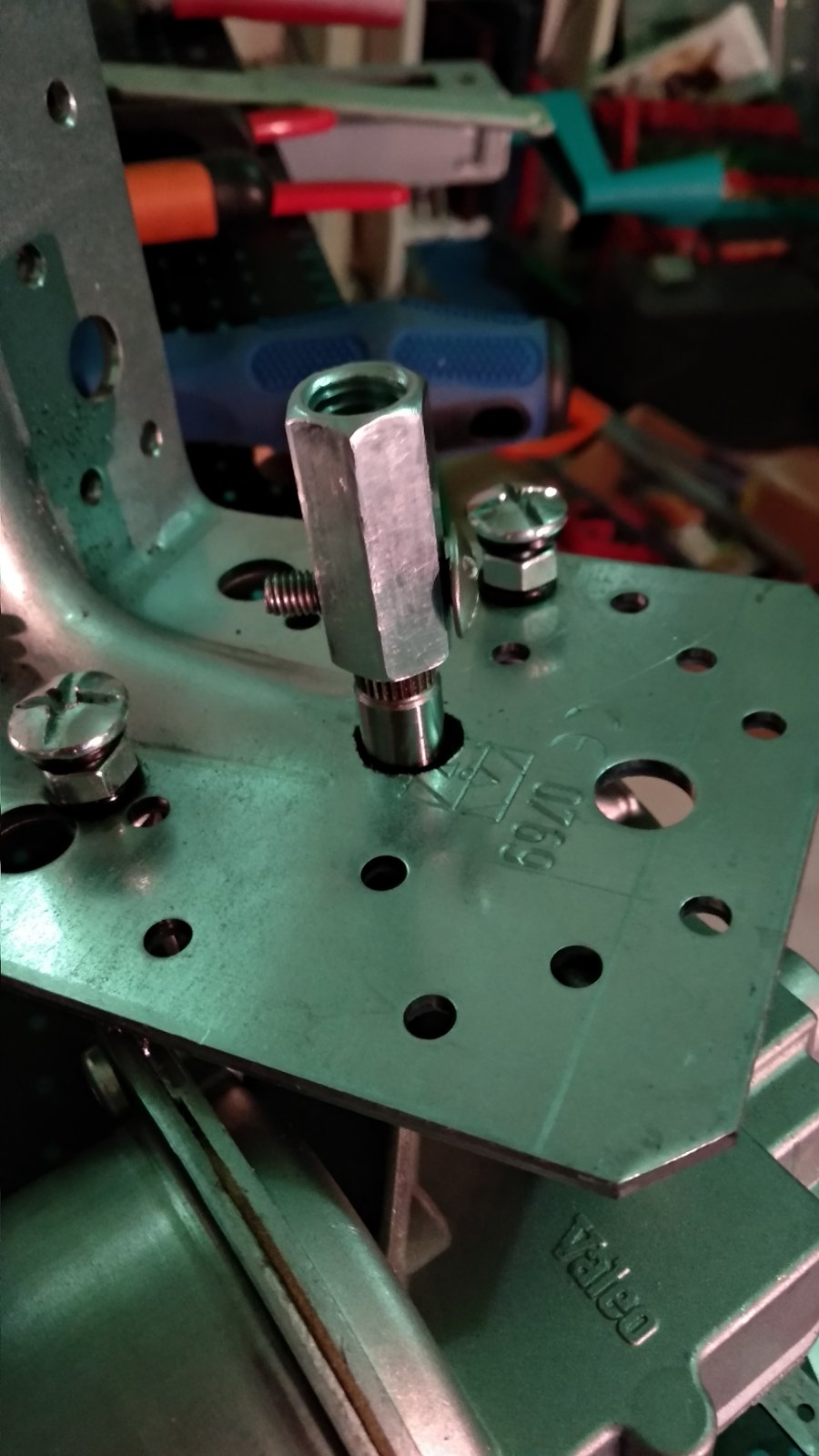

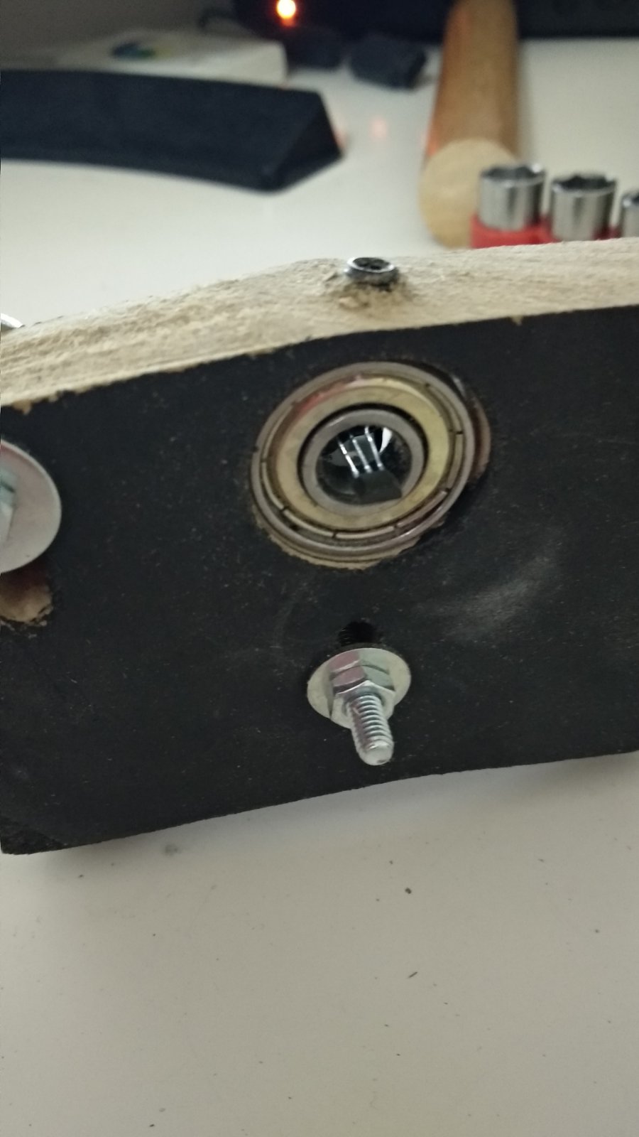

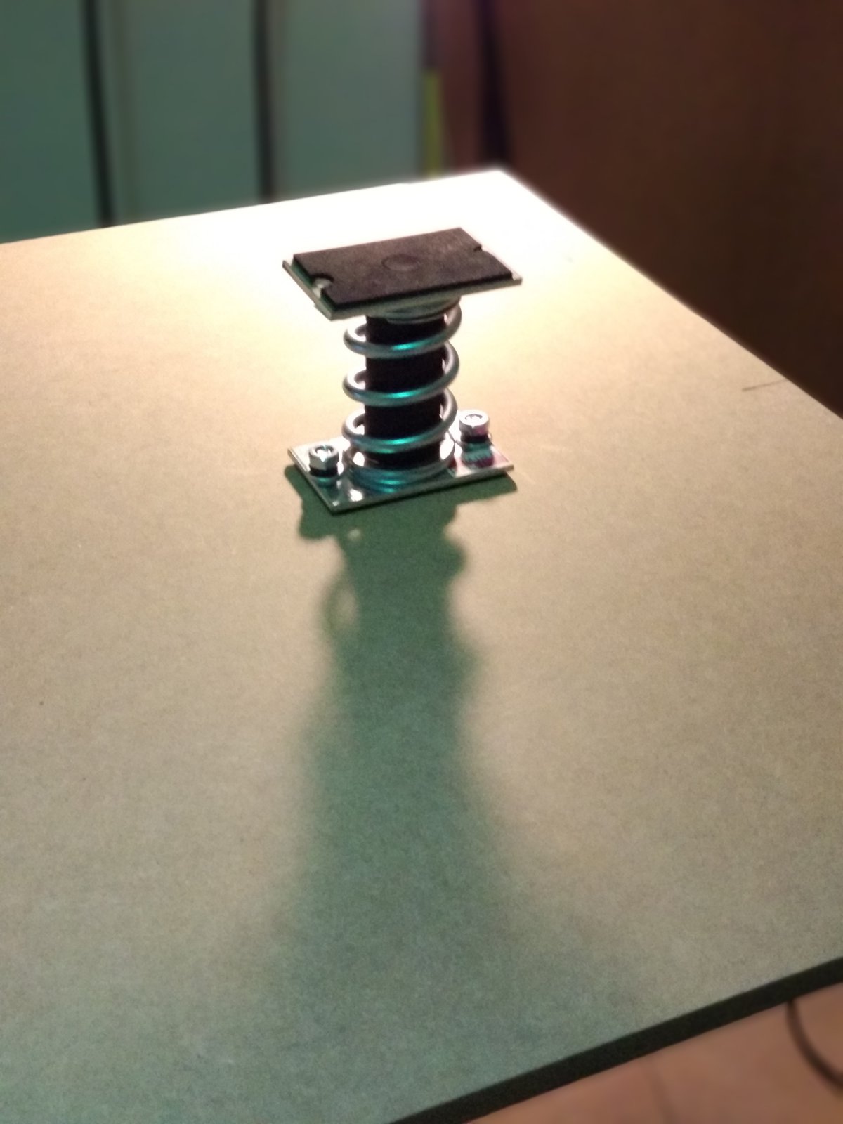

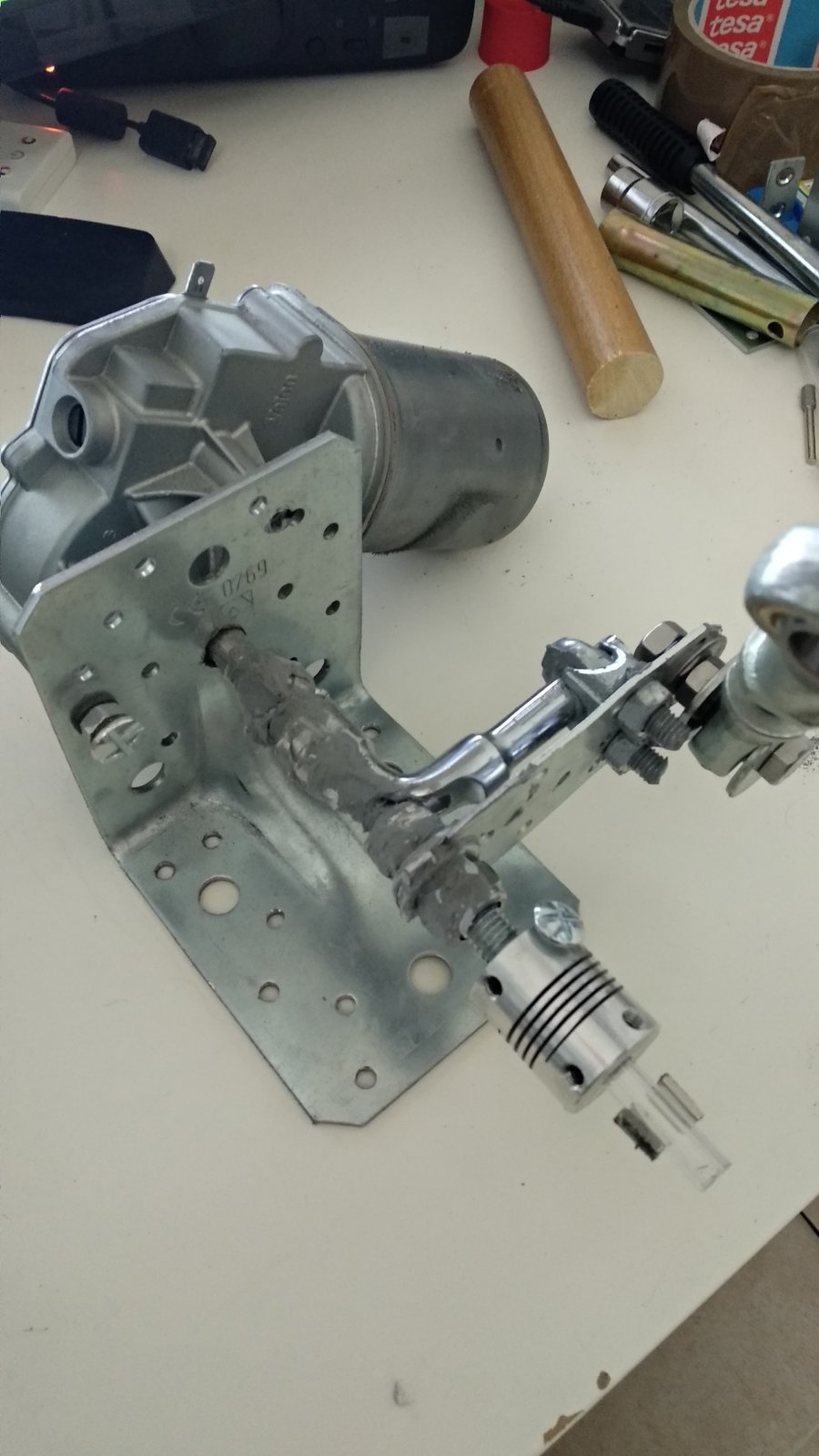

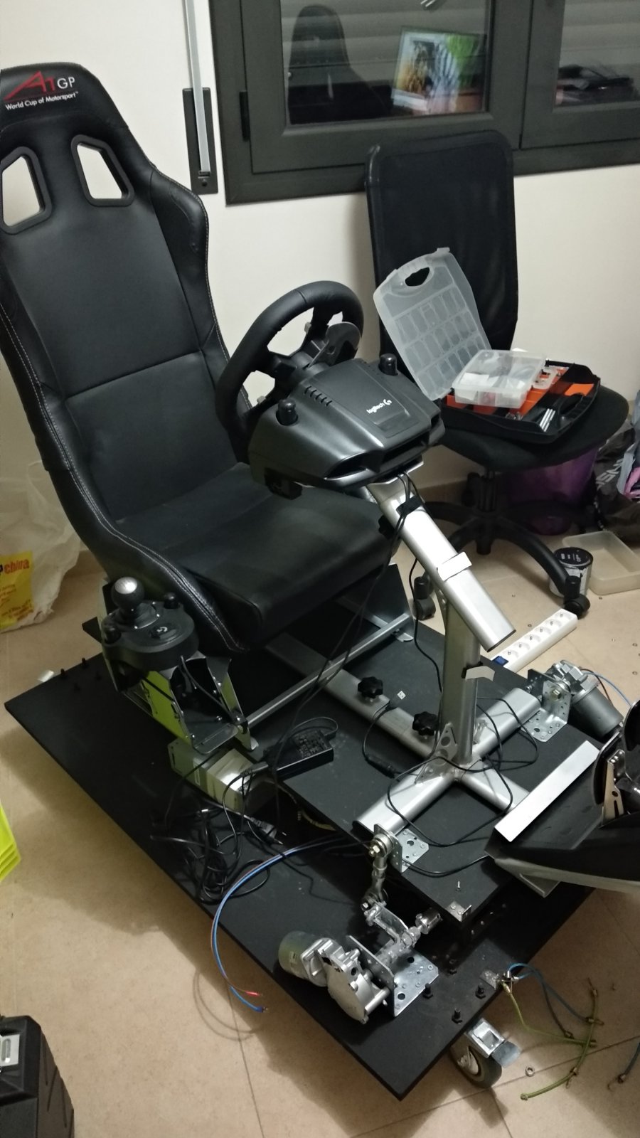

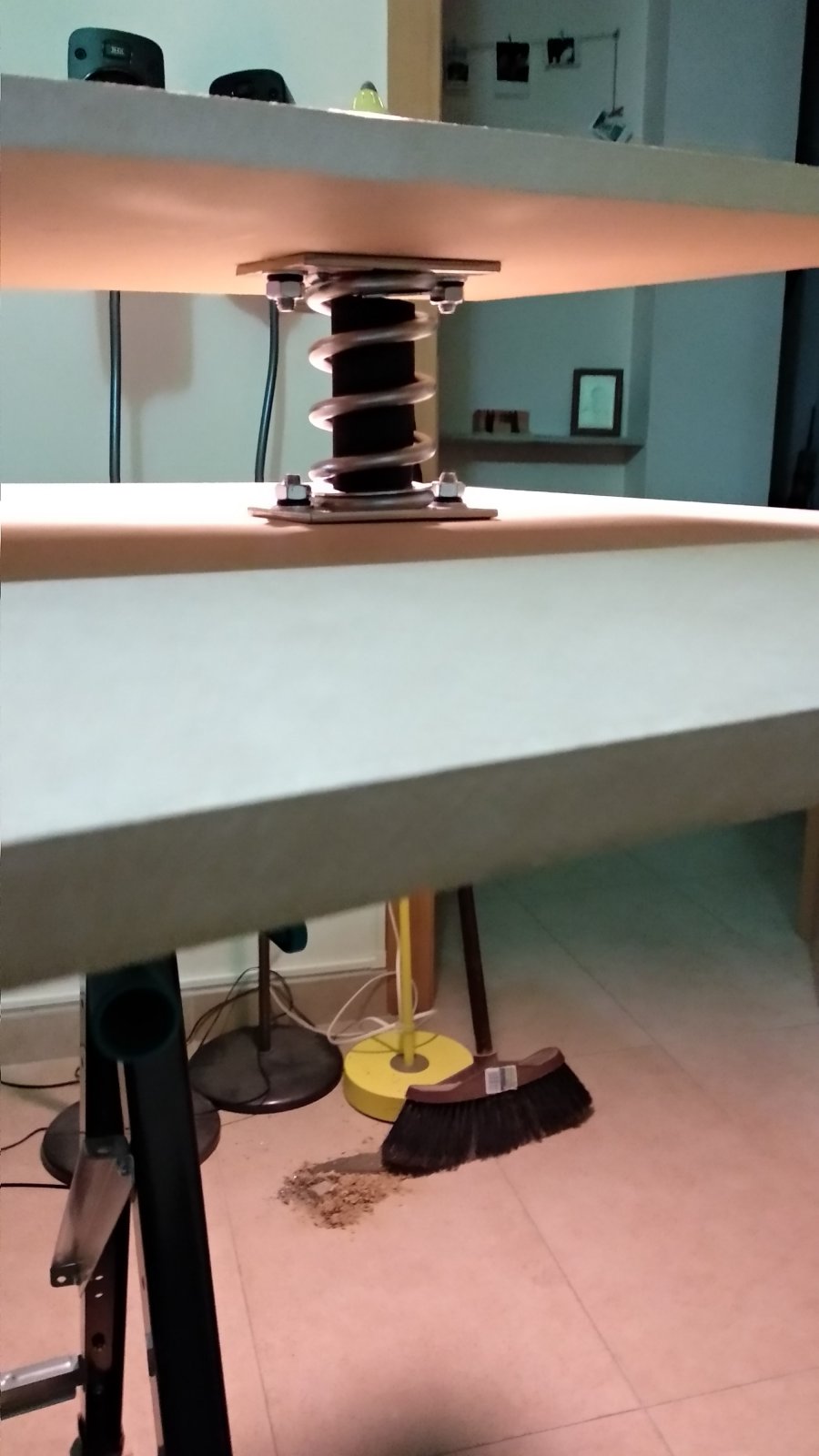

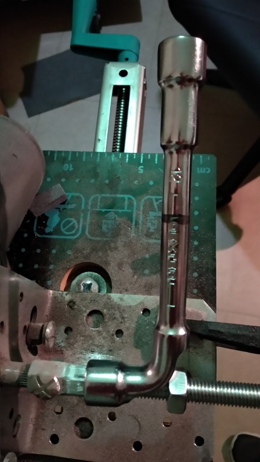

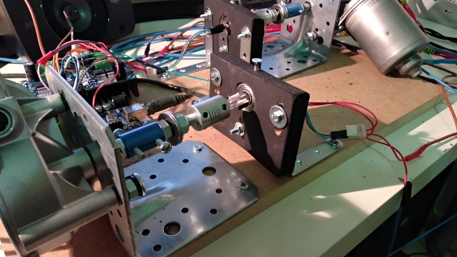

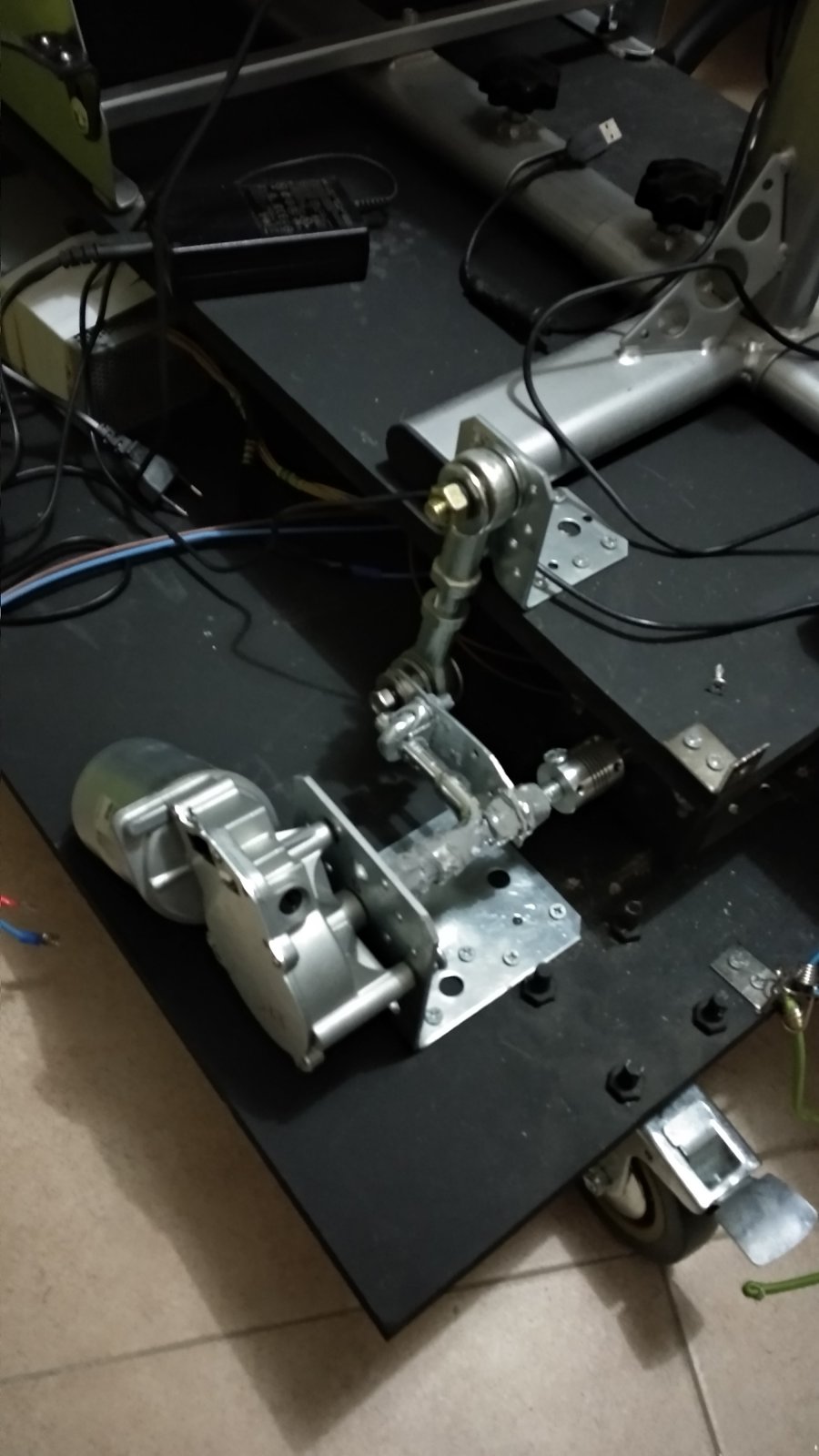

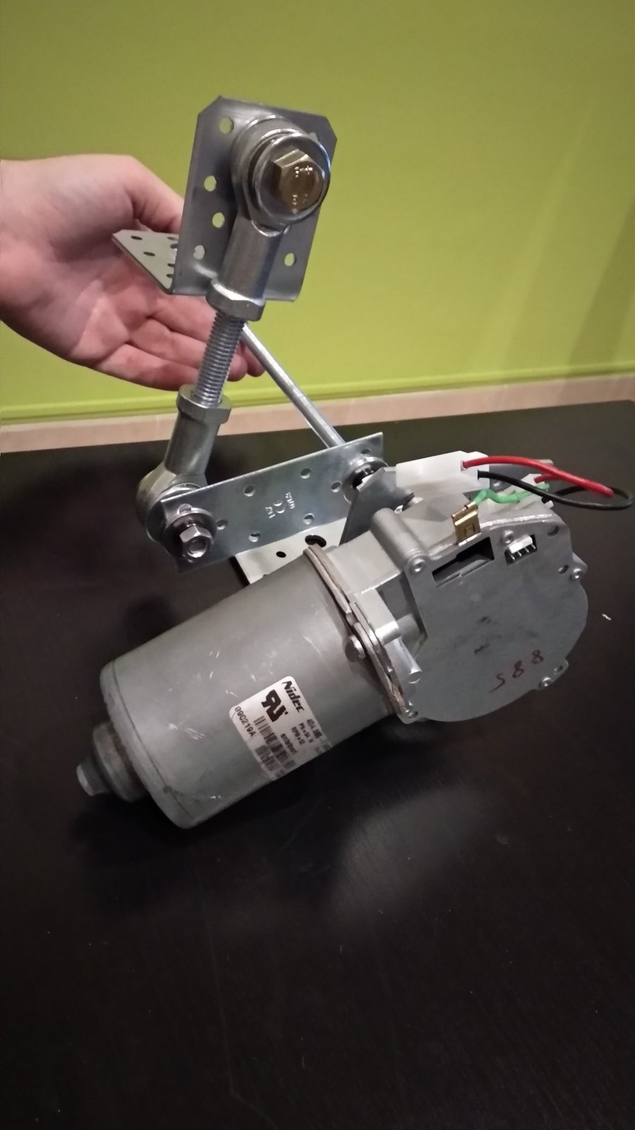

    Hello everybody!
    This is my first post in this community and I am glad to show you my 2DOF project!
    I have to finish putting some fans to the motors and a new case to support the wheel and avoid the middle stick. For now, I will show you the images of the process and my 2DOF almost finished!!
    IMG_20180107_220732_HHT.jpg IMG_20180107_220744_HHT.jpg IMG_20180107_220801_HHT.jpg IMG_20180108_211326.jpg IMG_20180108_212628_HHT.jpg IMG_20180124_233448_HHT.jpg IMG_20180130_220649_HHT.jpg IMG_20180130_220703_HHT.jpg IMG_20180207_213649_HHT.jpg IMG_20180210_203632_HHT.jpg IMG_20180210_203701_HHT.jpg IMG_20180211_122355.jpg IMG_20180223_212012_HHT.jpg IMG_20180223_215231_HHT.jpg IMG_20180223_215254_HHT.jpg IMG_20180223_215618_HHT.jpg IMG_20180223_215635_HHT.jpg
    Yuhuuuu!!
    I have played in Live for Speed with the demo of simtools and it's very fun!!!
    If you want some details of my building you can post a question!
    Bye guys!!

    Hi!
    I used the SMC3 Arduino 3DOF Motor Driver shared in this community. I follow the guide of RufusDufus, and I enter the mode 2 using the SCM3.ino code for Arduino since I use IBT-2 H-bridges to control the motors. The PSU(s) are two different PSUs connected in series this way:
    One of them is a PSU from a PC with 250W (I think) and 15-16 A, and the other is an HP PSU with 200W aprox. and 15A aprox too. I don't remember now exactly the W and A of PSUs but I am sure that they are different. If you need more details I can tell you all the characteristics of the PSUs when I arrive at home. Bye!

    I have to say that the movement are soft because I set 50% of amount of axis in simtools. However the sensations in the rig are very impressive. I have to adjust to 70-80% of amount of axis and test if the motors can withstand the effort. At 50% the motors are hot but not too much. My problem with the temperature of motors is when I stop to play and I stop the simtools software. In that moment, the motors are hotter (Very very hot) compared when they are running with me on the rig. Anyone knows what are happening? I don't understand. My solution right now is to switch off the motors after stop the software to avoid overheating. But other solution would be better if I knew the real problem (configuration in Arduino? bad configuration in simtools software?) Thank you for your help!!

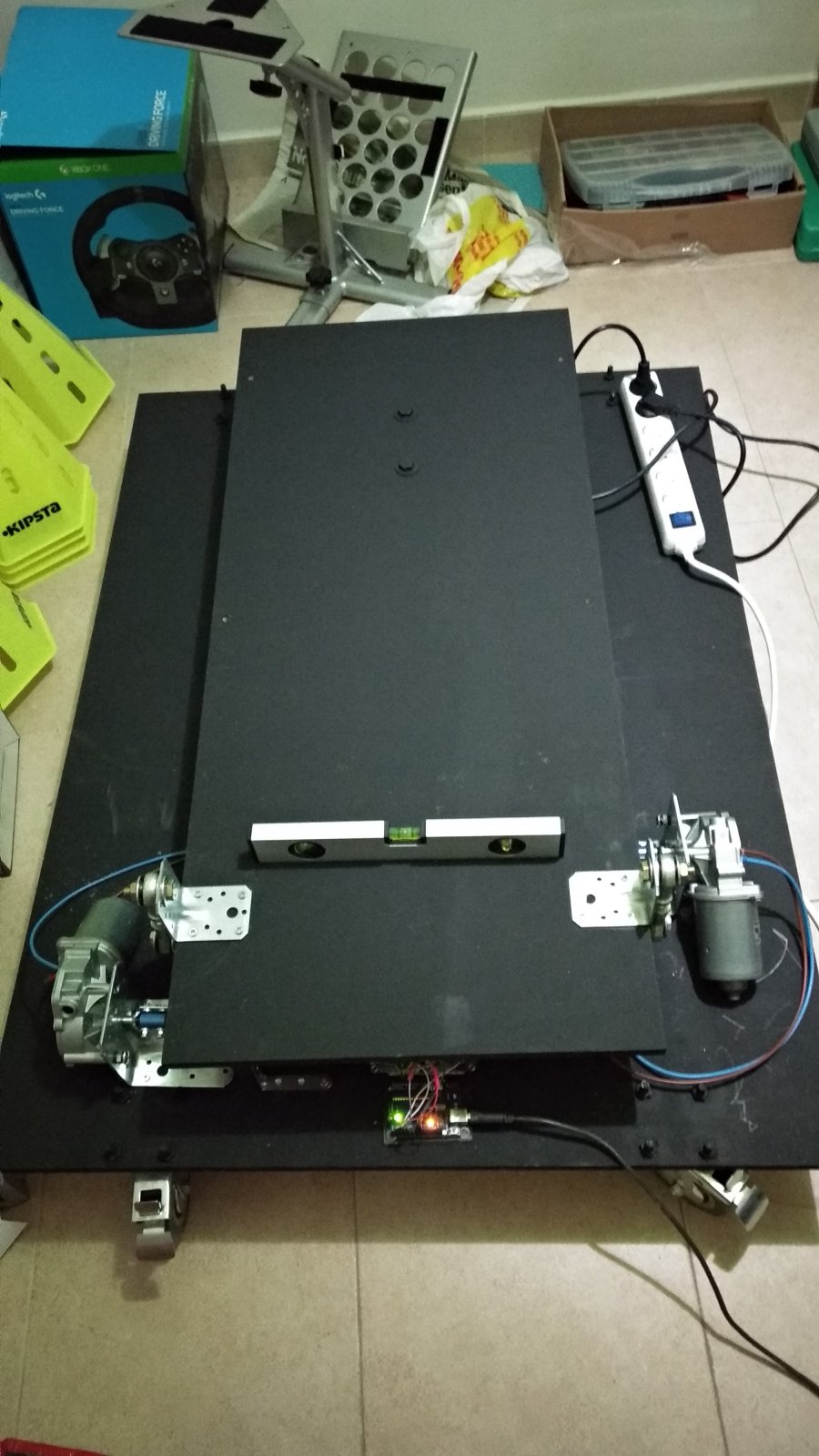

    A question, Ratafia...
    Why did you decide put the engines in front instead of behind?
    Is it for some reason?
    Thank you!
  10. RacingMat
    2,236
    20,962Coins
    +2,089 / 21 / -2
    motors have to be at a "good" length from the center of rotation.
    they can be front or back :
    by putting the motors in the front, the rig is more compact
