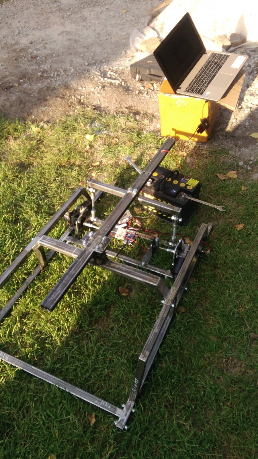

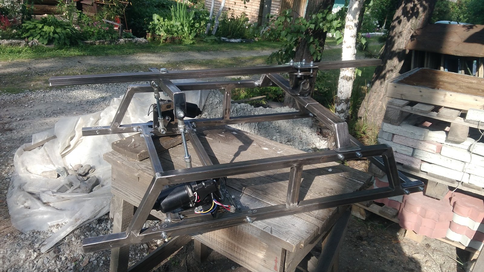

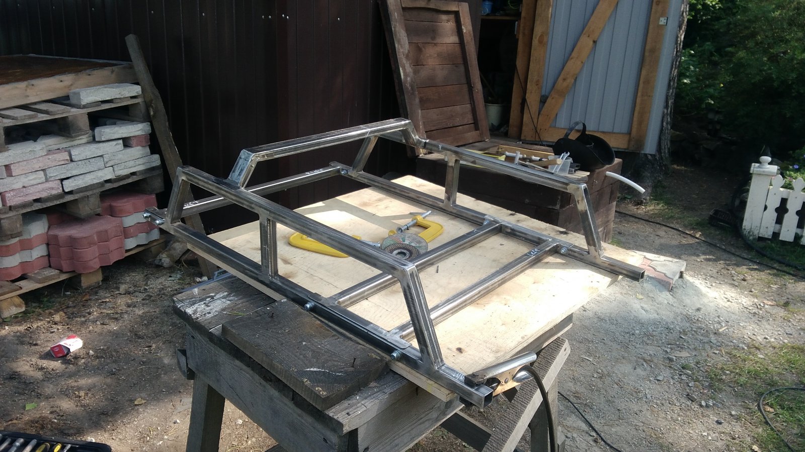

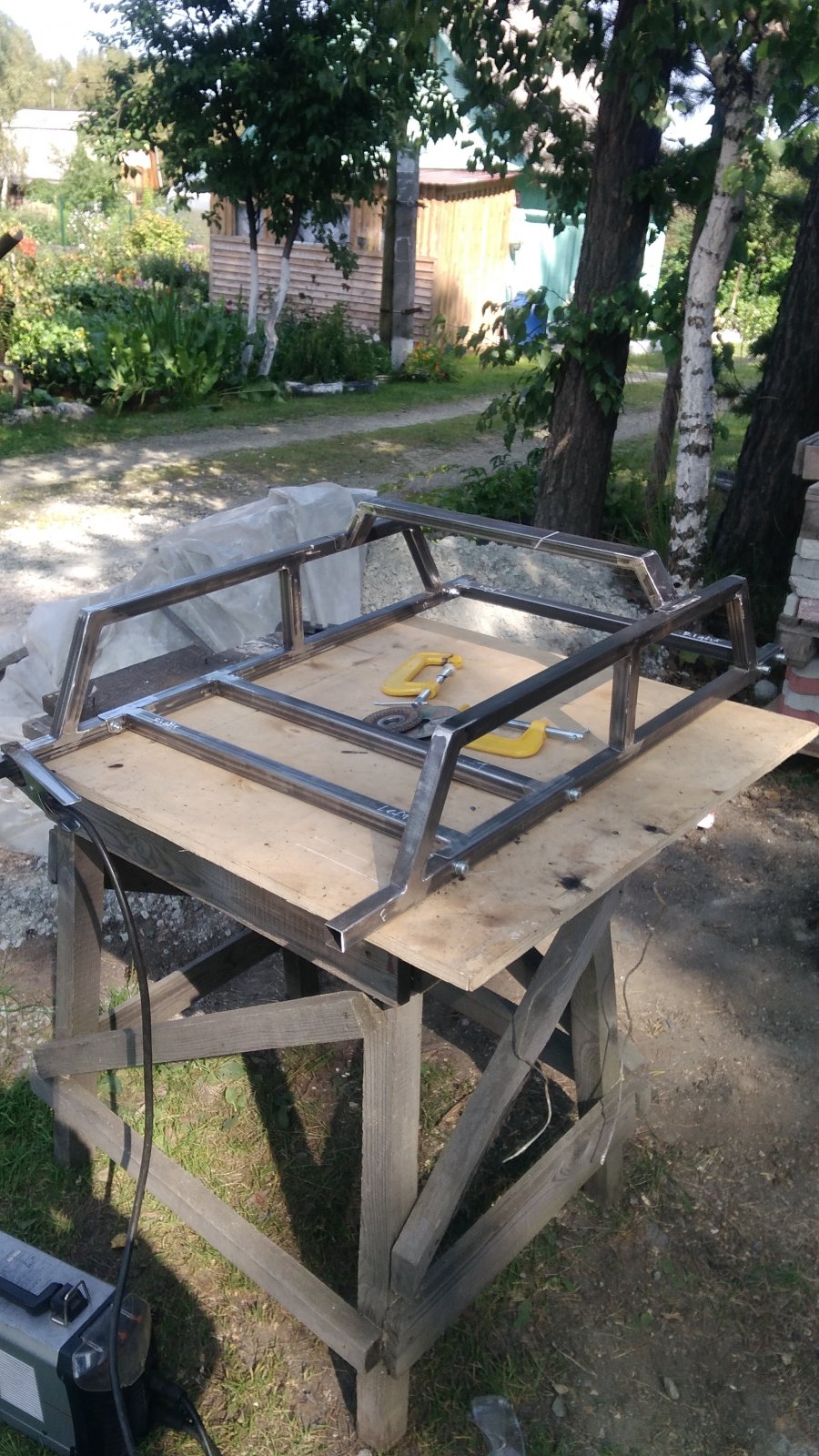

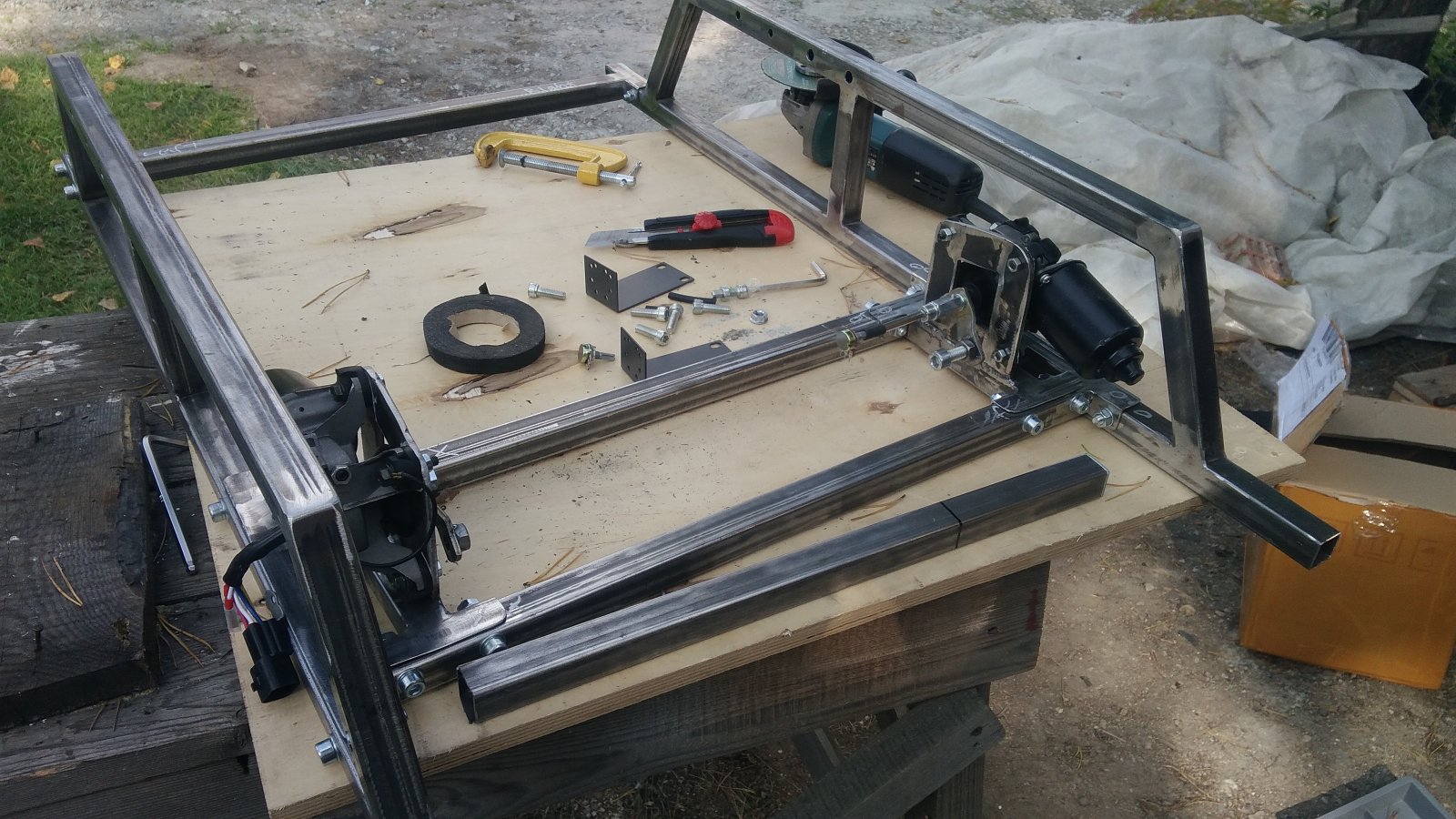

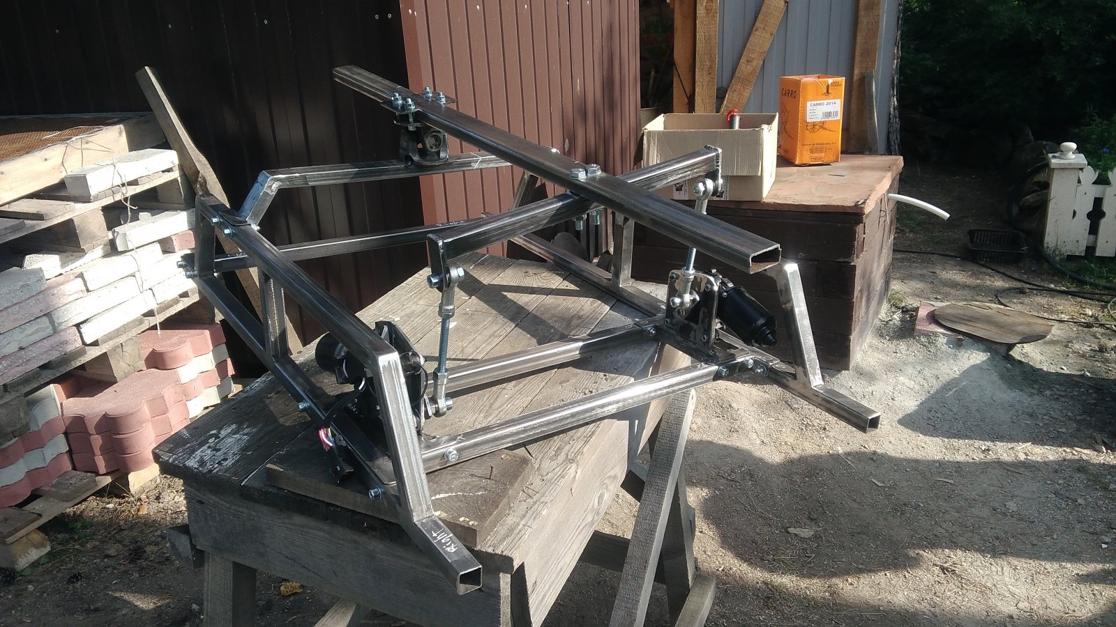

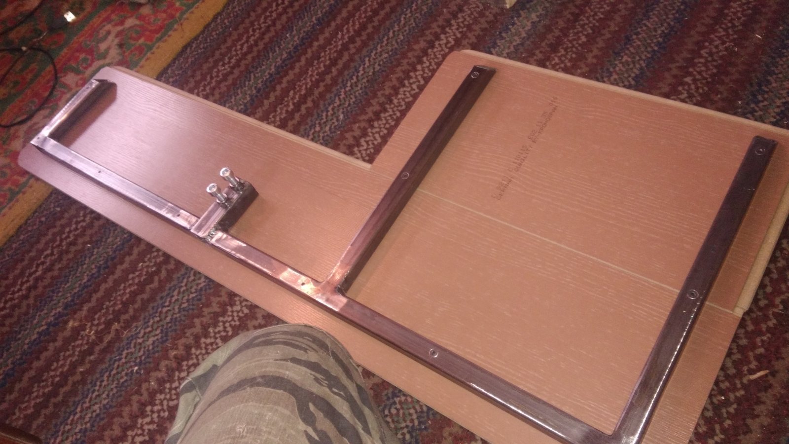

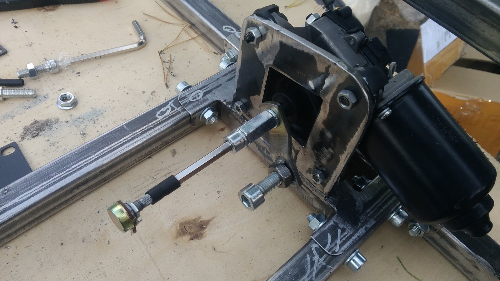

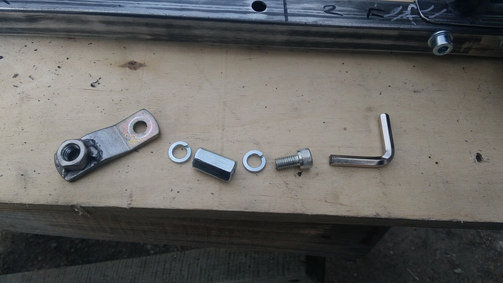

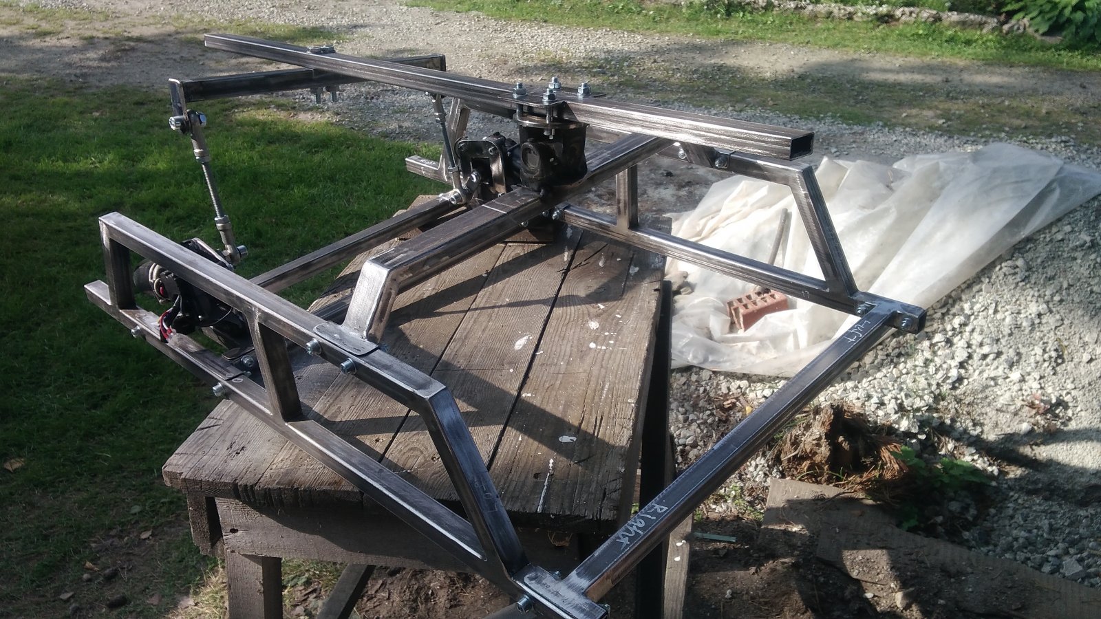

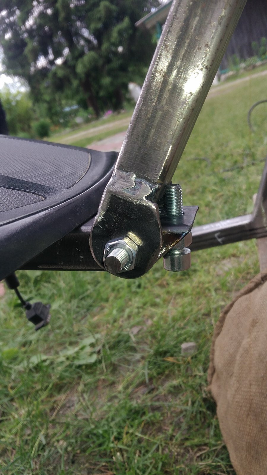

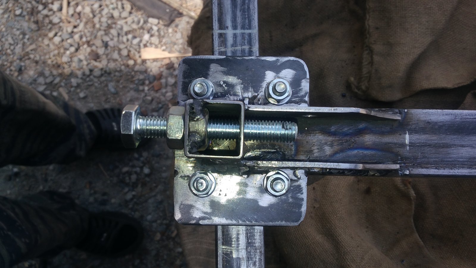

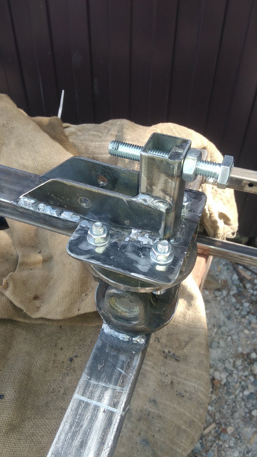

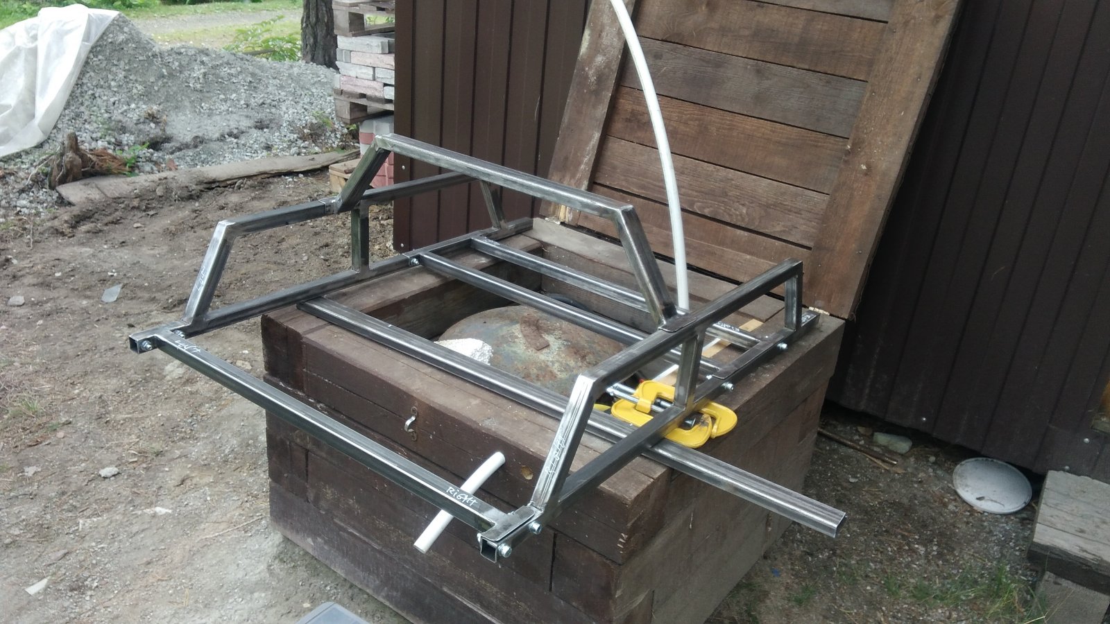

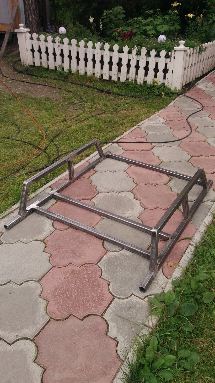

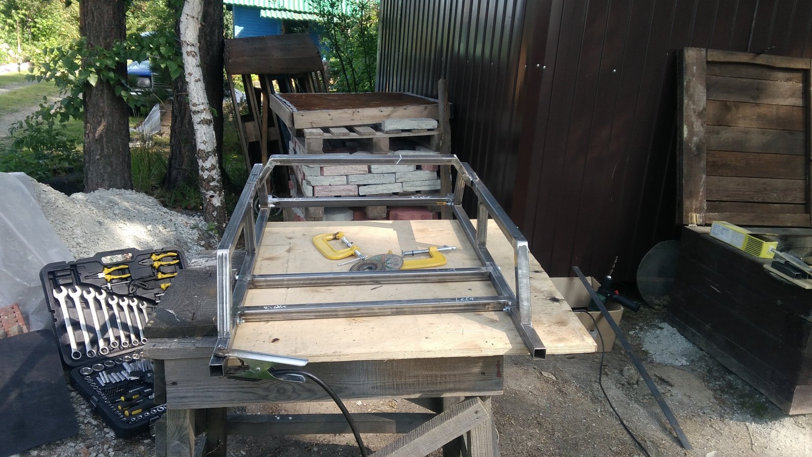

    Hello everyone!
    After long time and searching useful information I've decided to build it by myself.
    I have used these resources for the base of my project.
    I like that disign: https://dofreality.com
    And I like simpleness and cheapiness of that: https://www.xsimulator.net/2dof-motion-simulator-truck-wiper-motor-playseat/
    So I used both as inspiration for my rig :)
    Work in progress. I will remake many of

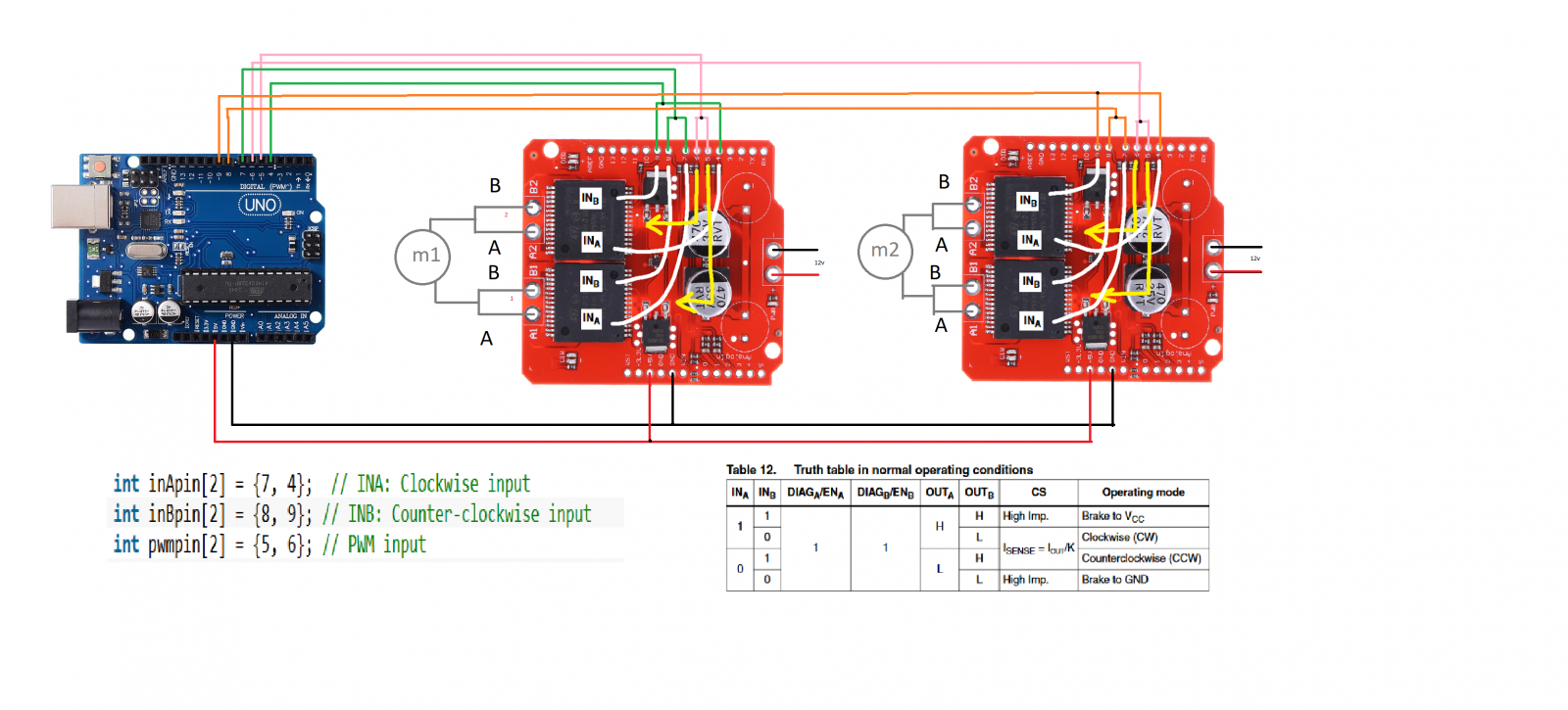

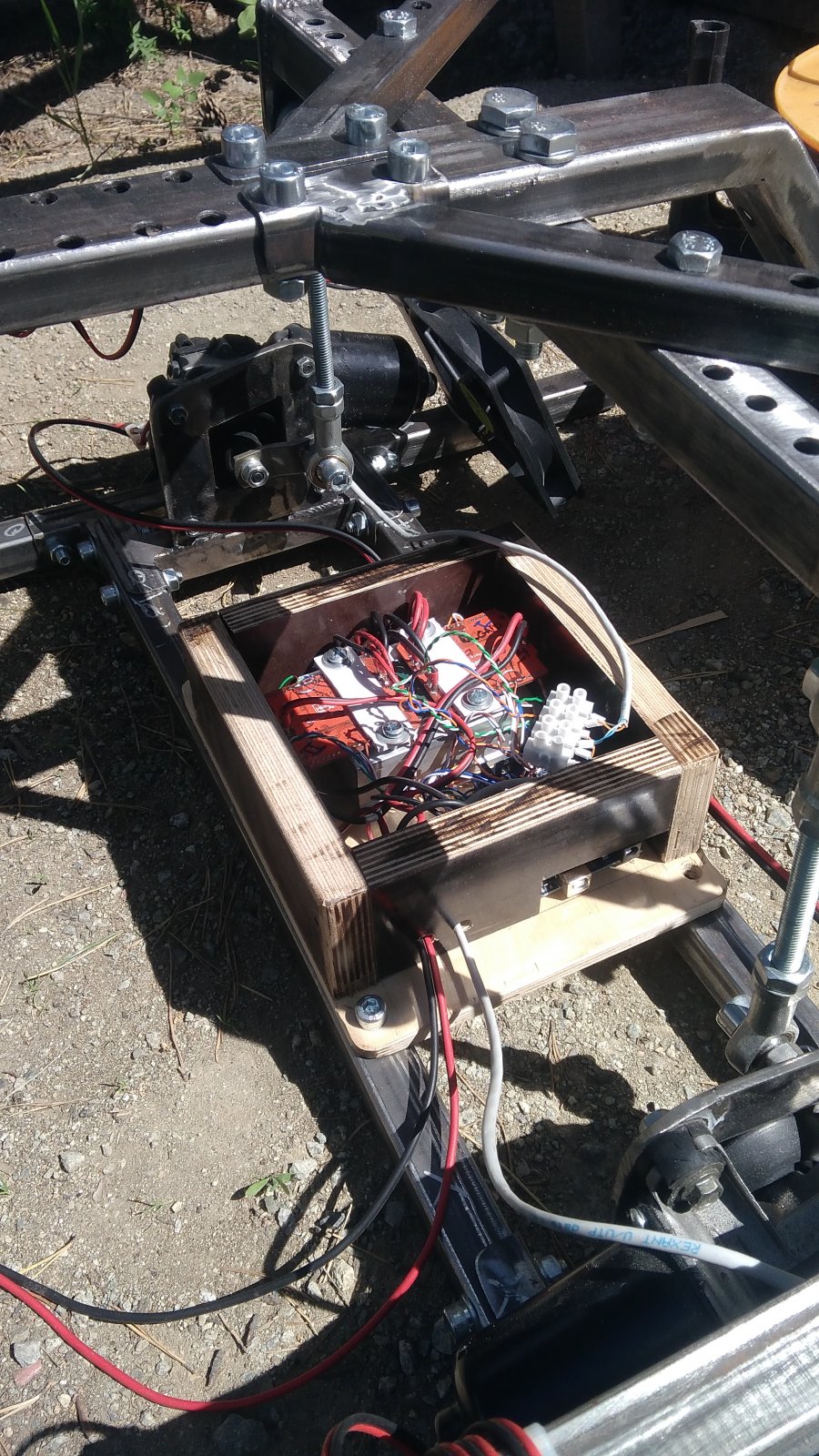

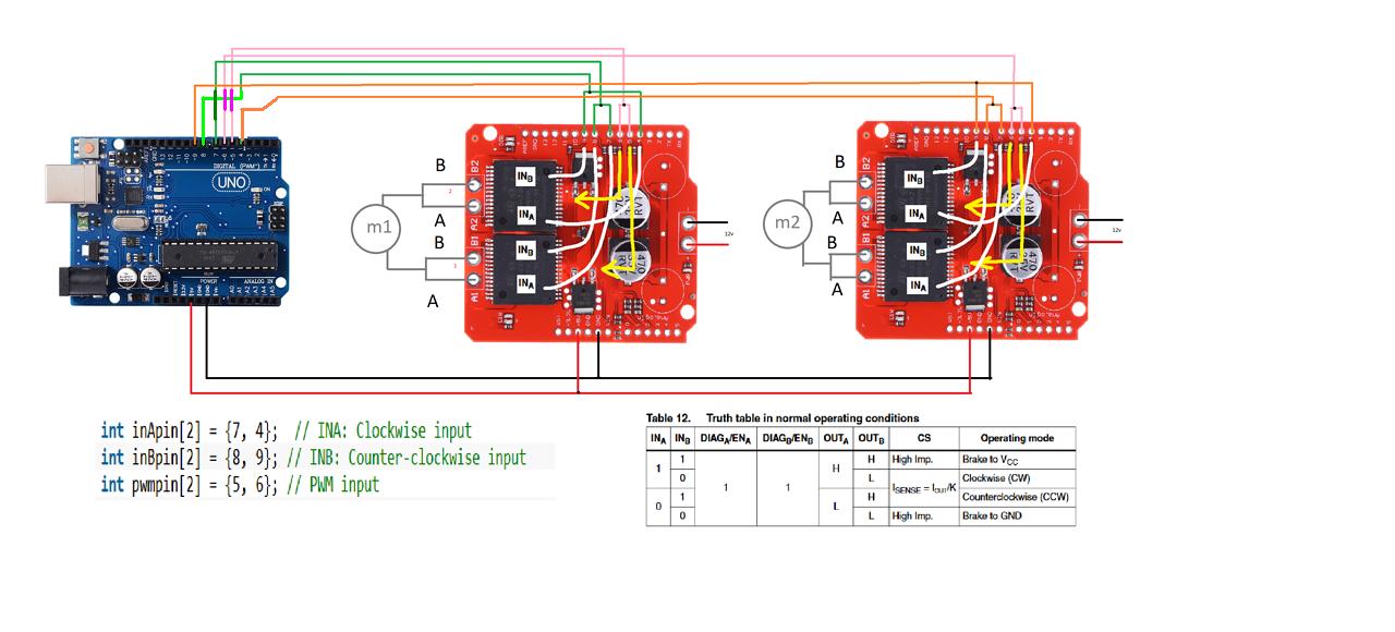

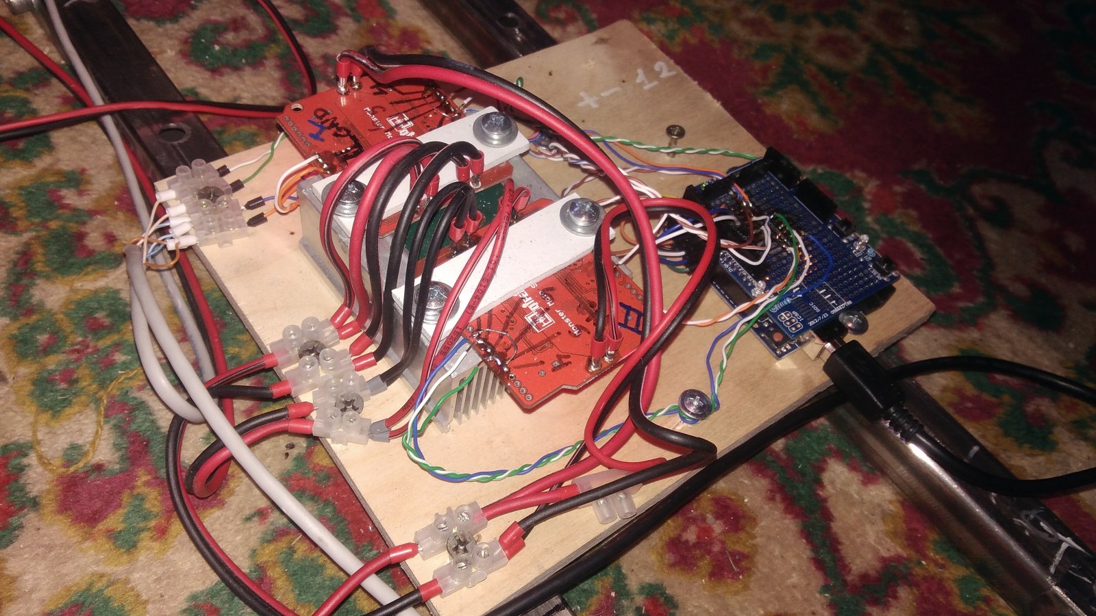

    Hello everyone!
    I'd tried to use two MotoMonster plates, and I drowed that scheme/ Is it correct on your opinion?
    Sorry about colours of wiring:)
  6. Viktor_s
    Viktor_s New Member
    Jul 12, 2017
    19
    Russian Federation
    - 44Coins
    +15 / 0 / -0

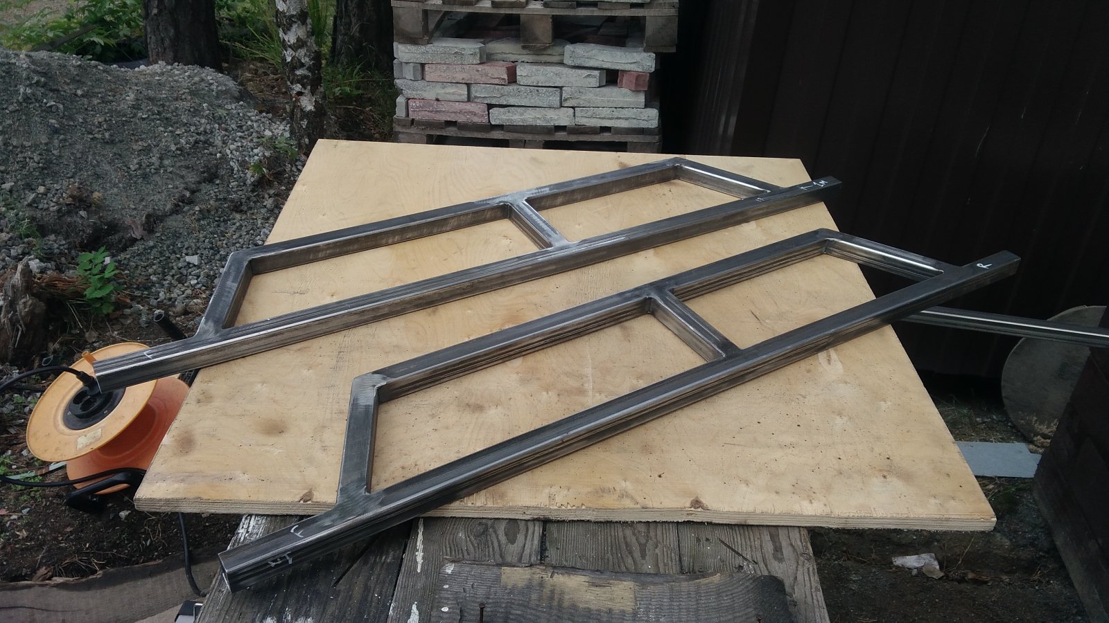

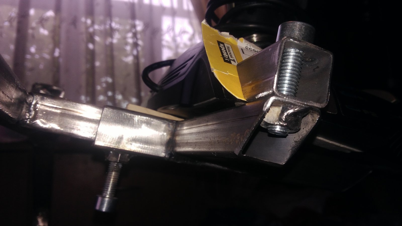

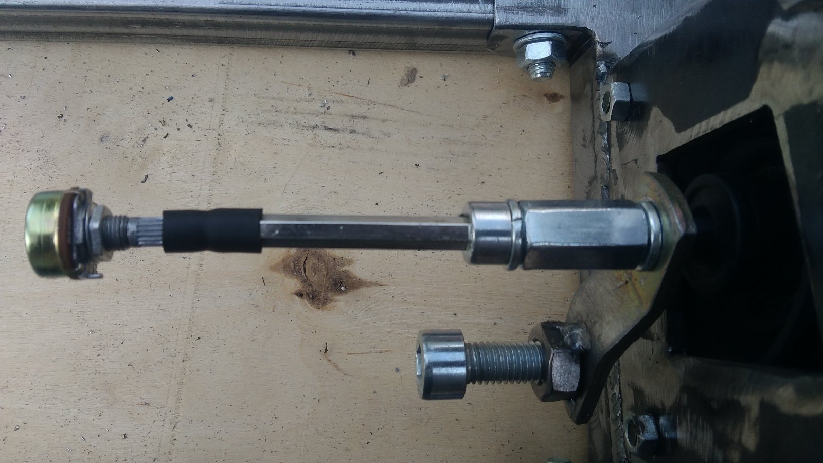

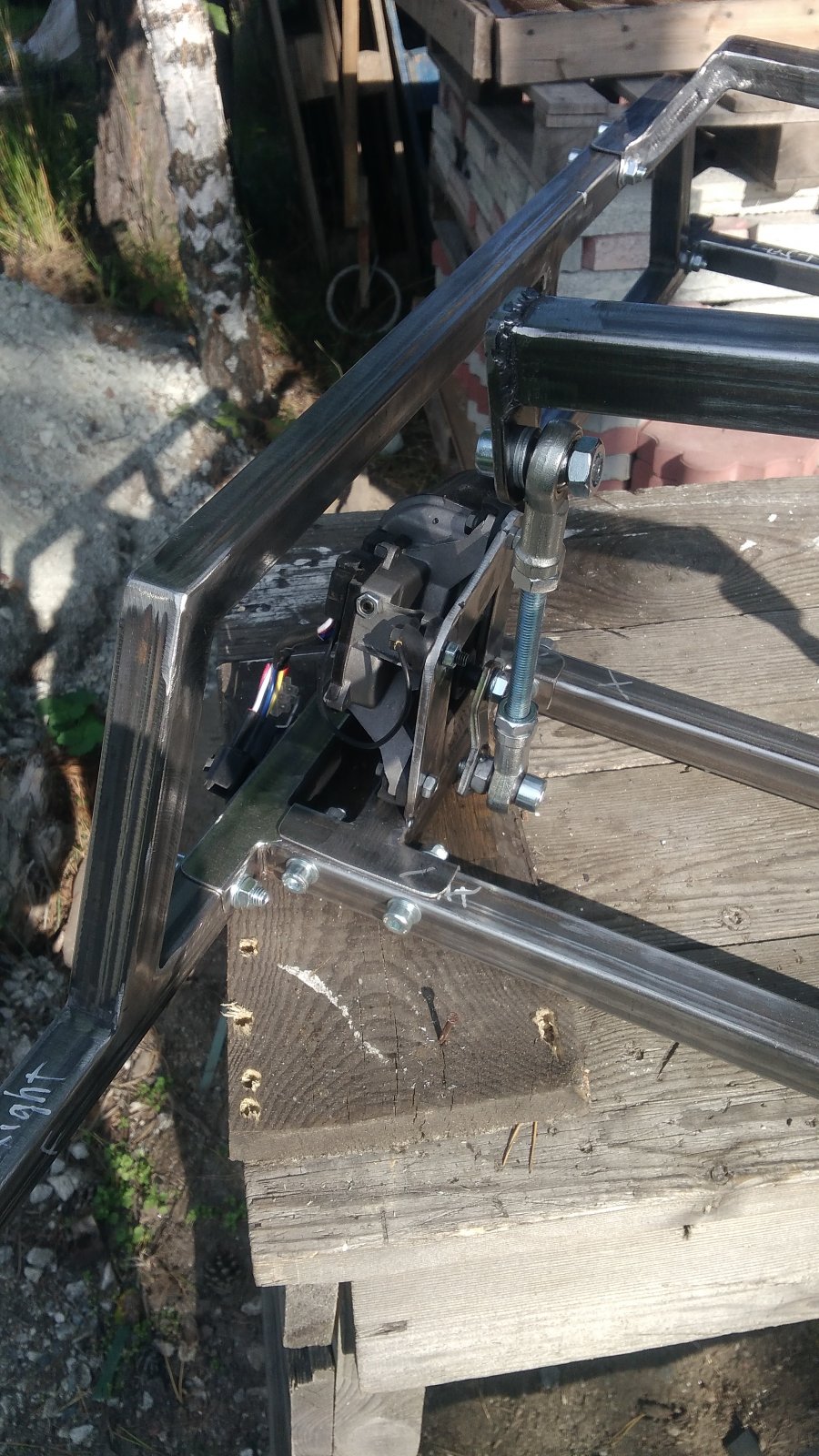

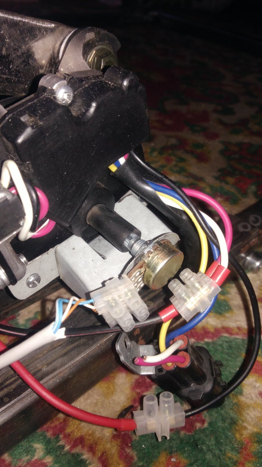

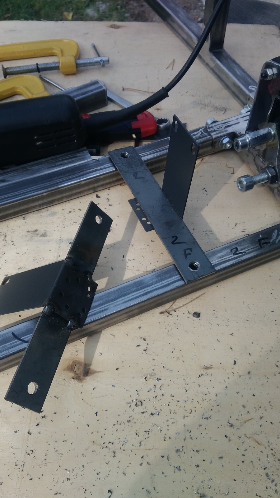

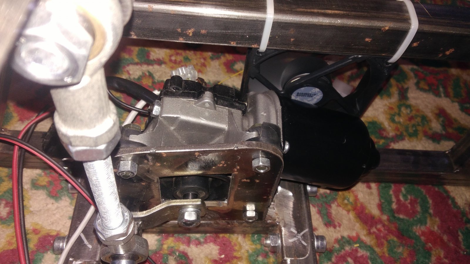

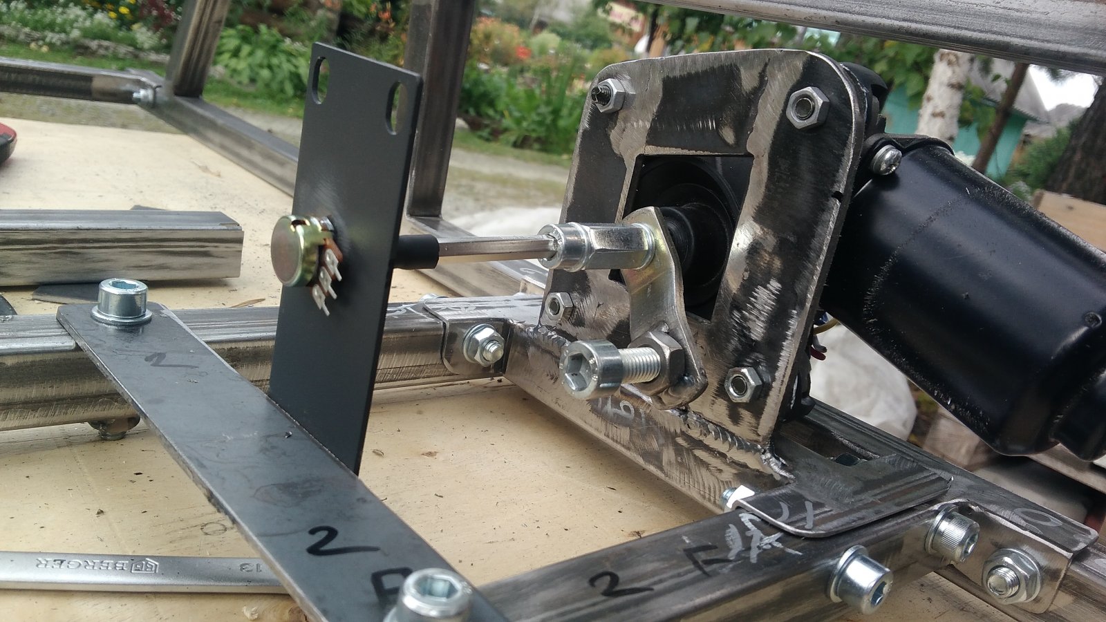

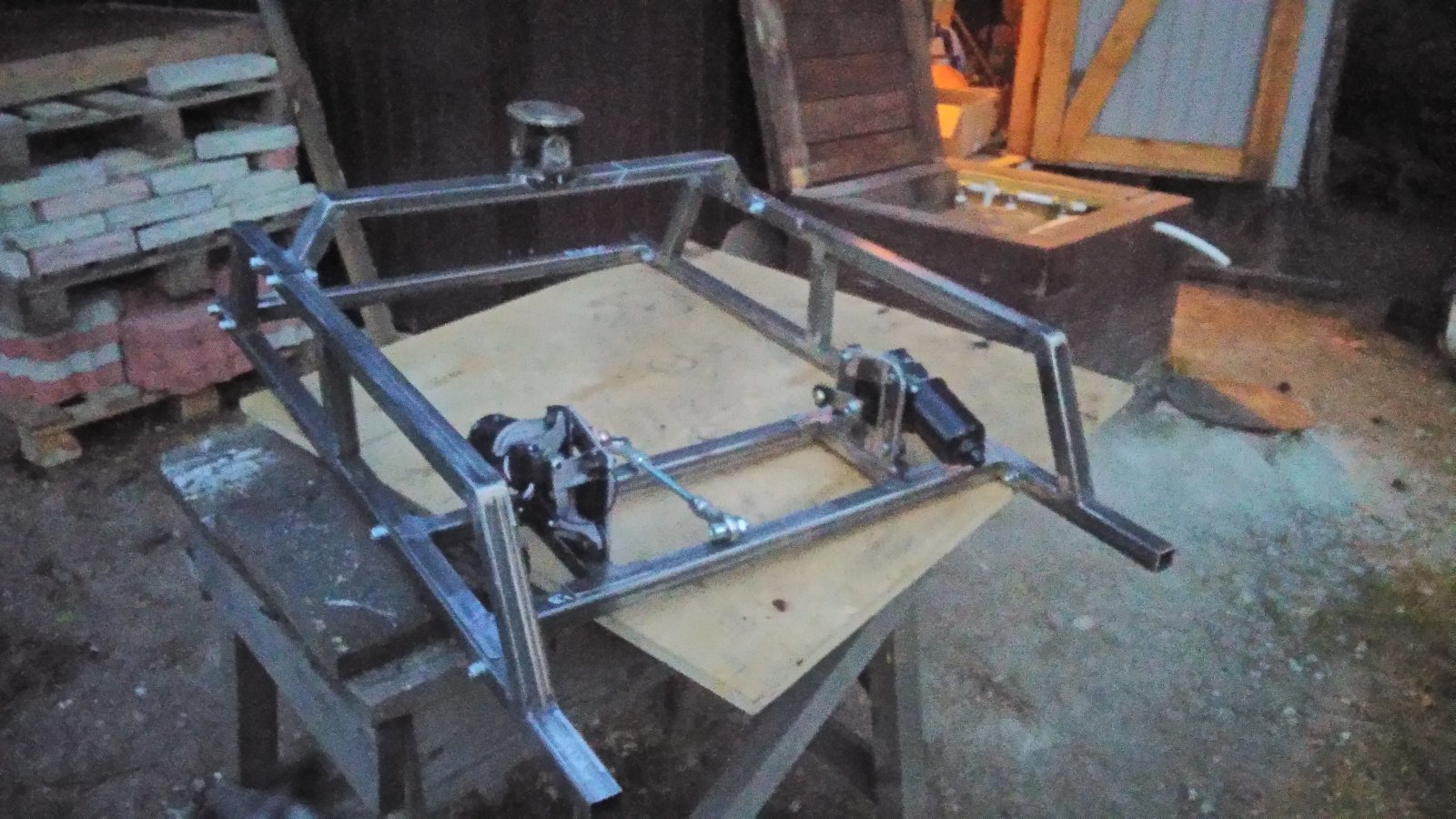

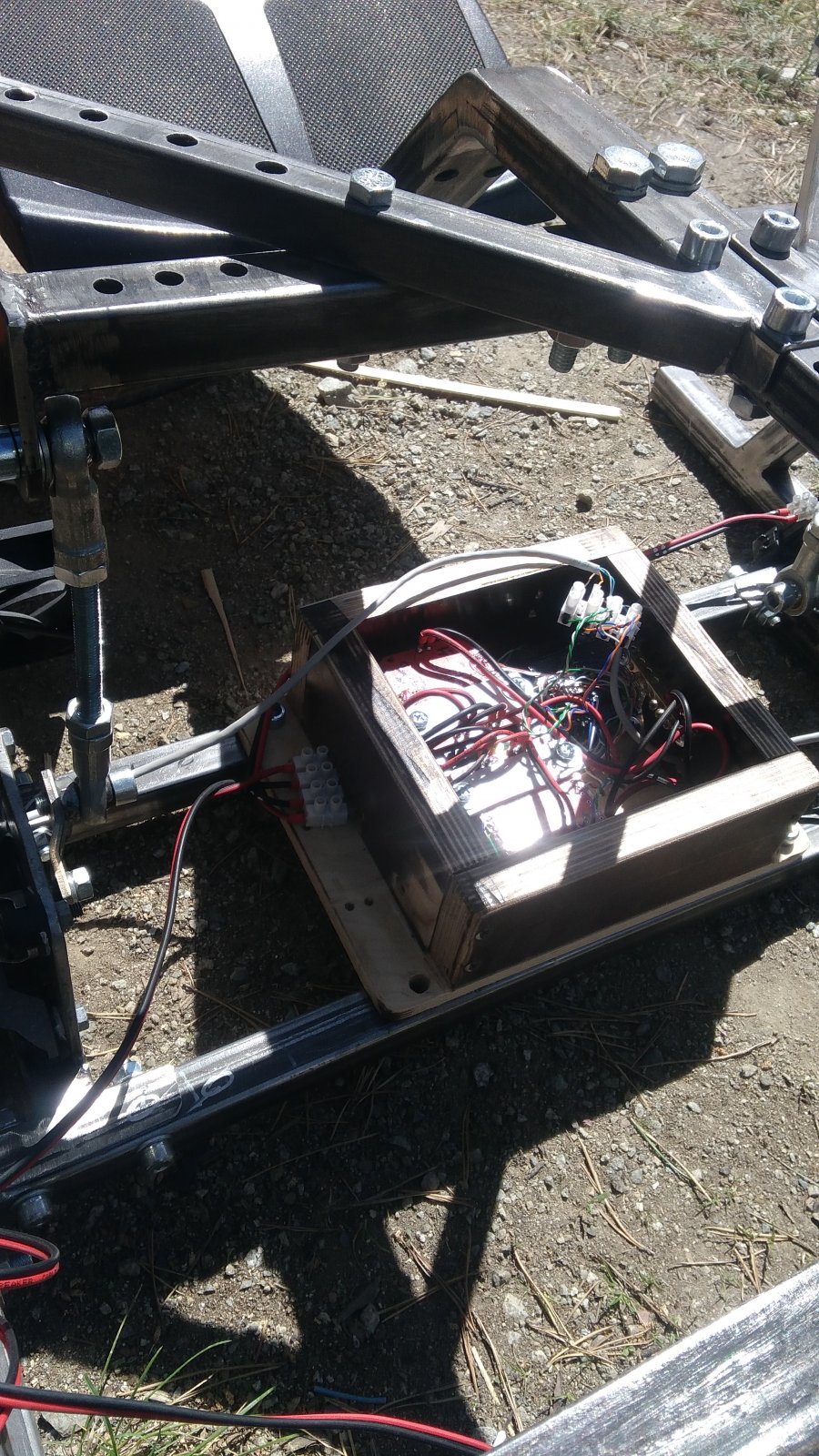

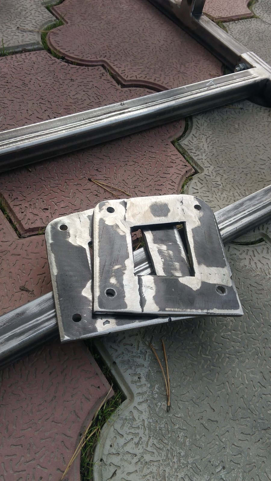

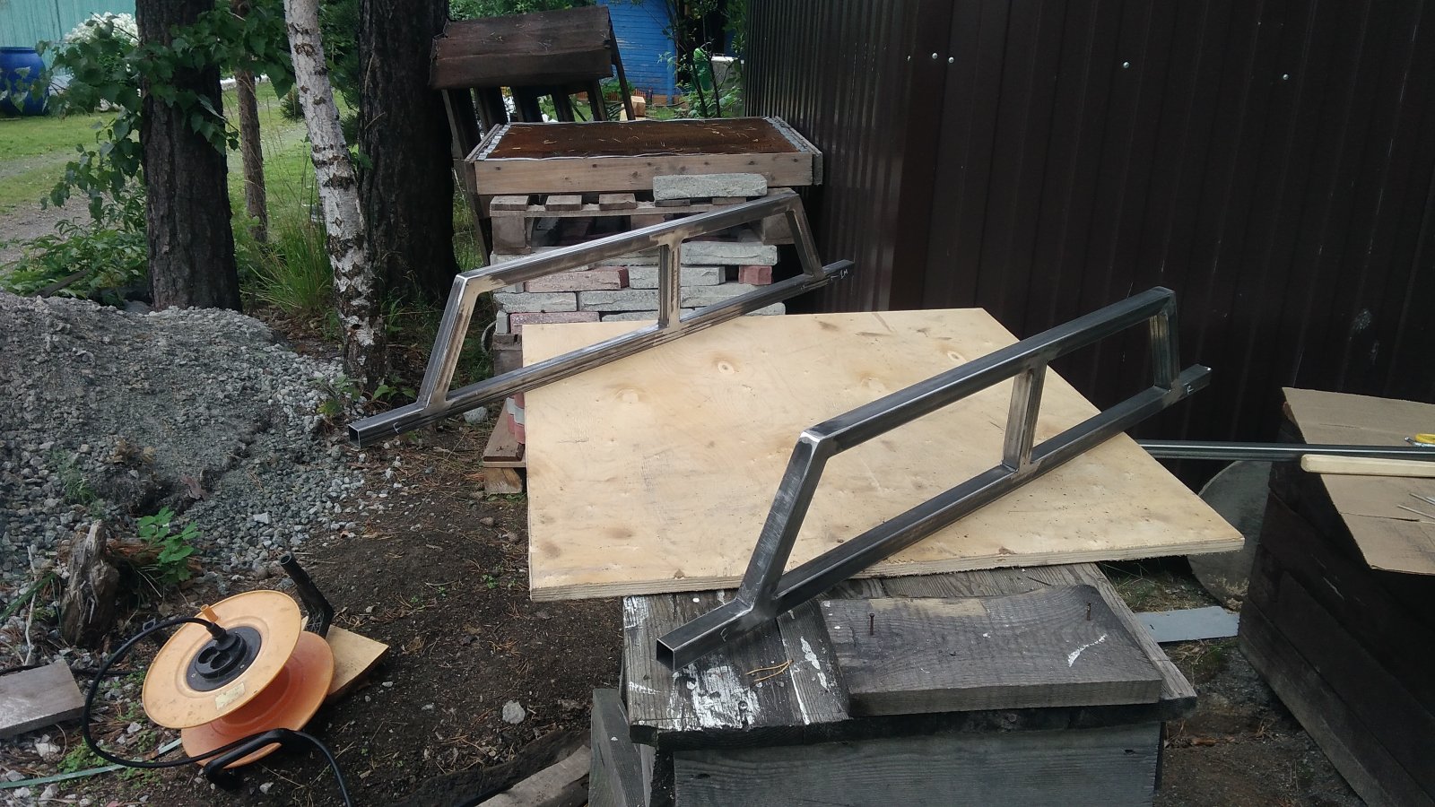

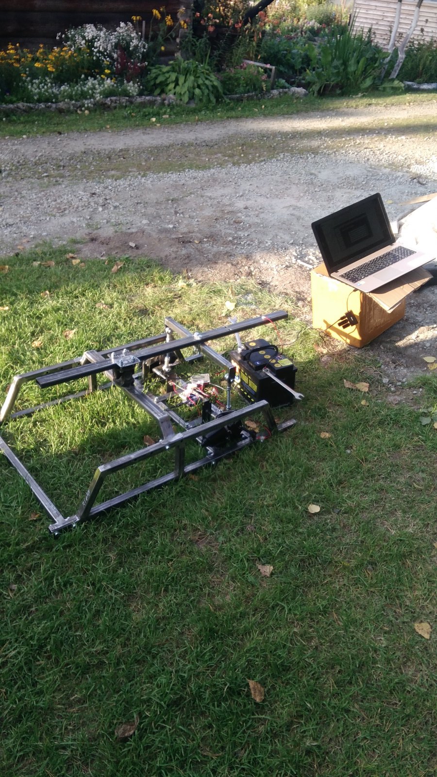

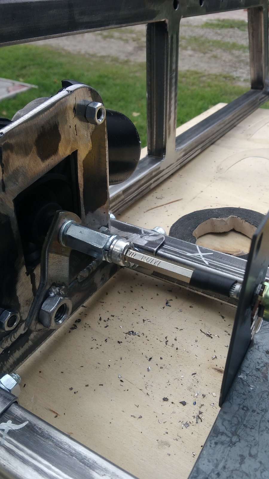

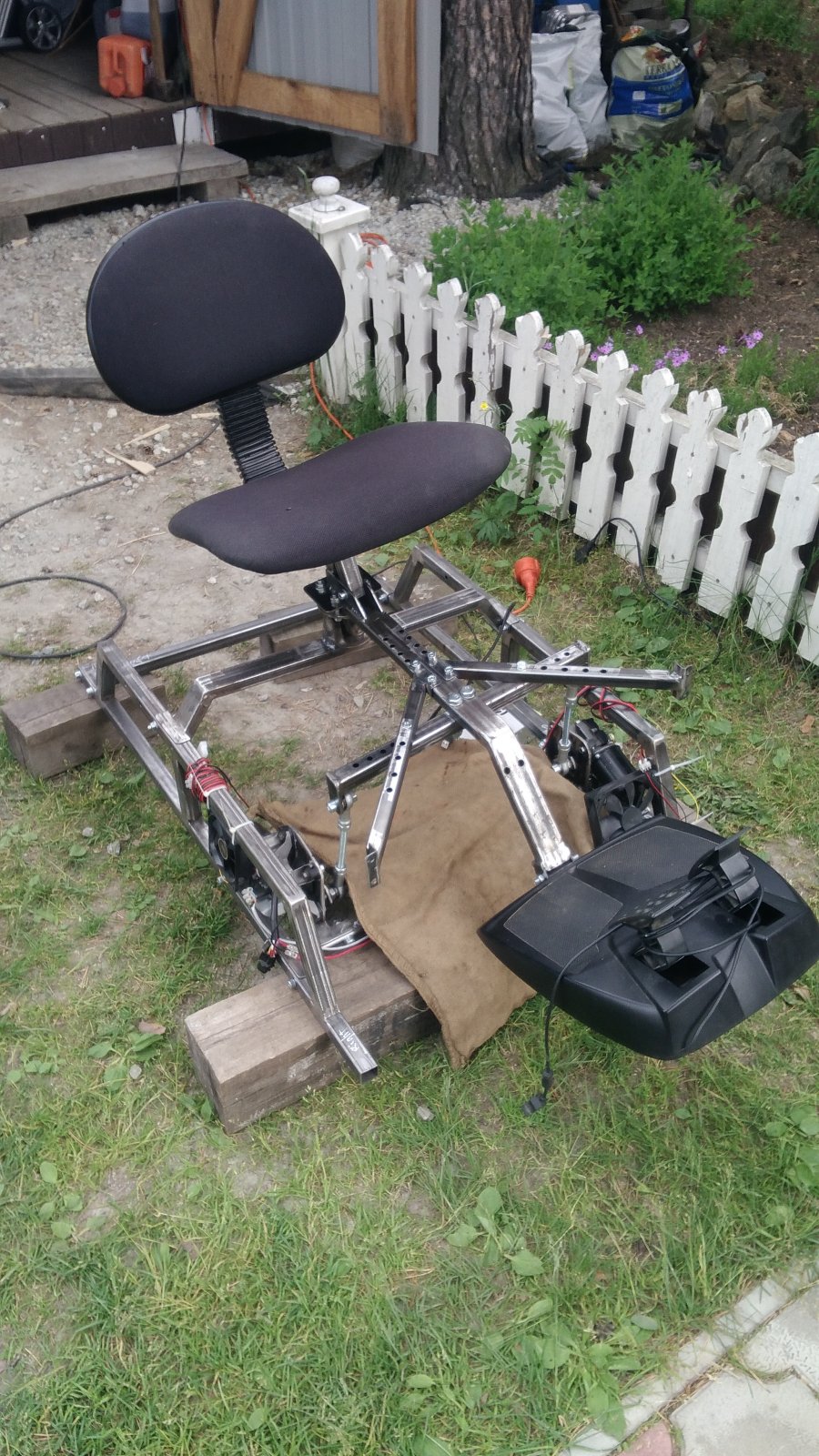

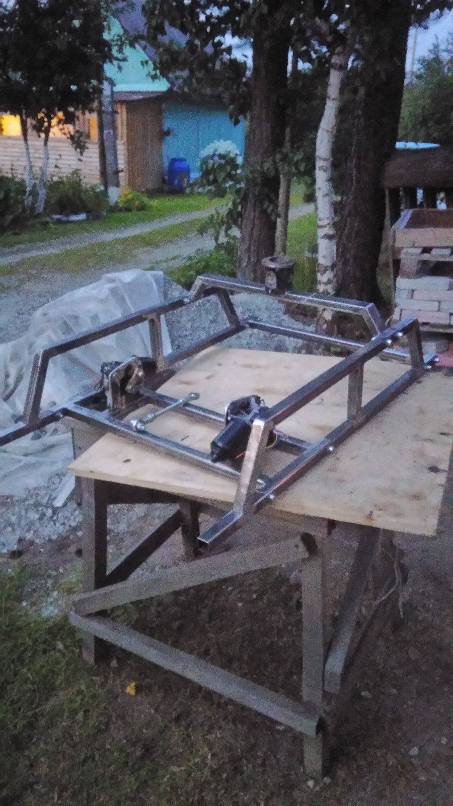

    Hi Everyone!
    The photos made in varius periods of time.
    Work in progress...

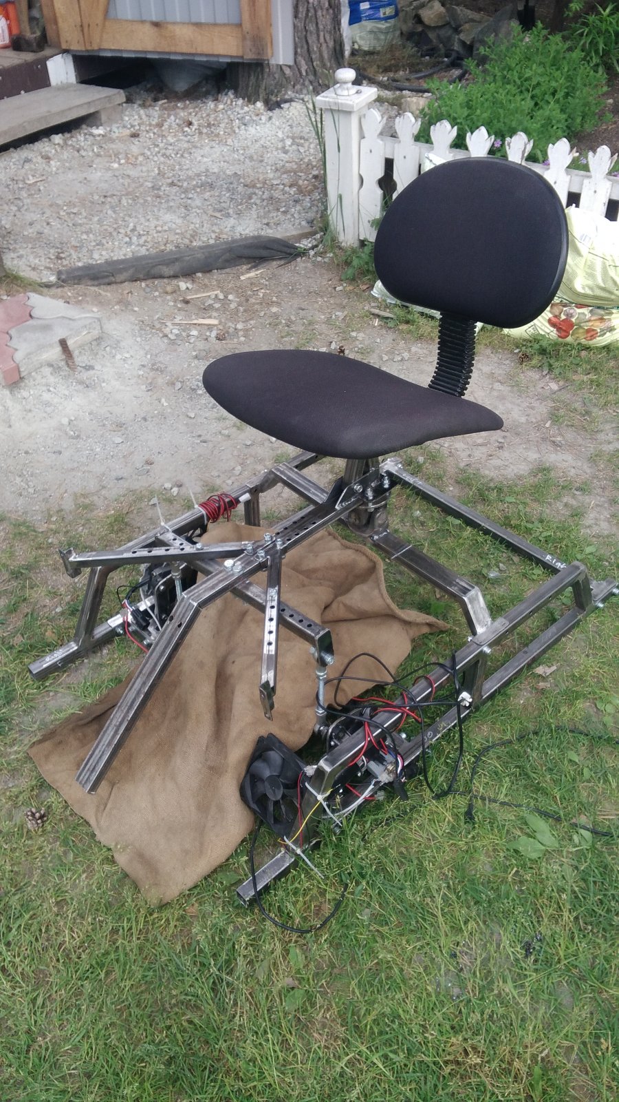

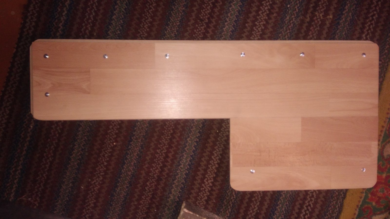

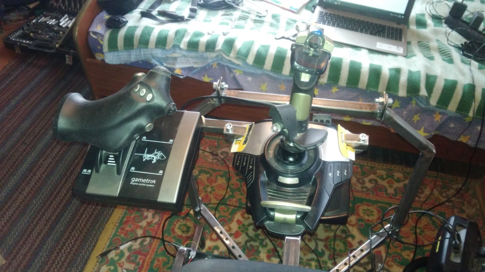

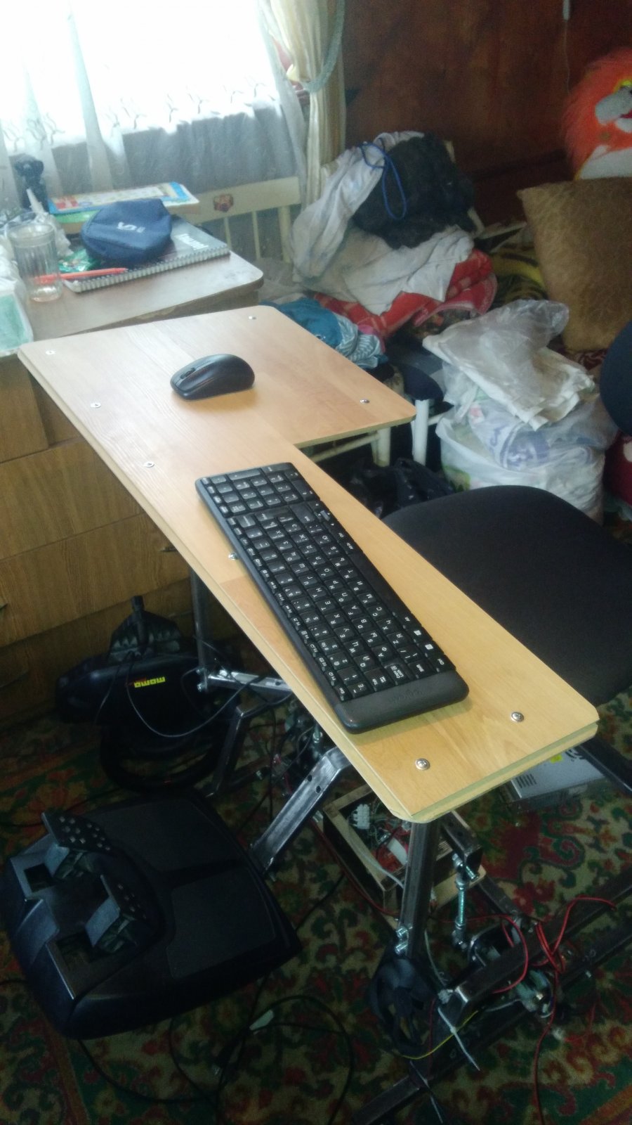

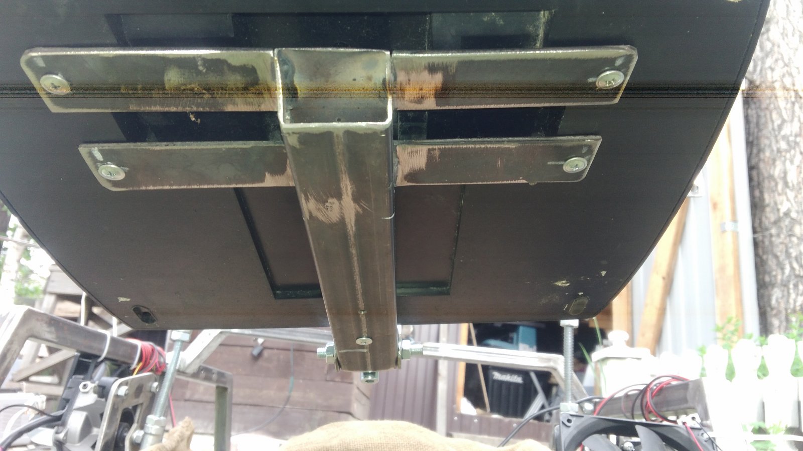

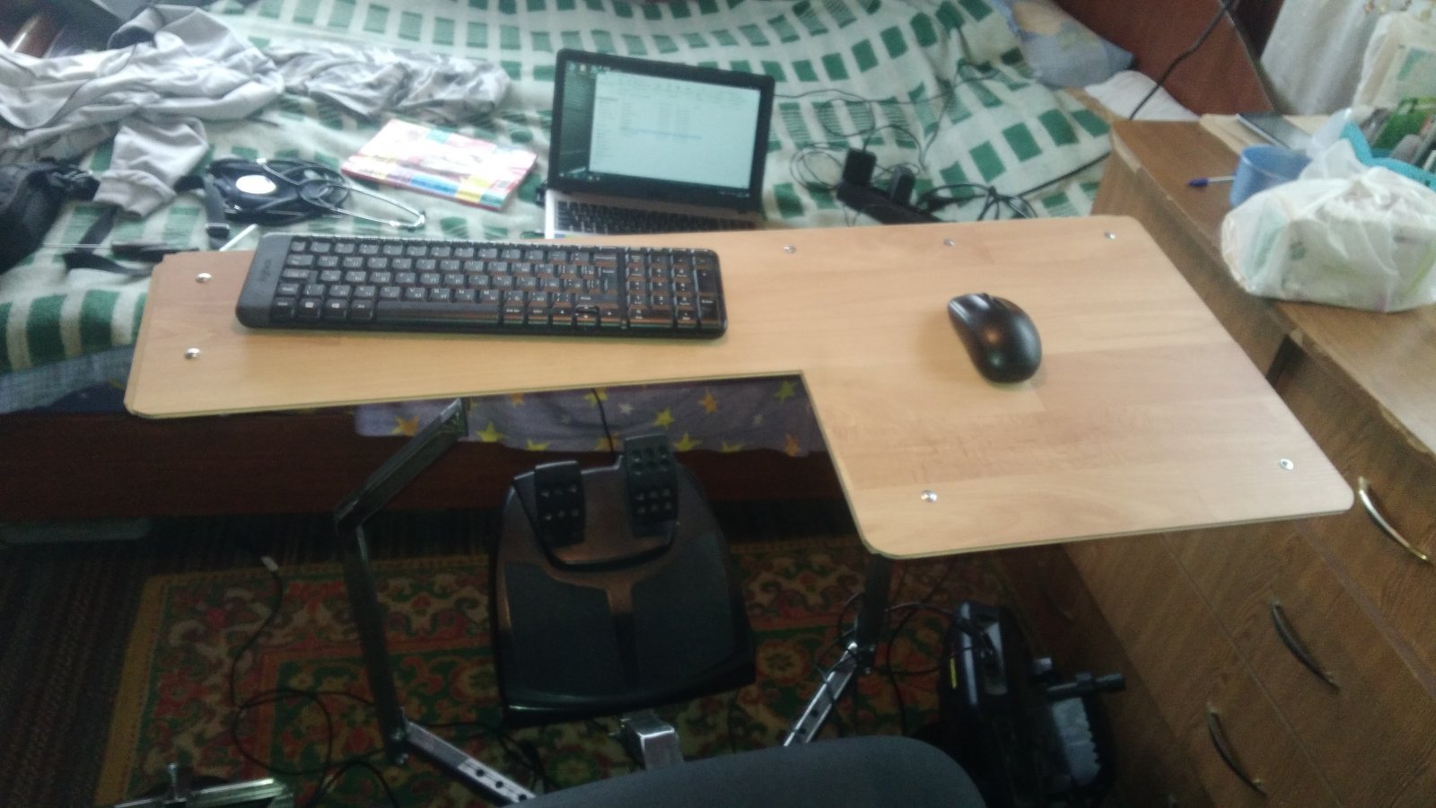

    Update.
    Flight mode adaptation (a keyboard plate is not done yet ):
    P_20190619_170522.jpg P_20190619_170538.jpg P_20190619_161613.jpg P_20190619_170604.jpg
    User PC mode adaptation:
    P_20190619_172008.jpg P_20190619_172016.jpg P_20190619_161523.jpg P_20190619_161509.jpg
    I've tried to do fast changing concept for all options I have.

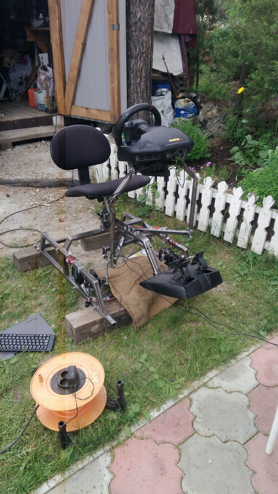

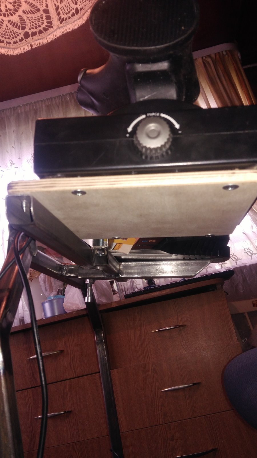

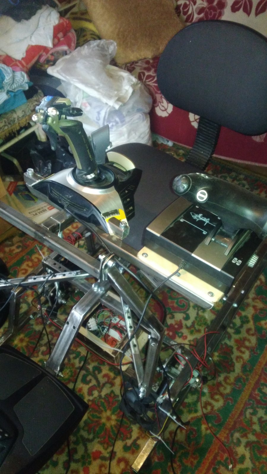

    Hello Everyone!!! Im almost done))))

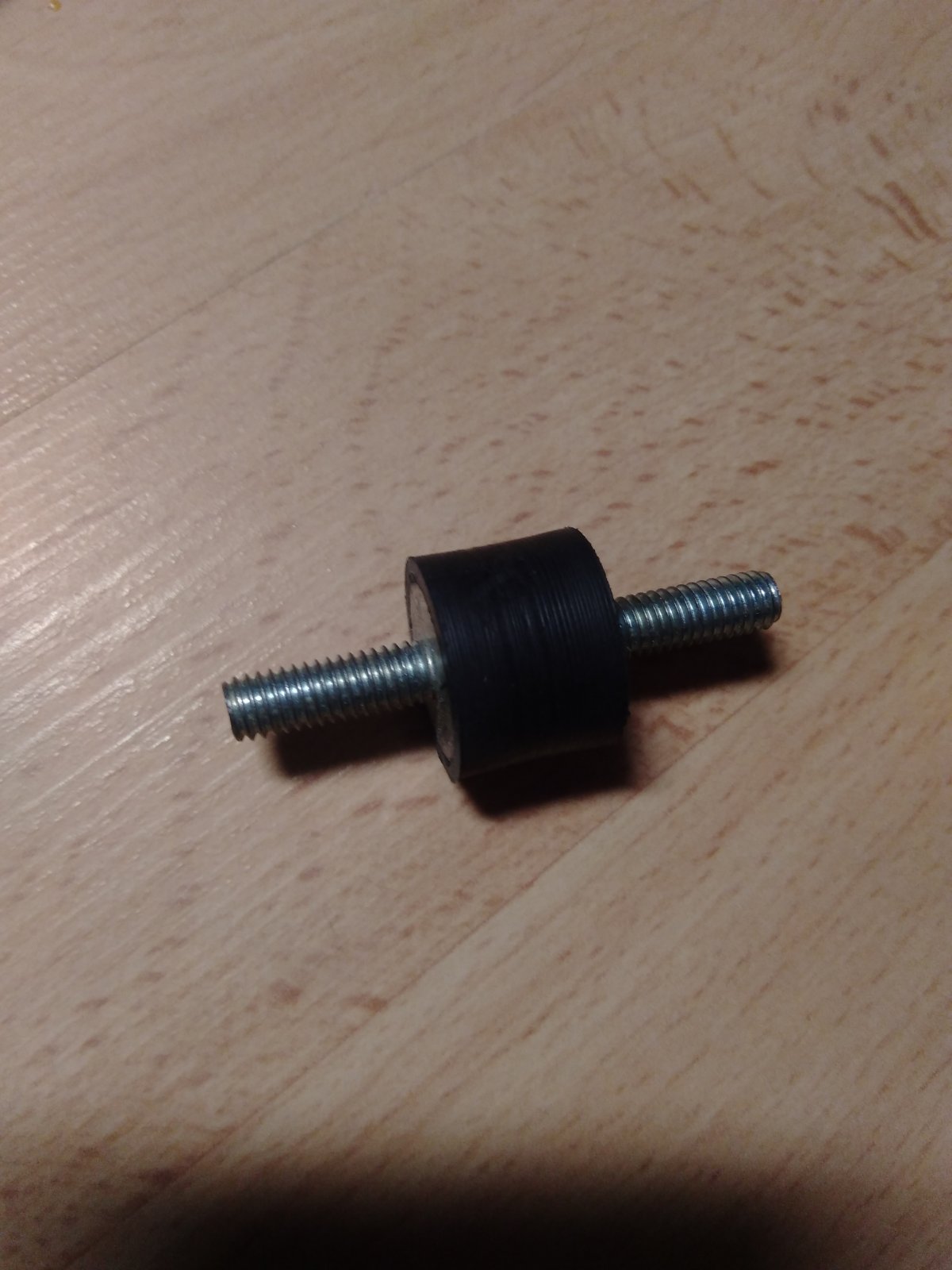

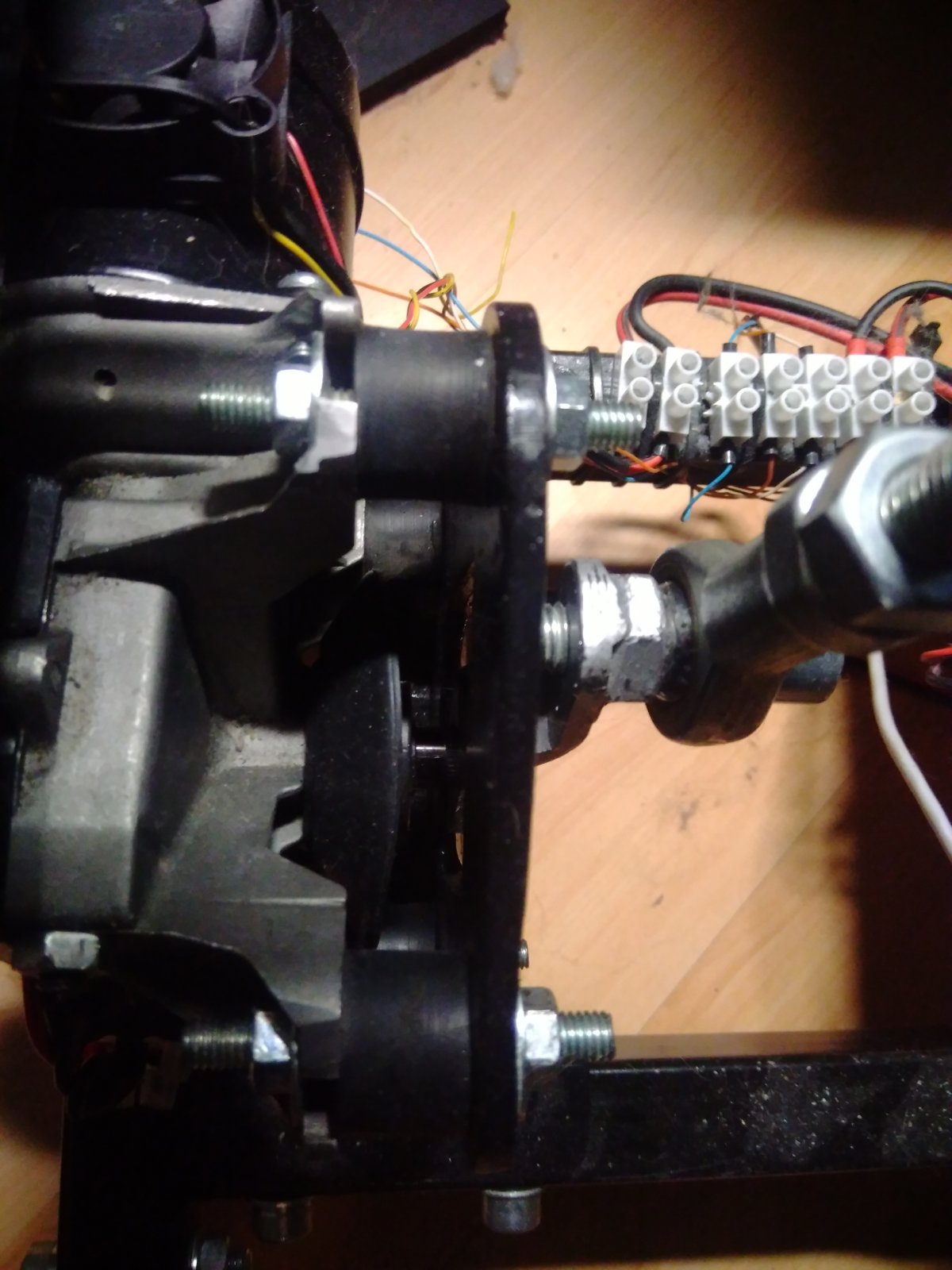

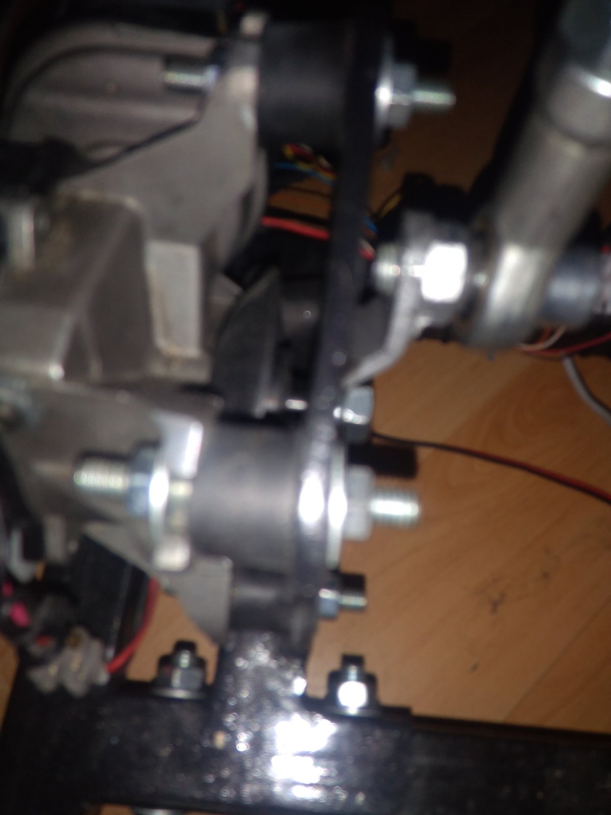

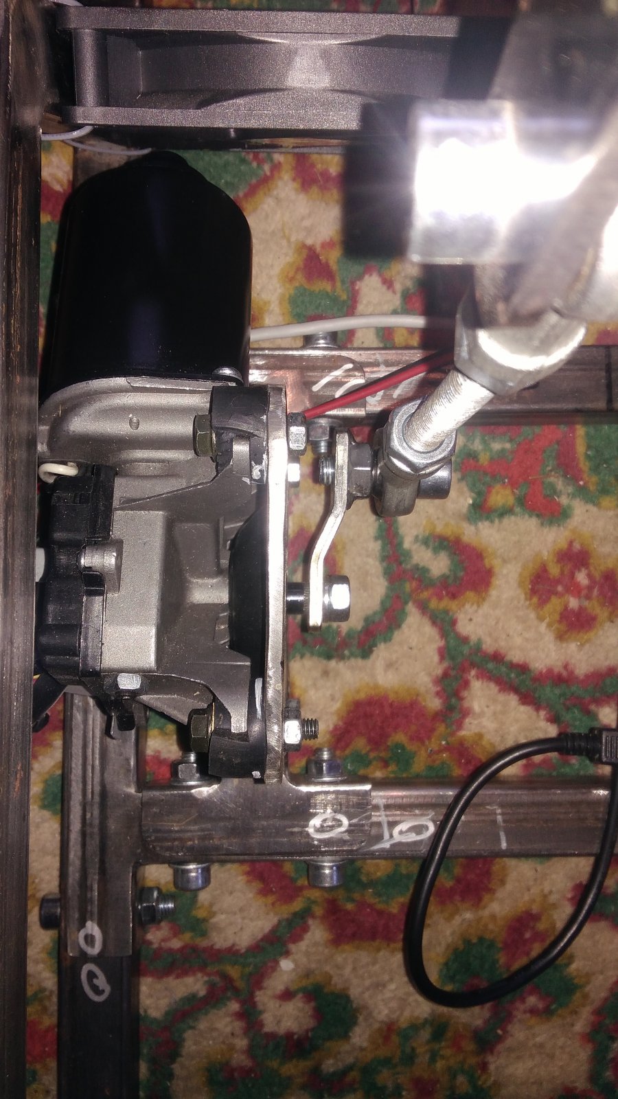

    People!
    That thing on the foto just a miracle!!!
    It reduce useless shocks and noises.
    Moves become more softly and natural.
    My neighbors won't kill me ))))
    VibroIsolators

    Good work! This is one of the lightest rigs i've seen, it clearly shows that even wiper motors work great under proper engineering. Big thanks is to DOF reality for their frame design.

    Thank you! Right now, I think about advansing of my rig. Get it more stronger and reliability/
