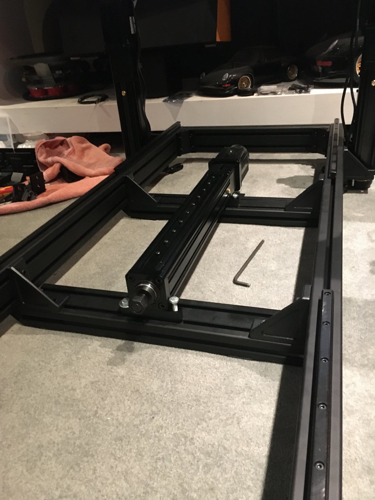

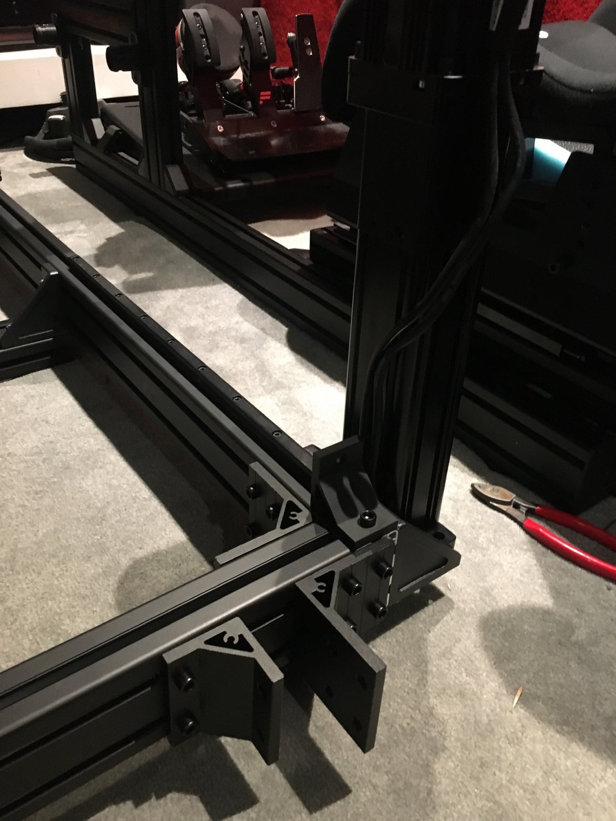

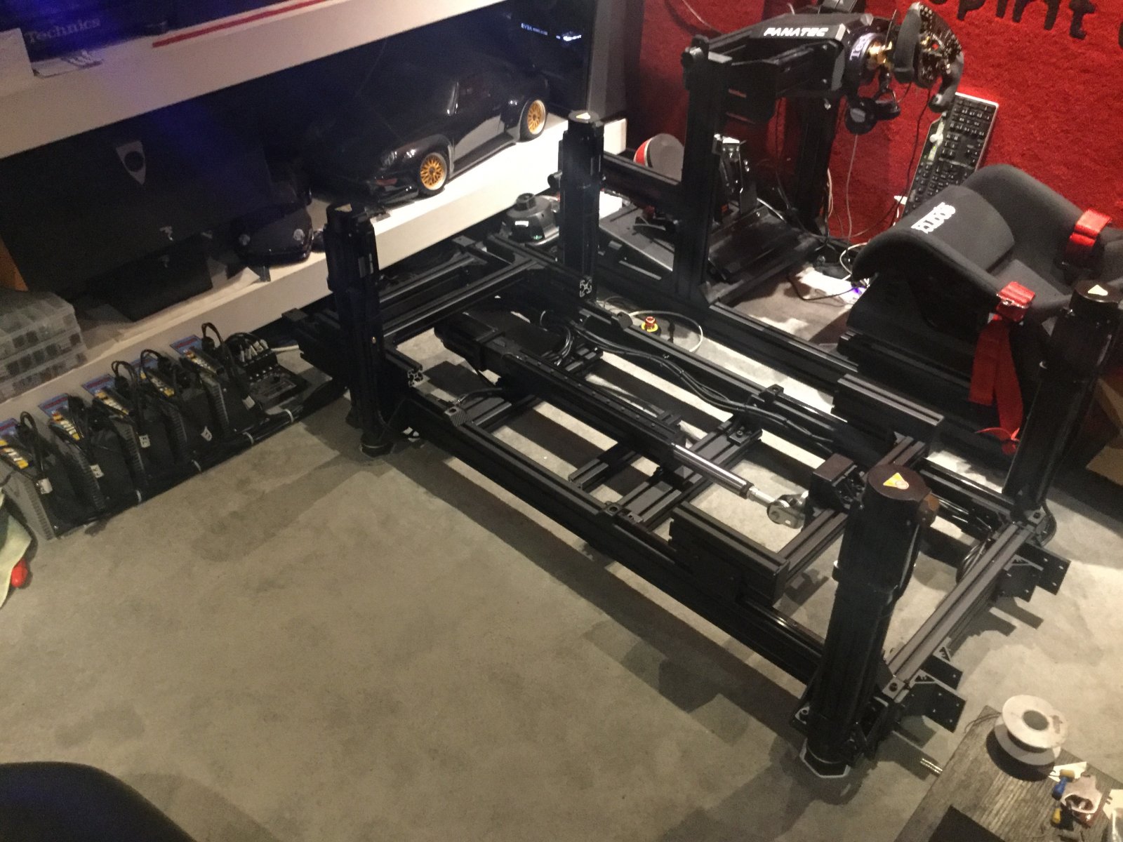

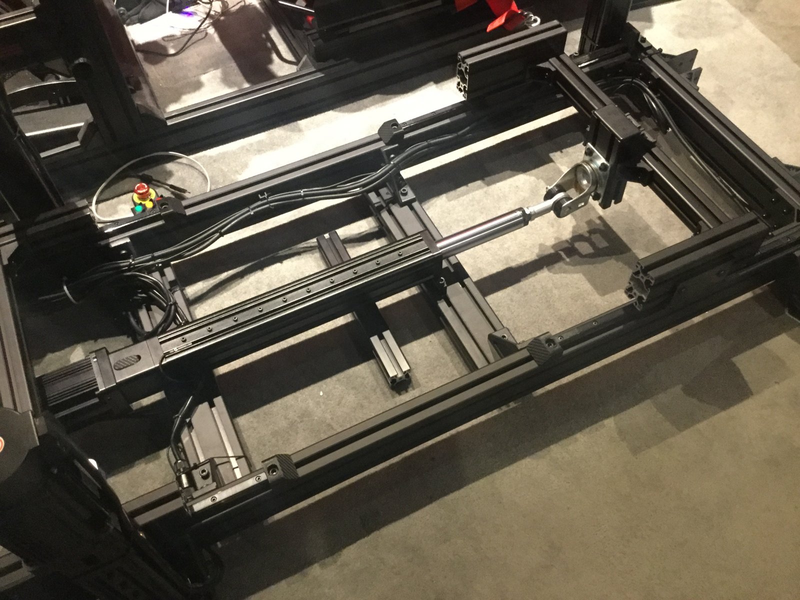

    A666ACEF-9D79-45D0-874A-22FBE8519263.jpeg F4769BCD-50F9-41DE-BF4C-4D5EA323DFEA.jpeg 60F66824-92FF-4780-9F86-95358876E797.jpeg I’ve finally got my parts for my 4dof with surge. After some work I’ve managed to get the platform ready to mount my rig which is a sim lab GT1 evo. The platform consists of 750w AC servo motors attached to custom actuators, the control is via AMC servo controller from Thanos. The slide rails are 15mm linear bearing blocks with one block in each corner of the rig, rails are 50cm long which allows me around 35cm of travel.
    Now comes the test phase, any help or info would be welcome.

    Custom actuators? Keen to share some details?

    They are made with 1605 ball screw and are 150mm travel. I basically went with the required specs of the sfx100 kit but with 150mm travel.
    I went with a flange to take 80mm motors instead of the 90mm. The motor specs are virtually identical between the 2 sizes. These are also designed for push and pull unlike the sfx actuators.

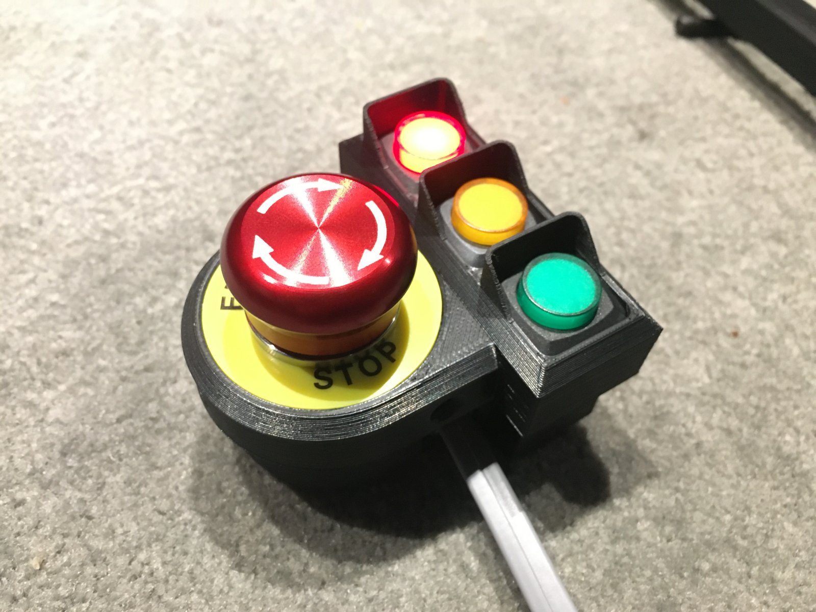

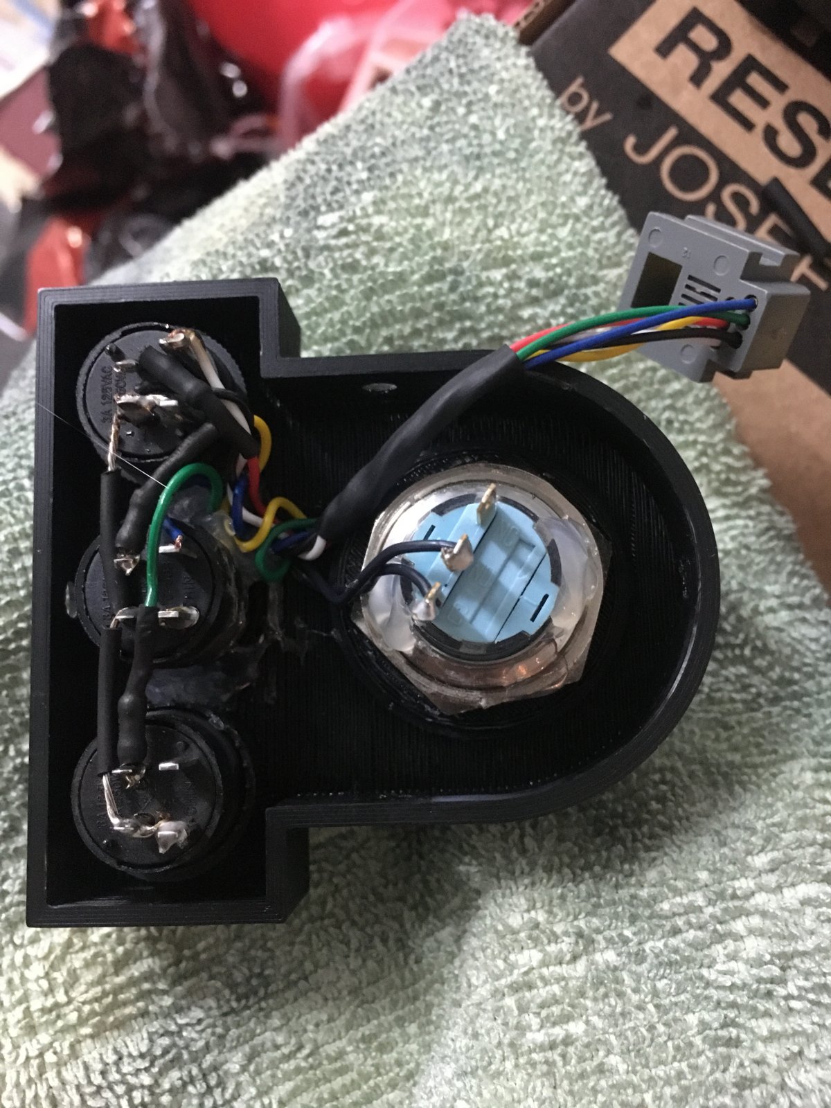

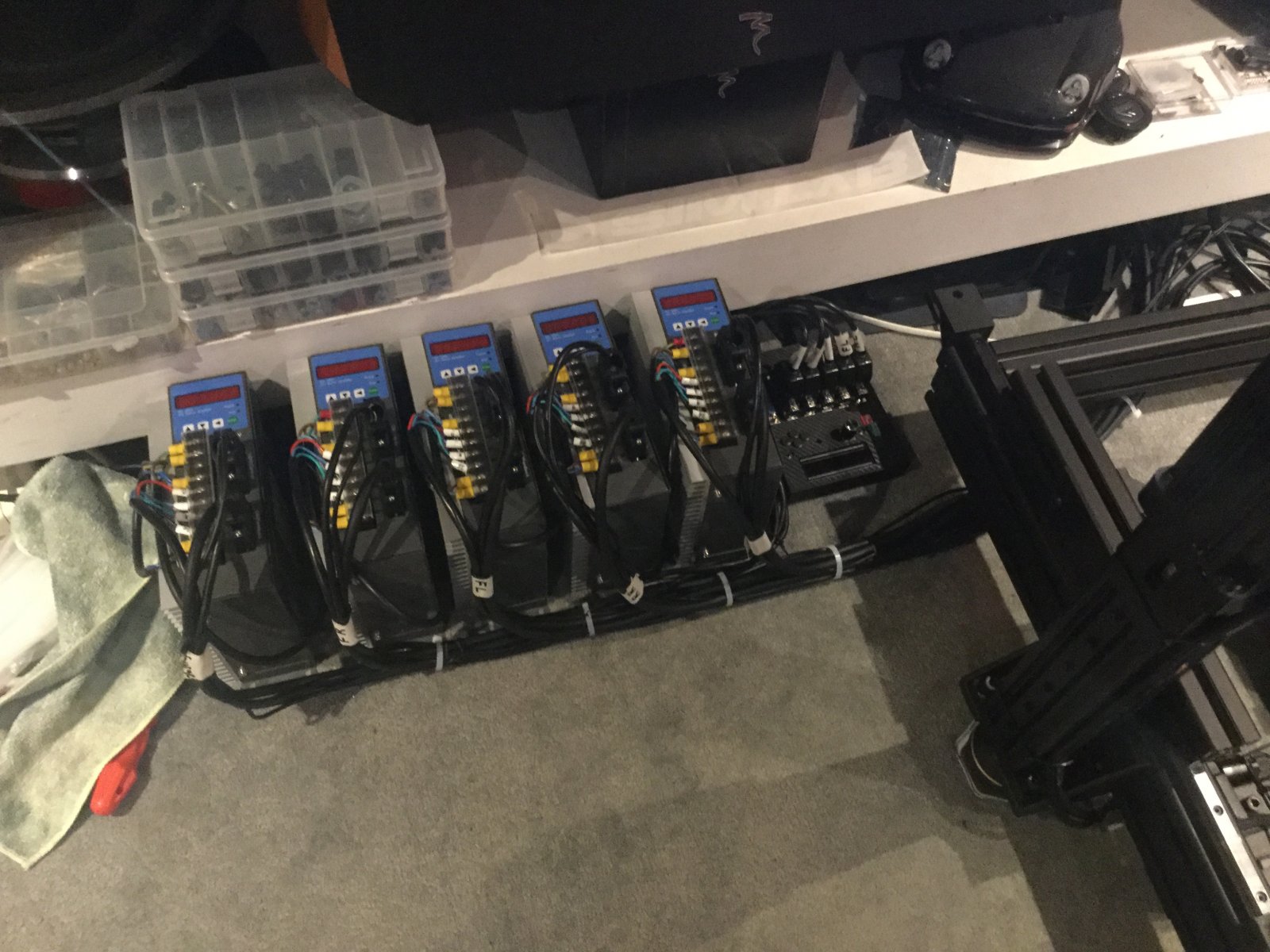

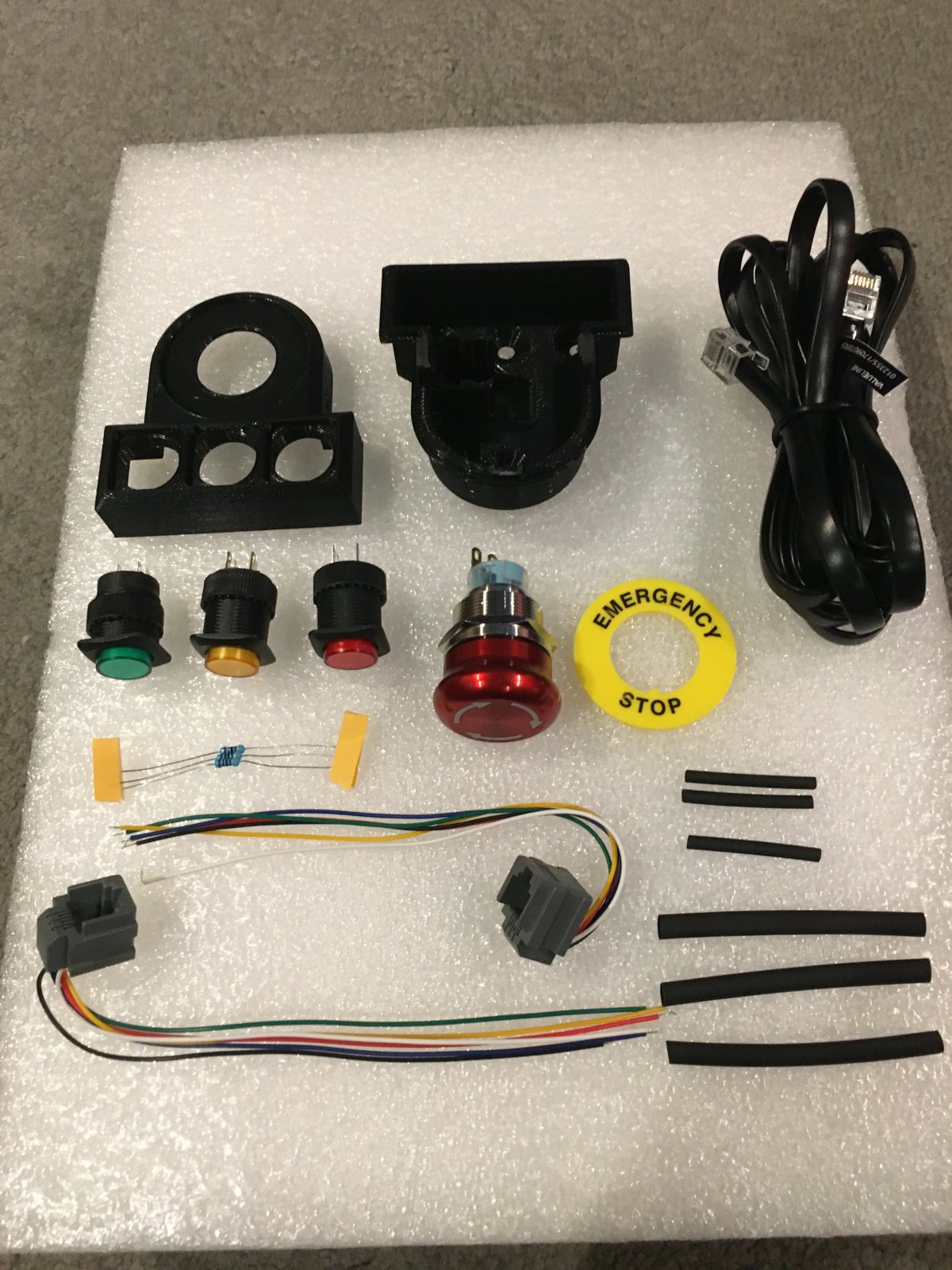

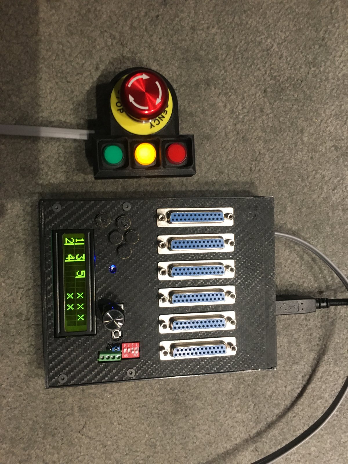

    A08DB48B-415D-4B1D-94B9-F3F7D56B8665.jpeg 788FD293-D4E3-4702-B75A-62F04905478F.jpeg 74912345-BC0B-4042-BCC7-3C6E27F06D8B.jpeg 00373702-C7A7-4B00-B4F9-45F2348AF7A1.jpeg Controller and emergency stop button ready to go.
    Next I need to do a bit of cable management before I can start testing the platform.

    Looks like a neat surge solution, I have the same rig and standard sfx-100s. How much did you need to spend on the extra profile and fittings?

    The profile was about £300 with fixings, the rails and guide blocks were about £200.
    I’m a bit afraid to total up complete costs

    E3485284-2611-4347-A032-013B0431F44F.jpeg D073D6B5-16D7-4961-A5D7-BB6F516B6B8A.jpeg 517656FB-8679-499F-B111-DE10A2972F98.jpeg I did a bit of temporary cable management so I can start testing.
    Once everything is finalised I will tidy up the cabling and hide as much as possible and put the motor drivers in a cabinet.

    The slider and push rod are very clever material choices, very referable if I upgrade mine to have surge or sway movement, I think I can control the cost within $150 in my country.;)

    I used Hiwin heavyduty 15mm rails and rail blocks, there are cheaper alternatives available but i didn't want to risk anything failing. They are quite common and can be found from various suppliers, I got mine from Alibaba.

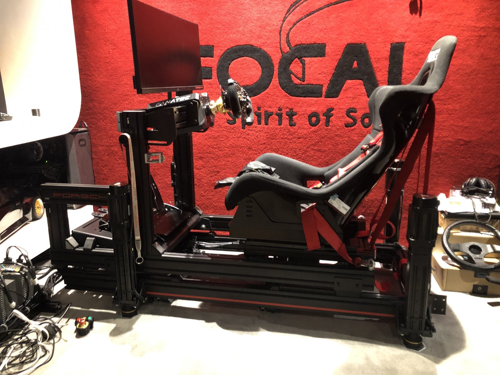

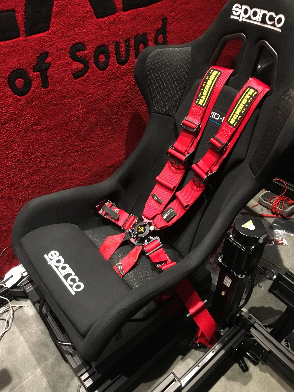

    I’ve had a bit of time with the rig now and am having a blast
    Still needs some tweaking to calm down any collisions but I guess it adds to the immersion. F17FBC88-6BC3-45BA-B09B-F26D405D7418.jpeg 6EBE1274-D9D7-40A0-8703-5245F43A5E41.jpeg
