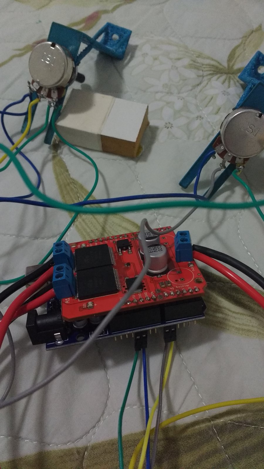

    hi Fellgood. thanks for you reply.
    yes. i think that all connections is ok. look:
  4. Pit
    3,012
    30,452Coins
    +3,094 / 31 / -0
    Hi mate, thinking or knowing could be quite different ;) There must be some creeping current between the pots.

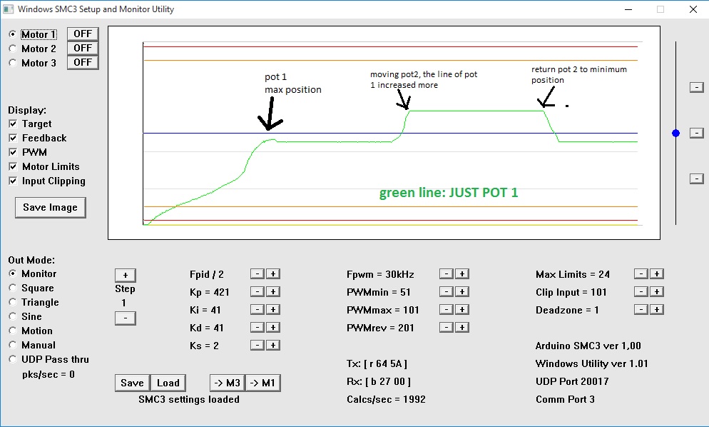

    Pit. Using the SMC3 Monitor Utility, i I had the impression that I'm having a voltage return (or creeping current - Correct me if I'm wrong).
    Look:
  14. Pit
    3,012
    30,452Coins
    +3,094 / 31 / -0
    Either way there is something wrong with your pots, the max position should be close to the max limits line and not close to the target line. i suggest checking the pots one at a time. probably there is a short of the pot case to one of the wires. But this is an assumption only.

    I notice in your photo of wiring you have POTs connected to A0 and A1 of Arduino?
    When the moto monster board is piggybacked like you have done I believe these pins are used for other functions... see schematic: https://cdn.sparkfun.com/datasheets/Dev/Arduino/Shields/MonsterMoto-Shield-v12.pdf This is likely to be causing problems.
    If the code you tested is meant for piggyback use then you are probably using wrong pins - check their instructions.
    Now you are testing with SMC3 you will need to unplug it as a piggyback board and wire as detailed in SMC3 thread.
