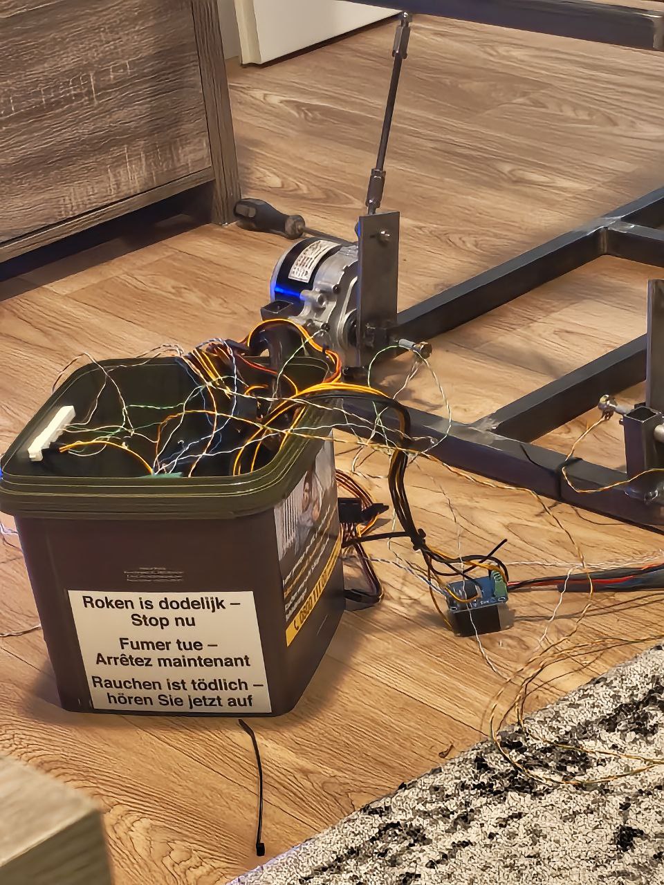

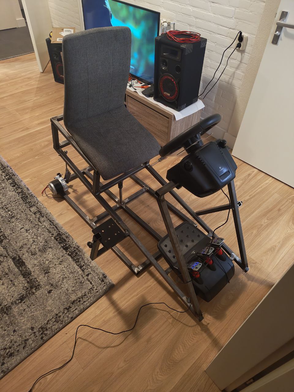

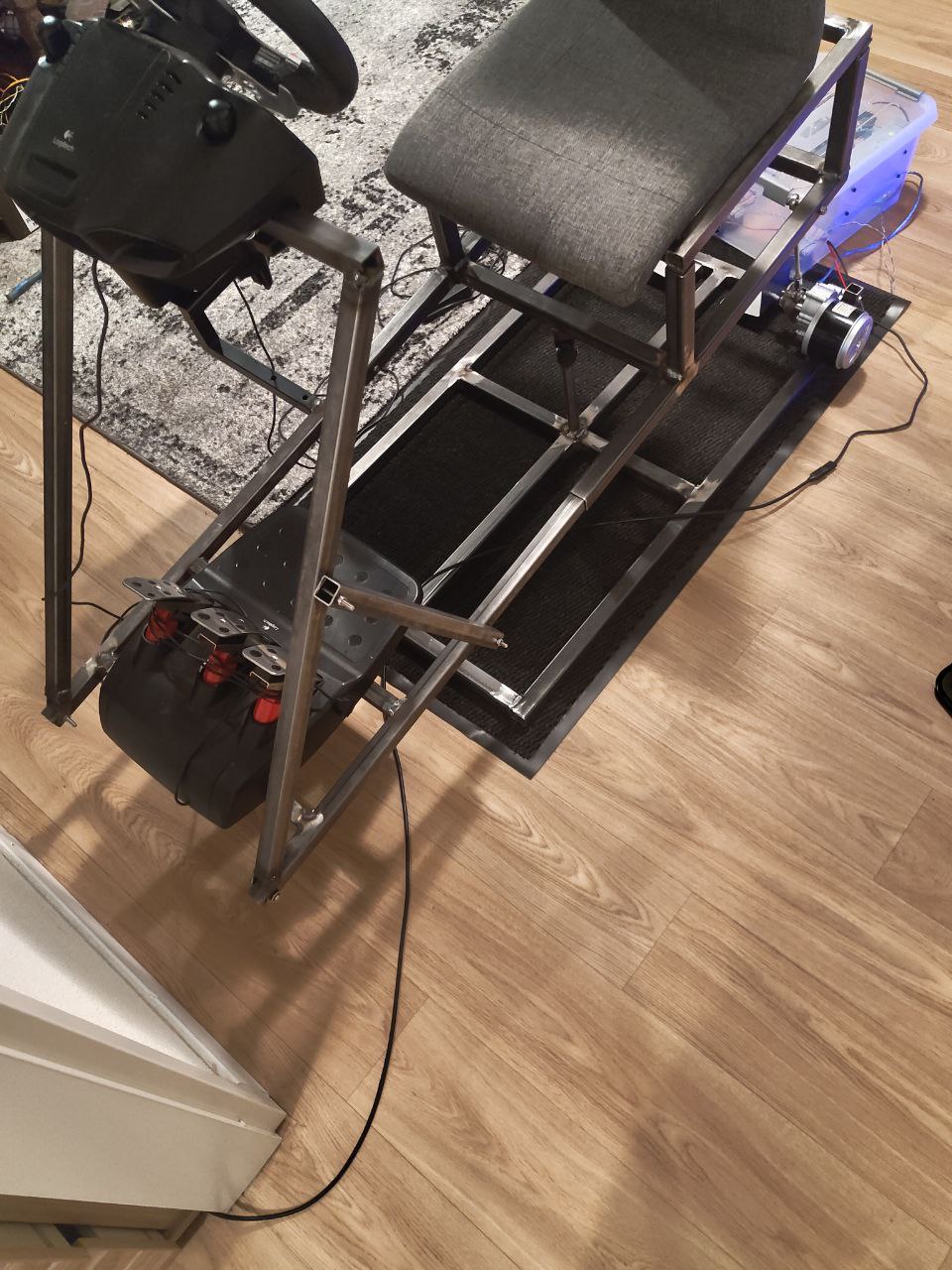

    Hello everyone, my name is Valery, I am from Ukraine, but due to the situation in Ukraine, I currently live and work in the Netherlands for 2 years.
    About a month ago I saw people building moving platforms out of anything. I thought it was pretty easy (how wrong I was). Here is the list of what I bought:
    1.IBT 2 x2
    2.wheelchair motor x2
    3. power supply 24 volt 25 amp x2
    4. 16 meters of profile (8 meters 25x25, 8 meters 30x30)
    5. 10kom potentiometer
    My father works as a mechanic at a factory and he persuaded his boss so that I could weld everything and assemble some small things. It took me 14 hours (1 day). photo_2024-02-17_18-37-59.jpg

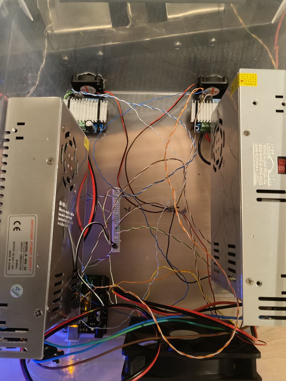

    After which I started connecting the electronics and after the first tests I realized that my engine lever was too long (15cm) (day 2-3).
    That day we trimmed the lever and made holes 5 and 7 cm from the center. After connecting, I realized that the power supply from the computer was too weak and was being protected, and I immediately ordered power supplies for 24 volts and 25 amps (day 4).
    waiting for delivery and attached a potentiometer to the frame (day 5).
    And finally, on the last day, I installed a cooling radiator with a fan on IBT-2 and carefully secured it in a plastic box.
    I'm using Google translator. I'd also be happy to hear your advice on reassembling and replacing something with something else.

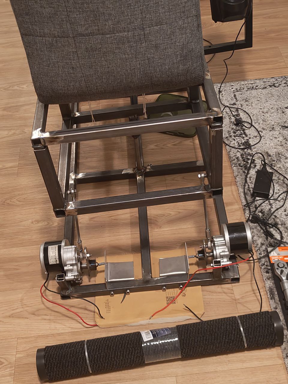

    What are you using as a universal joint?

    I ordered from Amazon but I can’t recommend it because it has a lot of horizontal play. And the play can hardly be caused by me since it is tightly welded on both sides.

    You must reinforce your central support with side bridges and i recommend you to use automotive U-joint not this chinese crap

    I needed it, but I couldn't find it at a reasonable price.

    Go to junkyard
