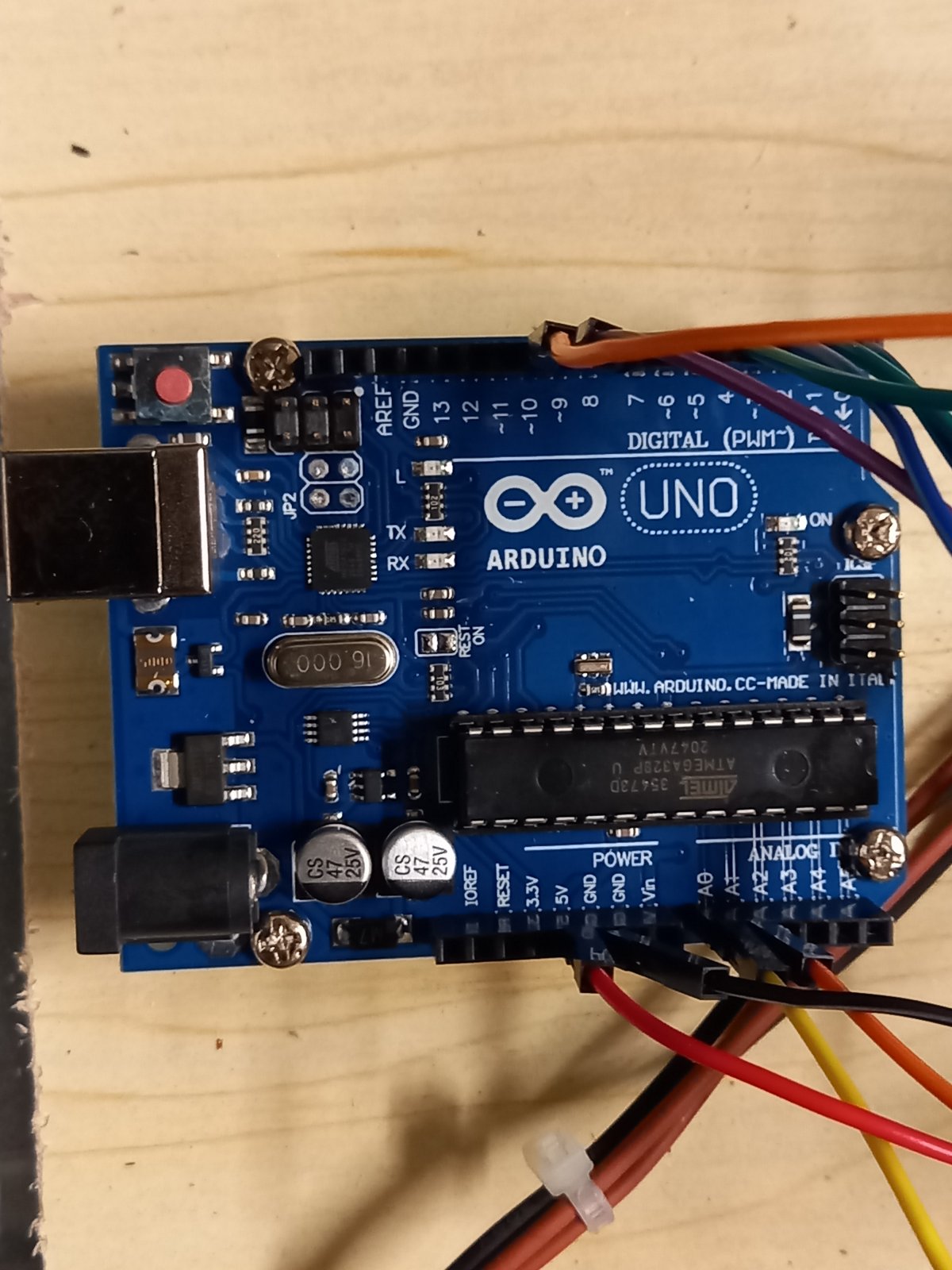

    Just checking, are you using a genuine Arduino Uno, or a clone?

    Purchased locally from electronic shop marked as Arduino uno has the sideways figure 8 with the + and- symbols and the long processing chip but don't know beyond that . I have added a picture so maybe you can tell from that . 20230817_192236.jpg

    OK, so is the Arduino IDE settings configured for the Uno, including the correct port?

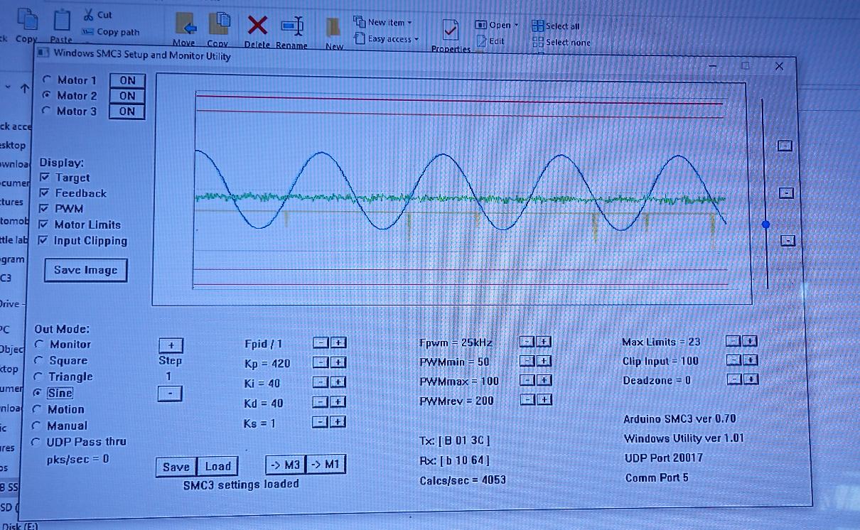

    Can you please post a picture of the SMC3 settings, running Sine in Out Mode.

    Thanks for all your help I hope this is what you want

    It does not look to be tracking, are the pots connected to the motors?
    With power off to the motors, if you move the pot by hand does the SMC3 line move?

    Yes with power off to the motors when I move the pots the green line moves to follow

    Are the pots connected to the motors in the SMC3 Sine test, as they provide positional feedback?

    Yes they are connected to the motors but for some reason when everything is powered up I get no power out of the RBT 2s to the motors so the motors do not move
