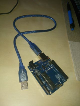

    Hello all,
    this is my first project simulator. In total there are many helpful projects that will certainly help me in the construction .
    I am open to all suggestions .
    At the beginning I have:
    Arduino Uno R3
    Moto Monster
    2x potencjomert 10kOhm
    2x wiper motors
    I miss the power supply yet , but I'll buy 12v30A .
    Photos I will keep adding .
    I'm counting on your help.
    Regards

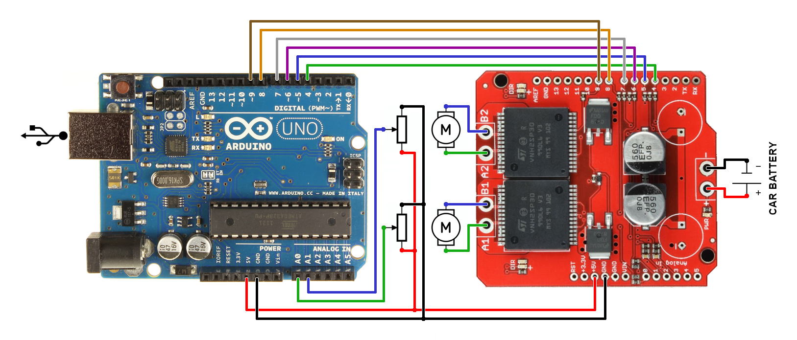

    Connecting the Arduino Moto Monster .
    Correct ?[​IMG]

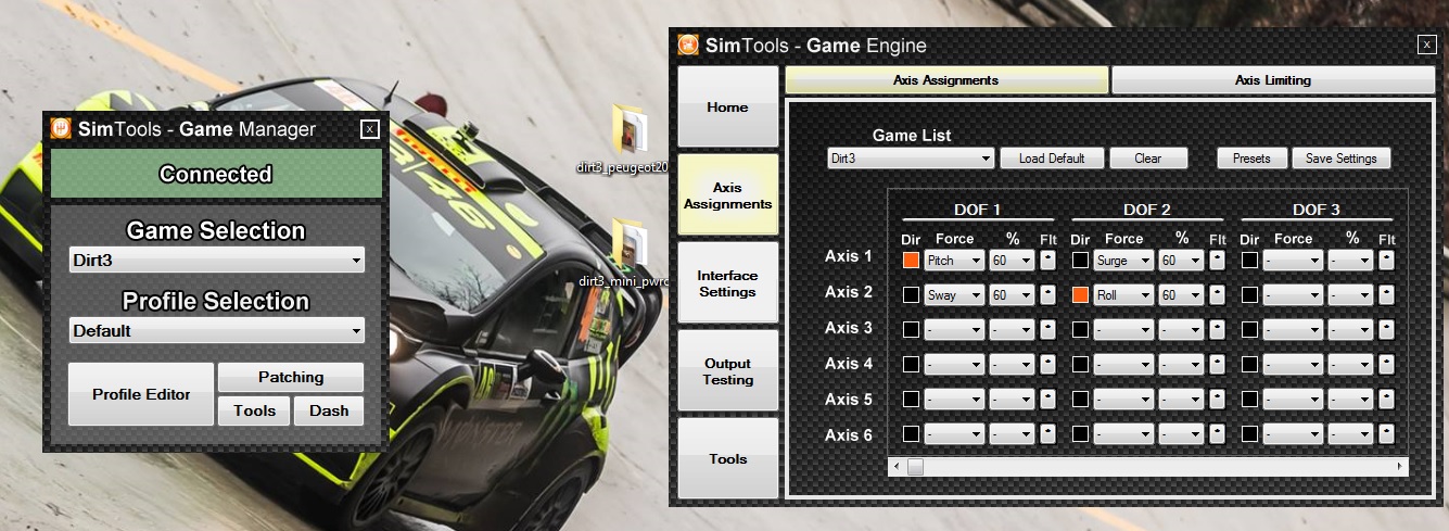

    Slowly I submit the simulator .
    I made a small model , I have a problem , I made the settings, turn on simulations and mouse move some strip the engine running .
    How to Run the game it's not happening , I set as on http://www.xsimulator.net/simtools-quickstart/
    Where is problem?
  18. noorbeast
    21,190
    148,820Coins
    +10,919 / 54 / -2
    You need to give a bit more information, like posting screenshots of all of your settings.

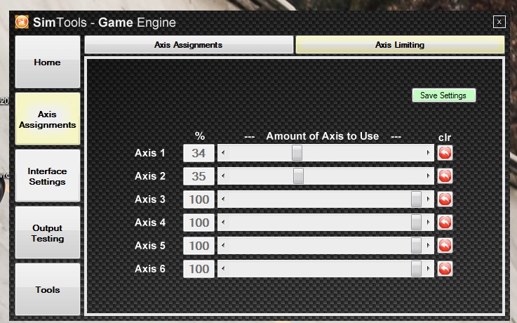

  20. bsft
    why is amount of axis used so low?
